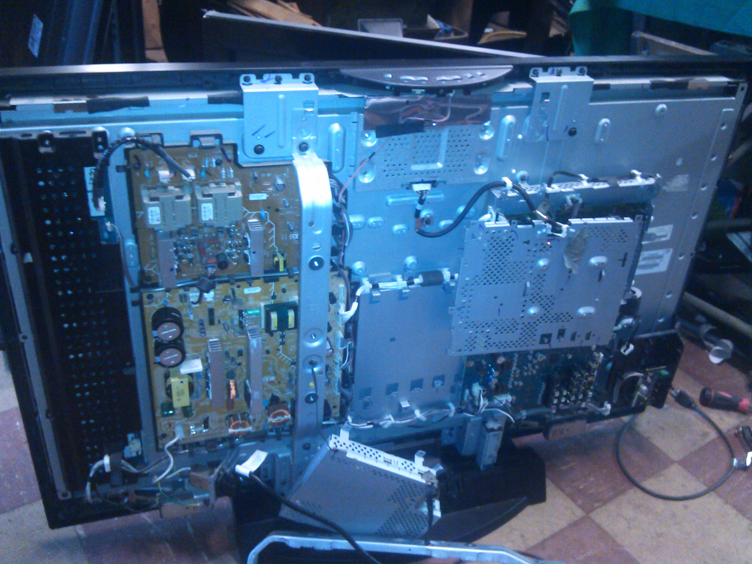

    Ok so i got this tv and when i press power the green light comes on but no picture, then after about 30 seconds it will flash 1 red blink the go back to solid green but still nothing, any ideas?
    Re: Kdl-40v3000 1 red blink then back to green
    Solid green sounds like it is turning on normally.
    No backlight? Any sound?
    Pictures of the TV boards?
    Have you checked if your PSU is outputting OK voltages? Most SONYs have outputs labelled.
    Check for 24V & BL ON at inverter...

      i checked the vcc on inverter says 12v on meter. So think inverter is bad?
        This uses a high voltage inverter - you cannot check it with a meter. Did you check BL ON and BL ERR (if present?)

          [=tom66;451126]This uses a high voltage inverter - you cannot check it with a meter. Did you check BL ON and BL ERR (if present?)[/QUOTE]
          i cant seem to find them tom, they would be located on power supply correct?
            Yes but they could be variously labelled ON/OFF, BLON, INV_ON, etc. For now just locate backlight on signal.

              i have balancer, inverter err, nothing that says on, also on my main board i have a little orange light that is blinking non stop then it will stay on then blink, it makes weird non pattern blinks

                i mean if it was inverter i should be able to flash light to see menu or something, i see nothing
