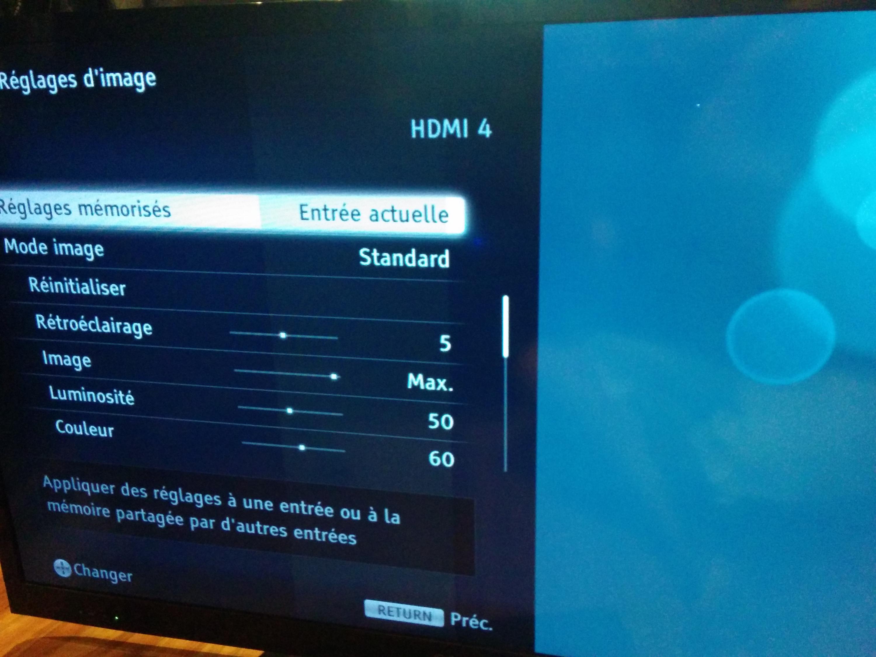

    Hi, I god a Sony KDL-55EX620 with a very light grey bar (See picture)
    Can it be a bad t-con or bad panel?
    Re: Sony KDL-55EX620 Grey Band
    More likely bad panel than anything else.
    • rikrikrik13
      • May 2013
      • 44
      :/ bad news
