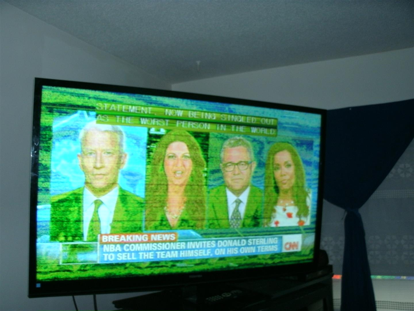

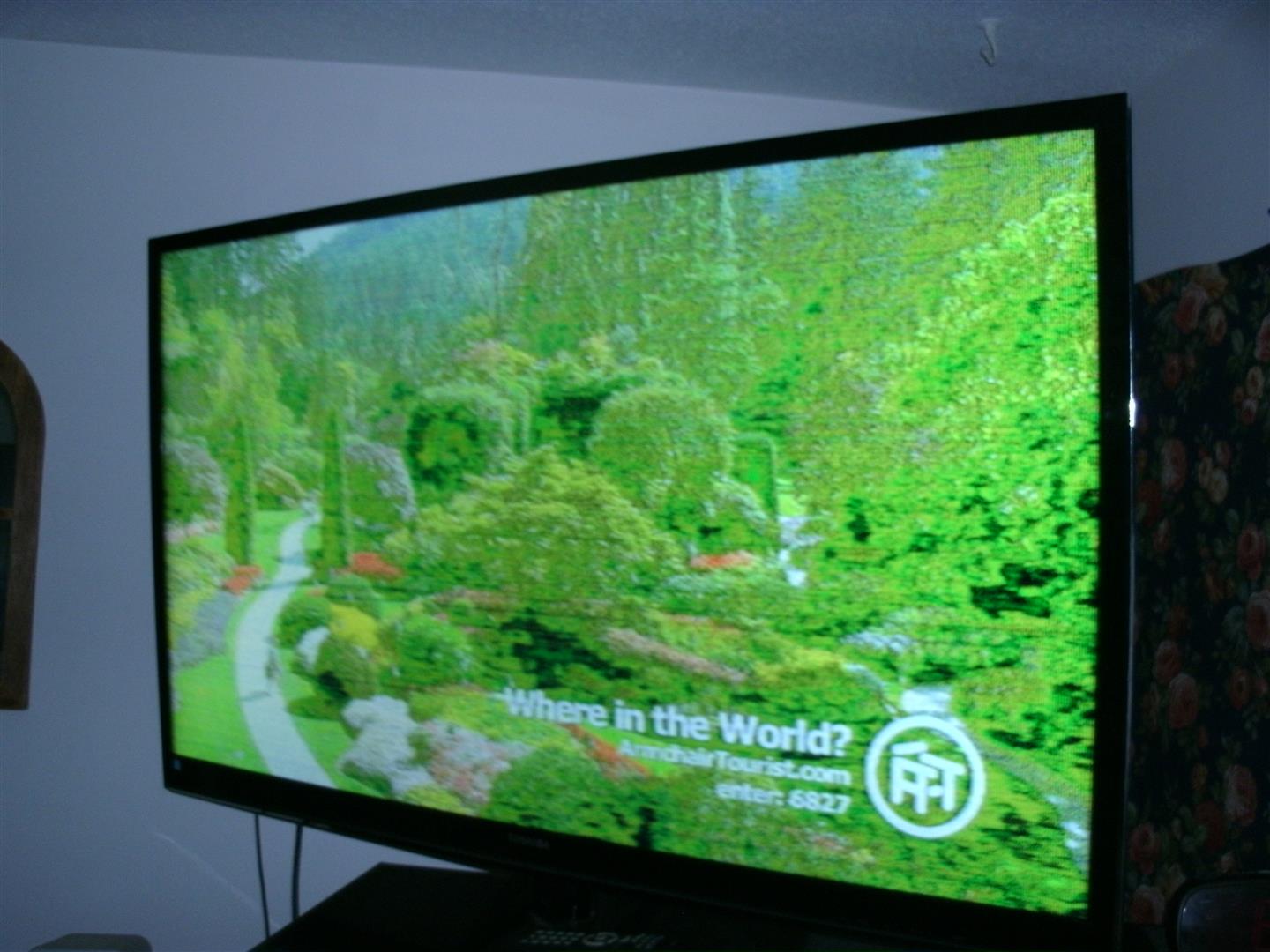

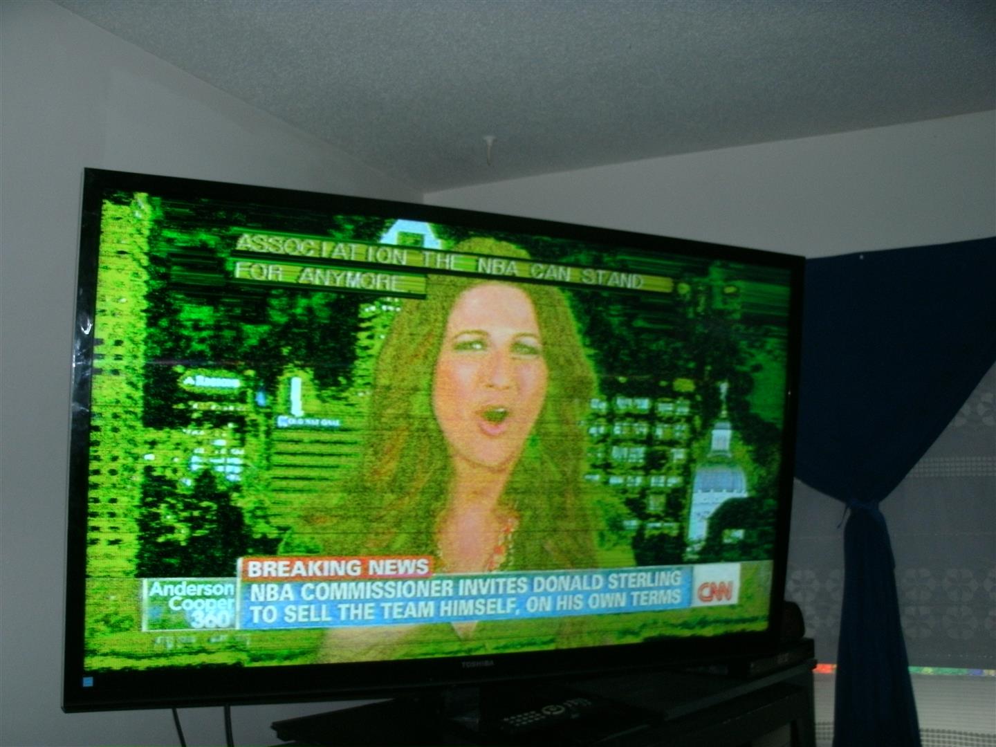

    I have Toshiba 55SL417U Led TV. Out of nowhere my screen became a distorted greenish image as you see in the attach pics. Could you please inform me as which IC board would cause that problem?

      Re: Toshiba 55SL417U Image Problems
      It is possible loose LVDS cable or T-Con pcb try removing cable and clean conector and reset cable, if this fails you might have a bad main pcb.
        Thanks SueVideo for your advice. I reset all my cables especially the ribbon connectors & its working Great now!!
          I had a 32" Toshiba like this (also LED TV) and it also had a loose LVDS cable. common fault.
