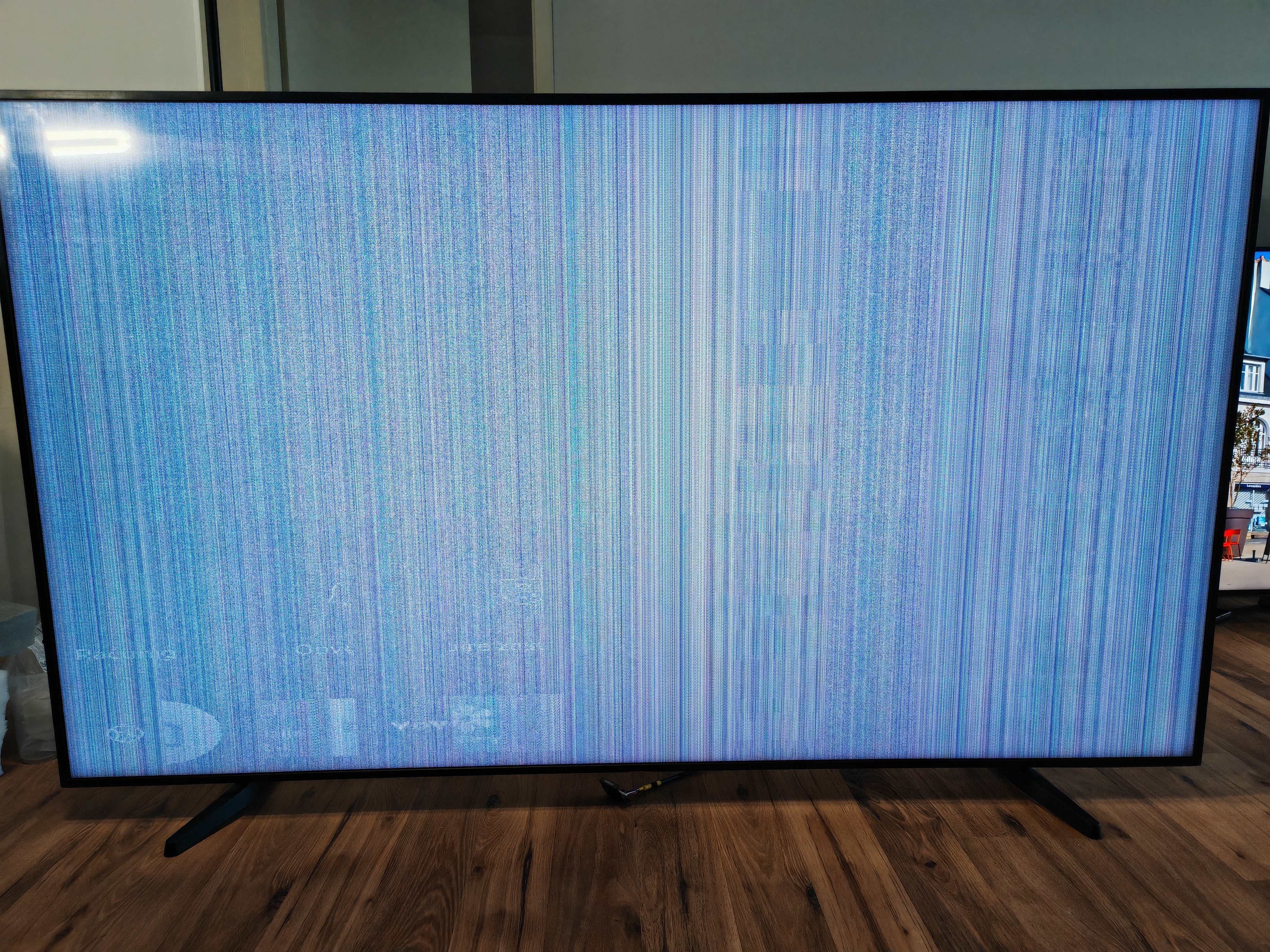

    Hi, i got a Samsung QE65Q60RAT with dead MB, so I trayed with MB from 55" QE, and getting strange pattern on screen, but have menu in background, and TV is responding on commands,...Somebody any idea what can it be (picture)..faulty screen?
    thx

    Firstly, you have different panels, which means the T-CON firmware will not match your panel, and secondly, if the panels are from different manufacturers, then there are position resistors on the motherboard and they must match your original motherboard...​

      i am talking rs original MB. it could be repaired better than to swap T-CON SPI from old to other. as you have now different Panel profile
      so what are the issue with yours original MB ? dead no boot no front LED... if its so did you measured the rail of 3.3V of the start SPI if it shorted to chassis.. ?

        dead, taken out and somebody is messing with it,..basicaly left withouth MB so I am tying just to find out if is screen working to buy a new MB

            The panel is most likely alive, look for the motherboard number BN94-14007G.

                The panel does not have black vertical pillars, the TV does not turn off or reboot.

                  it will do right away when correct MB in place... now CLK line missing just like masking
                  you write it correct at yours first post

                    i think you need to search ebay not for MB model code but for Screen model code (sticker)

                      then 50/50 .... so, will go for parts

                        I explain better my theory, Samsung is from the stone era busy in planned osolescence techniques, between my last annotations, in main board searches (i do it very rarely) i noticed too much codes of the sticker type and also screen stickers, respect to the pcb code, my bet is that it doesn't exists technically so many variants, it's Samsung that varies them to confuse everyone, so maybe the correct search at first try on ebay could be
                        " (-your BN94-XXXXX-, -yourPanelcode-) -your BN41-xxxxx- "
