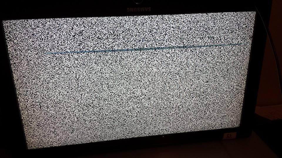

    hi guys have a Samsung 32" TV that refused to switch on/stuck in standby. replaced a small cap and a resistor and tv switched on no problem, however there is 2 blue lines on the screen. can this be replaced or is the panel faulty ?
    just when i go to switch tv off and the static on the screen dissapears the blue will turn to white just as tv powers off.
    Re: help with a screen issue
    Bad panel. Common fault with early Samsung panels.
