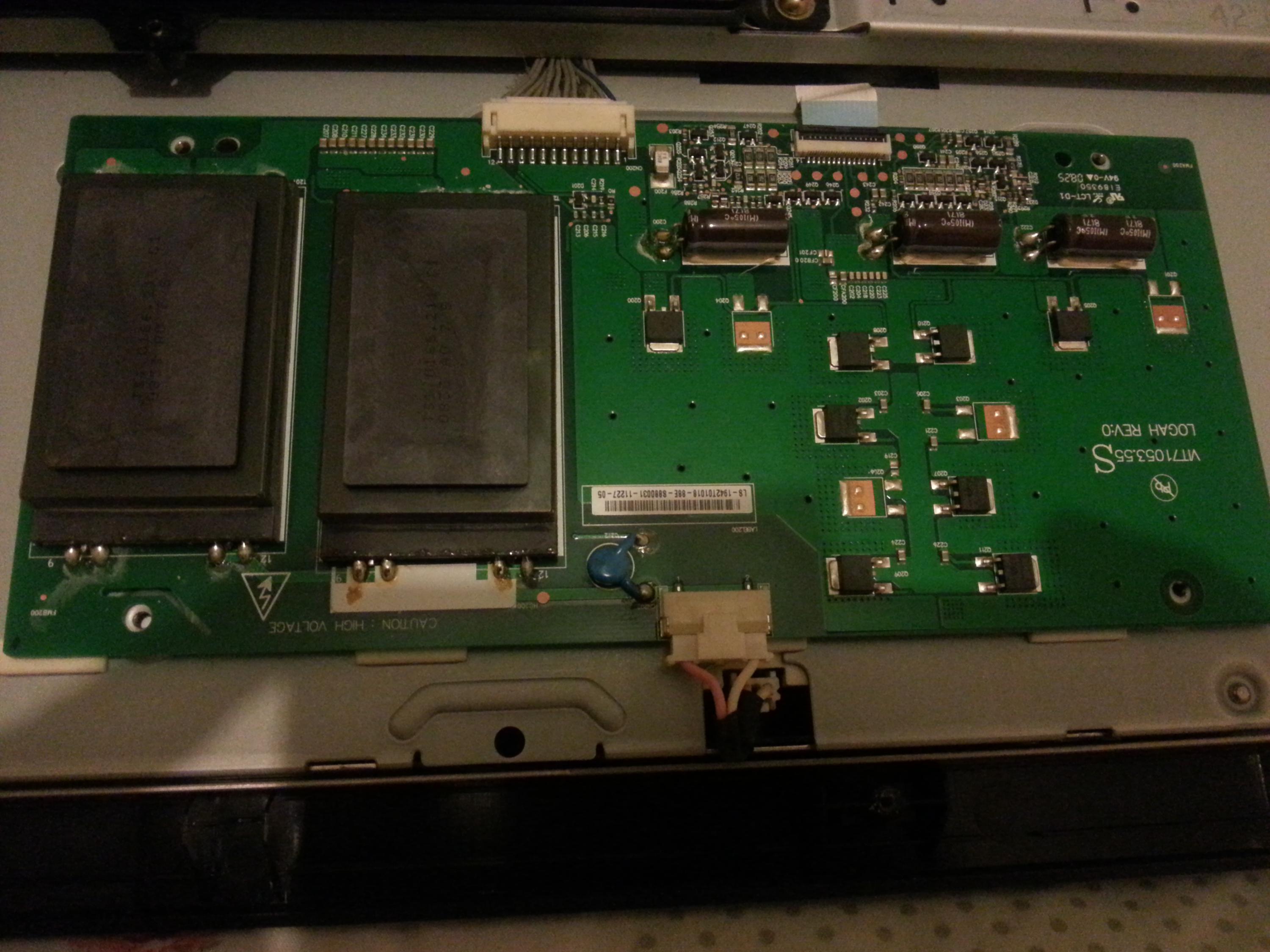

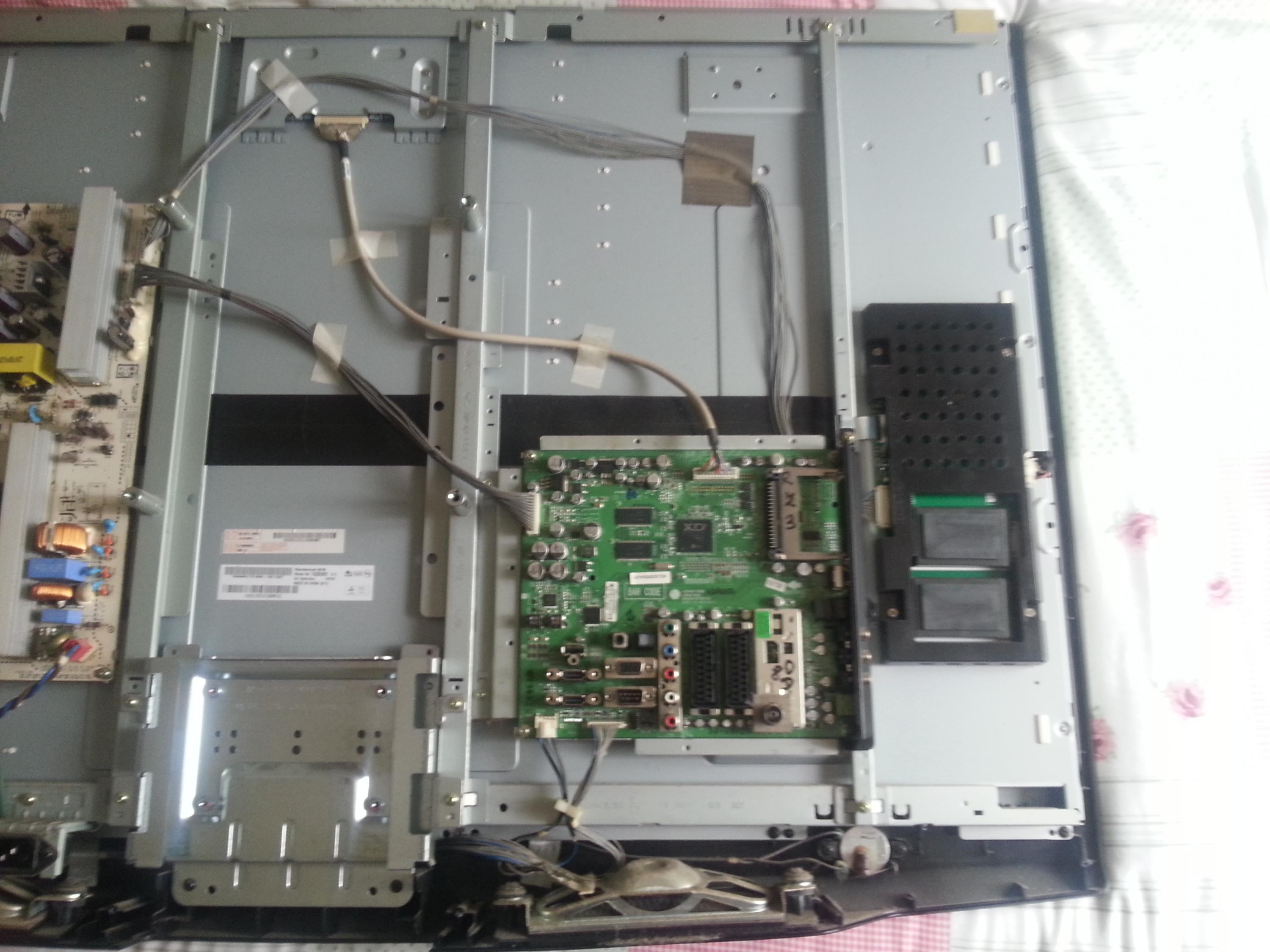

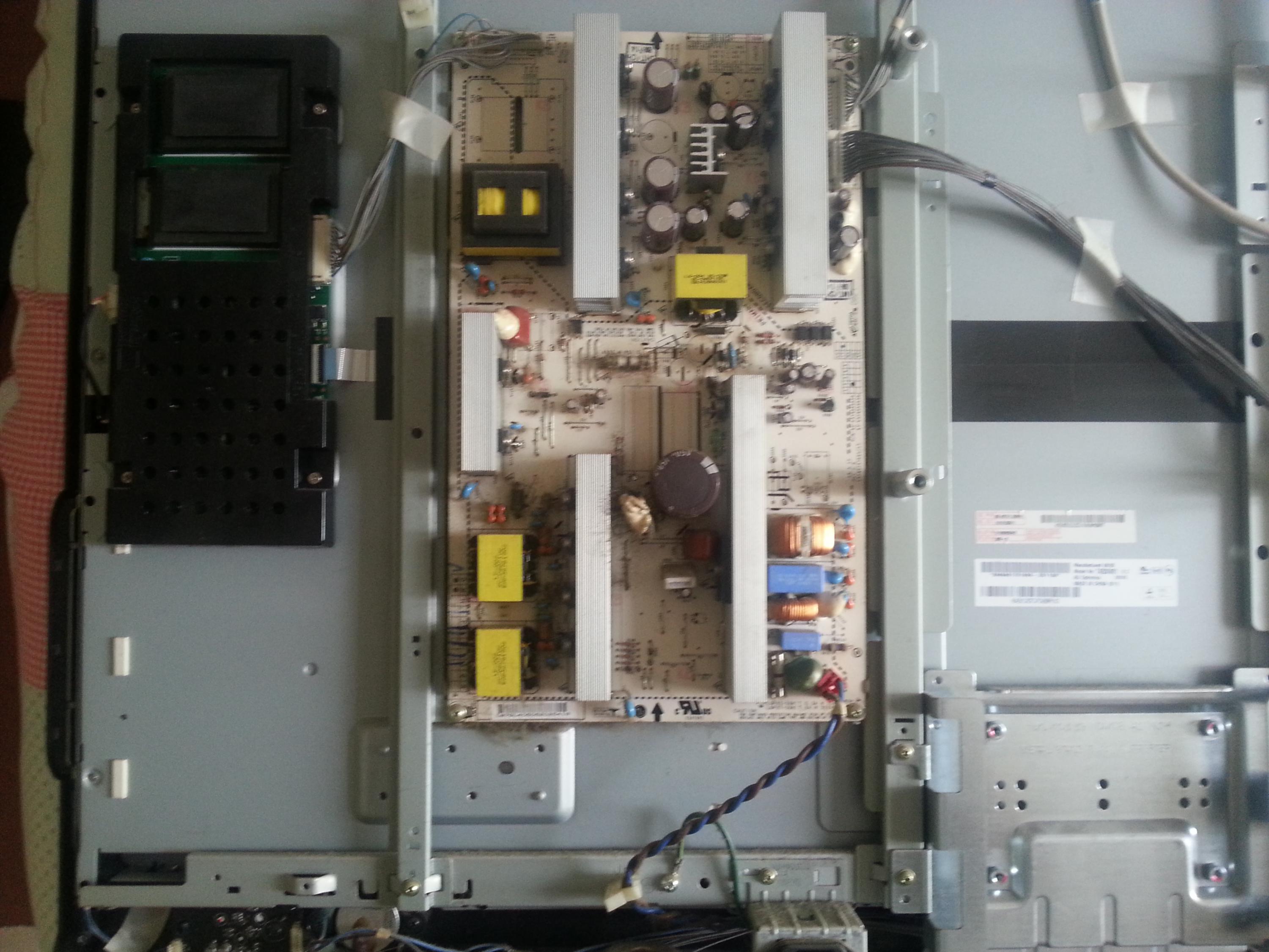

    Hi
    I have just been given a 42" Lg3000 lcd tv with a problem . As far as i can see it will power up well red light will come on but no picture or anything. if i hit the input button on the side the red light goes brighter flashes then goes off , cant get passed this part. Apparently if you plug a dvd player in it will play sound but no picture but i cannot test this at them moment
    Added small video of what the red light does when i press input button at side as i do not have the remote control for this set yet
    https://dl.dropboxusercontent.com/u/...511_174146.mp4
    any help would be greatly received
    Attached some pics

    Revised look at tv .. the red led is dull if i hit the input button on the side it brightens up flashes three times then goes off. At no point do the screen try to light up

      Ok , i have picture if use flash light in dark but have sound ... anyway i can the inverter boards?

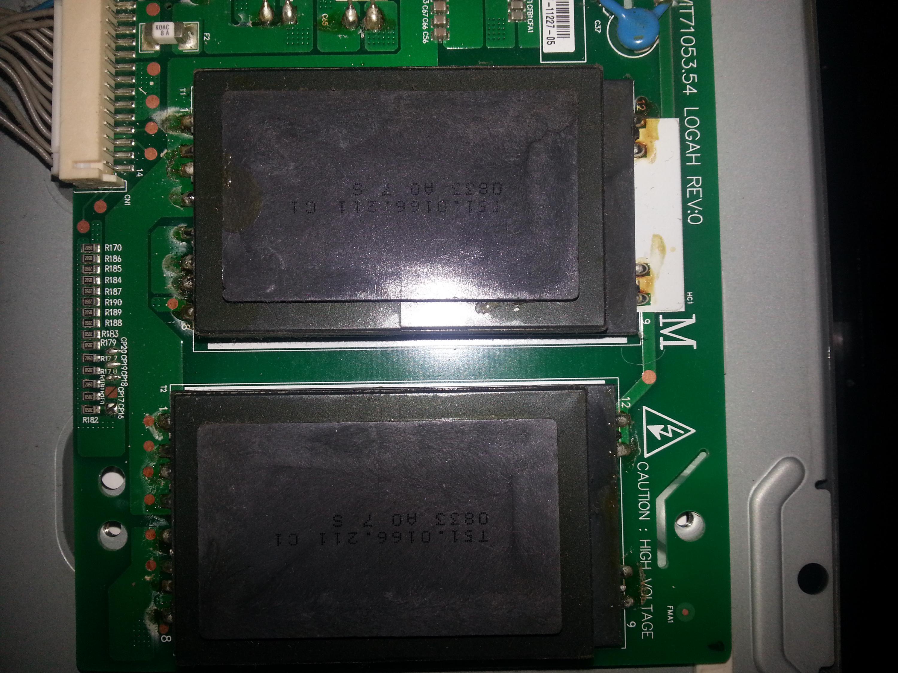

                    roger that . Kinda freaky im watching it in the dark with a torch lol... tried disconnecting slave see if i could get a flash , tried disconnecting TCON no green led . just need to know either

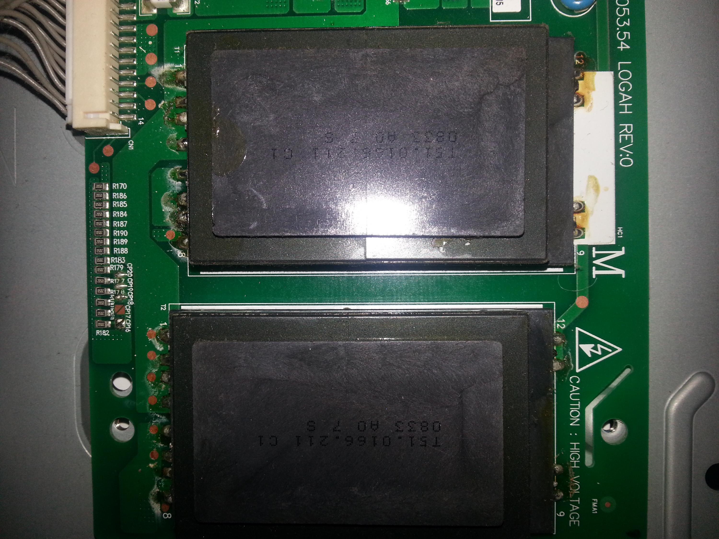

                    1 how to get to ccfl area and check them caps out or check each inverter but dont know what to check for
                    2 how to check psu
                    3 was gonna just get a pair of inverters but reading some of the other threads this hasnt helped, as they dont historically go faulty together youd have thought disconnecting slave i might get 3 secs of life unless master gone.
                      • 31285

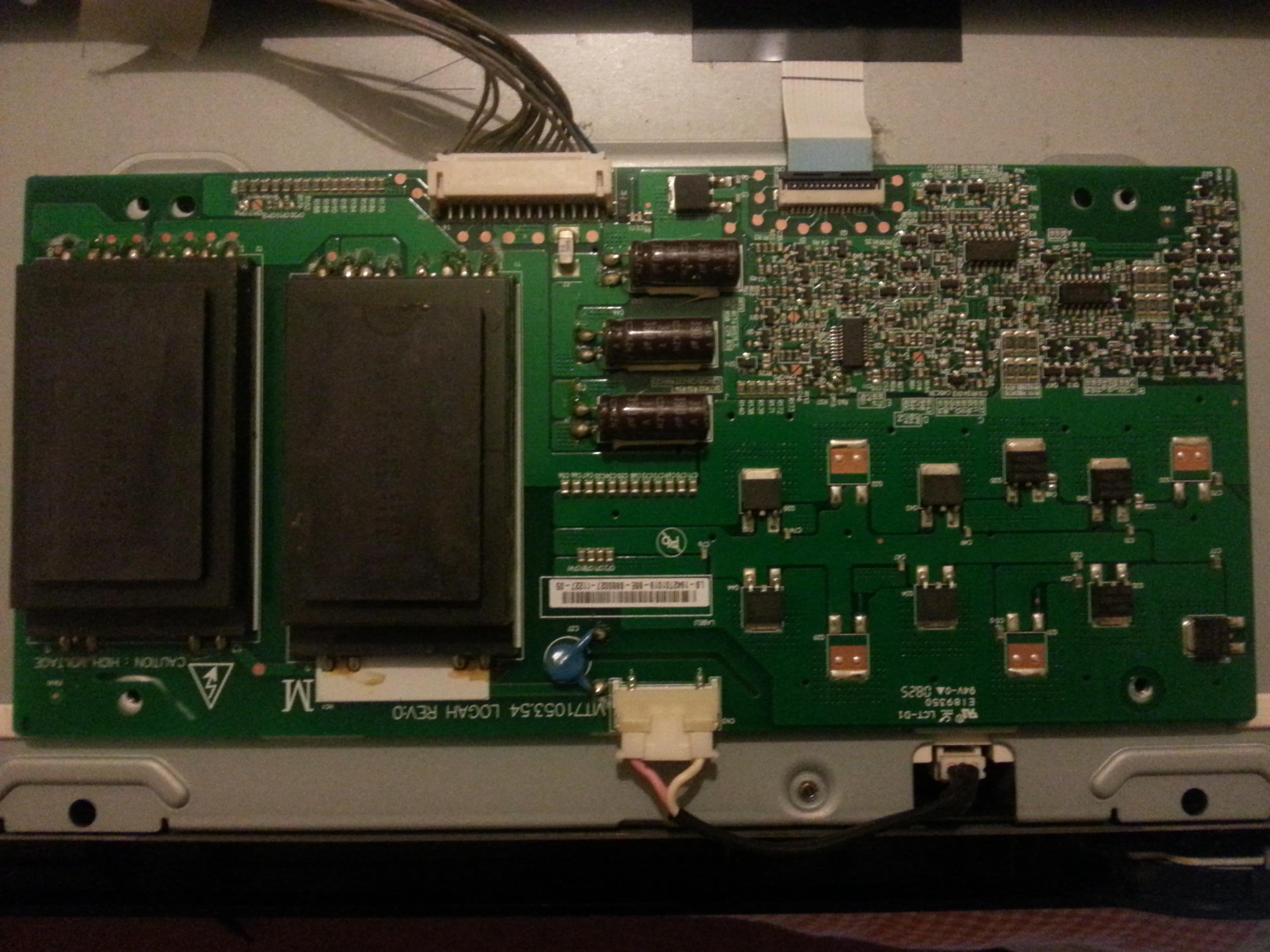

                      Re: LG Help Required 42LG3000
                      that's the first tv i'v seen with 2 invertors!
                      take them out & see if there is anything visibly bad on them under those covers.
                      maybe leave the covers off afterwards.
                      i know some of the large sony's had a design fault where the invertor overheated & failed because of a stupid plastic cover.
                        • 31285
                        check the invertor fuses.
                        small'ish white box on each inverfor marked "F" and a number.
                          Master/slave inverters, quite common for them to go faulty....
                          Check the BL-ON and BL-Dim pins, see what voltages on them....

                            Hi yeah master and slave . covers are off and secured with a single screw. Nothing obvious visually .24.4v pins 1-5 . do you know what the reading should be on the F1 ? just reading a generic LG thread where BUDM diagnosed a bad black F1 which was stopping the inverters firing up. If anything transformers look bit crappy on solder joints but they look same on both sides so dont think thats the issue

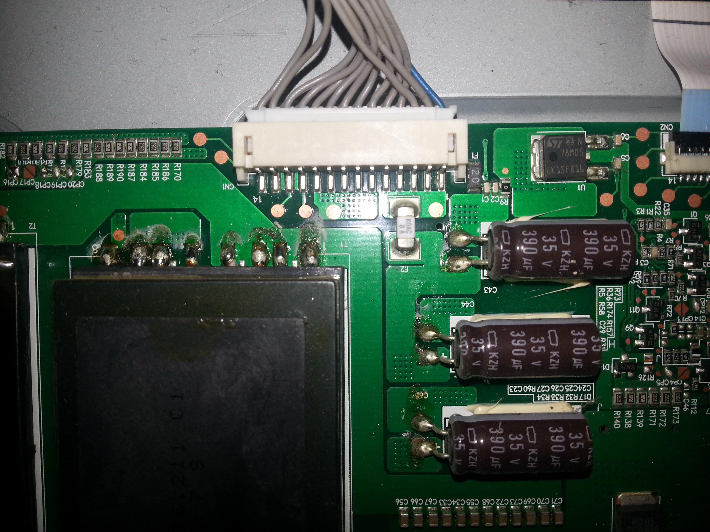

                                Of the 10 odd wires to the inverter, some will be Gnd, some 24V.
                                There'll be two or three that will be marked, BL-ON/BL-Dim/PWM
                                Its the BL-ON and BL-Dim you need to check the voltage on...

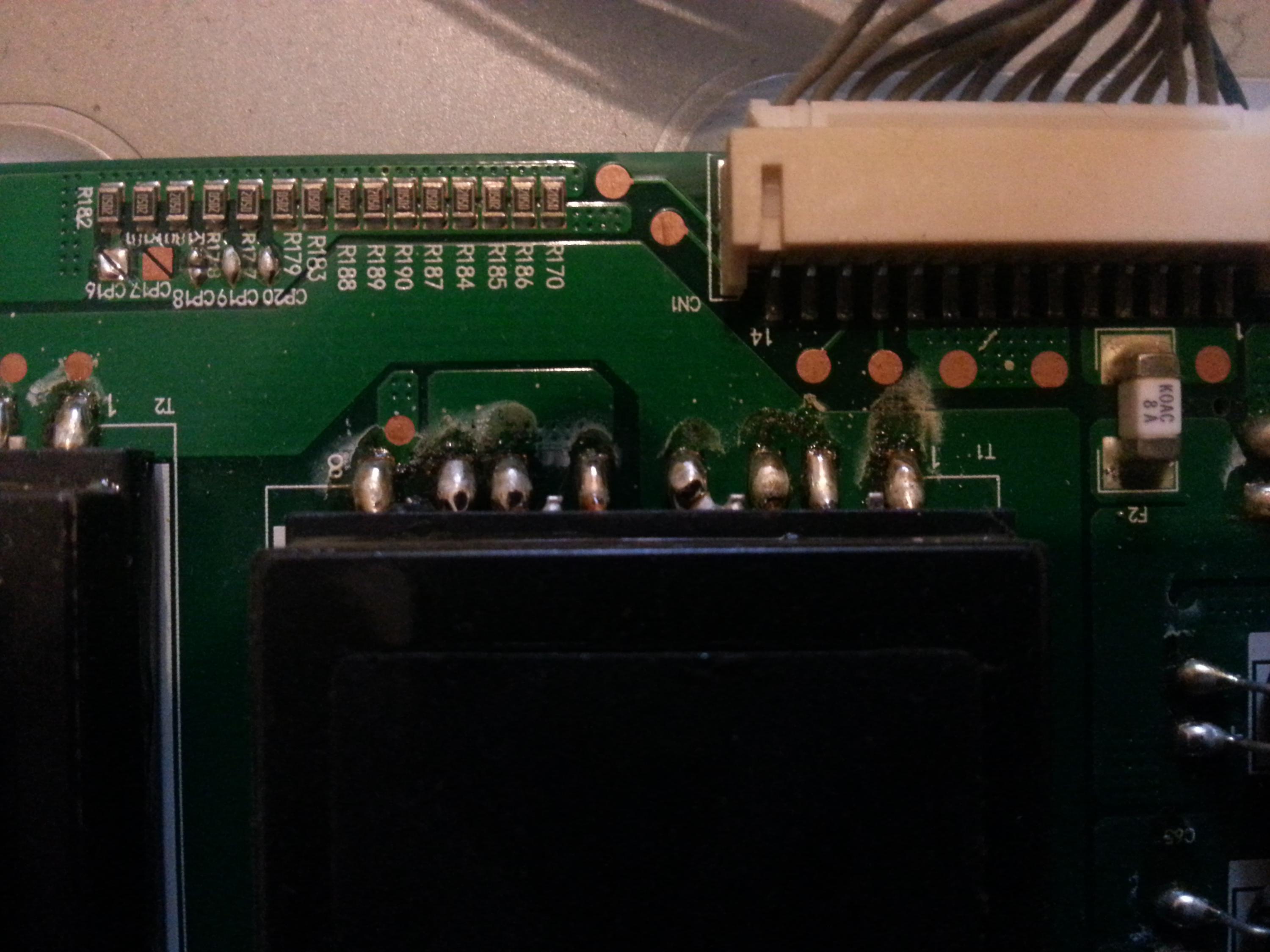

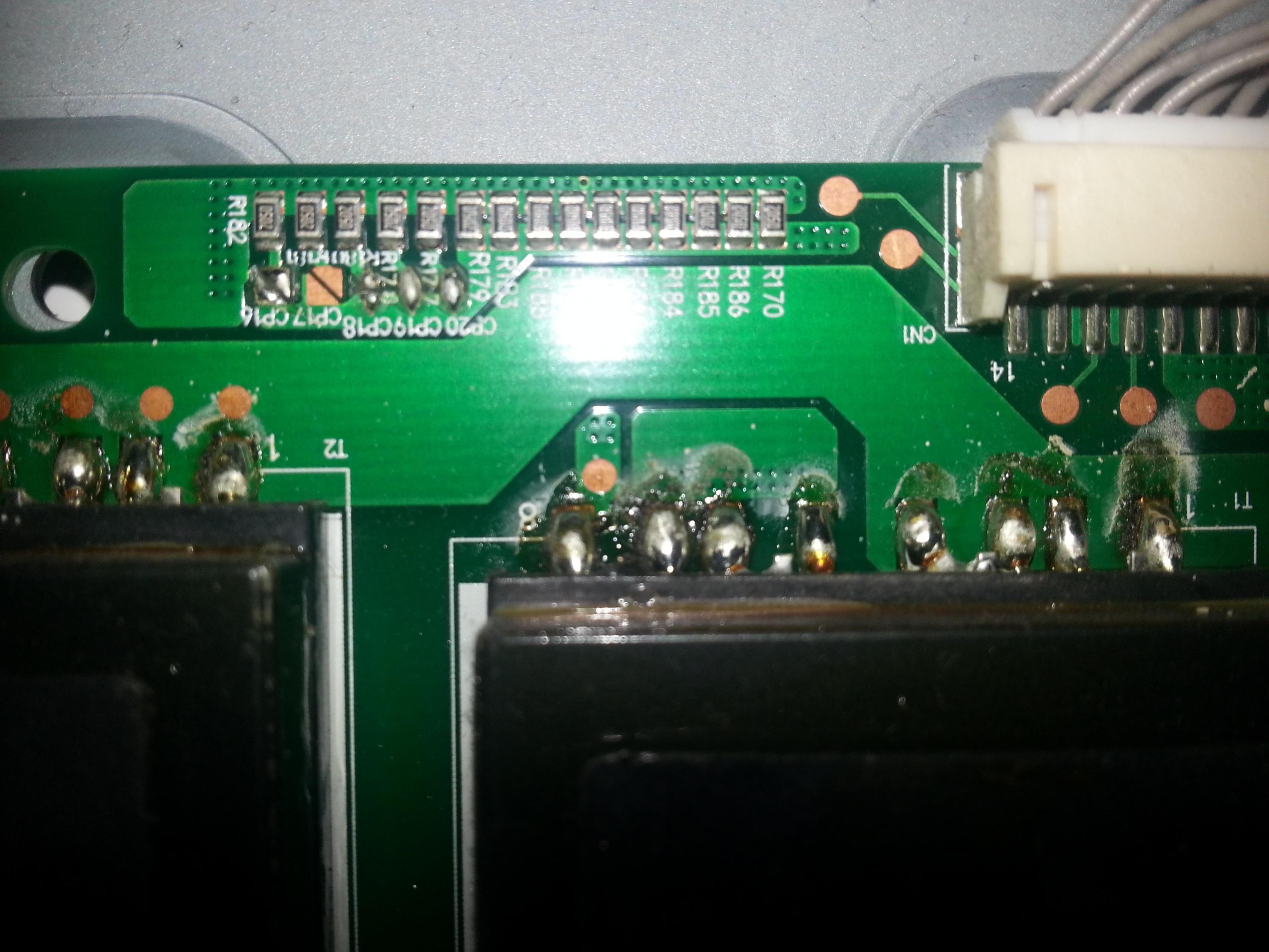

                                  Taken this pic ,, Which is the BL-ON and BL-Dim pins? also the white fuse and black one in pic am i just checking voltage or some other setting?
                                    pins 1-5 24.4v
                                    pins 6,7,8,9,10,11,= 0 nothing
                                    pin 12= 4.8v
                                    pin 13=3.2v
                                    pin 14 = 0
                                      Hmmm the black F1 shows 24.4v one side and nothing coming out of the other although its a tiny end to get MM probe onto
                                        So--with those voltages--Is the light on?
                                        If not--suspect either of the inverters or the BL tube/s its/themselves...
