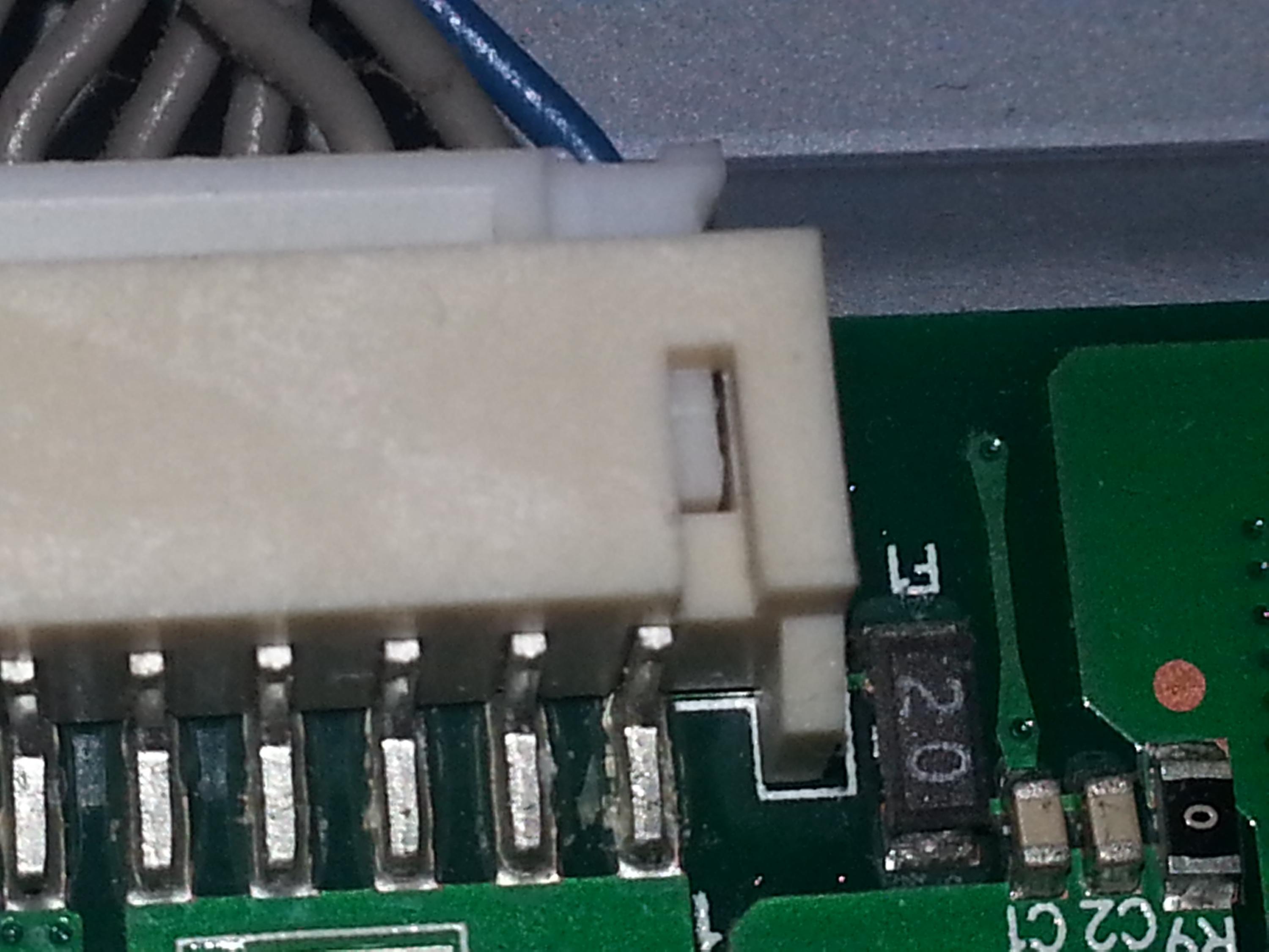

    Are you saying--there's no supply on both sides of that fuse, F2?

      no light on whatsoever never blinks . may seem like a daft question but i should be getting voltage out of other end of that fuse right?

        there voltage out of the F2 both sides but the little black one seen in pic F1 only gives a reading from one end

          Its this little bugger . Im sure ive hit the probe onto the end and a big fat zero.

            With set switched off, check the continuity of that F1 fuse....
            Should be 0 or close to 0 ohms....

              forgive my noobness but what setting do i need the DMM on for checking this out?

                ive put it on a setting that beeps when you stick probes onto the 2 ends of the fuse . however with the F1 one no beep and the number skys it through 1600+ and counting. The F2 beeps and stays at 0

                  BINGO ! just temp bridged with bit of wire and it lit up like a christmas tree.. Any one know where i can get a replacement F1 to fit this set or a replacement part that will do the job? preferably uk for a quick delivery

                    Looks like a 2 amp 1206 fuse
                    £3 all in

                        will this do the job Tom ? if so ill order now , i couldnt fathom if you were saying it looks like or it is if you catch my drift

                          To be certain you should measure the fuse. Check it is approx 0.12" by 0.06". That will be the right part if that is the case.

                            The one you listed didnt seem big enough so at farnells we had a look at pics etc and they thpought these
                            http://cpc.farnell.com/cooper-bussma...23?Ntt=1123256
                            still 1206 case but these ones have a small metal edge like the ones on the board that you can solder wheres the others listed did not .
                            will they do the job anyone?

                                That is the same size, should work OK too. About 2x more expensive though, if that matters to you.
