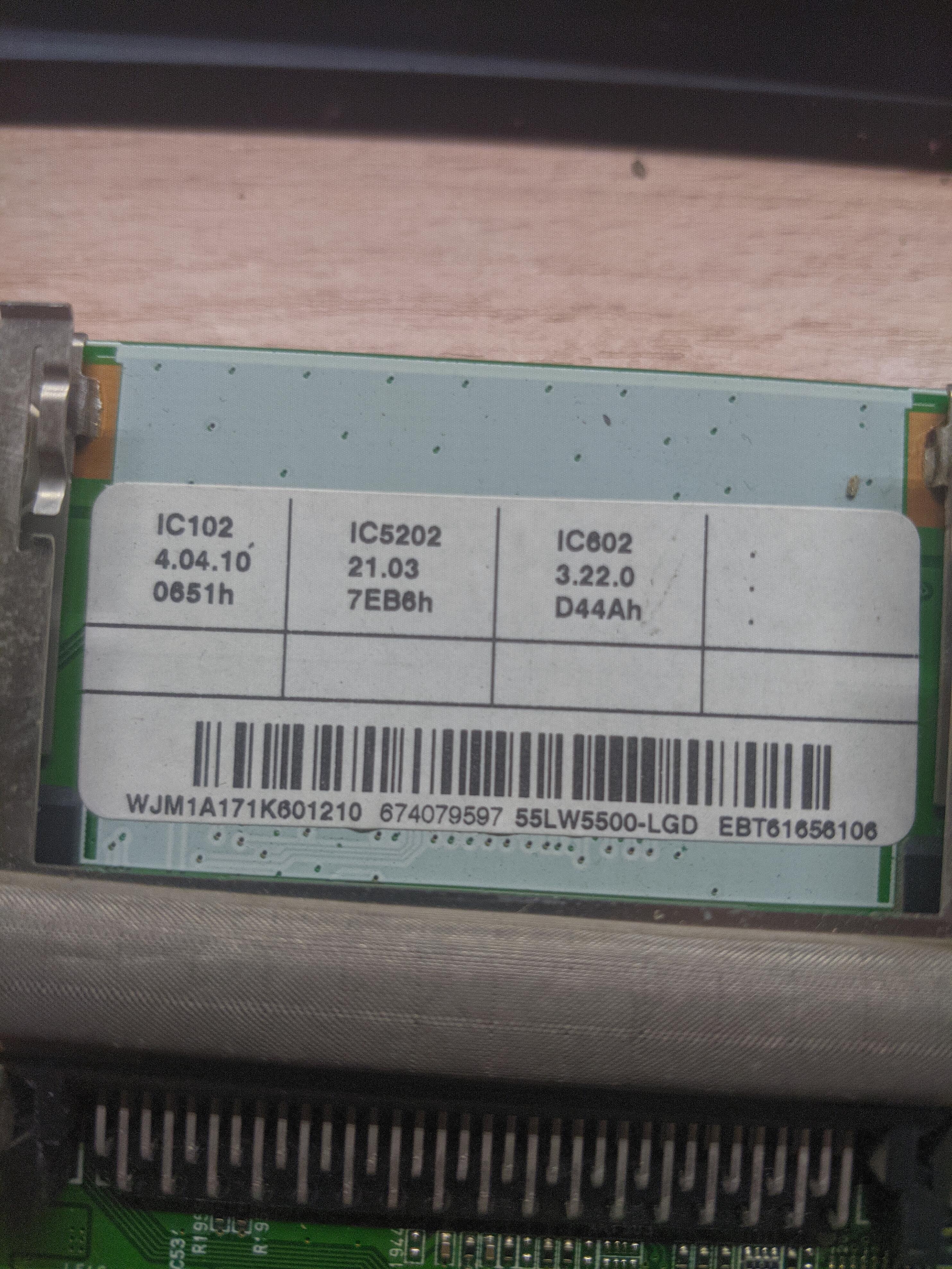

      I don't have the original board anymore, but I do have photos of it's stickers/codes:
      The original board produced purple artifacts all accros the display. However the spinning LG logo and everything else worked perfectly. The problem was caused by the dying URSA5 Extrenal FRC IC. Cooling it with an active fan and bigger heatsink helped the artifact temporarely.

        EBT... is one of the codes, i think this is the most important because it identifies the softwares, artifacts of witch shape? wasn't them circle shape and faded? in that case bad.leds can be..
        • unimatrix93
          • Oct 2021
          • 343
          • Magyarország
          No they were blocky purple like graphical glitches.
          I think I forgot to transfer IC602 from the original board, can this kind of IC be reprogrammed by Ch341A?

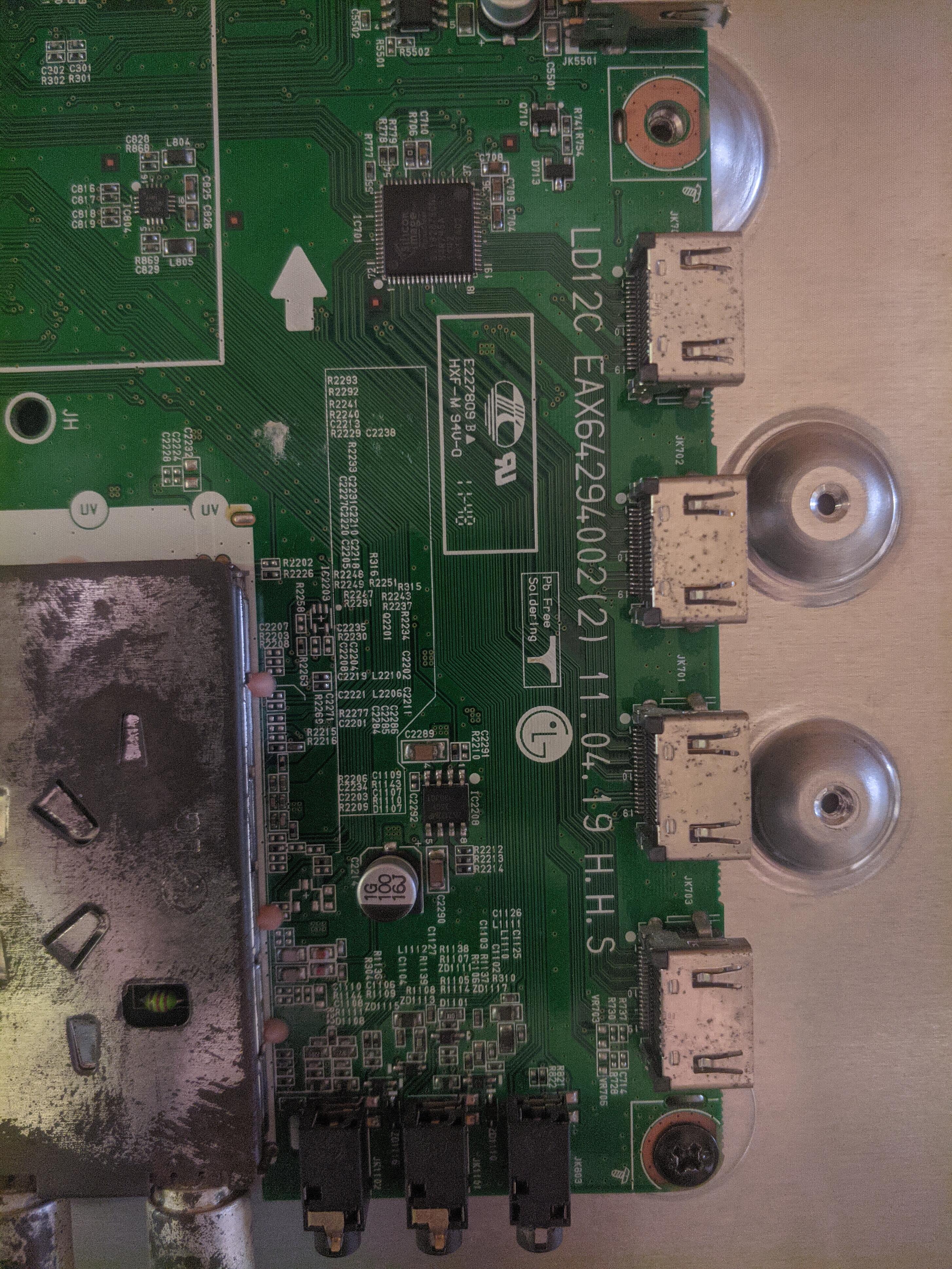

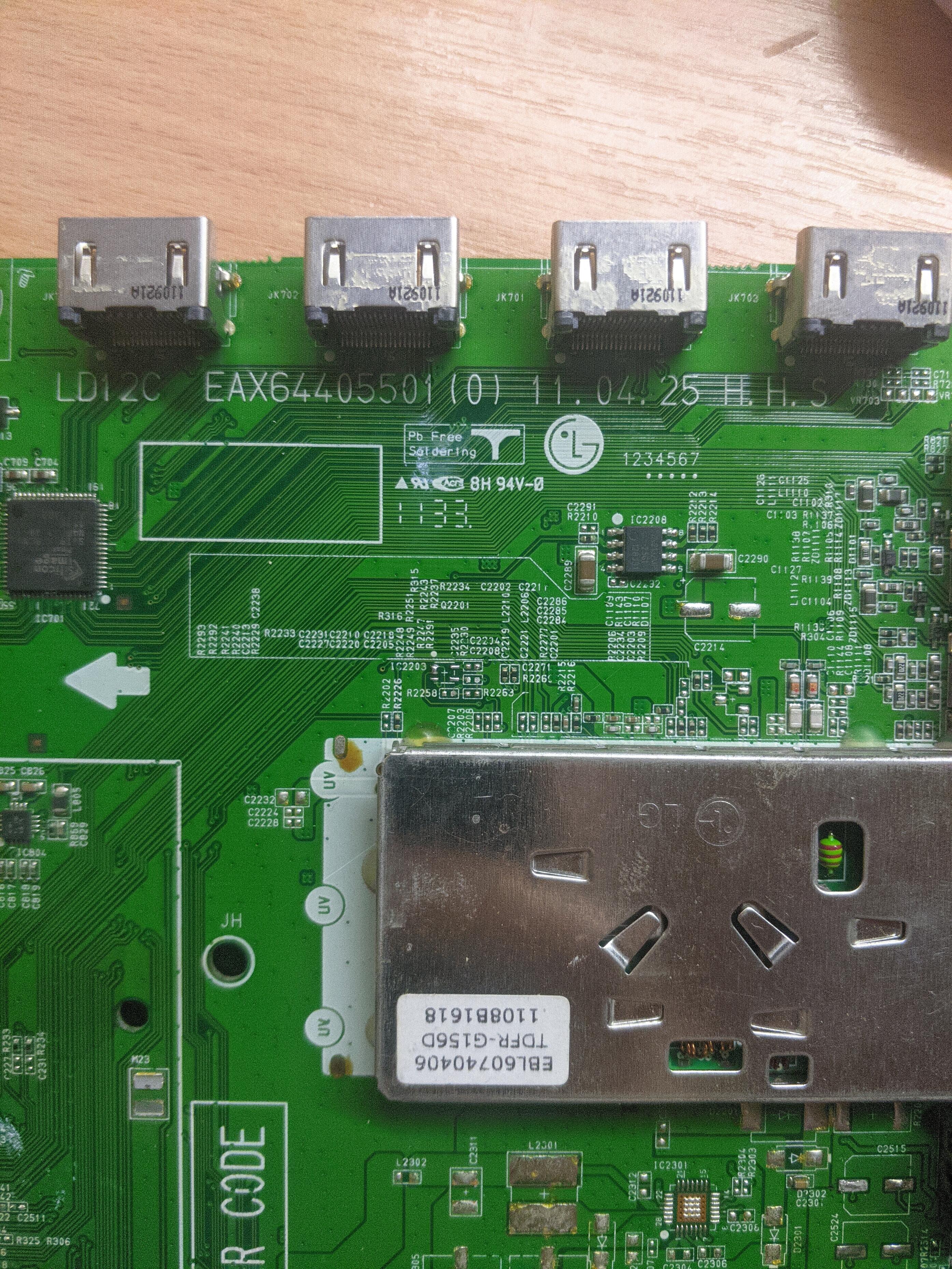

                                      This is the original board EAX:
                                      And this is the new one:
                                      You are right about the EAX, it's doesn't match.
                                      The FRC IC is under the black heatsink next to the LVDS connectors.
                                      I already swapped the TSOP48 package next to the CPU, a Toshiba IC. I removed it back then from the original board for saving it.​
