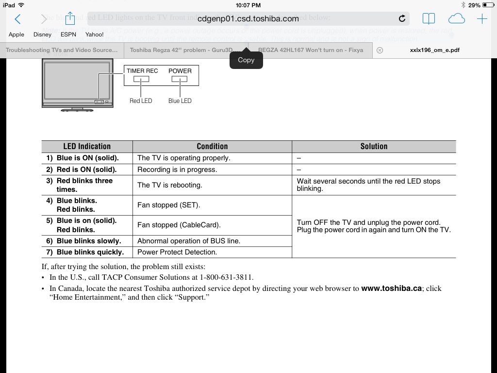

                  also i find this :
                  Note: If the TV loses A/C power (e.g., a power outage occurs or the power cord is unplugged), when power is restored, the red LED will blink while the TV is booting until the remote control is usable. This is normal and is not a sign of malfunction.
                  ok i dont have a remote control so if i read the manula right then LOGICALLY IT WILL NOT BOOT WITHOUT REMOTE CONTROL PAIRING WITH TV ?????????
                  omg iam having headache with this what u guys think can the problem be the remote ???

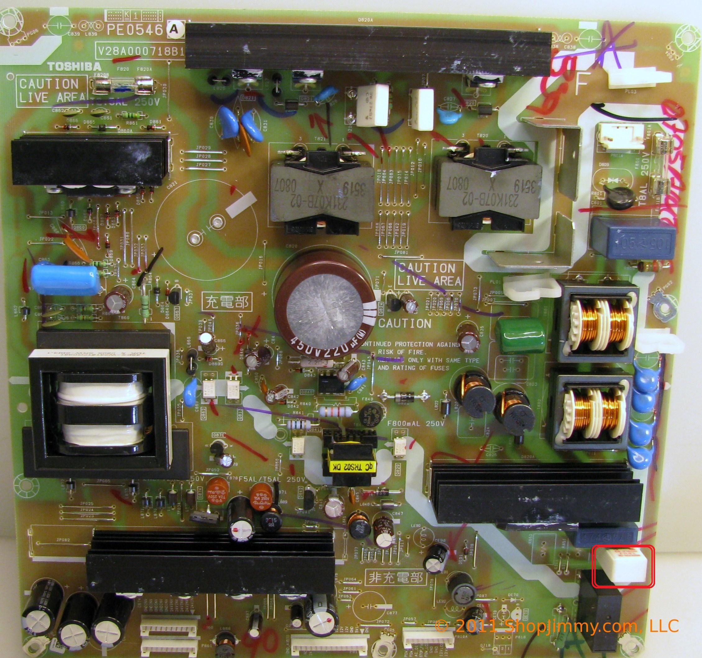

                    I picked up one of these from the recycler yesterday, one 5w 1.8ohm resistor later and I have yet another TV. It blinks at startup if it has been unplugged. The remote won't work while its blinking. It doesn't need to pair or anything. After a few seconds it goes back into standby and will work with the remote.
                    During initial testing I noticed 2 fuses on each inverter board have you verified the inverters are getting 24 v supply to turn on backlights?

                        Maybe you can check that resistor on your original power board and see if it is bad. It may be easier to fix it if your new board has some other fault. Attached pic from shopjimmy with resistor in question circled in red. Like Alastair said dont stress over it, I find troubleshooting tvs very relaxing.
