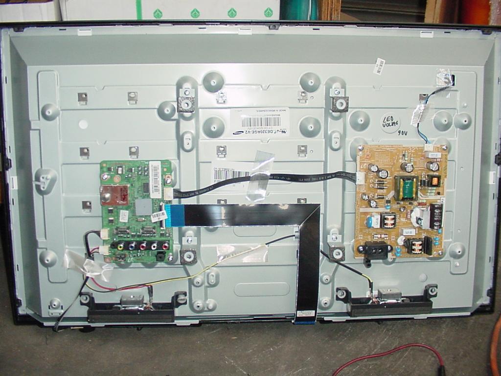

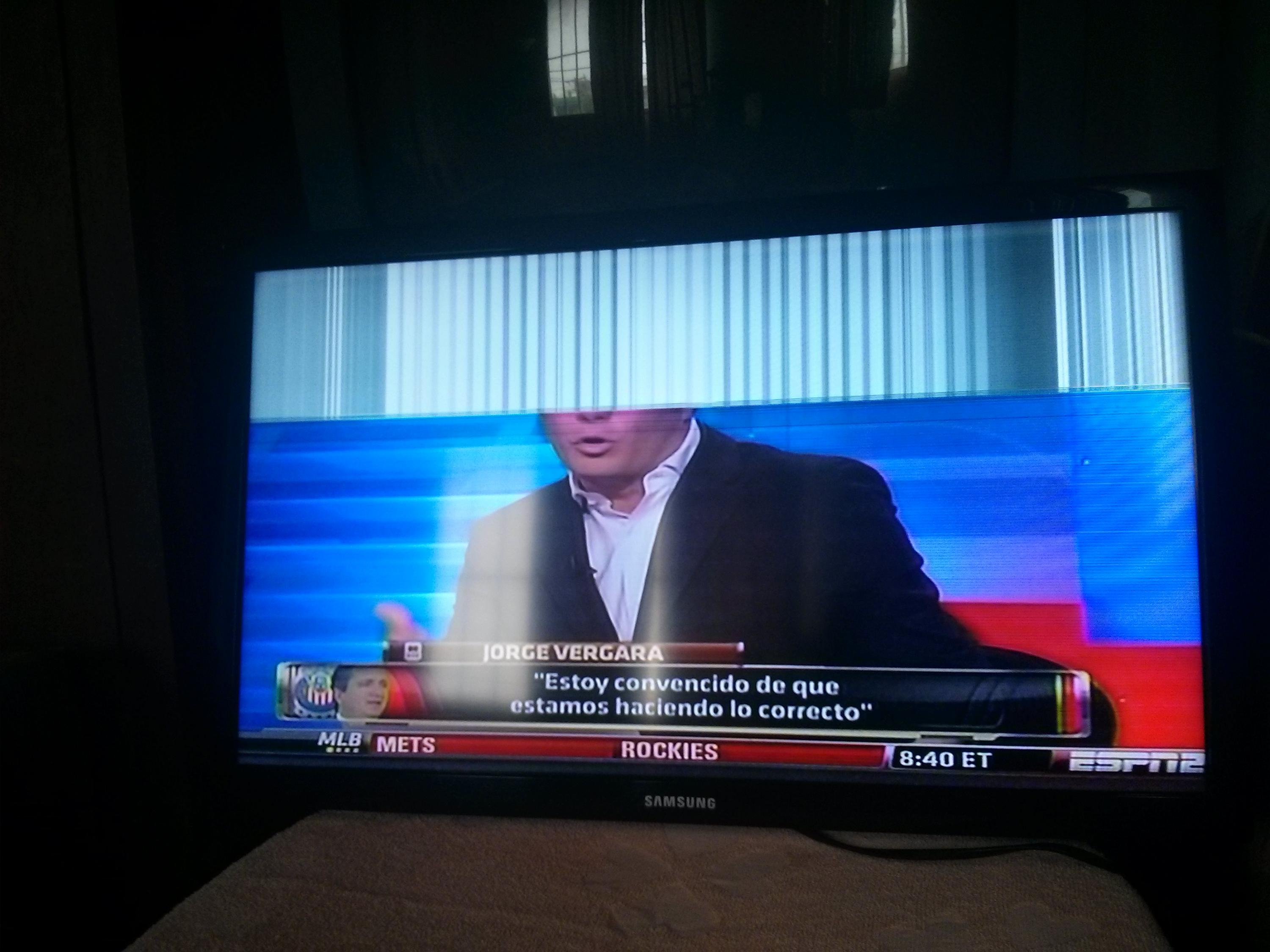

    Hi, long story short, about 2 weeks ago there was a blackout in my neighborhood, then when i powered on the TV, it showed some strange thin purple/green lines at the top of the display, after 2-3 hours of use those thin lines became really visible and the top part of the display became white.
    took it to a workshop for diagnose and the guy told me there's no fix for it, that i should look for a broken one and replace the whole display unit cause the "flex lights" (thats the word he used) are broken, so i've just took it apart and i can see the back panel completely lit, from top to bottom completely white light so at least i know the LED panel is working fine.
    Questions are:
    Could this be a problem with the logic board or the power supply, and could it be fixed just by replacing one or both of them? cause ive found a cheap one, exact same model with a broken display i could use for parts.
    Could this be a problem with the LCD controller board and maybe thats what the guy was refering to? cause that board has a ribbon cable that goes directly into the LCD display. attached some images, my Tv and some other ive found on another thread.

    I would think its a tab-bond issue by the look of it....

        There is a chip "glued" to the ribbon tab,just before it disappears into the screen itself,that's probably shorted...
        plz wait for someone with more knowledge to chime in to confirm or defuse my statement...

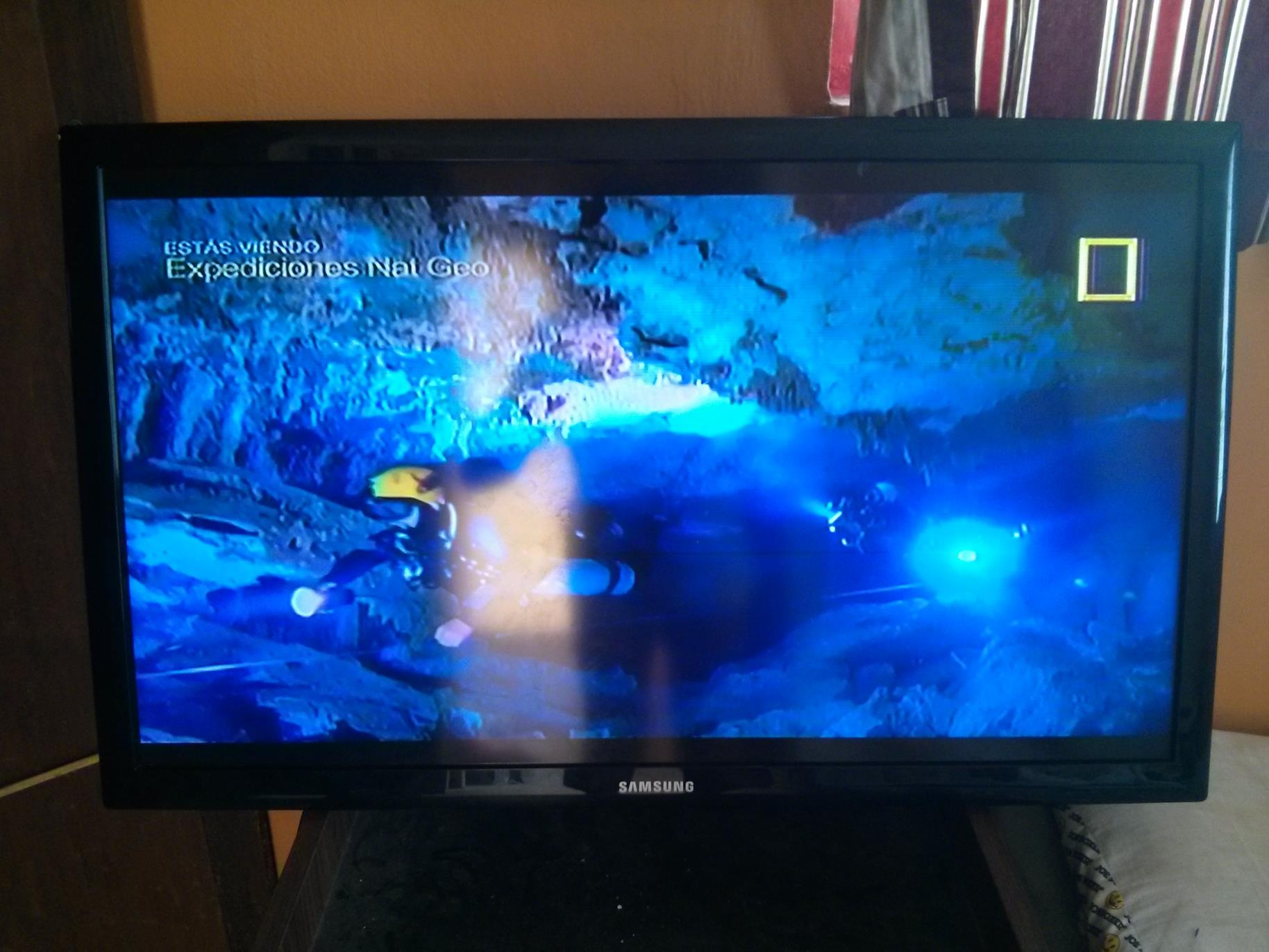

          well, i let the Tv untouched and ujnplugged for about 3 weeks, this morning i did just a test, and to my surprise, it looks "fine", however, after 10-15 minutes, neon coloured lines starts to appear again in the same area.
          Does this mean it's just a bad capacitor that, after been completely discharged makes the Tv look fine? any ideas before it goes into the trash?

            Bad panel, tab bond fault.
            May or may not be fixable.

              correct me if im wrong but, if it looks fine for 20 minutes, then its not a bad panel isnt it? ive checked the tab bond, gently wigling to see if theres any change on the image but nothing happens.

                    Yes, it is a panel fault in my opinion.
                    Some people can fix them by shimming them. For some panels, this lasts years and years with no problems. For the vast majority of Samsung panels it lasts a couple of months tops.
                    There are also chips inside the panel now (called "Gate in Panel" technology) which also can fail. Not even a tab bond shim will help you there!

                                  Well, after a long hiatus, im back on my last attempt at fixing this tv... asked a local guy for his opinion, and after 2 days he's positive on the buffer board to be fried, so, is a matter of either replace the shorted IC or replace thw whole board... any idea on where exactly is the buffer board on this model? ill attach a pic, i just can't see where is it supoposed to be, im looking for any chip with a heatsink on top but i may be wrong.
                                    Re: Samsung UN32D4003BD display has black line
                                    you need to fire your local tv guy...bufferboards are in PLASMA tv's,yours is NOT a plasma.
