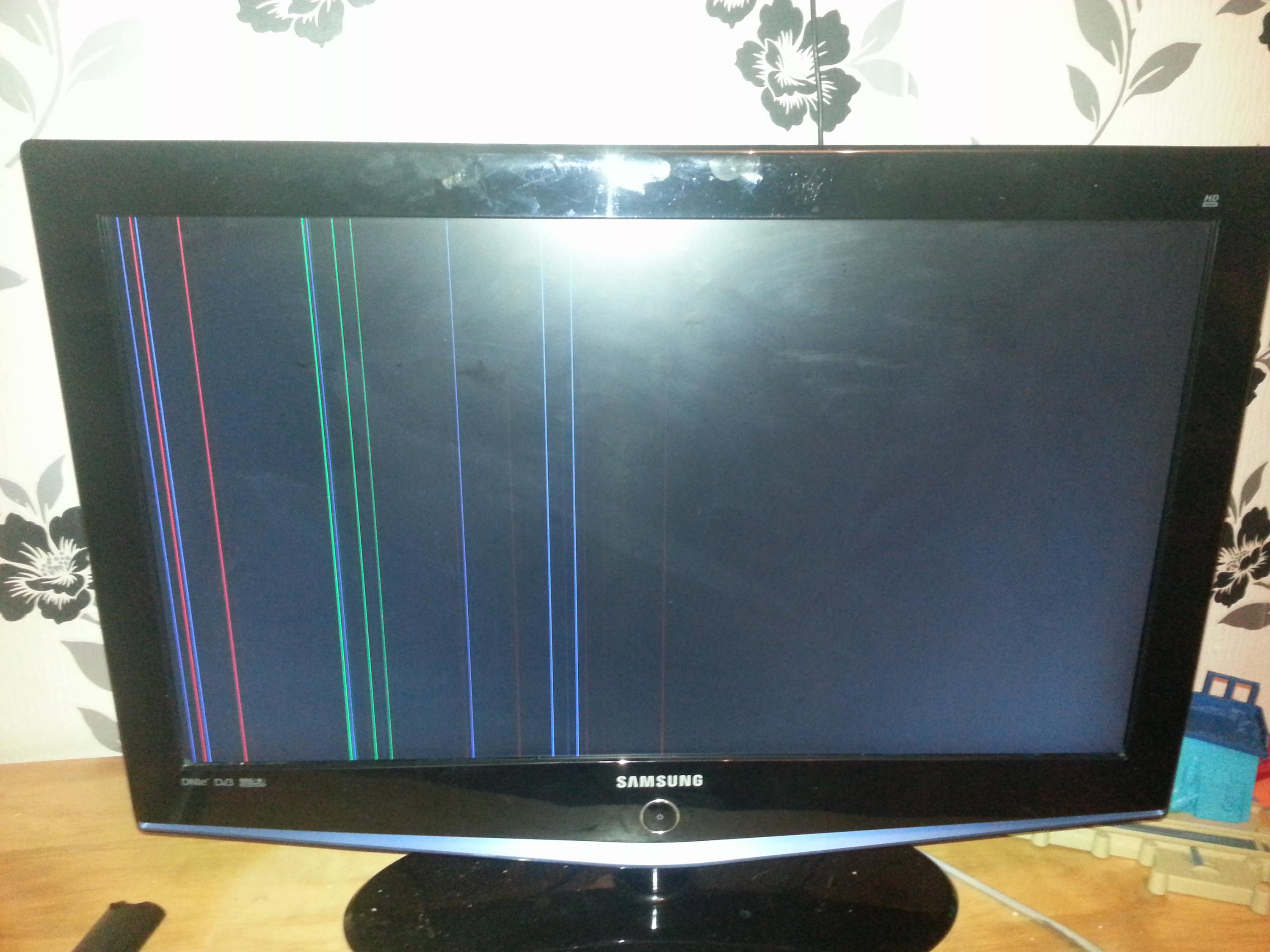

    Hi all, hope your all well.
    ok i picked up a samsung le32r73bdx i was told it wasnt bringing up a picture but had sound, the picture appeared when warmed up.
    i opened the tv spotted some bad caps and replaced them, i gota a picture for a bit, but distorted. i replaced a few more including the main cap turned on worked great for around 2 hours, then the picture went and all i have is a few red green blue lines on one half only...
    i thought maybe this is bad tabs all along but opened right up and tried tapping them to see if any thing happens. nothing just the same.
    so whats left? the t con? main board? maybe bad sm caps on main board?
    any ideas?
    Re: le32r73bdx loses picture has sound and some lines
    A picture of the fault would help us.
      hope this helps?

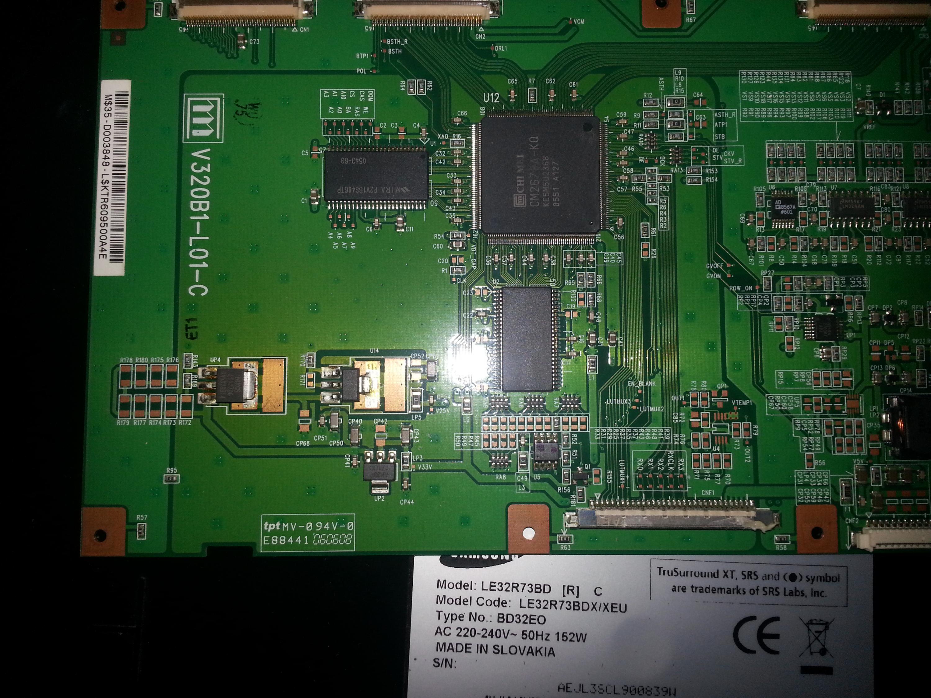

        I've had that before intermittent voltage regulator on t-con (on a LE40R73) -- post a pic of your t-con.
            tv is on with sound but no picture or menu

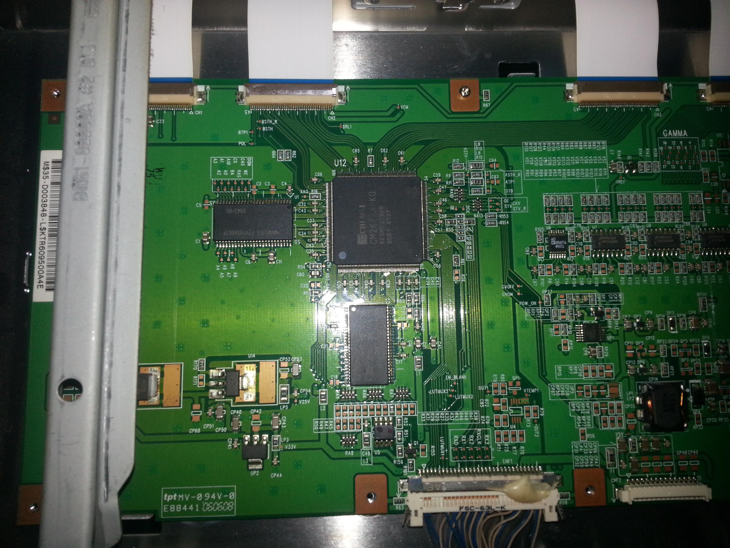

              give me 5..need to take cover back off
              • charlierfc
                • Mar 2013
                • 93
                • scotland

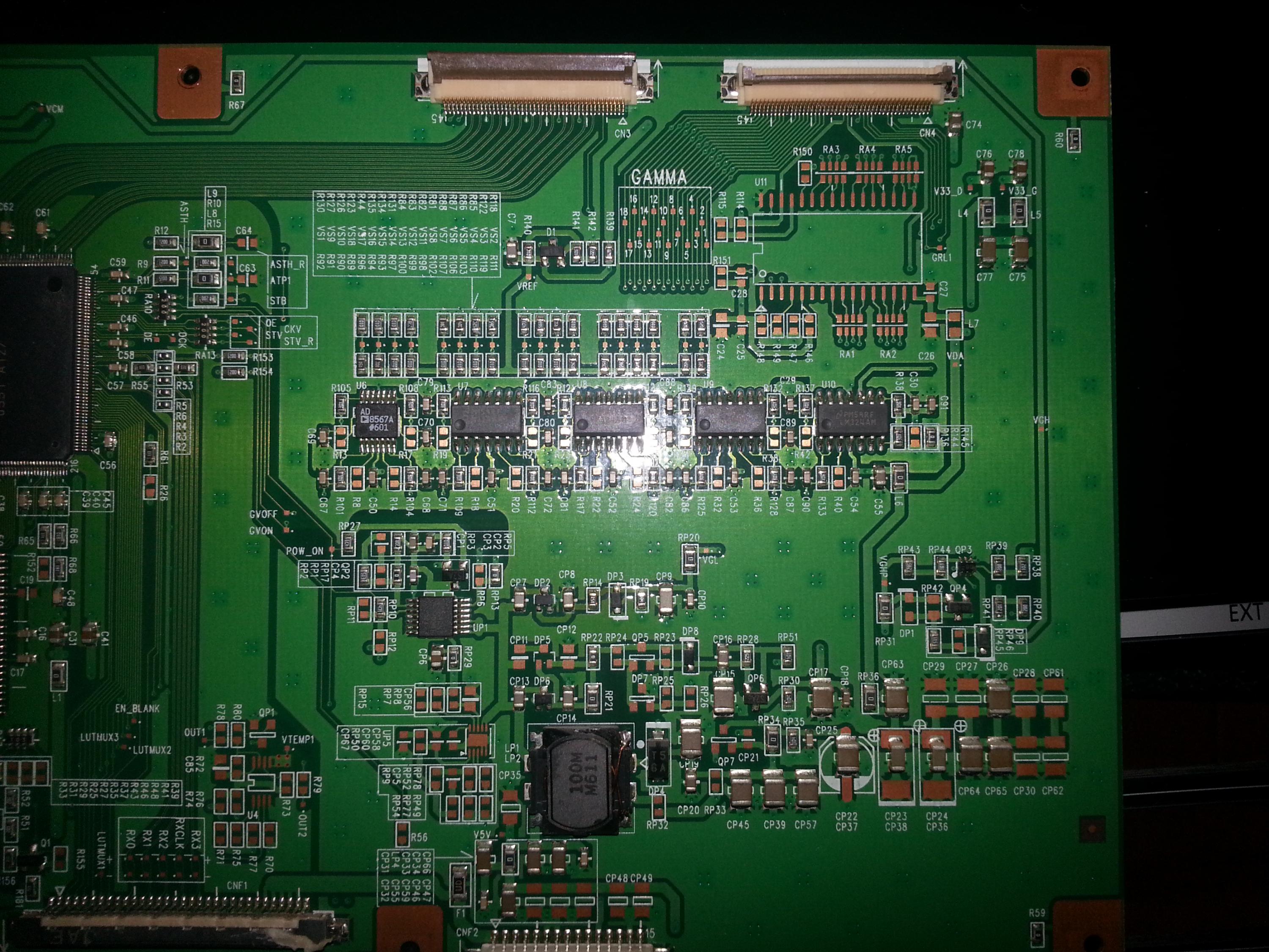

                these ok?
                • charlierfc
                  • Mar 2013
                  • 93
                  • scotland
                  these?
                    Yours is different but it might be the same problem.
                    With the board installed check the voltage on the UP4, U14 and UP2 voltage regulators - use 20V DC range with red probe on each pin and black on chassis. Also note the part #s of each. If possible get one reading when faulty and one when working.
