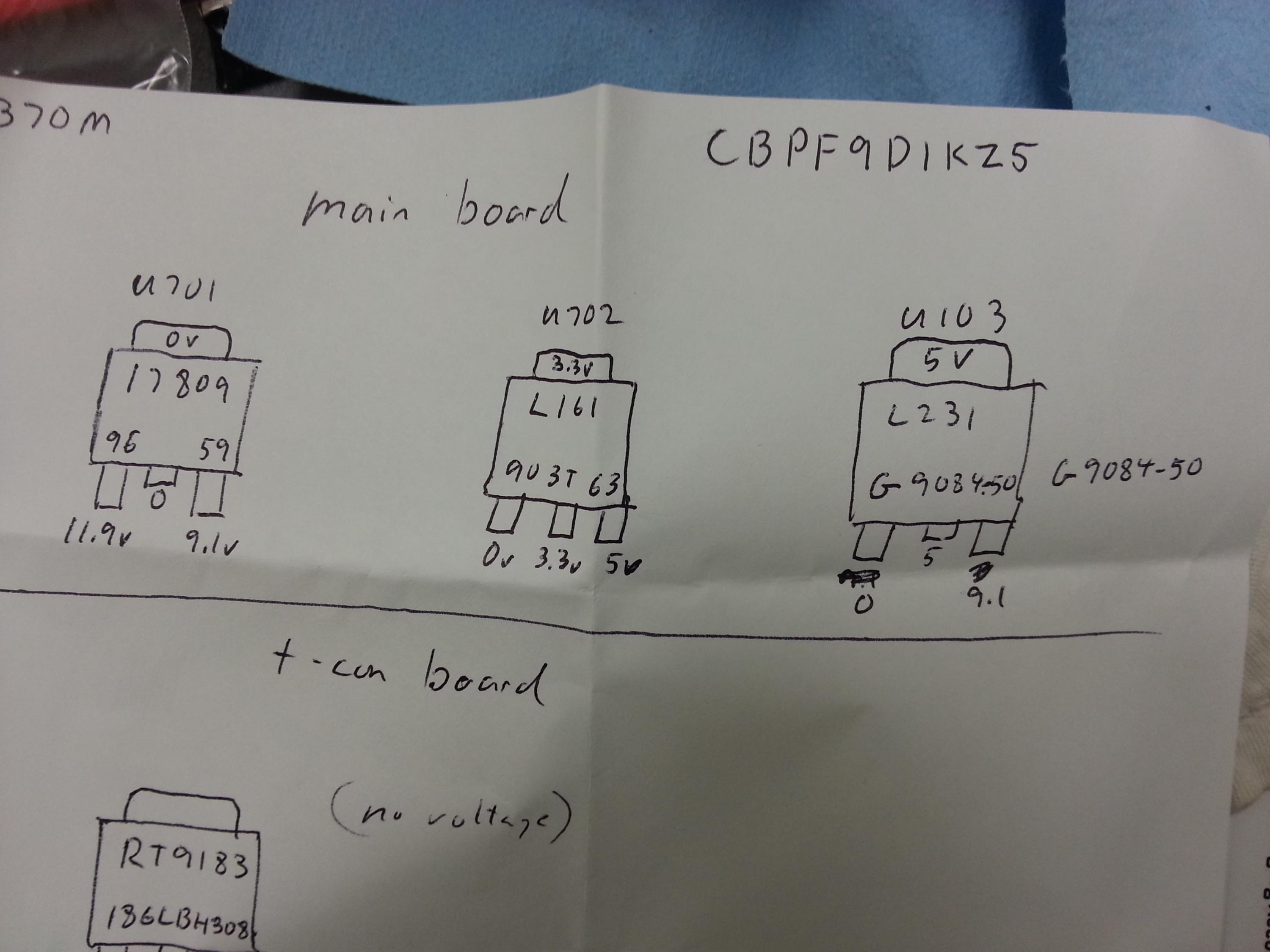

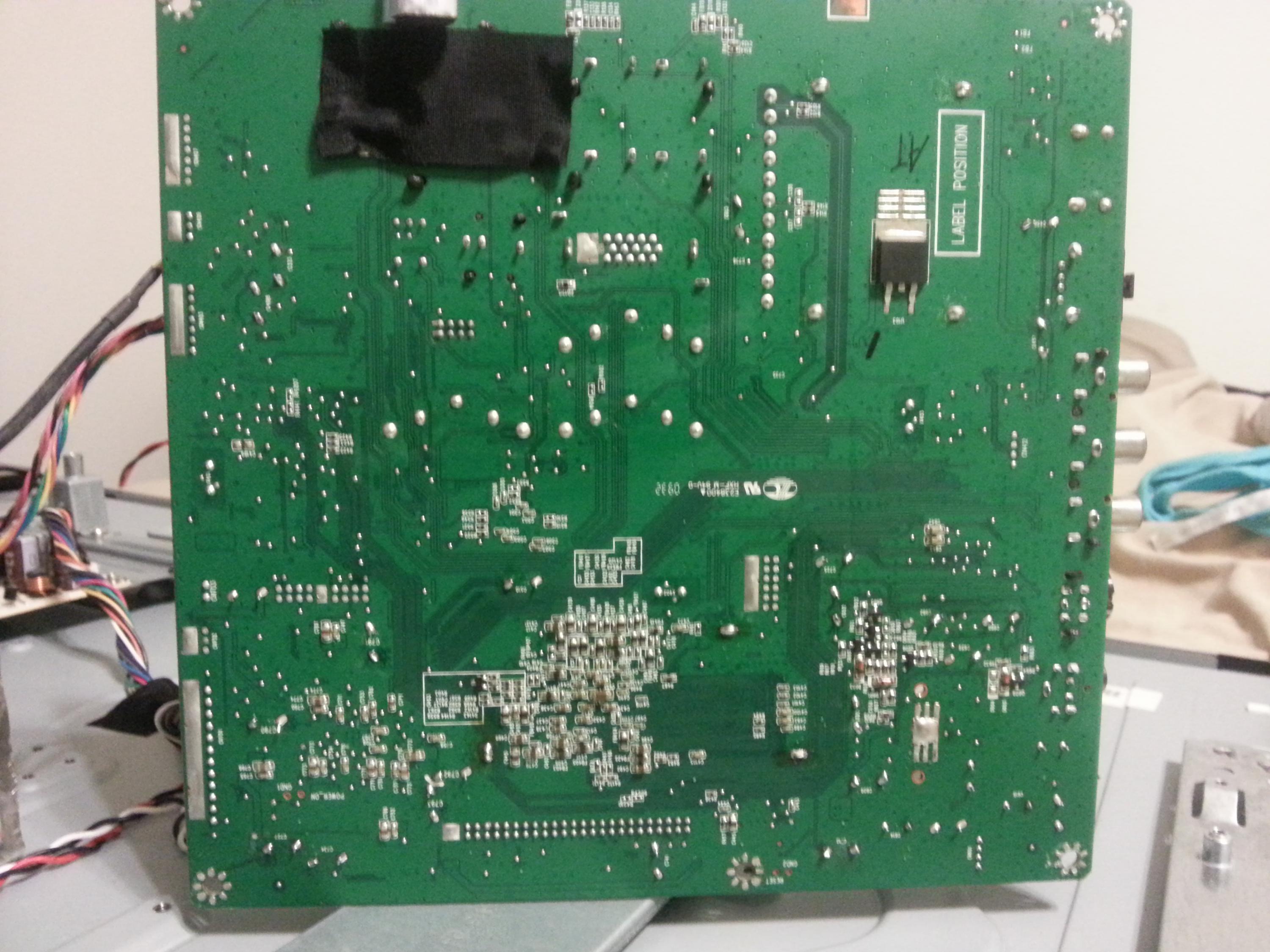

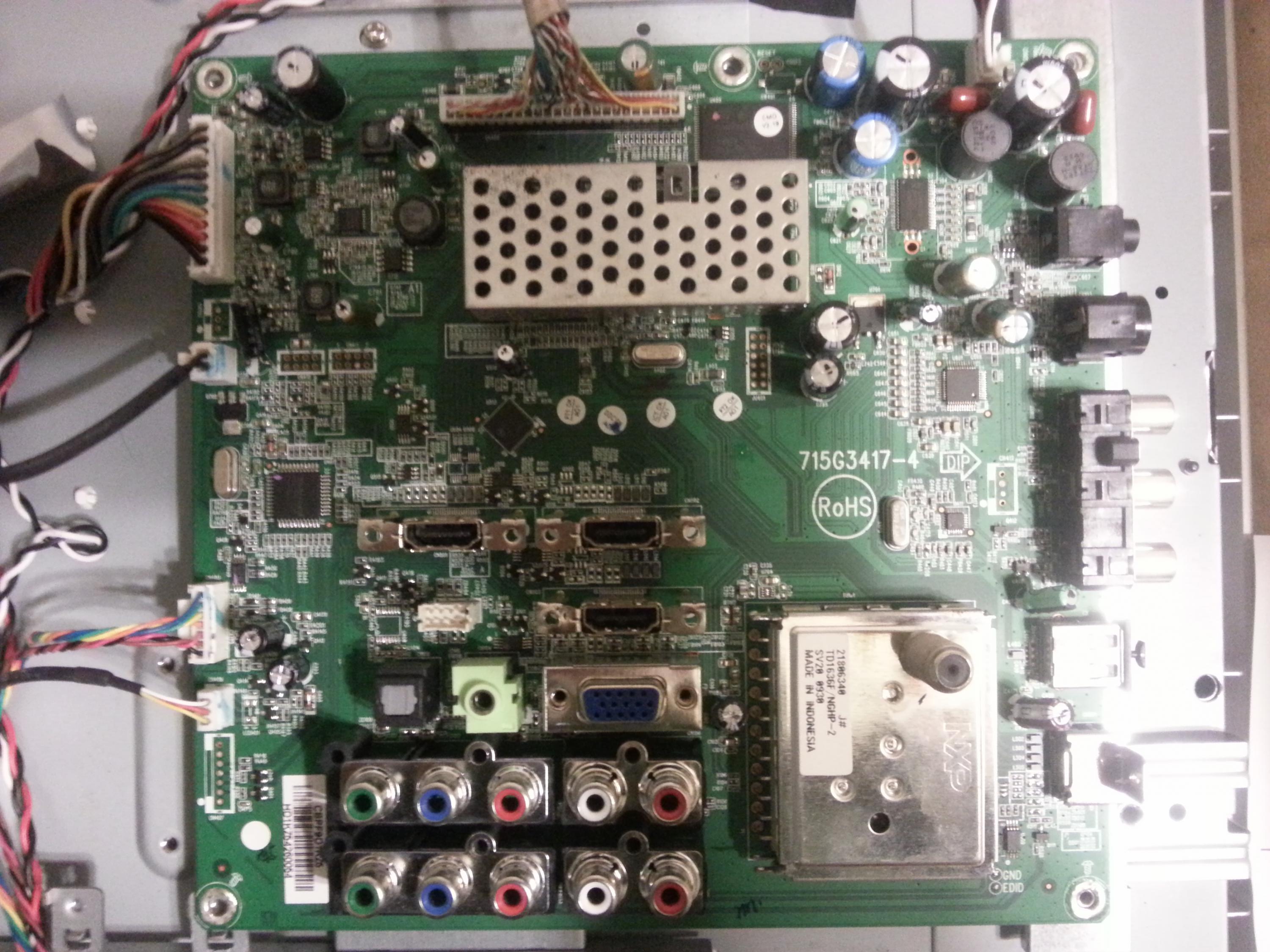

    Hello, any help with this would greatly be appreciated. I've read through the post on testing voltage regulators but am still having some trouble decoding these in this Vizio VA370M. I've checked all I could find on the main board and have attached notes for review. Also, I can't decode the numbers on them to determine what type I'd have to replace them with if in fact they are bad. I'm assuming they must be fixed because none of the values are 2.5v difference. I'm convinced the issue with this tv is the main board because the visio logo (not the one on the screen) does turn to amber when the power is turned on but no picture. Also, it does turn off. I show no voltage at the t-con or any other board when the power is on. I've read in these forums that voltage regulators are a common problem in vizios so I started with that. The main boards # is CBPF9D1KZ5.
