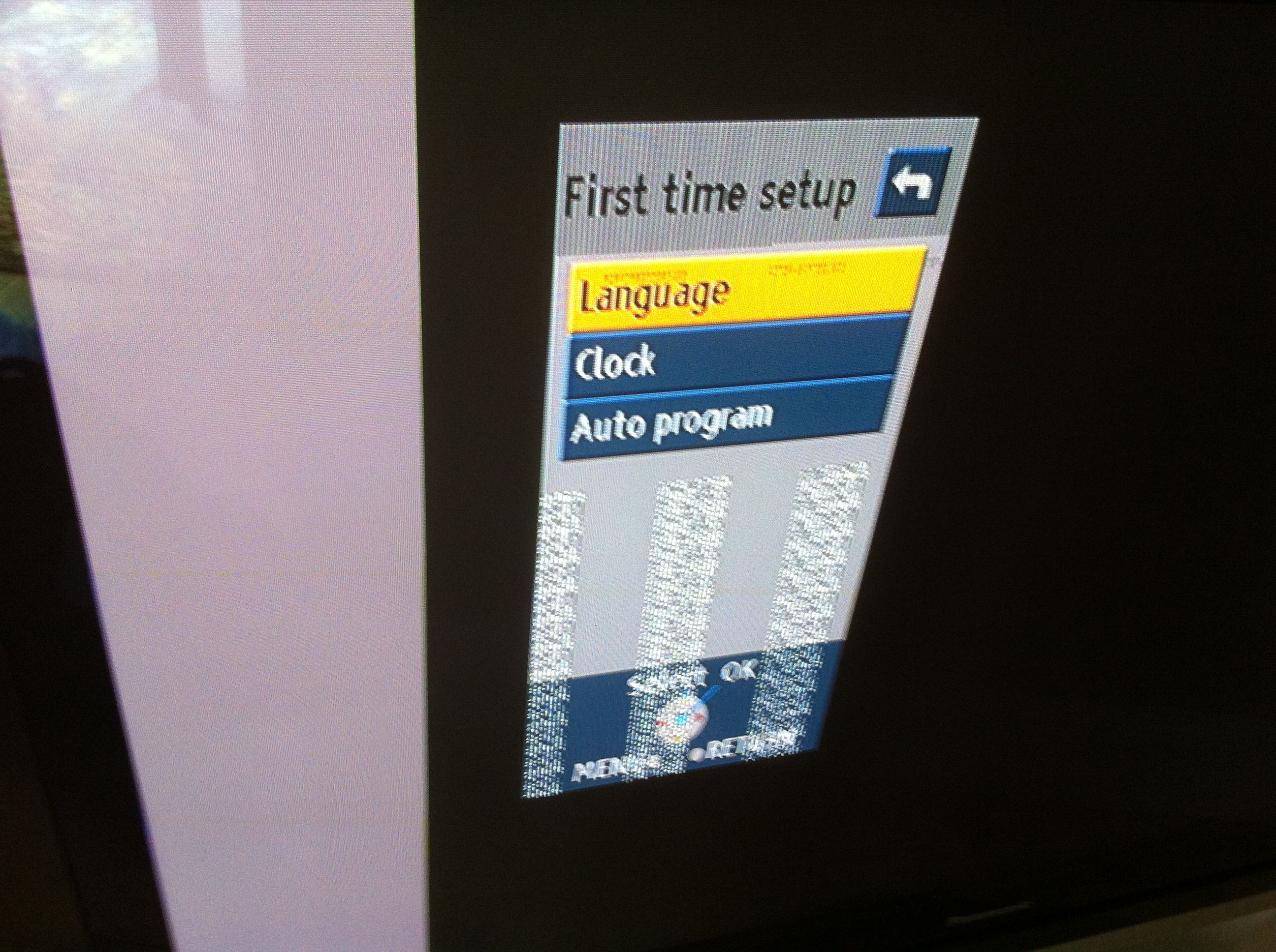

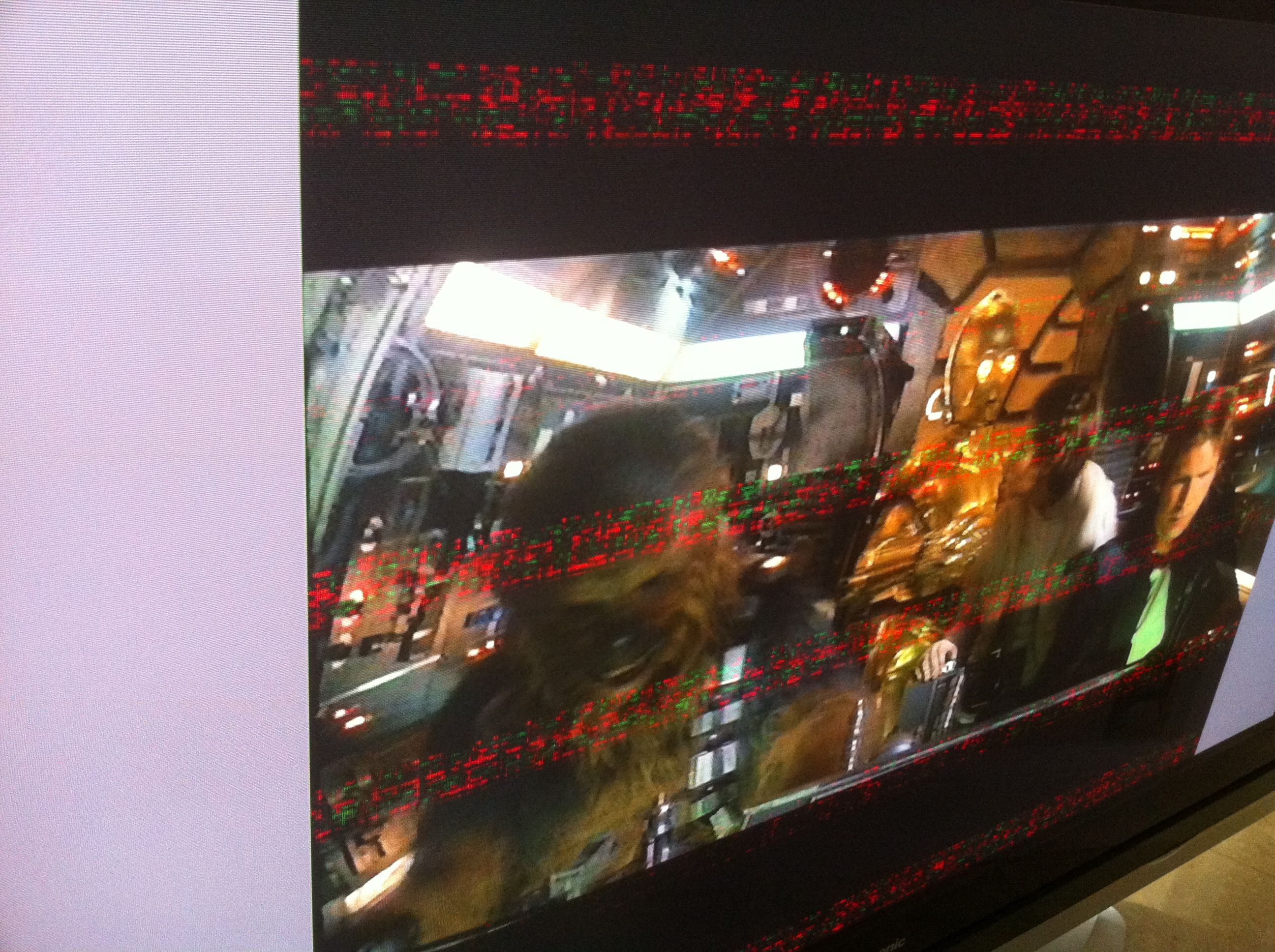

    Hello everyone. I've been scouring the internet trying to fix my trusty 50" Panasonic plasma TV (manufactured in 2005). I know it's old and not worth much money, but after perusing the internet on how to freecycle it, I found someone who really pleaded for people to fix them; otherwise, there was a high likelihood it will end up in landfill.
    Attached are pictures of the symptoms. At first, all the internal menus started bit smearing vertically (see IMG_0628). That was tolerable, but eventually, red/green horizontal lines appeared, scrolling up the screen (IMG_0629). Eventually, the lines worsened to the point where I couldn't tolerate it anymore.
    After researching (this forum and other websites), I bought upper and lower Y buffer boards and swapped them out. That didn't work, so I bought a Y-SUS board and swapped it out. At this point, I could do the same with the Z-SUS board, but given my track record, I'm not sure if it's worth the expense.
    Any advice appreciated. I am very close to sending it to the recycling center.

    No that's a main board problem. Probably a faulty BGA connection on the main IC. Try a can of freeze spray on the main board ics and see if the problem dissappears..This board is the one with all the connections going into it.

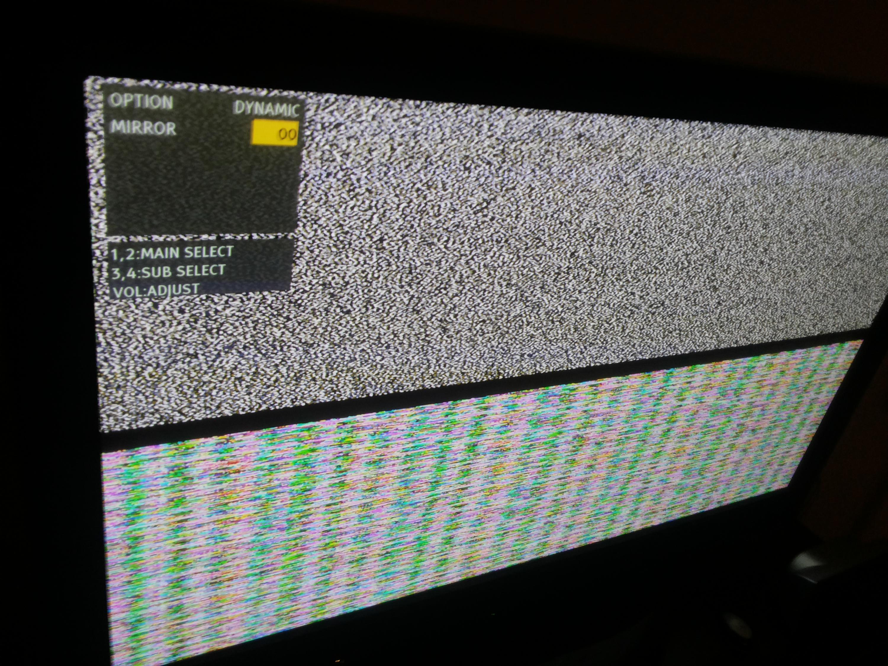

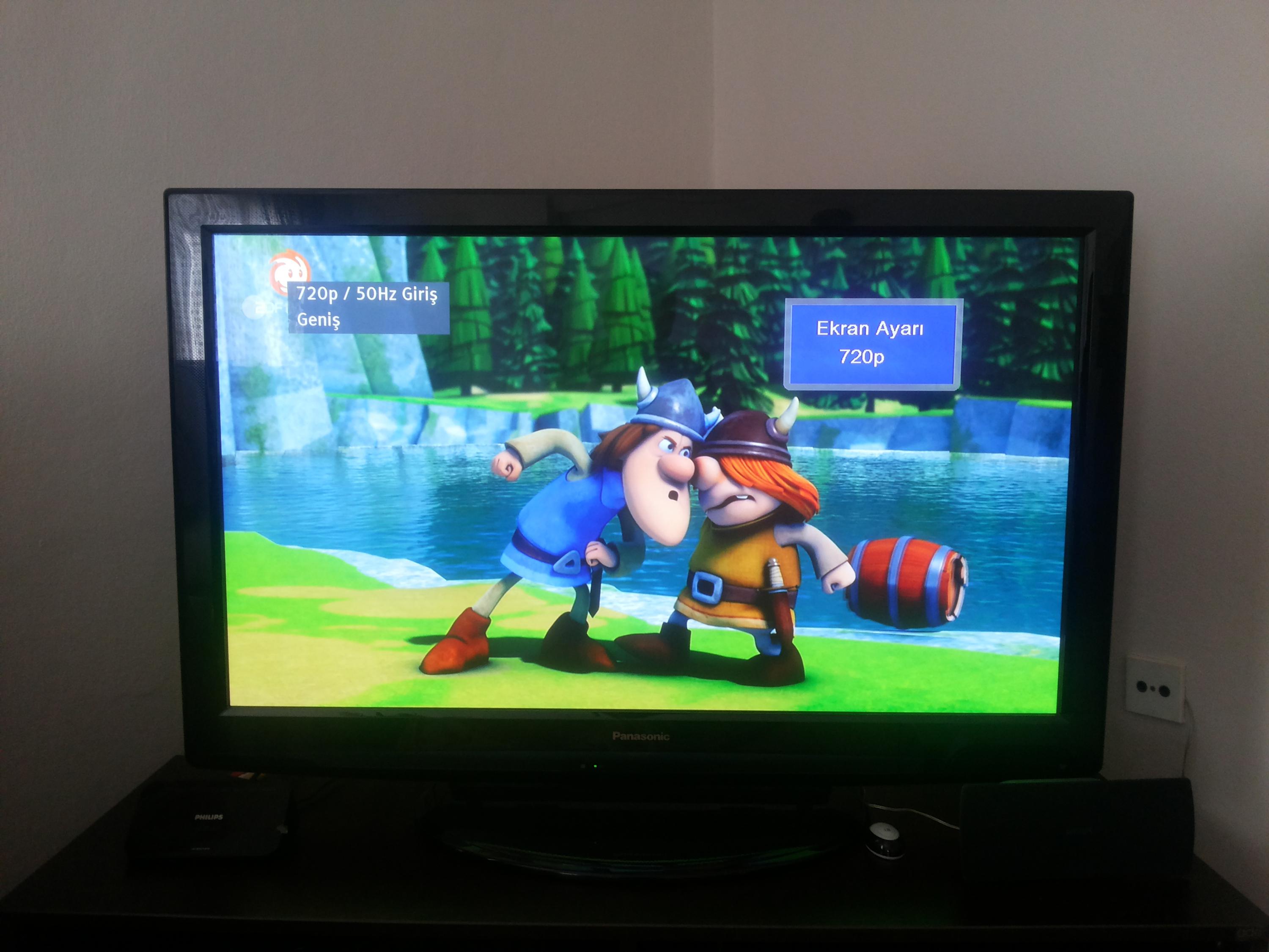

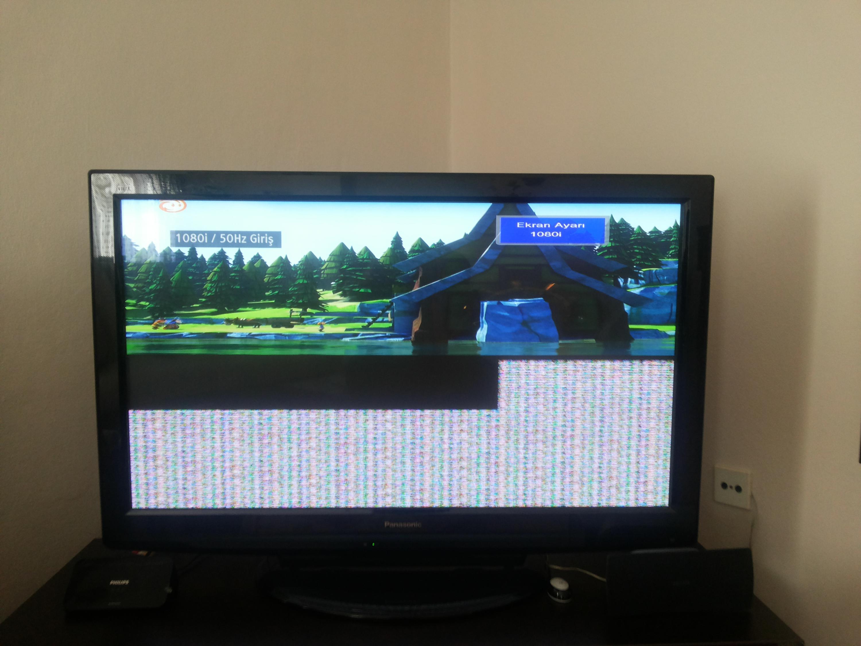

      I have a problem with my Panasonic TX-P42S20E. On 576i and 1080i There is a half vision on panel. Up side is ok but, down side is black or coloured. When i change the aspect ratio, problem is not solved. But when i change to 1080p or 720p, all panel is correctly working.
      Some servives tells its a main board problem, but i downloaded the service manual of my model, it tells this problem can be because of some cards failure.(SC,SS,SS2,A,C1,C2 boards) Please let me know you lived a problem like this and how you solved. If you want i can send a photo

          Here are two pics shows the differences on 720p and 576i.
            Re: Panasonic TH50PX500U Scrolling red/green horizontal lines
            100% A board for me, what happens in service menu?

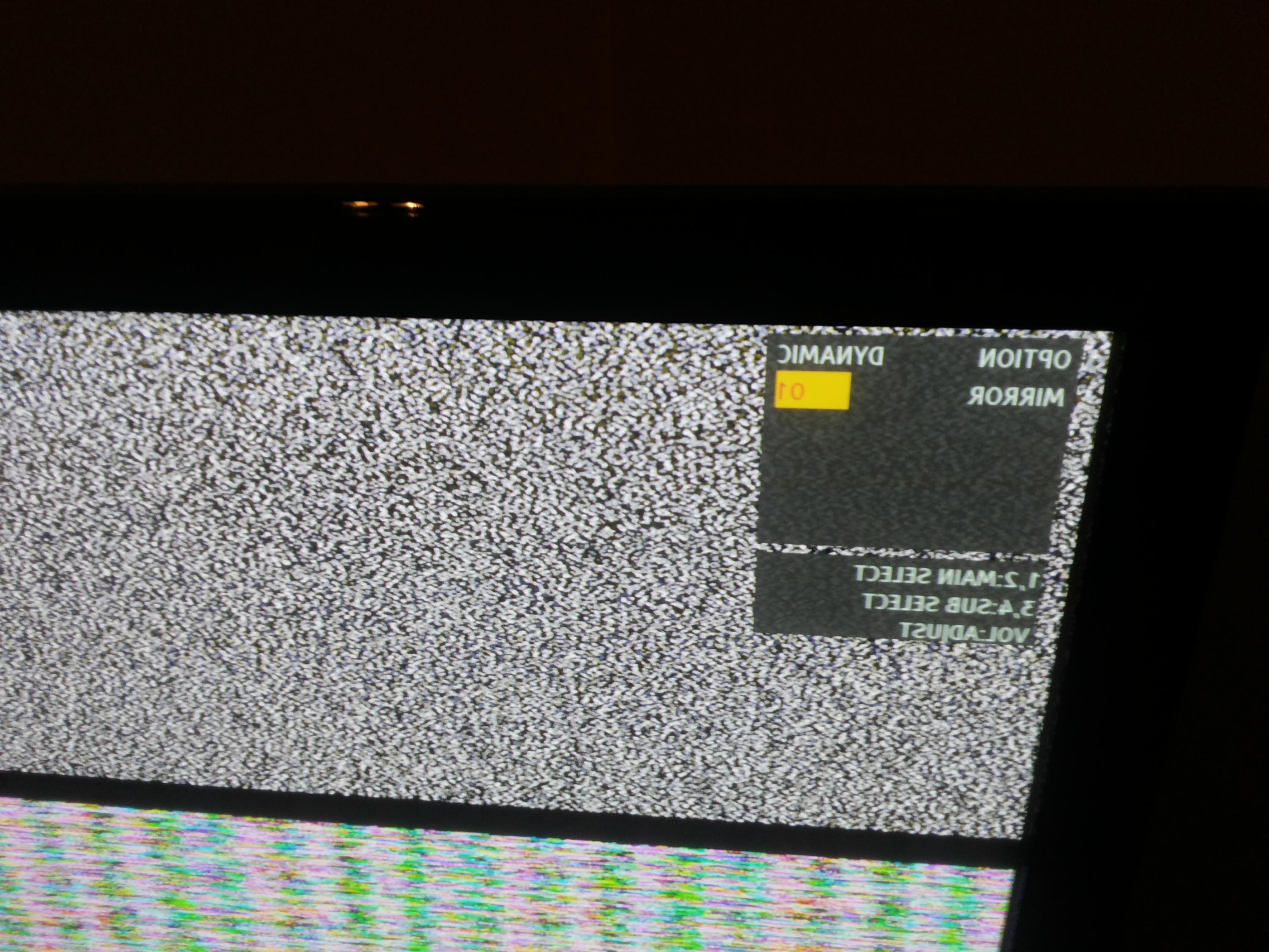

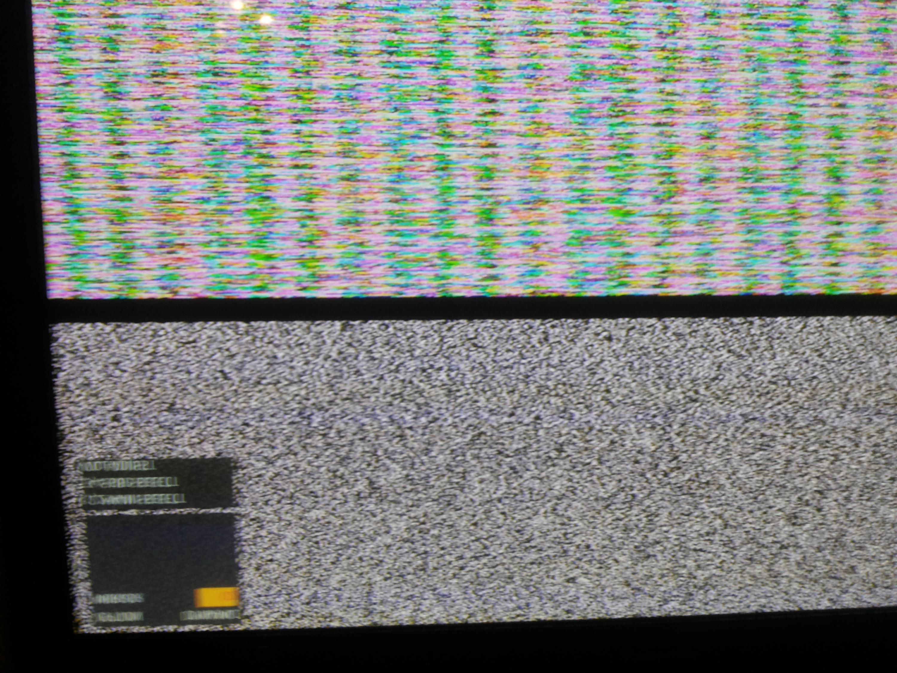

              can you get into service menu? If so try the mirror function, option 02 which is a vertical flip. If all that mess at the bottom goes to the top that would be good enough to confirm A board.
                I got the service menu and it says there is no failure. And shows everything is ok. But in service manual, it tells A board failure. But i ll try to find the mirror function. I'll inform you what happens. Thanks a lot.
                  Dear TW2005;
                  You are awesome. Problem is A BOARD. Thank you so much. Tomorrow i call the service.

                    So you're saying you got into service menu and did the flip and it went to the top?
                    Pity you did not post a picture, would be a good example for someone to follow although this all should be in a separate thread. No one is going to find this unless they do a search.
                    For the main board, it will have a TNPHxxxx number and then there is also a 2 letter suffix code which will either be 2 letters stamped on the card or a legend with some jumpers above it to decode what it is.
                    Some clear shots top and bottom and we may be able to decipher it for you. A boards can be difficult to get used.
                      You can see my shots like attachments. When i change to mirror mode on option, i got those screen-shots. But i can not open the back-cover of tv, because of service will come to take it. So i cant not say the number and suffix code.I hope these pics help everyone who lives the same problem.

                        Perfect. Always wanted to see this feature prove a fault. No , I'm not sure what causes it. Could be something simple like bad firmware or something?
                        It's not a common fault. A board would fix it. You keep talking about service. So is this TV under warranty?
