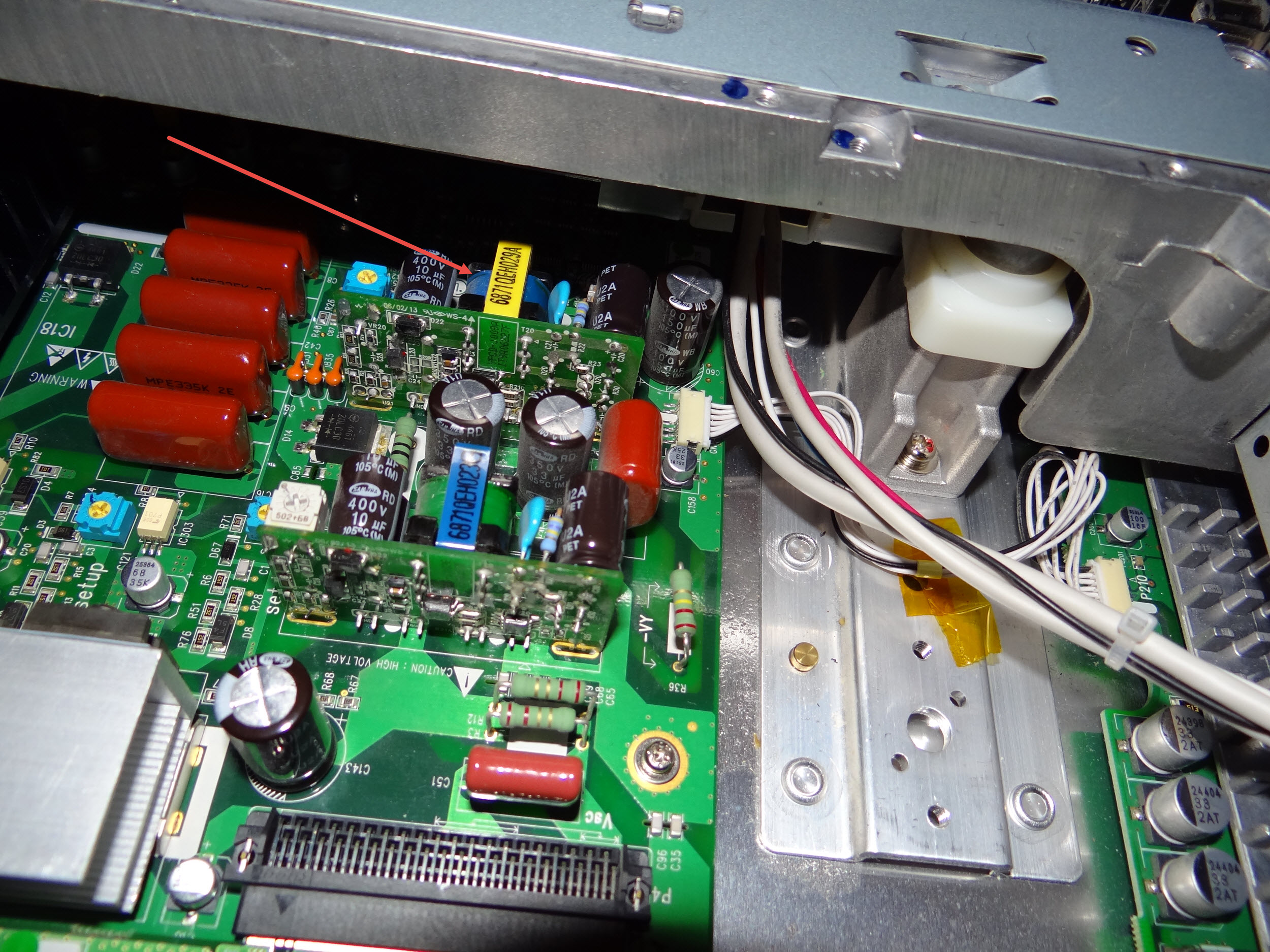

Toshiba 42HP66 - Pulsing -Vy
  • capkid
    • Oct 2010
    • 1339
    I sold this TV to a friend over a year ago after replacing the IPMs and fuses, and it now has sound and no picture again. The voltages check out, except for the -Vy, which pulses between -1V and -2V. The pulsing is audible. I disconnected the Y-buffer from the Y-Sus, but the pulsing is still there. It's most likely a Y-Sus issue, and I could probably find the culprit, but I don't have a whole of time to spend on this TV. Has anyone experienced this issue? What was the resolution?
    Y-Sus part number is 6871QYH053B.

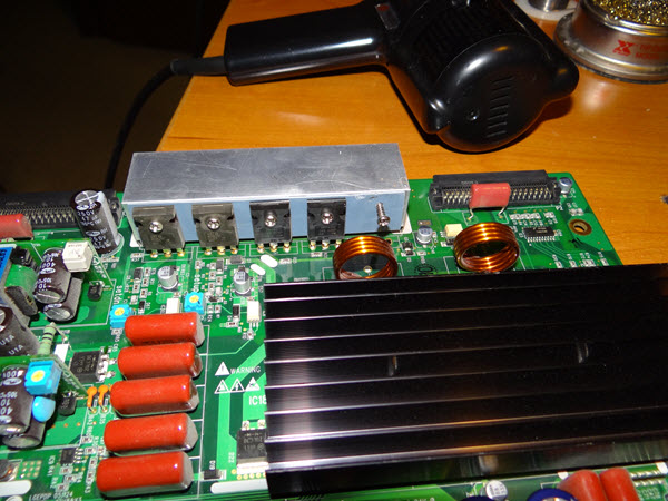

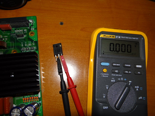

        Well, it looks I have a shorted mosfet (IRFP4232), so I'm going to replace it and the other two that are chained to it.
        LG Plasma Mal-Discharge Correction Service
        • capkid
          • Oct 2010
          • 1339
          Re: Toshiba 42HP66 - Pulsing -Vy
          I replaced the three IRFP4232 mosfets, and I now have a whitewashed picture. The -Vy is reading -243V I guess I have more work to do. Crap.

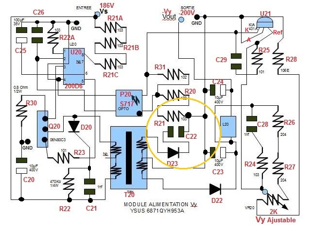

                          • capkid
                            • Oct 2010
                            • 1339

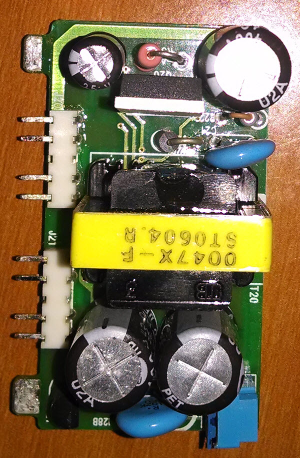

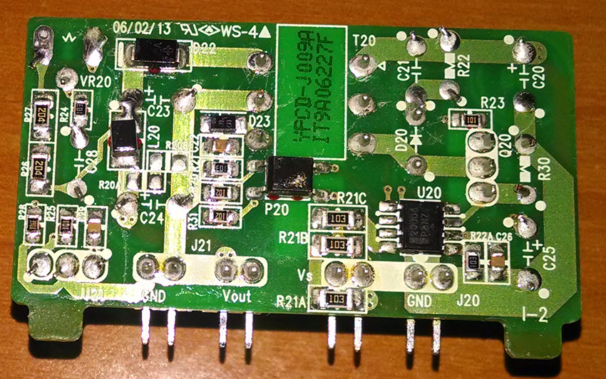

                            Well, it looks like the -Vy pot is fine. I measured voltages on that card, and the transformer reads 185V on the primary and is converted to -220V. I'm wondering if I have a cap issue on the secondary side of that transformer. More to come...
                            • capkid
                              • Oct 2010
                              • 1339
                              I tested most of the components on the secondary side of PS101's transformer, and the only one that seemed a little suspect is the cap at C22.
                              C22: ESR = 60, but I'm skeptical because it appears to be in parallel with a R21. The resistance across C22 is 10K ohms, which is the same as the value of R21.
                              C29 is in circuit with the U21 (KIA431A), and I couldn't get a reading using the ESR Micro V4 or the Fluke 87-III.

                                    • capkid
                                      • Oct 2010
                                      • 1339
                                      Ok. I removed the 10uF 400V caps from the board. The capacitance of each cap is just about right on spec, but the ESR is a bit off.
                                      Secondary side caps: 4.9 ohms and 3.5 ohms
                                      Primary side cap: 3.0 ohms

                                      • capkid
                                        • Oct 2010
                                        • 1339
                                        The 400V caps seem fine. I found this diagram that appears to have the C22 cap circled that I mentioned earlier. Of course, the cap's values aren't listed. I measured the cap in the same location on the PS102 board with it still installed, and it measures 0.22uF and 24.5 ohms ESR. From what I can tell, the PS101 cap is physically smaller - I got 0.11uF when I measured it.
                                        http://obrazki.elektroda.pl/8808509600_1323159379.jpg
                                        http://www.elektroda.pl/rtvforum/topic2153162.html
