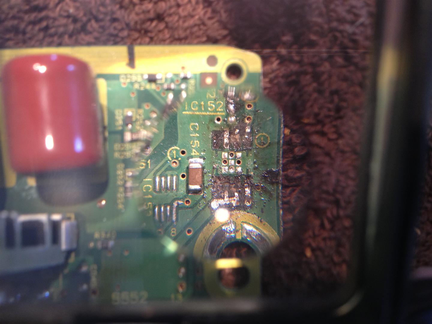

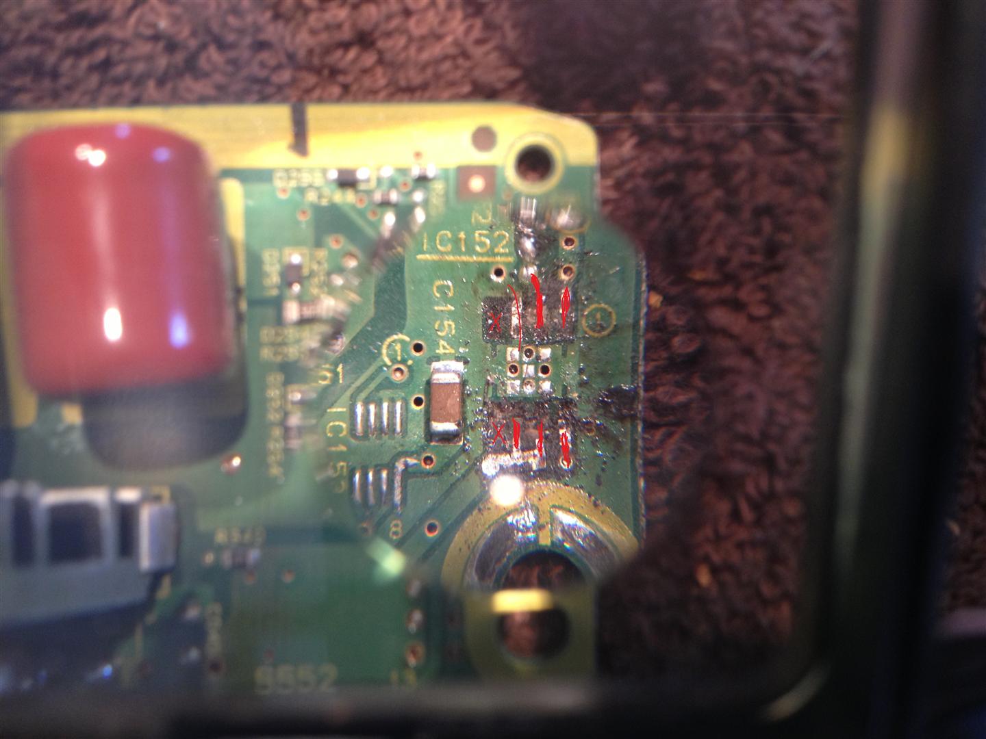

    Hello all,working on a TC-P50U50.
    It has the classic Xboard fault,loose screws causing the board to blow up.
    I got the repair kit from SJ for it but ran into a problem....
    While removing IC-152,a 8 leg little chip,I accidentally damaged the pads on the board
    I think I can fix it but could really use a schematic to check where each pin goes....
    The board is a: TNPA5623 or TXNSS1SDUU.
    I tried Tom's database and a few others and for the life of me can't find a schematic
    Would anyone have one? Even a picture of the area where IC-152 sits would be great....

      Chip is BD8694.
      I looked at those pics too. It helps for some traces.
      The chip has a center pad under it that's also soldered to the board.
      I will try and make a close up picture of the board if you promise not to laugh at my butcher job lol. It was late and I attempted to clean up the area what made it worse. I then walked away which I should have done earlier lol.

        I took a picture with my magnifying glass and Iphone,tricky but succeeded
        Pic#1 is pic of the area,pic#2 I doodled some red lines on as to how I think it should go...
        Would like a second opinion if I'm right..
        Does the center pad under the chip actually connect inside the chip or is it just for cooling??

          The centre pad is essential for cooling.
          That is pretty bad, I am not sure you can repair that.
          How did you try to remove the chip? If the chip is stuck, do not pull!! It will come off with surface tension on a river of solder by flooding both ends in turn.
            Re: TNPA5623 schematic Panasonic needed
            That's what happens when it's 3am and you "quickly " want to replace the chip still lol.
            Solder iron was set at too low of temp, I flooded the pins with solder and normally it just flips off the board with a little shove from the iron.
            It not being not hot enough and me sleepy I pushed a little to hard and did damage. Then I realized it was to cold and cranked up the iron. Made it too hot while trying to clean with solder wick and then I gave up haha.
            Don't do this small stuff late at night. I'm not proud of this screw up at all.

                    Well,it took a bit of creative soldering,this time NOT at 3am and Tv is up and running
                    Tested,zipped up and TV sold
