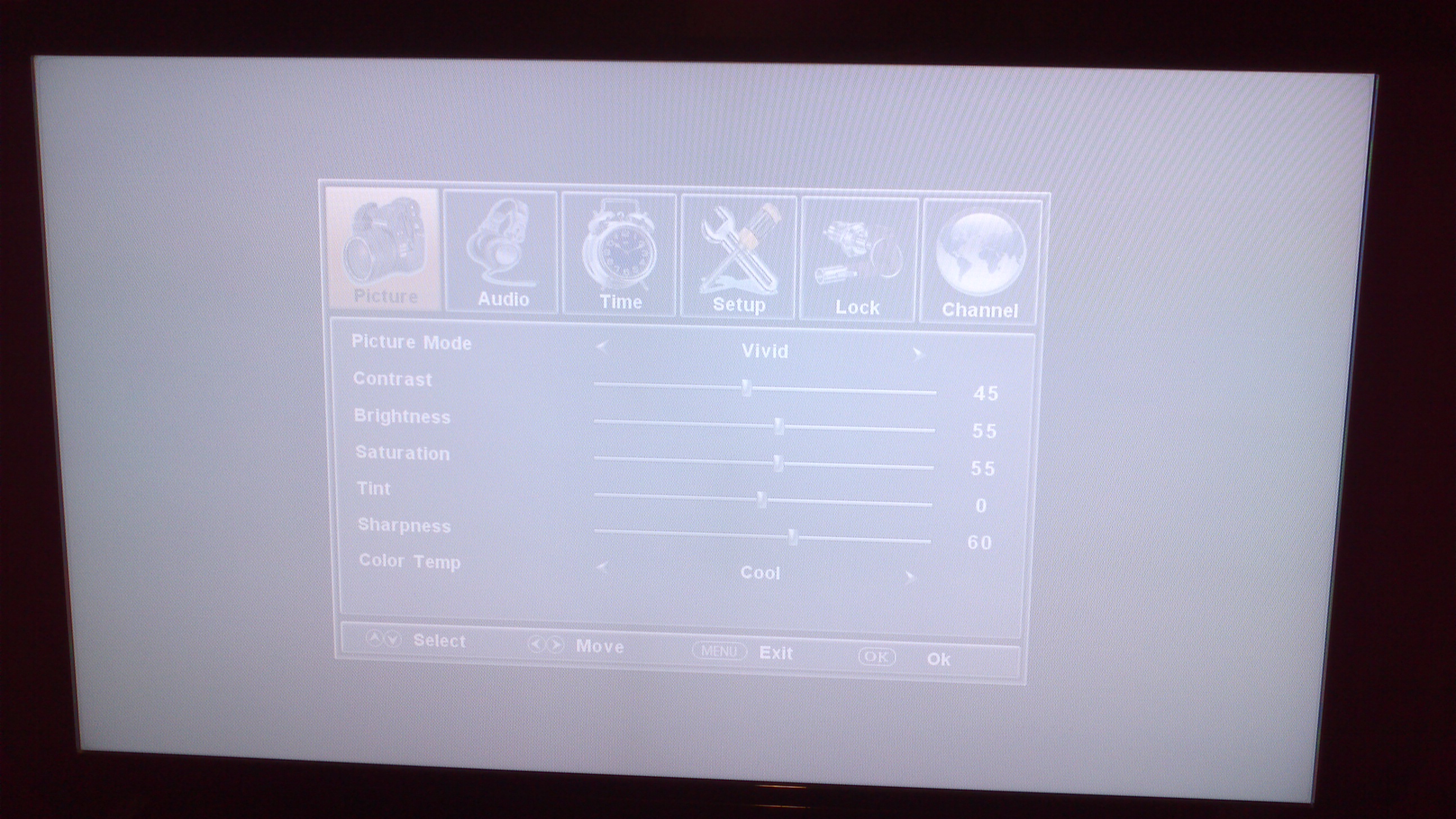

    I'm looking for a schematic of this mainboard 520-MSD119C-010C.
    Google tells me that it;s also in the Sceptre X32BV.
    The TV has a very bright picture which cannot be adjusted. The backlight CAN be adjusted though. Removing the signal output connector from the main board results in having only the dark backlight glow. So that seems to be ok.
    The picture is so bright you can barely see the picture. It's as if brightness and contrast was adjusted to their maximum value.
    The guy I have it from told me someone sat on the remote control and after that he had this problem. Sounds weird.
    Anybody knows if a schematic is available or what could be the problem or if there needs to be firmware reflashed or something?
    Thanks!

    This might be another gamma IC failure. It can cause this effect, completely unrelated to main board. Can you supply a picture of the fault & a picture of the T-con board?

      Re: White very bright picture on LVQ40HLA VisionQuest
      Here is a picture of the fault. Brightness contrast and other picture related menu adjustments have minimum effect on the picture. The backlight adjustment works. The picture is colored.
      I will post a picture of the TCON later.
      I don't know much about the TCON, i.e. never had to replace one. Why does the picture go black when I remove the cable from main to TCON? I didn't remove the board yet...
        That definitely looks like a gamma fault.
        The T-con converts the video signals that the main board produces into a format that the LCD panel can accept. It also typically generates the various voltages that a panel requires (VON/VGH, VOFF/VGL, AVDD, and VDD.)
        When the power to the LCD panel is removed, because the T-con is disconnected from power, the pixels go back to their natural state; on most panels this is black. Earlier panels went white with no power.
        Look closely at the panel. Can you see a dancing dots pattern? Every second dot flickering? This is one effect that can sometimes occur with a gamma fault due to mis-matched curve voltages.
          Thanks for the explanation. No I couldn't see dancing dots, but I didn't look REALLY closely. Now I have it partly disassembled. Will have a look at it later.
            No worries, we can still check the gamma curve voltages to see if the IC is bad or not.

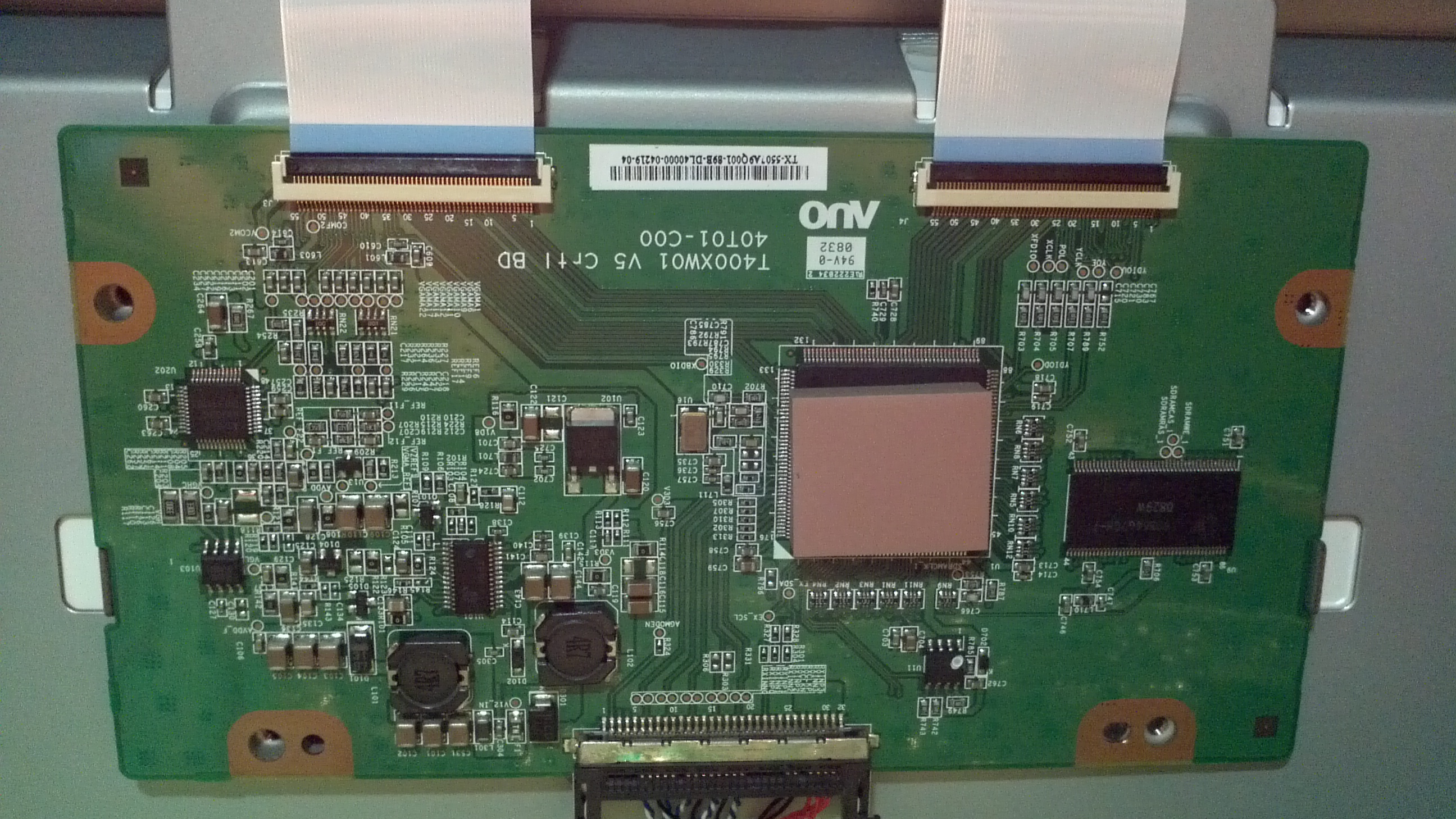

              Here is a picture of the TCON board. It says T400XW01.
              • paulstef
                • Dec 2013
                • 724
                Is the gamma IC the 48 pin TQFP package ? The datasheet says "voltage buffers that buffers reference voltage for gamma correction". If that's it it would be easy to replace. Otherwise, how can I actually check what's wrong with the TCON? I know they cost next to nothing but I still would like to find out what's wrong.
                The other two big ICs look like a CPU and RAM but I didn't really look up their datasheets.
                  Yes, that's the chip.
                  Just above & to the right there's a series of points which are labelled VGAMA1 thru VGAMA22
                  https://www.badcaps.net/forum/attach...7&d=1398218428
                  Check the voltage on each point with the board connected.
                      So I have:
                      VGMA1: 15.29V
                      VGMA6: 15.16V
                      VGMA9: 15.16V
                      VGMA10: 15.04V
                      VGMA11: 15.04V
                      VGMA12: 6.64V
                      VGMA14: 4.9V
                      VGMA17: 4.13V
                      VGMA22: 0.35V
                      REF6: 14.45V
                      REF9: 14.3V
                      REF14: 4.8V
                      REF17: 4.08V
                      VGMAREF: 2.48V
                        Your gamma IC is bad. Replace the IC marked AS15 and it should be good. Alternatively replace the entire T-con board.
                          Thanks! I would like to understand better though.
                          How do I determine that it's bad? What voltages should there be? Are they similar for all panels? I assume the higher the voltage the higher the transmittance for the pixel?
                          Since this IC seems to be a simple amplifier how do I know it's not the input signal that's wrong?
                            I will link you to a couple of pages from my ebook (still a big, big work in progress) to help you understand.
                            • paulstef
                              • Dec 2013
                              • 724
                              Great reading. Made certainly more sense to post this here than to explain it several times.
                              Anyway I guess I will have to read more on this subject. So the gamma IC actually creates fixed voltages in certain steps and the average of all of them should be half of AVDD, 15.77V in my case.
                              For the sequence I posted the obviously wrong voltages are 5x equal of 15V, is that correct?
                                Half of AVDD in your case is 7.5V and this is true for 99% of large LCD panels used in TVs. (Laptops & phones tend to use 6 to 9V AVDD...)
                                The voltages should either increase or decrease but they can only do one. They can't increase, decrease, increase. That's bad. That's test 1 and detects 90% of failures.
                                The second test is to virtually split the curve around the middle VGAMA (11 in this case.) For the lower values, try to mirror them about the axis so they line up with the upper values. As you can see this is not possible. This is test 2 and detects most other failures.
                                Failing that compare to the reference curve in the ebook...
                                Yes the real killer voltages are the first half stuck at 15V which is causing the LCD to drive all pixels full white for half the pixel cycle. (VGAMA22 & VGAMA1 represent the same light level... it's complicated.) This is why your picture is whited out.
                                      Yes, it was the IC. TV works now. (just has one stuck green pixel)
                                      Thanks Tom! Your help is much appreciated!
