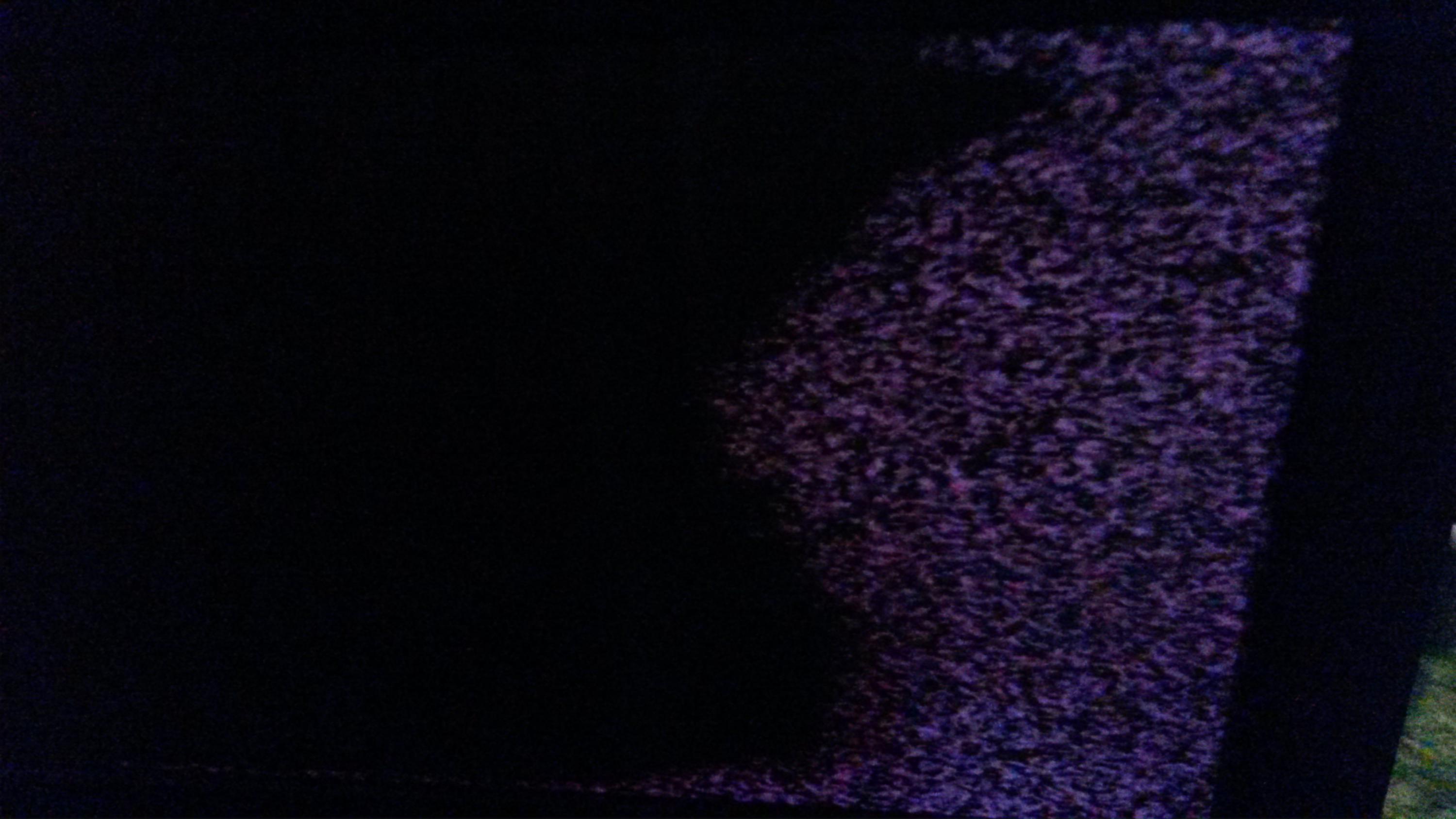

    I think I have a bad ZSUS, anyone see this issue before? Almost looks like a cracked lcd display. Voltages look good and fuses check ok on zsus. I'm thinking if it is bad, the large ic/regulator assy. went on it.
    Re: LG 42PC3D picture issue
    Definitely bad Z-sustain, check fuses on the board.
      No blown fuses. Saw a few boards out there under 60 bucks. The "kit" is like $45, but the last time I fought with one of those kits, spending the other 15 bucks will be worth it. Unless you have a desoldering station, it's a real pain.
      I just fixed a vizio ysus with one of those kits. It worked, but a nightmare to desolder. How I miss my ungar desoldering station.
        Yup, it was the ZSUS. Thanks for the help.
