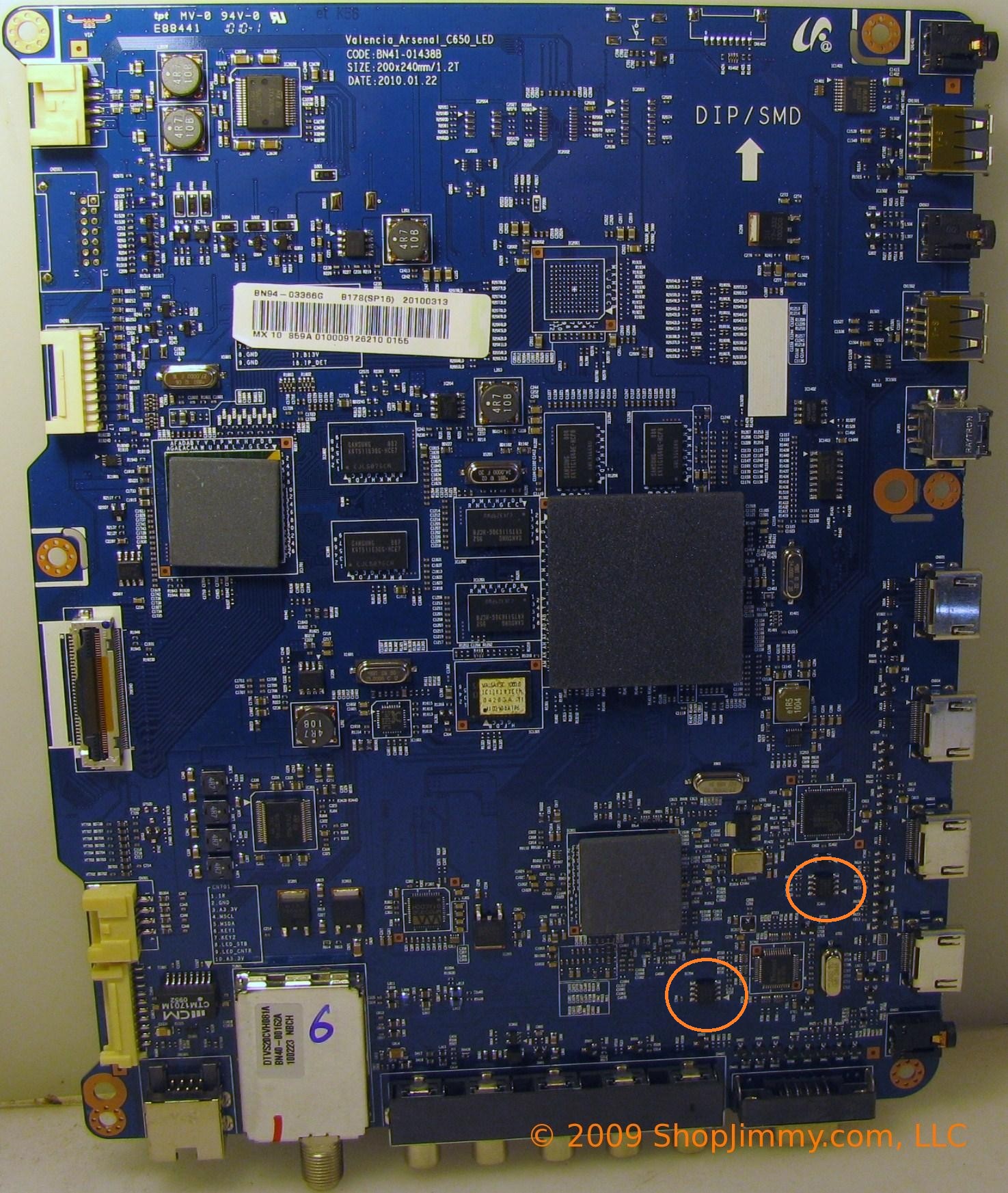

    I have picked up this TV and trying to repair it, but I need some help.
    I have jumped the STB to PS and BL and the backlight turns on and stays on without clicking.
    So it's a mainboard issue.
    I'm thinking to try resetting the EEPROM, what can I lose?
    I don't know which one is the EEPROM. The clsoset ICs that I have found are the same both of them, they are 8 pin and there designation is S24CSO. These could be the ones I'm looking for? They are EEPROMs, but why there are two of them?
    I haven't made a picture yet, but here is shopjimmy's picture, I have circled the two ICs.
    Any help would be appreciated.

    There are two 8 pin ICs near the CPU, but those are some buck regulators(Zxxx).
      Re: Samsung UN40C6300 clicking fast
      Try SAMYGO wiki... there are locations for EEPROMs there, I think it will be SPI flash though, the C-series LCD flash may or may not work.

        Thanks Tom for answering, but on that site I don't see anything similar to my board.
        What do you mean by SPI, different type of EEPROM? The one with a paper sticker on it? If yes, what that means?
          SPI flash, yes you can think of it as an EEPROM (it's not, but it's similar.) It stores the software for the TV after the boot loader has started. (Running Linux, usually.) If it is corrupt it will not boot usually hence the loop clicking. Not sure which one it is but if you post the part# it can be confirmed.
            Should I remove that paper sticker?
              Yes, but keep it or note down what's printed first.

                  It seems like this is the part number# Samsung KFG1G16U2C-A1B6.
                  I couldn't locate a datasheet for it yet.
                    Reprogramming that IC will be too difficult, it is BGA. I think the only thing you can do is replace the board, sorry. Common issue with C-series Samsungs.
