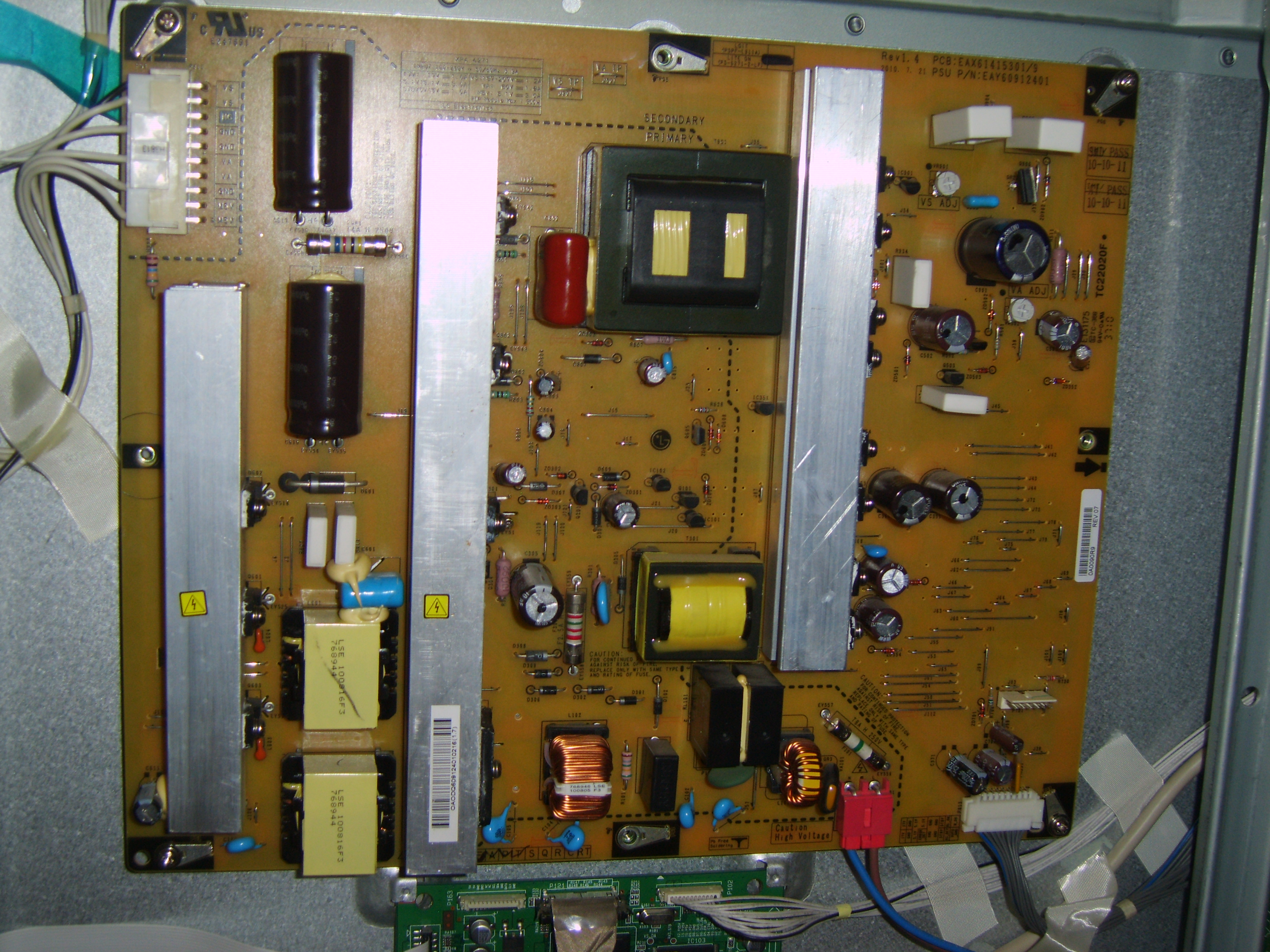

LG 42PJ550 Click
  • anotherdude
    • Feb 2013
    • 488
    • uk
    LG 42PJ550 Click
    Tries to turn on with a audible click, standby led shows before it attempts to turn on I get no response from pressing buttons or the remote.
    can hear the click again when i remove the power cable
    reading no vs or va voltages

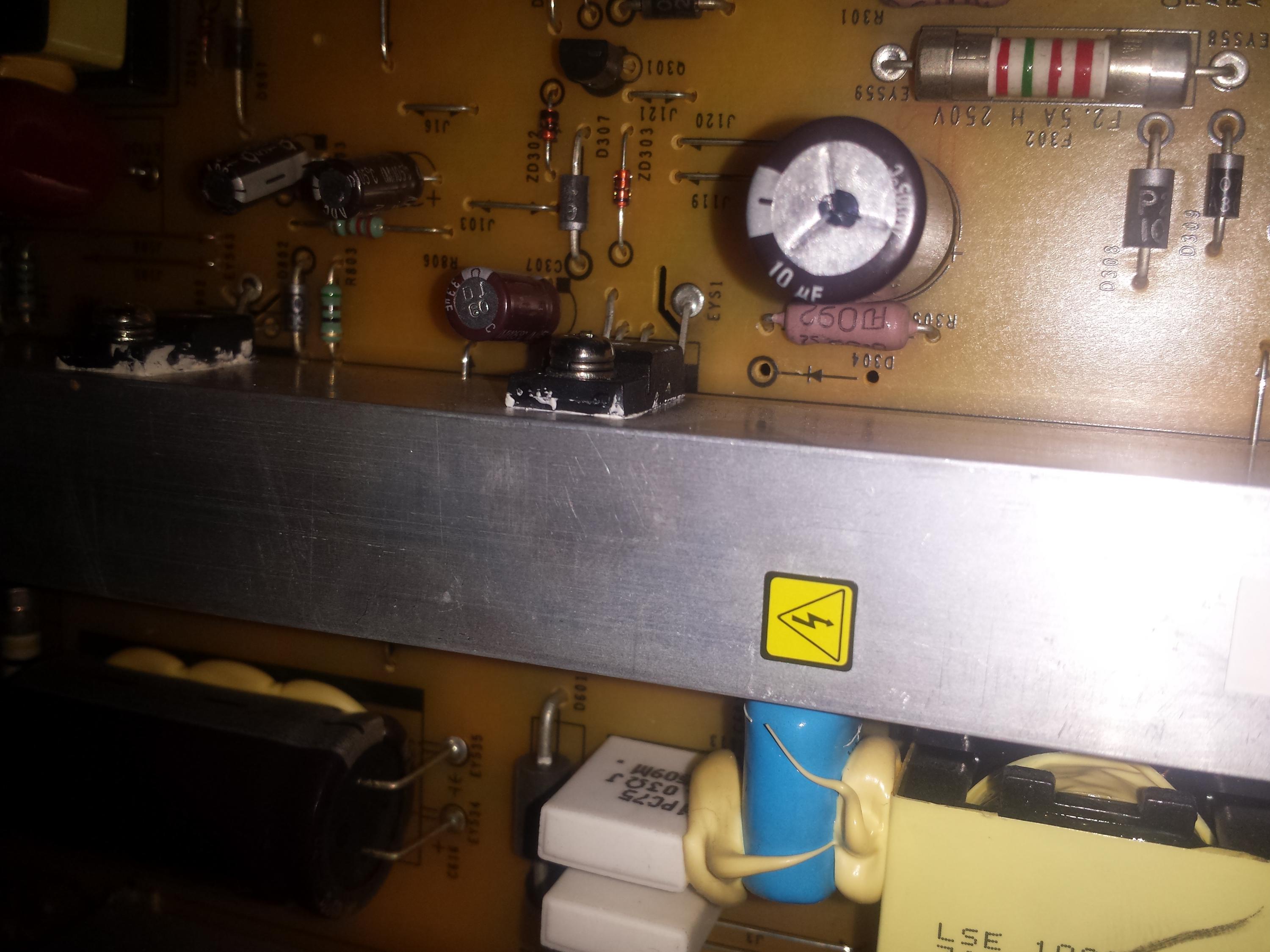

    Re: LG 42PJ550 Click
    it common problom chack the 5w 22 ohm resistor and 3BR1565JF
      thanks can see these in a kit on ebay
      just found them seperatly but can't make out the diode on the board
      • anotherdude
        • Feb 2013
        • 488
        • uk
        got the diode out it's a sb140a
        am I correct in this 40v 1a so would these be a suitable replacement
        http://cpc.farnell.com/jsp/search/pr...sp?sku=SC08155
        also i've seen kits with fuses next to the diode but as far as i can tell the fuse is good because i still get a standby light
        sorry to ask here but my searching on cpc doesn't seem to work (or i'm doing it wrong) but could anyone see these parts
        these resistors correct? http://cpc.farnell.com/multicomp/mck...5ws/dp/RE07467
        22ohm 5w resistor
        ICE3BR1565JF

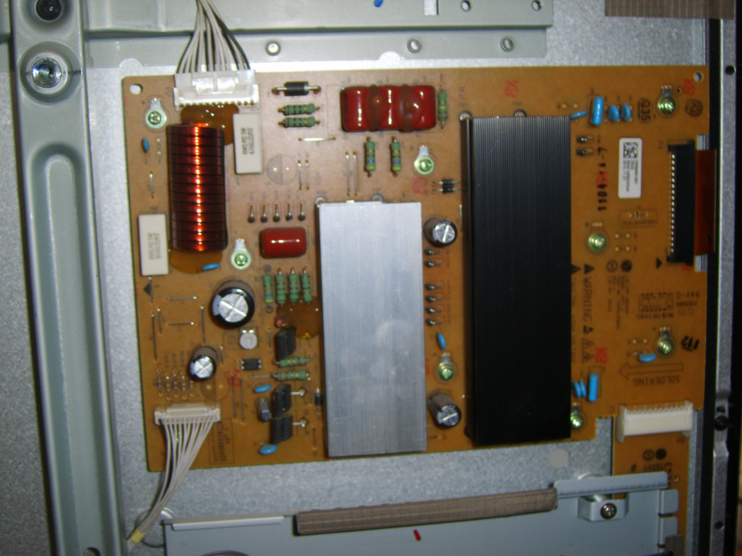

              Could you provide a picture of it's location?
              • anotherdude
                • Feb 2013
                • 488
                • uk
                it's located next to the ICE3BR1565JF
                it's been removed already D304
                  Ah kk, that should be fine, was thinking of another diode.

                      • anotherdude
                        • Feb 2013
                        • 488
                        • uk

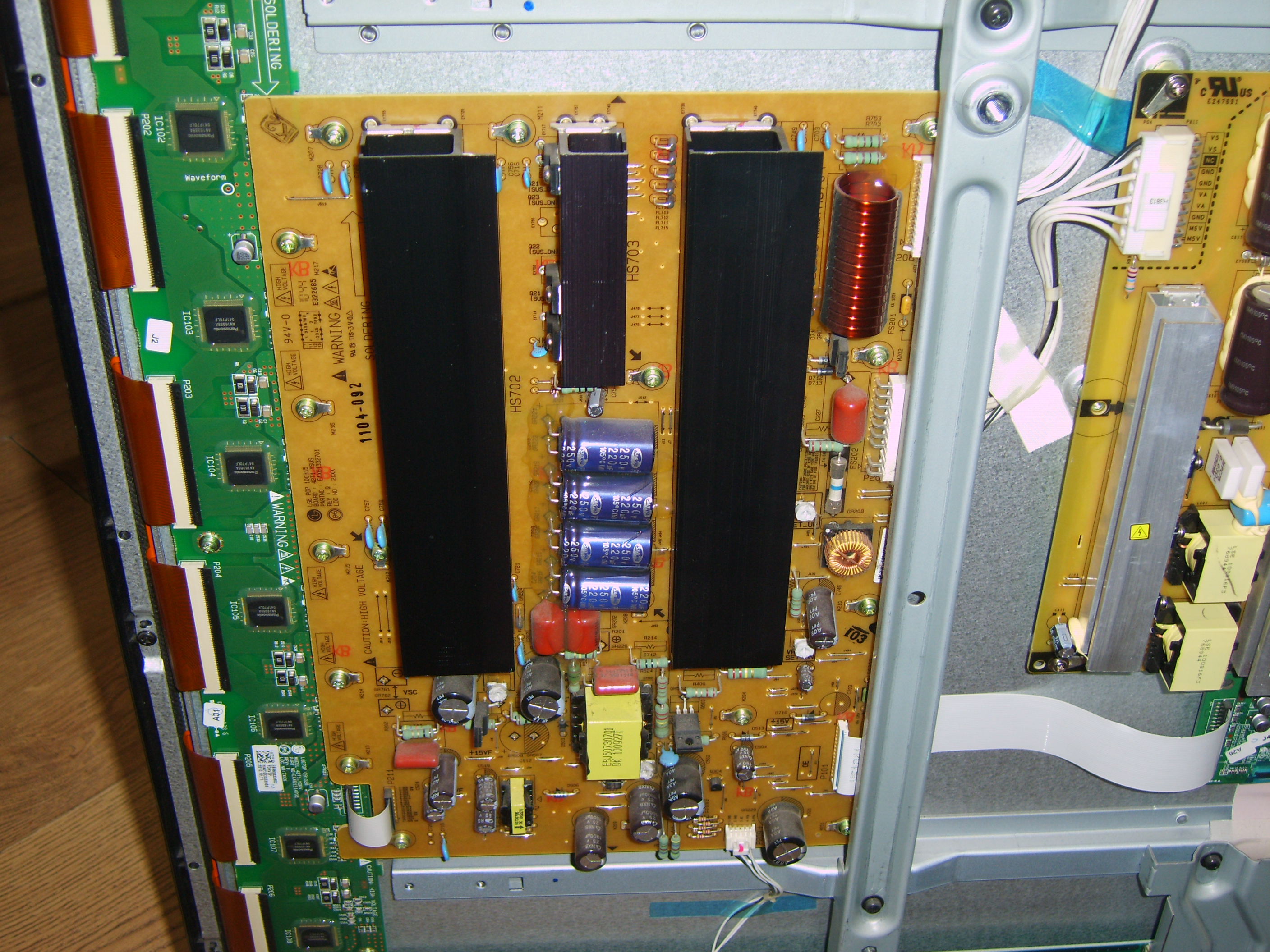

                        pictures attatched, can see there was another similar issue with the same set a few weeks back
                          215V to Vsus? That's very high....

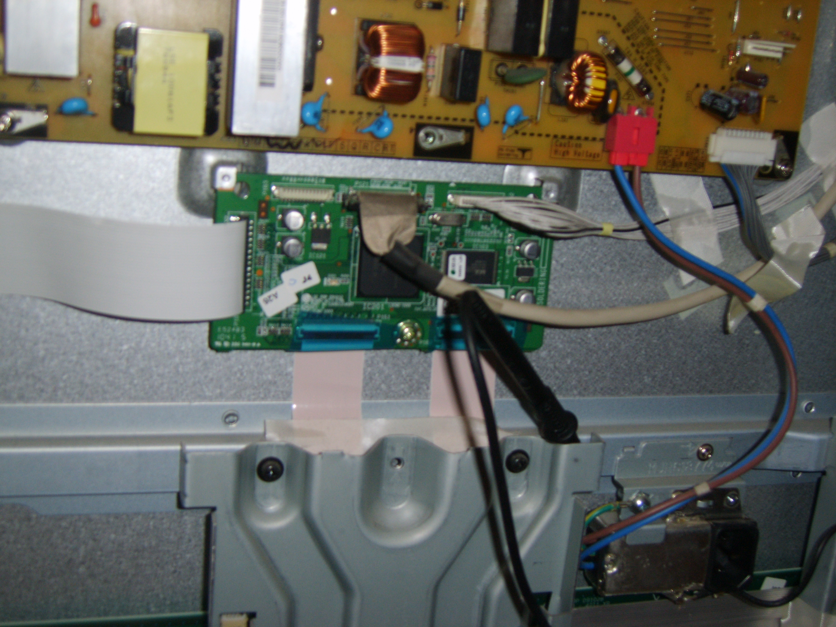

                                have you tried running the PSU on its own? If the power cable to the main board is disconnected, the PSU should power up all stages in sequence. I'd disconnect all other boards.

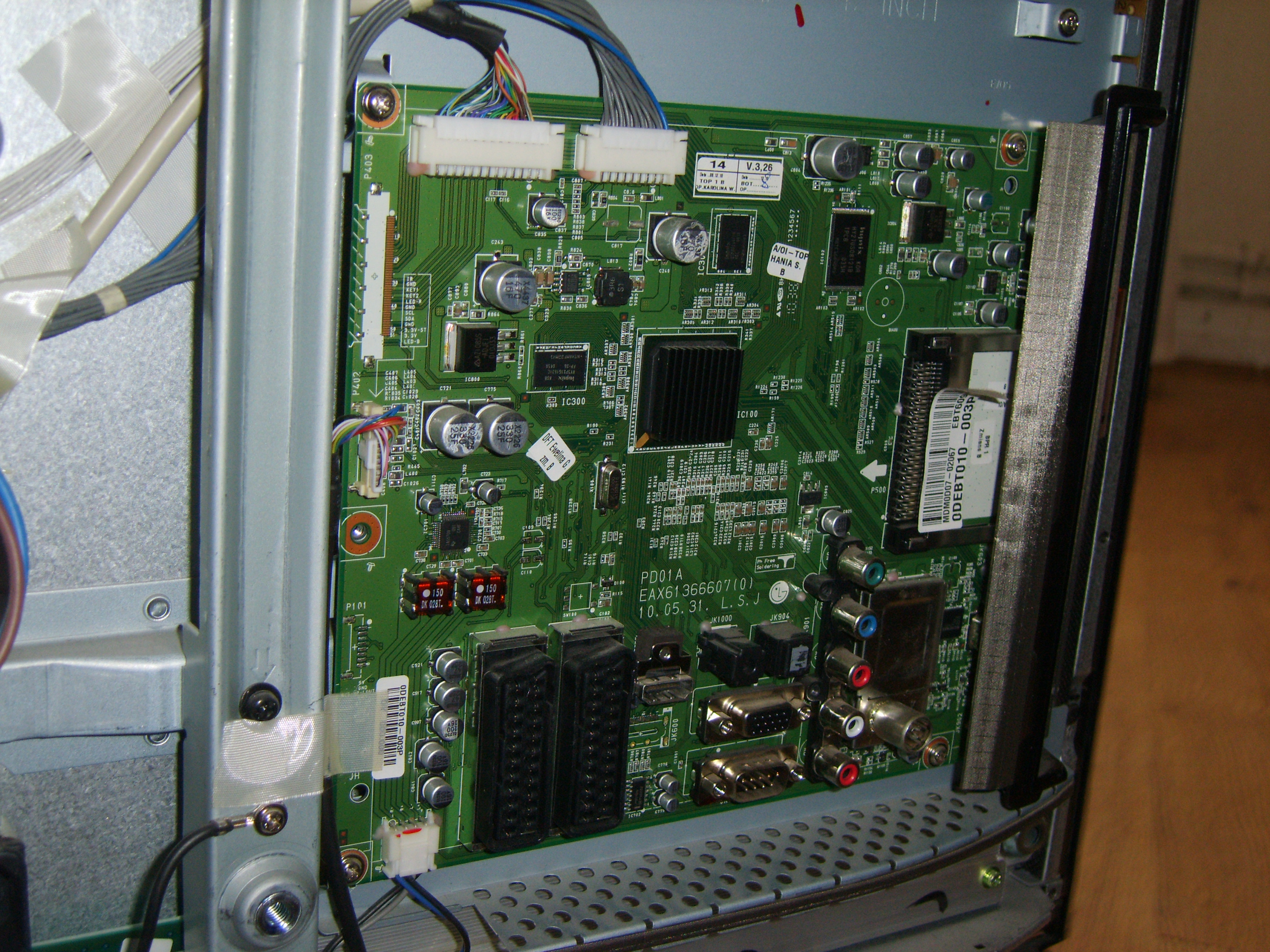

                                    seems your are correct, unplugged the main measured the voltages at the vs etc and there all there and correct
                                    used a resistor on the t-con and got the test pattern too

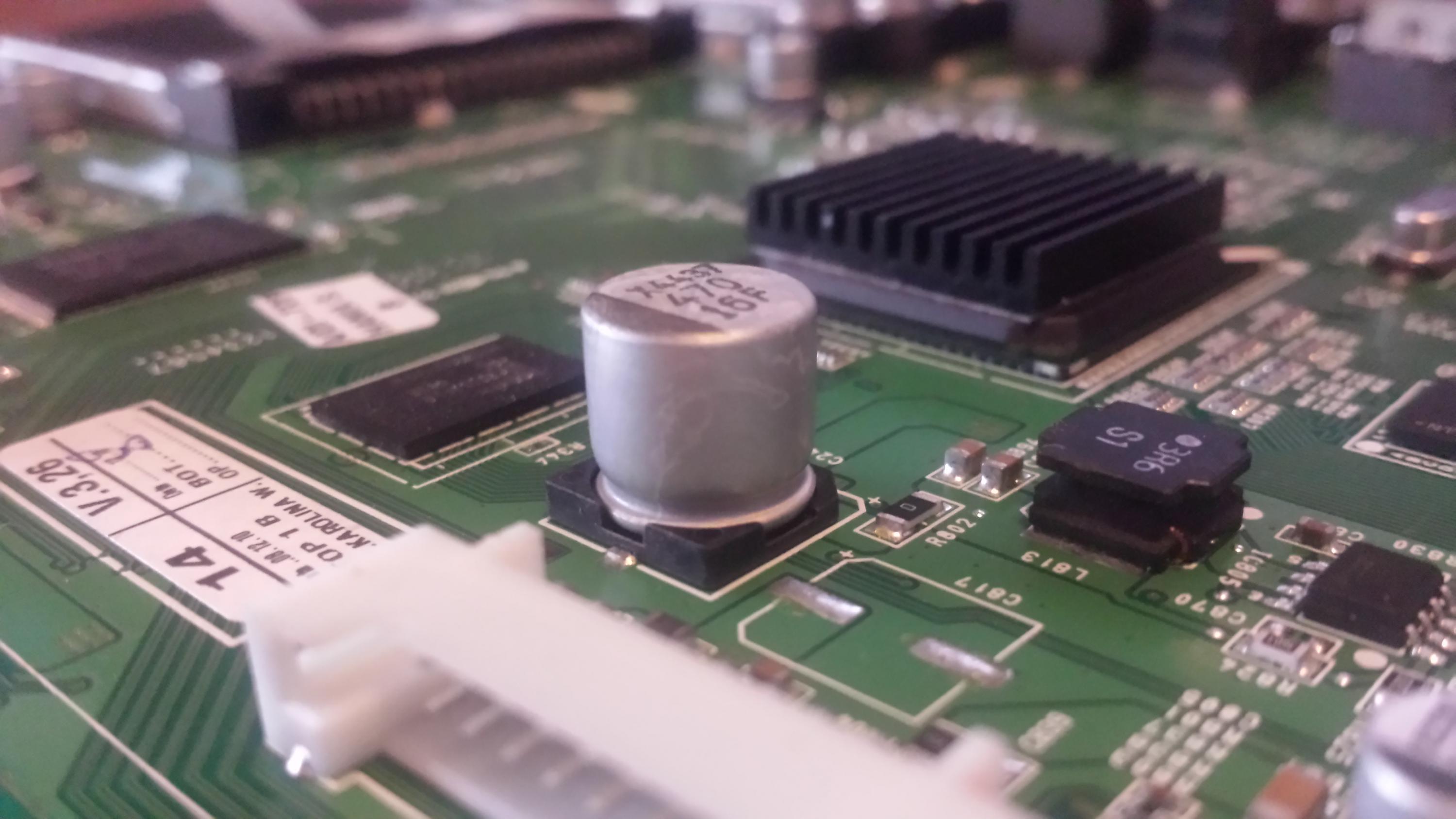

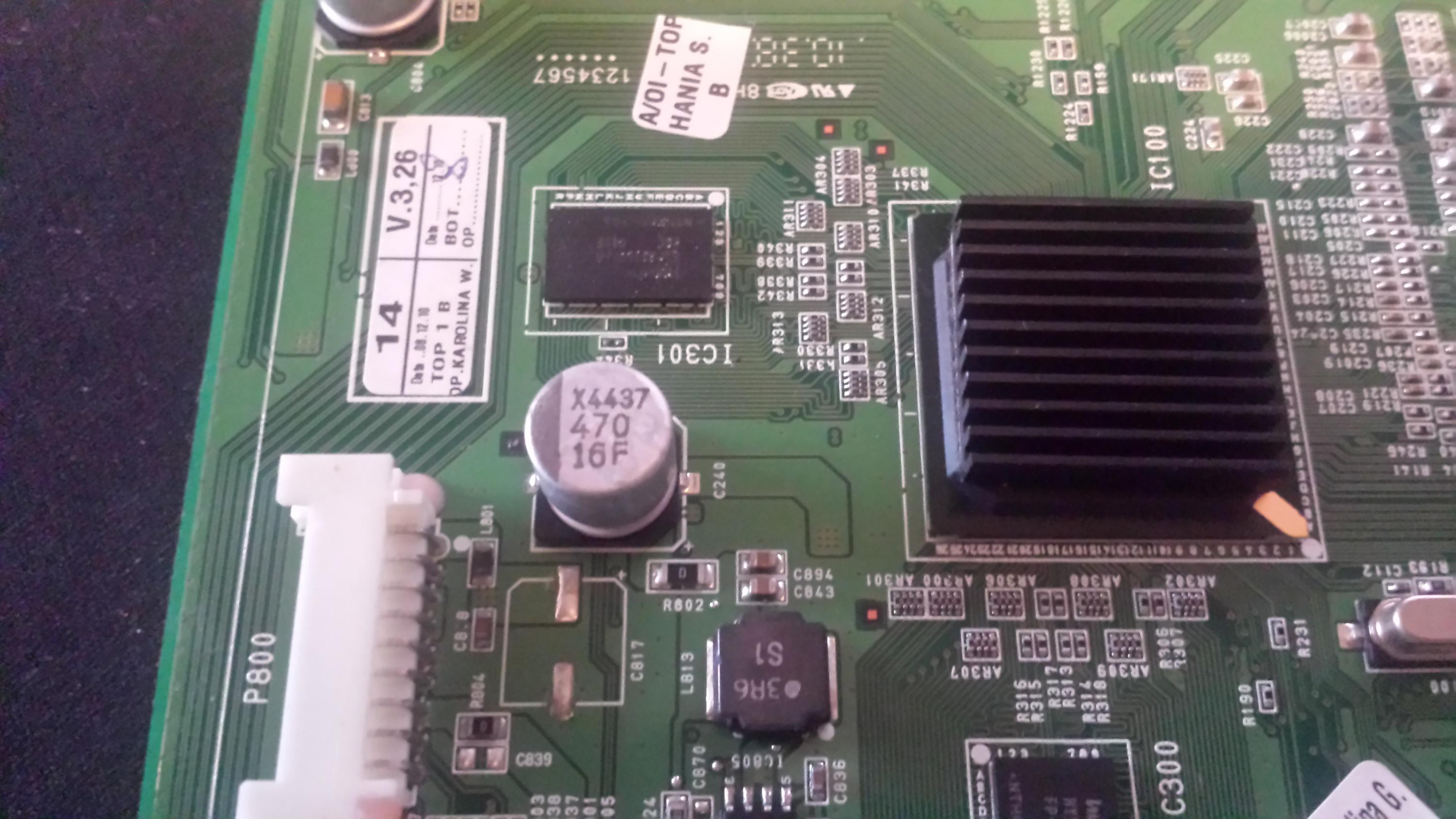

                                    looking at the mainboard now it's very obvious where the fault is, cracking on a cap
                                    should of tried that from the off, how stupid of me, suppose i know for next time
                                    • anotherdude
                                      • Feb 2013
                                      • 488
                                      • uk
                                      not that visible from the photo but the difference can be seen to the rest of the caps, no swelling but cracking down the sides and the top looks different too
                                      anyone able to help with the values?
                                        That looks fine to me.
                                        Have you jumpered the power supply ON and tried test patterns yet?
                                        215V~220V - what cap? The 450V ones? You need to measure across them.
