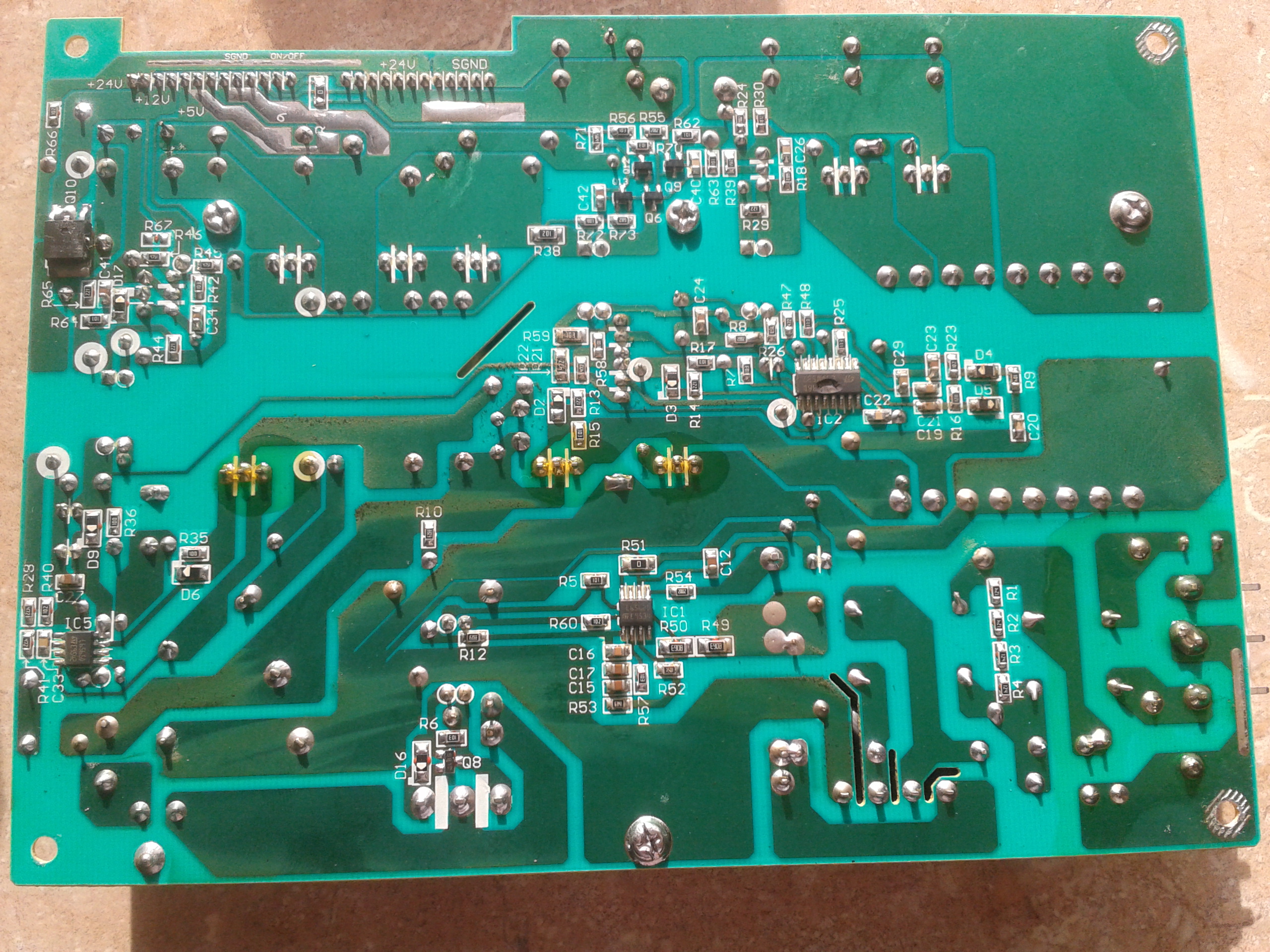

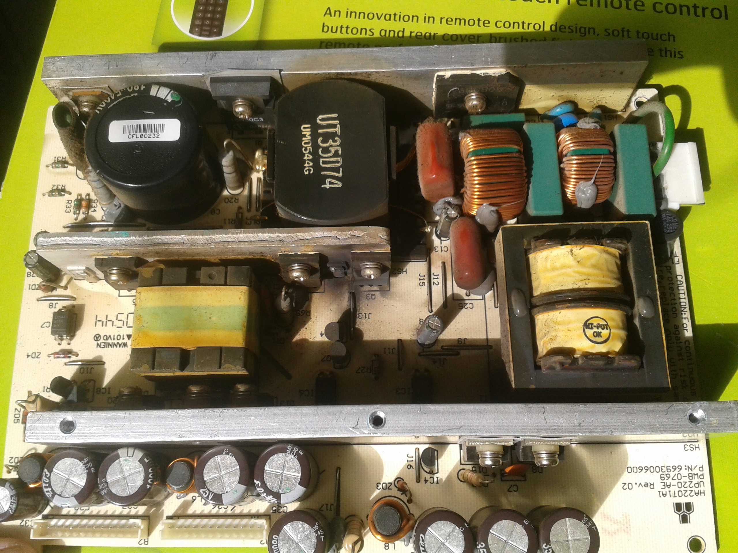

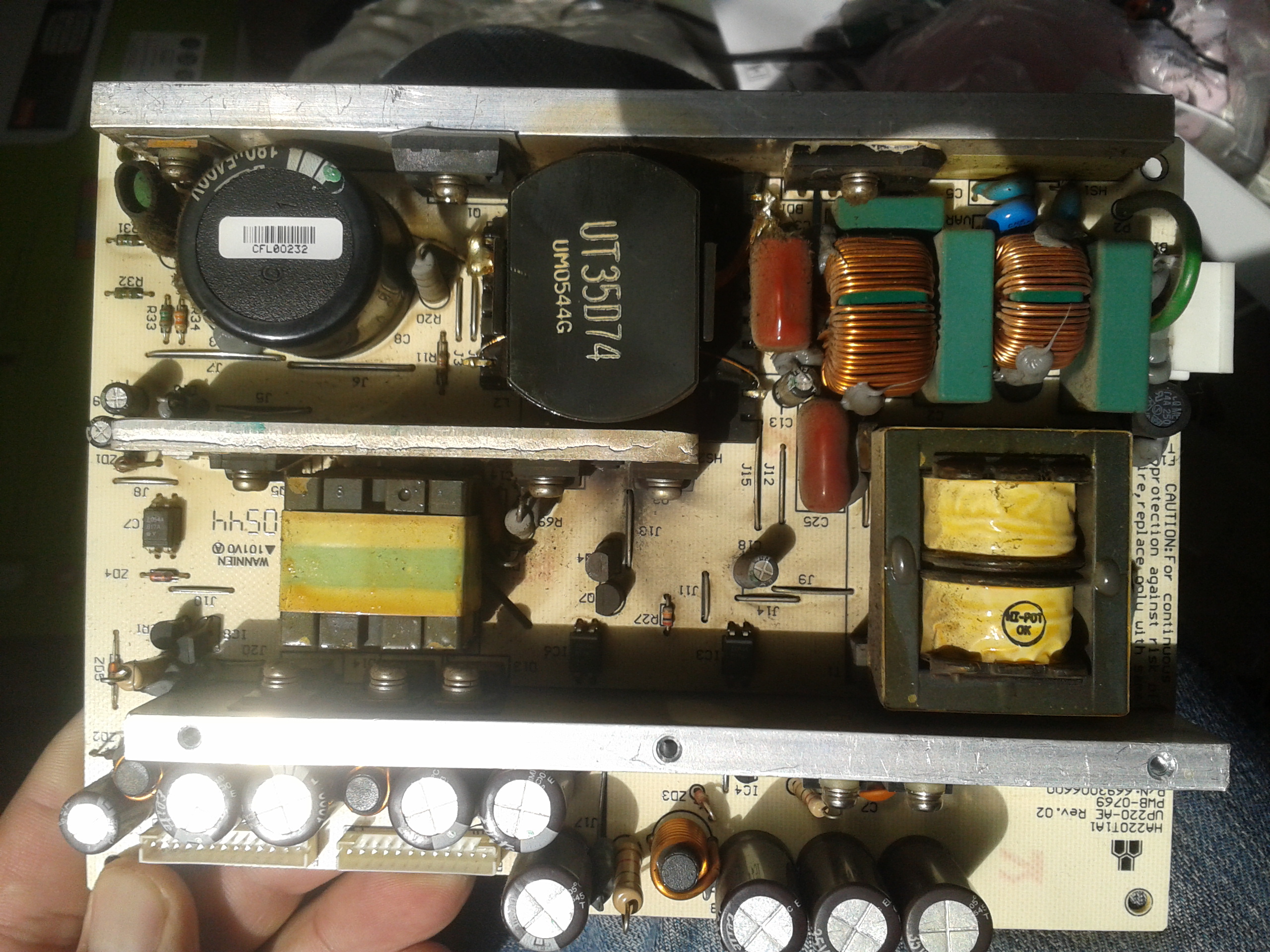

    I got this evesham v32eccb tv given to me. it's a 2006 model.

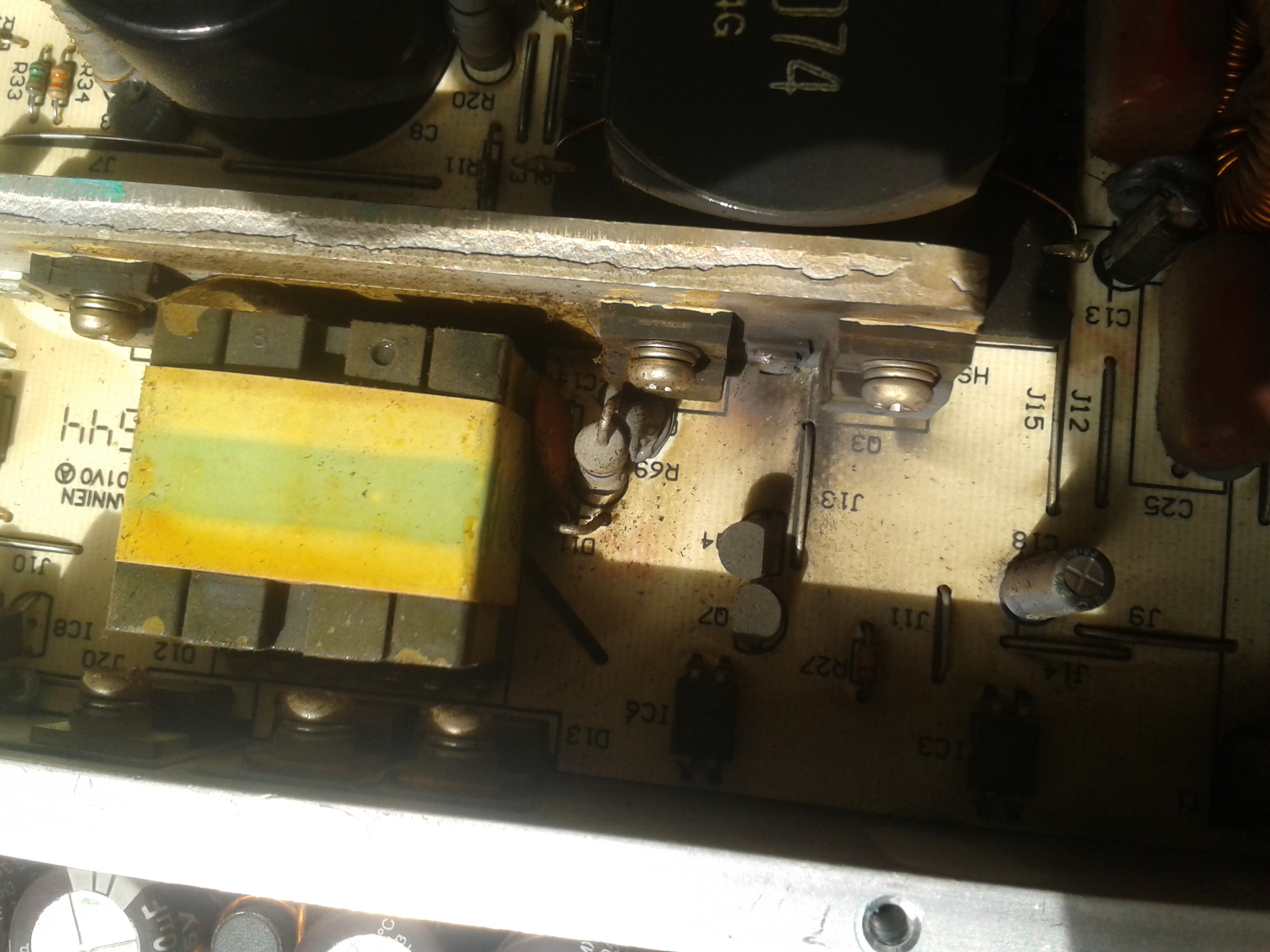

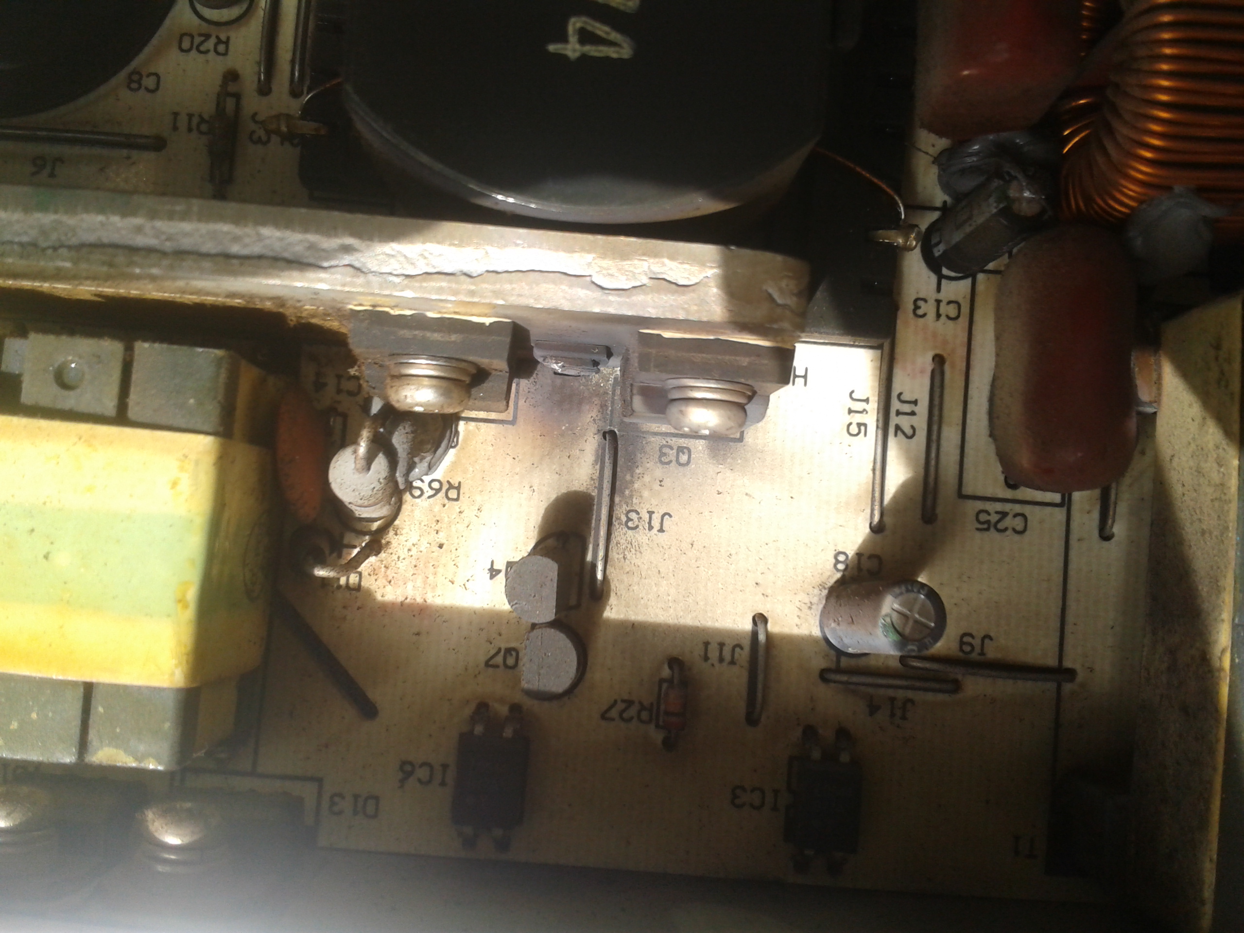

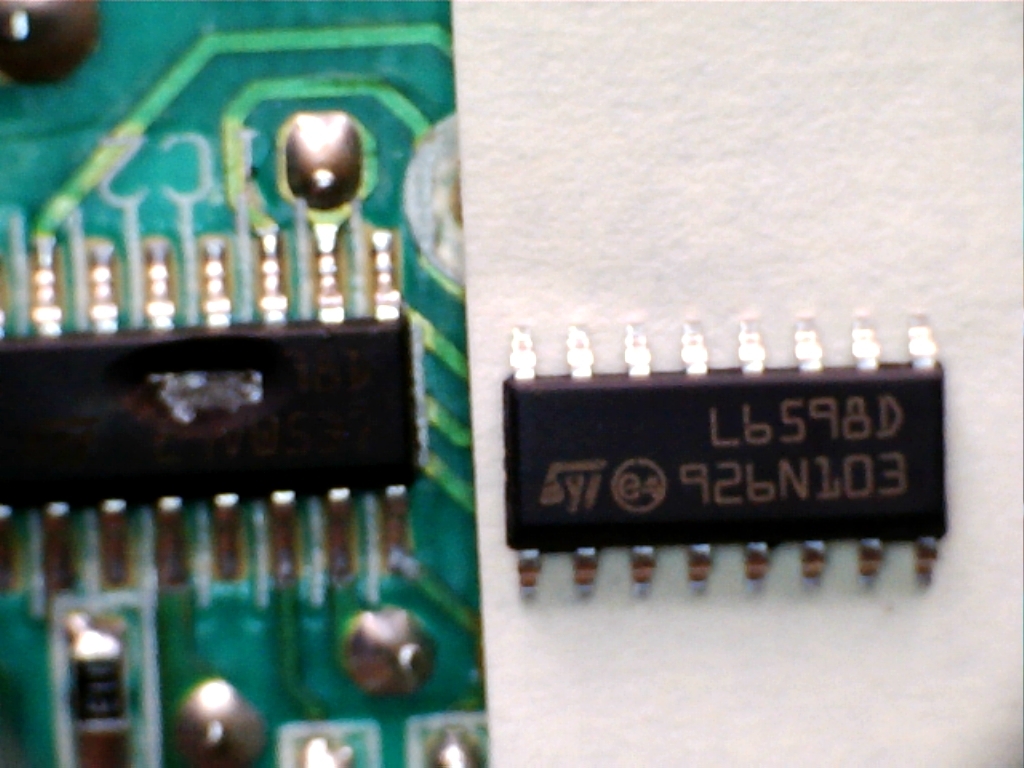

    There is no power what so ever coming out of it. I can see scorch marks around two fet's and on the underside there is a hole in one of the chips (see pics) this is a stab in the dark but there is no burning on the chip, it looks like its been chiped some how "Pardon the pun". Is it possible that chip is ok??
    I haven't done any other checks yet, just a visual inspection.
    I will need a schematic if anyone got one cos if im going to repair this I will need to know what part the chip is as the hole on the chip had the numbers on it. Thank you...
    p.s. I think the board is a wannien 101vo 0544 or the board number is the one in the pic not sure.

    No, the chip is destroyed. This will happen if the FETs fail. I have a Vestel PSU here with a blown SMPS IC too. It actually put a very nice black mark in the back metal behind the screen.
      Re: evesham v32eccb no power
      Only the one fet is blown "p14nk50zfp" but cant get the part on ebay or cpc, maybe no point if I cant get that ic number.
        It's a 14N50, just find a similar part with:
        - RDS(on): same or lower
        - Qg: same or lower

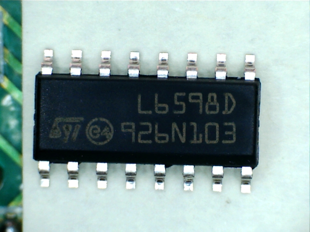

          Closest I can find is STW14NK50Z, it has the same data sheet, think its just a different package. now just need to find out that part number on the blown chip. then I can order them and learn how to solder a small smd chip lol.

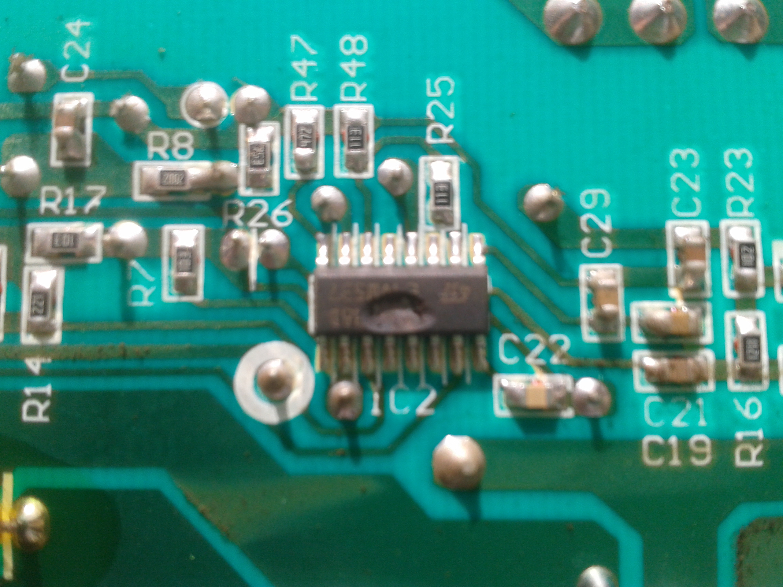

                I also need to know how to identify pin 1 on the chip ic2. as you can see in the pic there's no marks to let you know which way it needs to go. Do I use the writing as a reference and put it on the same way as the writing on the chip on the pcb?

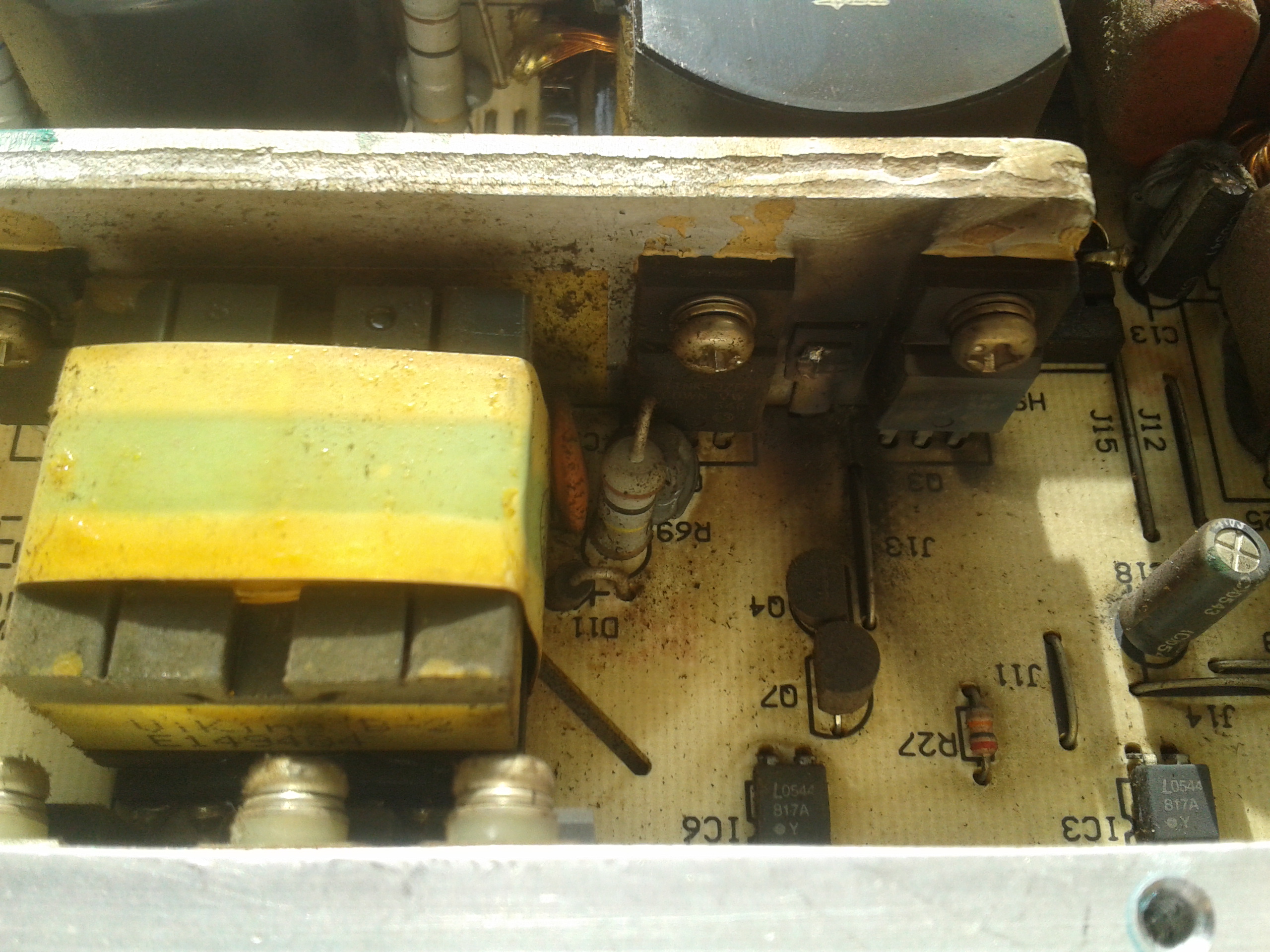

                  Just an update, I've soldered in the new chip, don't know if it was the right way around as there's no mark to see what is pin one, so I put it in with the writing the same way around as the one that came out. Changed the fet's to w14nk50z they a bigger package with metal back so cant be put on the heat sink as it shorts. Also had to change the fuse and the main cap as it was measuring in the nf region not 150uf, it wouldn't even register on the esr meter. I got a 5v on one of the pins but when I connected the psu to the tv it is fluctuating, tv wont turn on but there a orange flashing led on the front.

                          The PFC controller is not working then, did you check the resistor from the SOURCE pin of the MOSFET you replaced is OK? (Resistor goes from SOURCE to the negative of the big cap.)

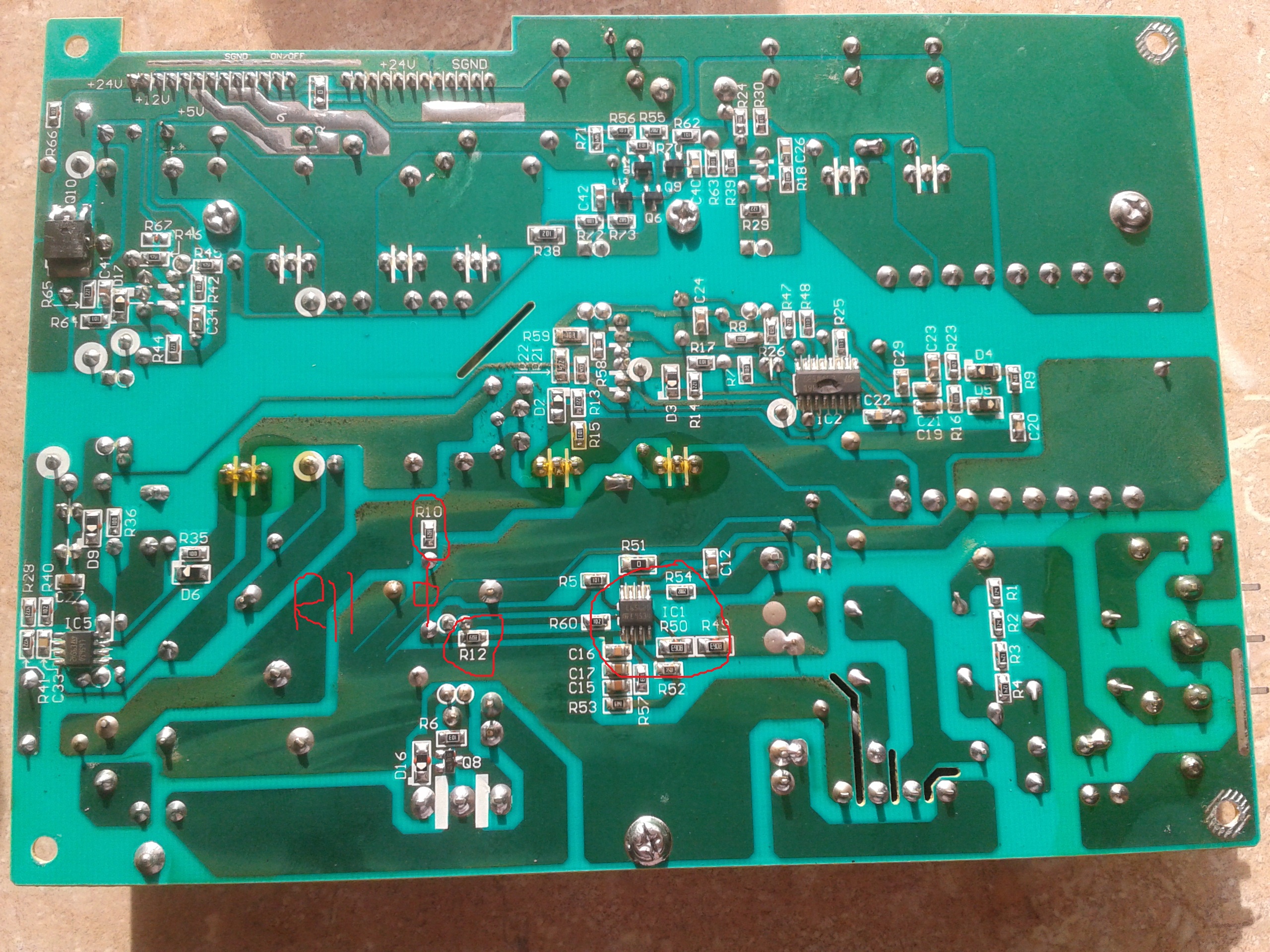

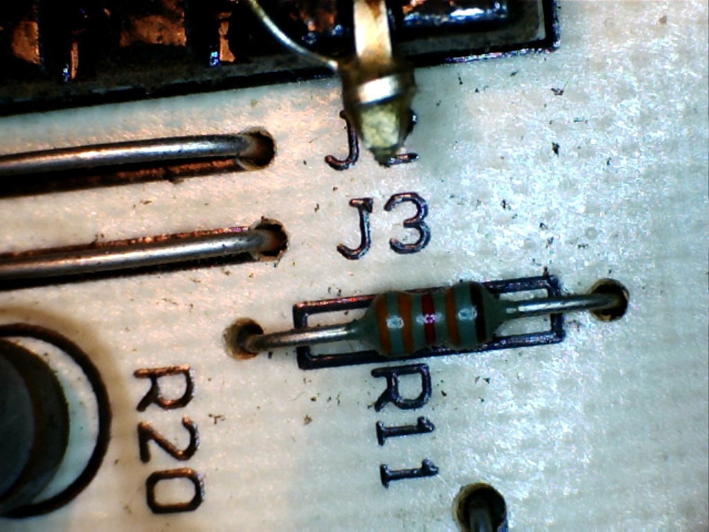

                            Cant find a resister going to source to neg on big cap but there is on from drain to positive R10, which is measuring 0.24M ohms in circuit. It says 3323 on the resister, is that 332k ohms?
                              This pic might be better, it showing straight connection from source to neg on cap and the other fet going to the ic2 I changed.
                                Could this be the PFC path going to pin 1 of ic1?
                                R10 goes to R11 "throu hole" not the neg of big cap like I said 2 comments up.
                                R10 R11 R12 are connected in series "3323 0.24Meg 3323"
                                R11 is orange orange red orange gold
