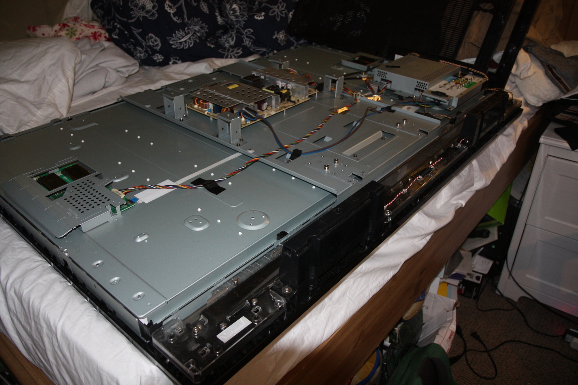

    1. I disassembled the TV, removed all the boards to check for burned components or failed capacitors and found nothing obvious.
    2. While doing this I accidentally dropped the metal cover from the T-con board onto/across the two heat sinks on the power supply board while it was on... so yeah I thought I'd try to use my PS as a welder it it only worked momentarily!
    3. I resoldered a new T8A fuse to the power supply board and checked all voltage outputs with only the power supply board and the main board plugged in (for the turn-on signal). All voltages checked out within a few percent of the rated voltages, although I was thrown off for a minute because the 24VI stuff doesn't reference the chassis as ground. Took a minute to figure out it had a different refrence, but then it was also ok at 24V.
    4. I then started plugging in additional boards one at a time... T-con first, then master invertor, then slave invertor. Until the invertor boards were plugged in, there were no issues with power supply cycling/turning off/clicking.

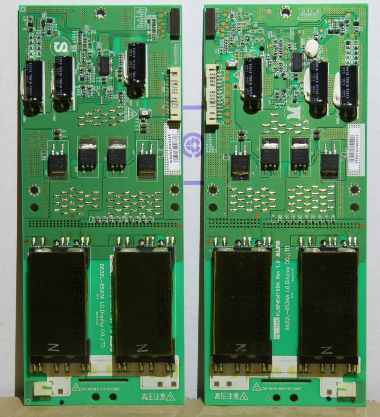

    If a new inverter gives the same problem, then you likely have a backlight issue with bad cable, bad lamp, or arcing somewhere.
    This would possibly require disassembly of the panel to replace\repair which is tricky to do without breaking it.

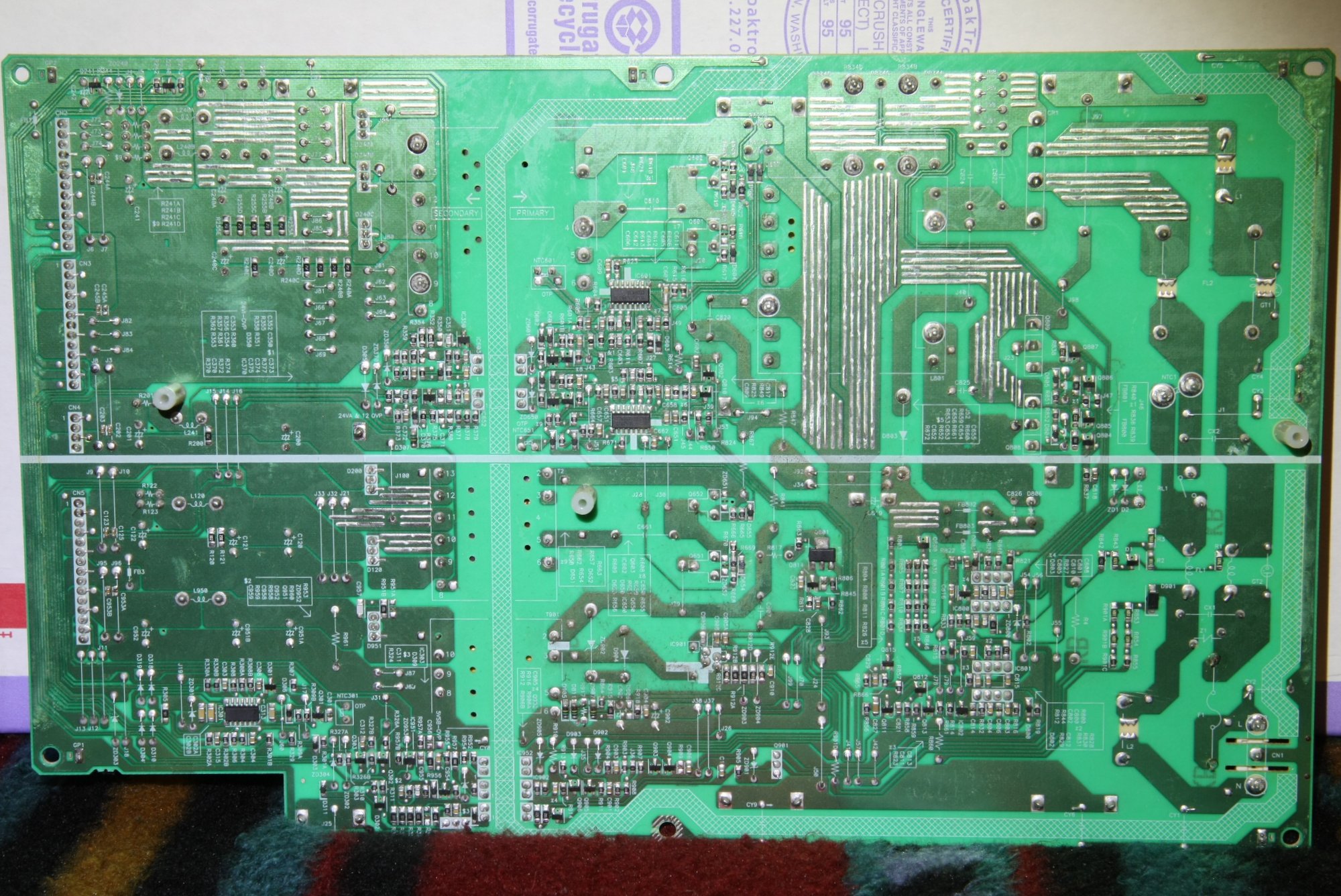

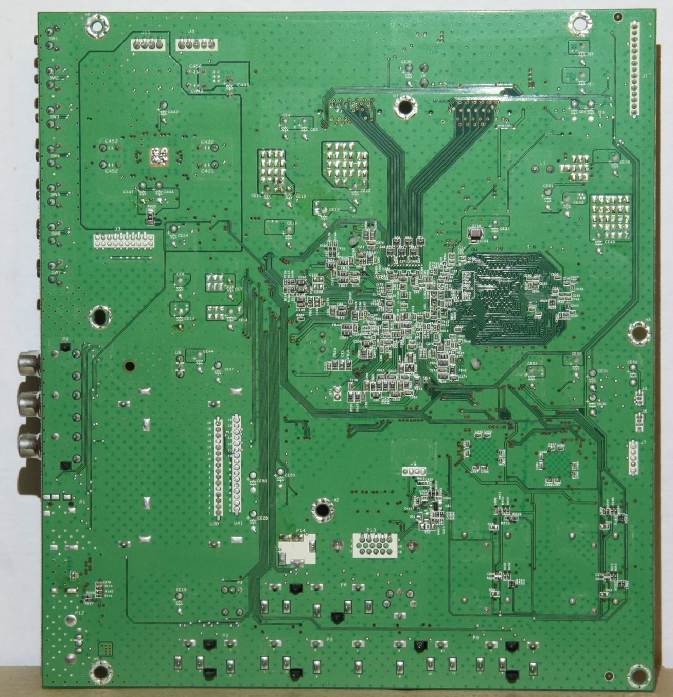

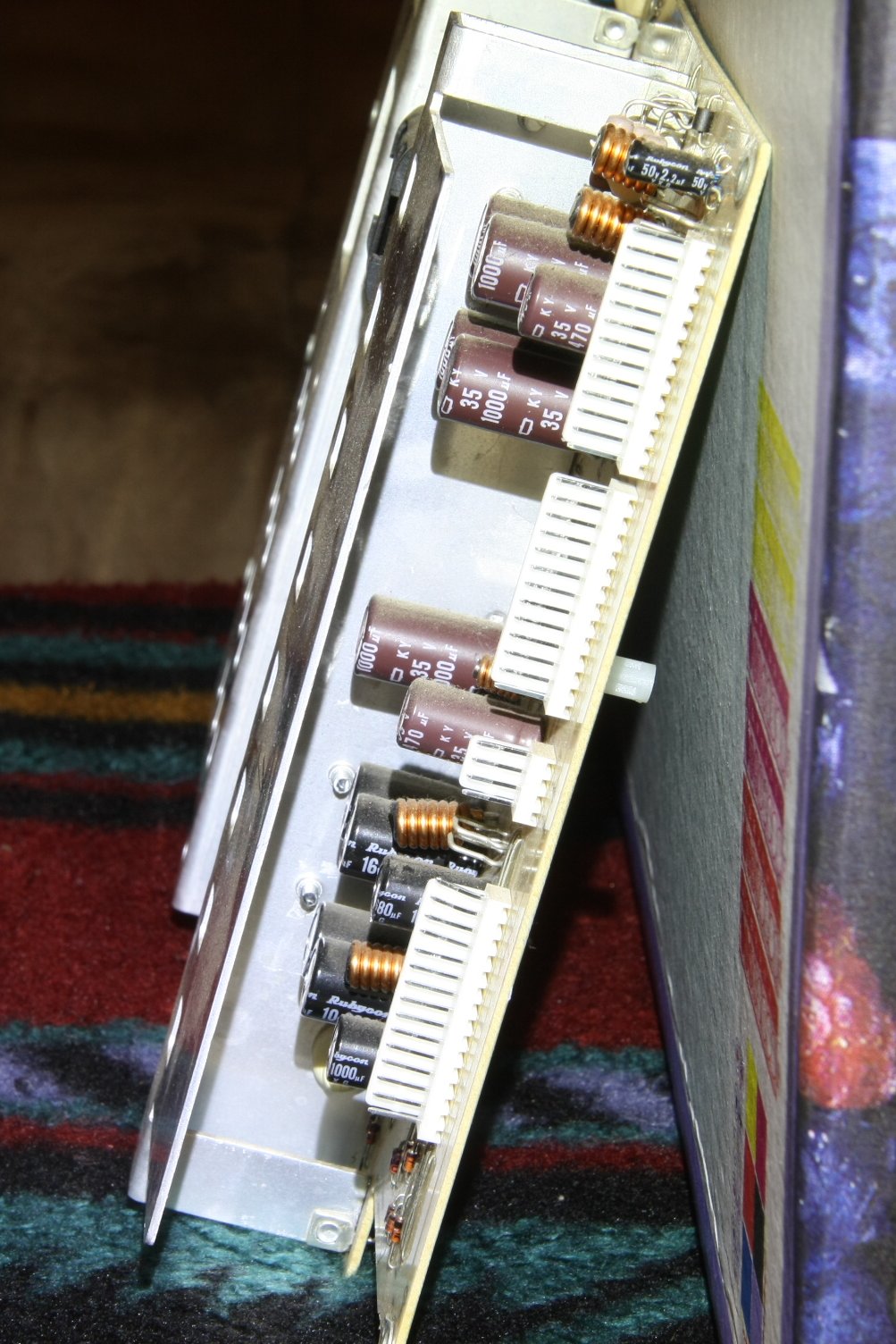

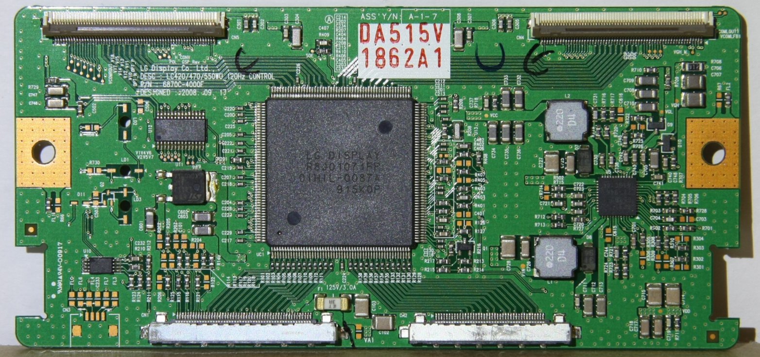

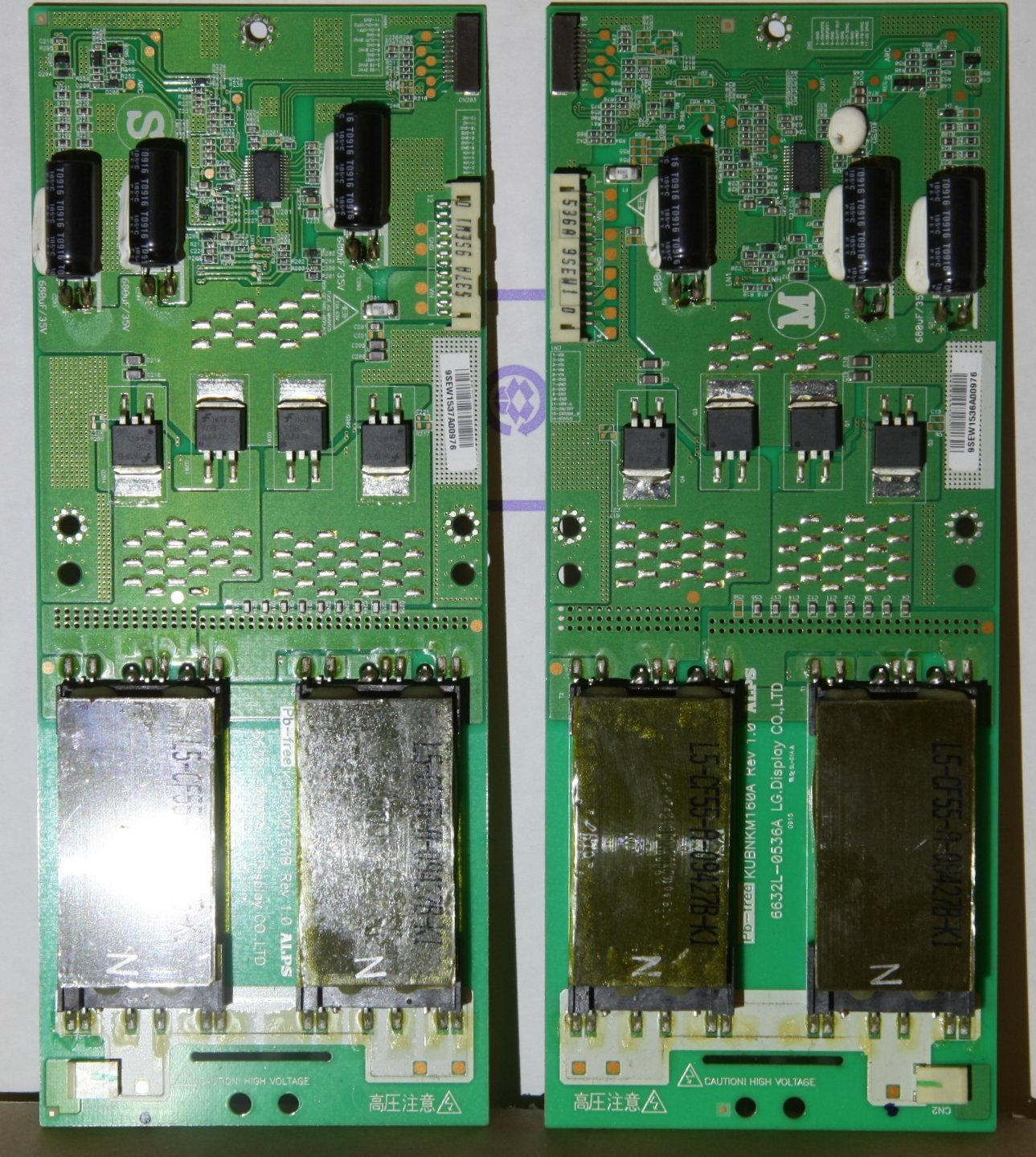

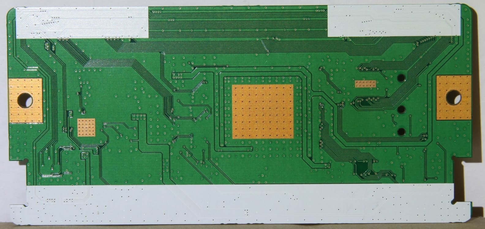

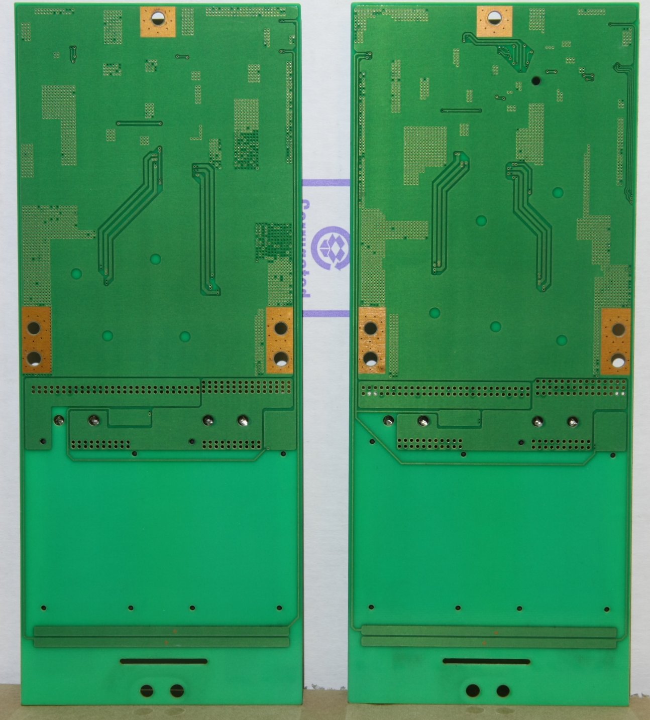

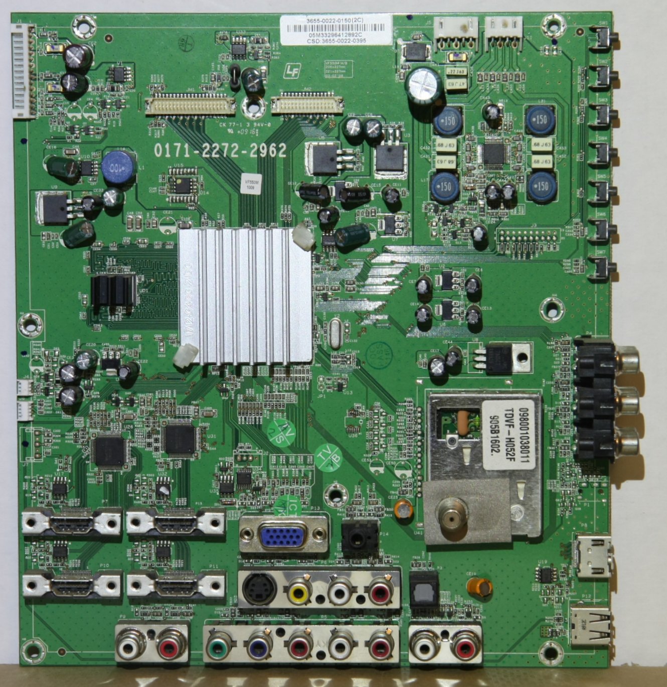

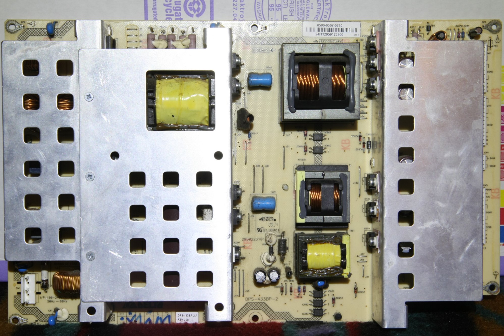

              Okay, here are some pictures of all the boards. I didn't notice anything terribly out of the ordinary... but maybe some better trained eyes can see... The new power supply and invertor boards are not yet in, so I haven't really tested anything else other than listening during the flicker a little bit. There was quite a hum coming from the invertor boards, and the large transformer in the middle of the power supply board (near the top) sounded like it was arcing inside... it had a sort of high frequency spark sound; higher frequency then the actual flickering...

                So I'm thinking (and hoping) more and more that this is going to be a power supply issue... but in case it's not, I was looking into alternative solutions, i.e. if some of the CCFL bulbs are toast or partly toast. I am putting this information here for information/documentation only. I called this place in Nebraska ((402) 330-2222), http://www.ccflwarehouse.com/lacclaforlcd.html in hopes that they could help out with a few of my questions. They were very helpful in guiding me into how I might select the correct CCFL replacement, but also very skeptical about whether it would be worth the cost. The CCFLs are at least $20 each, and a set of this size probably has at least 24 CCFLs (I haven't removed the panel yet to see). At any rate, I think the power supply is coming in the mail today, so I can rule that out first.

                    I got my new power supply board in the mail today. It looks like that was indeed the culprit in this case. It appears to me that the problem was in the main transformer... on the dying one you could hear arcing coming from the transformer. Not sure if that was the only problem with the board, but that's the one that seems most likely to me.
                    They jury is still out on whether this fix is truly done, but it has been working great for the last few hours, event with 100% backlight.

                      Good to see you appear to have the problem solved
                      One thing it could be is cold solder joints on the transformer pins where it connects to the PCB. I would have a look at the joints on the transformer you heard the noise from. Post a macro shot of them if you wish. If you're interested and they look bad, you could try reflowing them and seeing if it fixes the problem.
                      Otherwise, If there was actually arcing *in* the transformer it would probably due to insulation breakdown, either from age, crap quality insulation, or external damage. It may be possible the PSU was faulty and overdriving the transformer with a higher voltage, but I think this is very unlikely.
                      Suffice to say in such a case a new PSU would probably be the best you could do anyway - repairing the transformer would likely require expensive rewinding, and good luck finding a replacement one!
