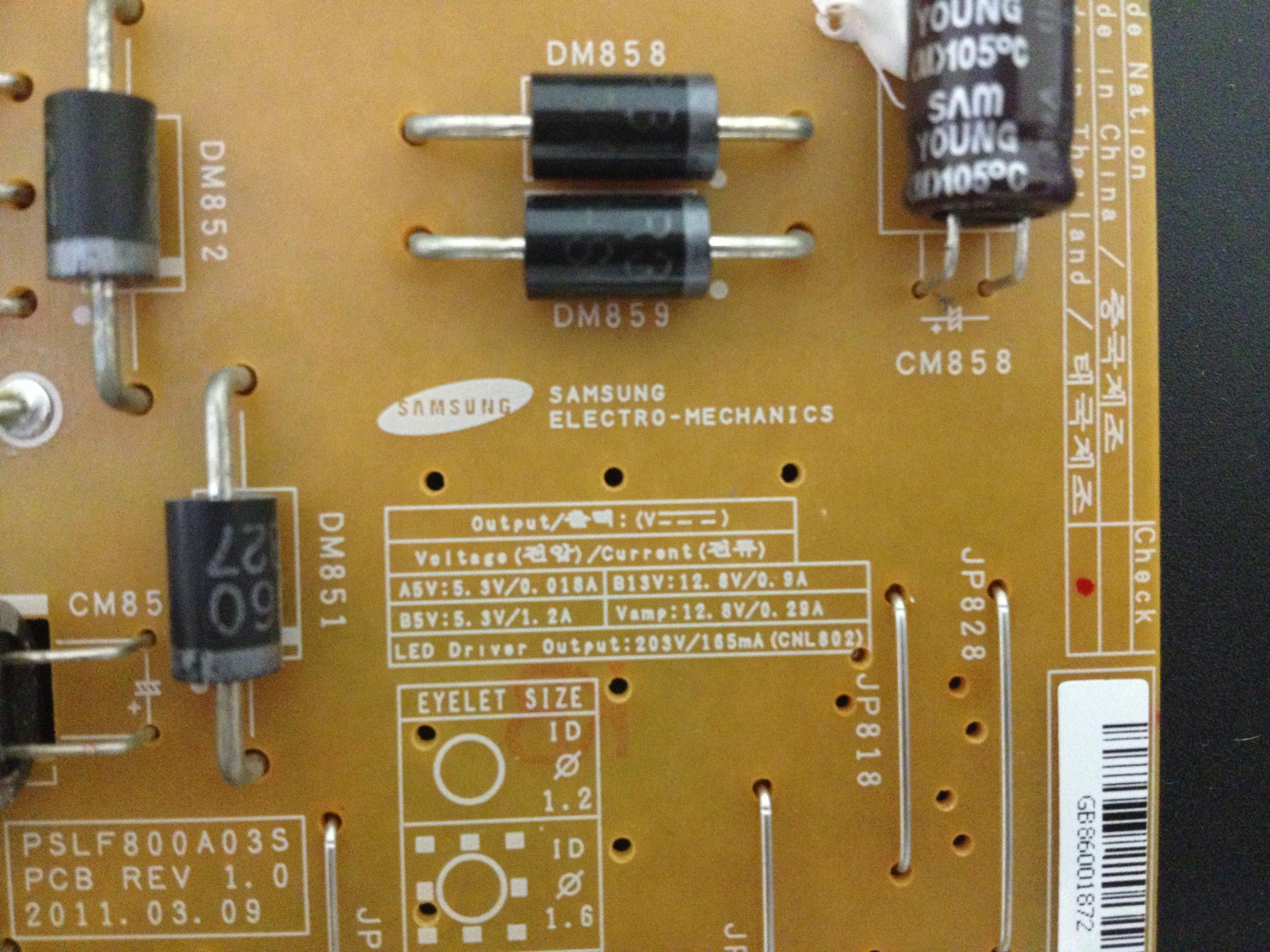

          Re: Samsung UA32D4003BM 32" LED NO POWER
          OK tom, i will cut the black wire tommorow and update it 2:41 AM and i need to go to college tomorrow morning,
          just found this ref on the board, any idea what does it say?
          about the power of the set, im really not sure it doesnt say,
          could be 70watt? sounds a bit low...
            203V@ 165mA, so it seems to me that output voltage is too low since you are only getting 145V, there should be IC for the LED driver circuits that has voltage booster circuit to boost the voltage up to 203V. I would expect the LED driver circuit to go into shutdown if it detects no current flow so I do not expect to see any voltage at the output pin. I need to find the SCH.
                  so i cutted the black wire (had 12vdc), and connected the multimeter in series to it.
                  got no current, checked for dc or ac and got nothing. measured on the mili range.
                  any ideas what to test on next?
