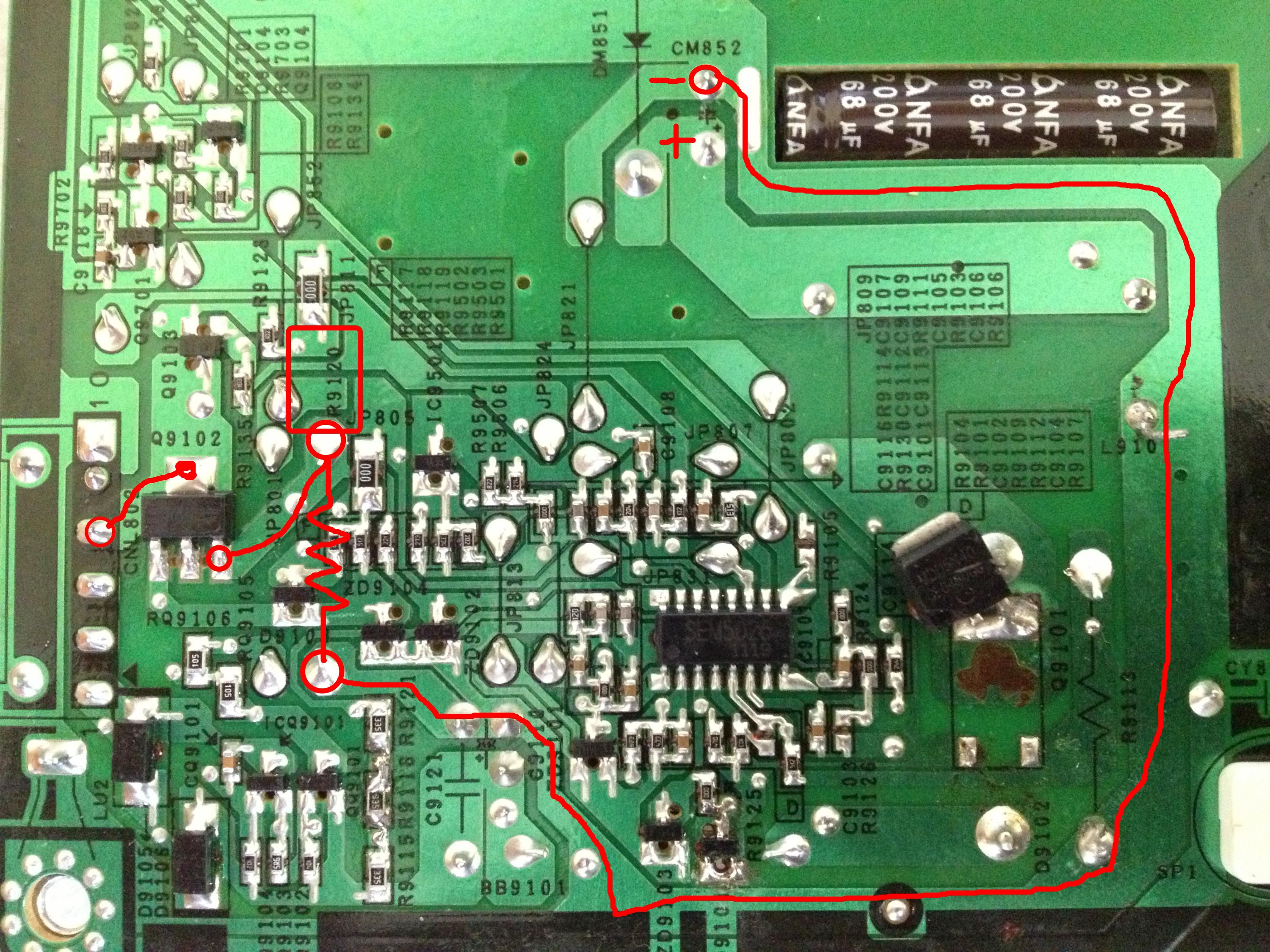

      It wasn't the caps, i lifted the psu board and the logic board up on carton away from the chasis, (everthing still connected) and got 220vdc on the blue wire and 80 on the black wire, and another maybe stupid thing i don't feel breakout voltage when touching the chassis as i felt before.
      by the way Q9101 is actually D9101, weird package for a diode

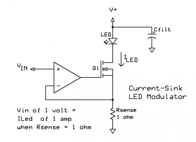

              What you could try: if you feel up to it, build this very simple circuit on a breadboard. Use a 400V sink FET or higher. It regulates sink current:
              http://modulatedlight.org/optical_co...ent_sink_2.gif
              This will help you safely test the LEDs and it's the most ideal way of doing it, but it's fairly complex. Good learning project, though.
              You could also use a resistor, but the risk is you don't know what the forward voltage of the chain is. But you can make a guess. That SOT223 sink transistor shouldn't ever dissipate more than 1 watt. Assume I=165mA. This means V must not exceed about 3 volts.
              So the series chain is 200V (e.g. 4V/LED, 50 LEDs in series.) So you need to drop 3V at 165mA so R=18 ohms. Use an 18 ohm, 1W resistor and carefully monitor current. Maybe start with a bigger resistor first, to protect the panel LEDs.
              Apply this formula for Vs=220V if you like, though that voltage might drop under load.

                tom66, i would like to open the panel as a last option,
                (I never opened an LED panel before, but i replaced an lcd bulb on a SONY VIO laptop a few years ago, (was a pain in the ***) but worked.
                About the project you refered to, any recommended parts, as for the comparator, Q1, Cfilter,
                The other option as i understand, is less recomended, to use an 18 ohms 1Watt resistor instead of the LED

                  I think 80V reading is an error, as you can see the Drian pin of the MOSFET Q9102 is connected to the LED connector, the Source pin is connected to the current sensing resistor R9120 the other end of R9120 goes to ground, the Source pin is also connected to the resistor network to goes to the LED driver IC.
                  I do not know which ground point you are using to make the measurement.

                    I suspect the transistor is used as a linear regulator for the current, so the voltage drop across it would be an unknown (dependent on the base/gate voltage, the current flowing through it and the parameters of the transistor.) Most likely it is an BJT NPN due to the linear relationship between base and collector currents.
                    This is different from some sets which regulate current at the boost converter.

                      Comparator: actually it's an opamp, LM358 or LM324 is a good choice, make sure to run it from a 12V or so power supply. Do not attempt to run it from the 200V!! A 100nF capacitor across power and ground of the opamp is a good idea.
                      Q1: any MOSFET, 250V or more. For example a 7N50.
                      Cfilter: omit this part it is not necessary for this system.
                      Maybe size Rsense to 10 ohms, giving you a voltage of 1.65V at 165mA rated current, i.e. 10V/amp. Use a potentiometer for Vin to vary the reference set point voltage. Consider a 100nF capacitor on the wiper.
                      Test the circuit on a power supply before use and verify its functionality, you do not want to potentially damage the LEDs.

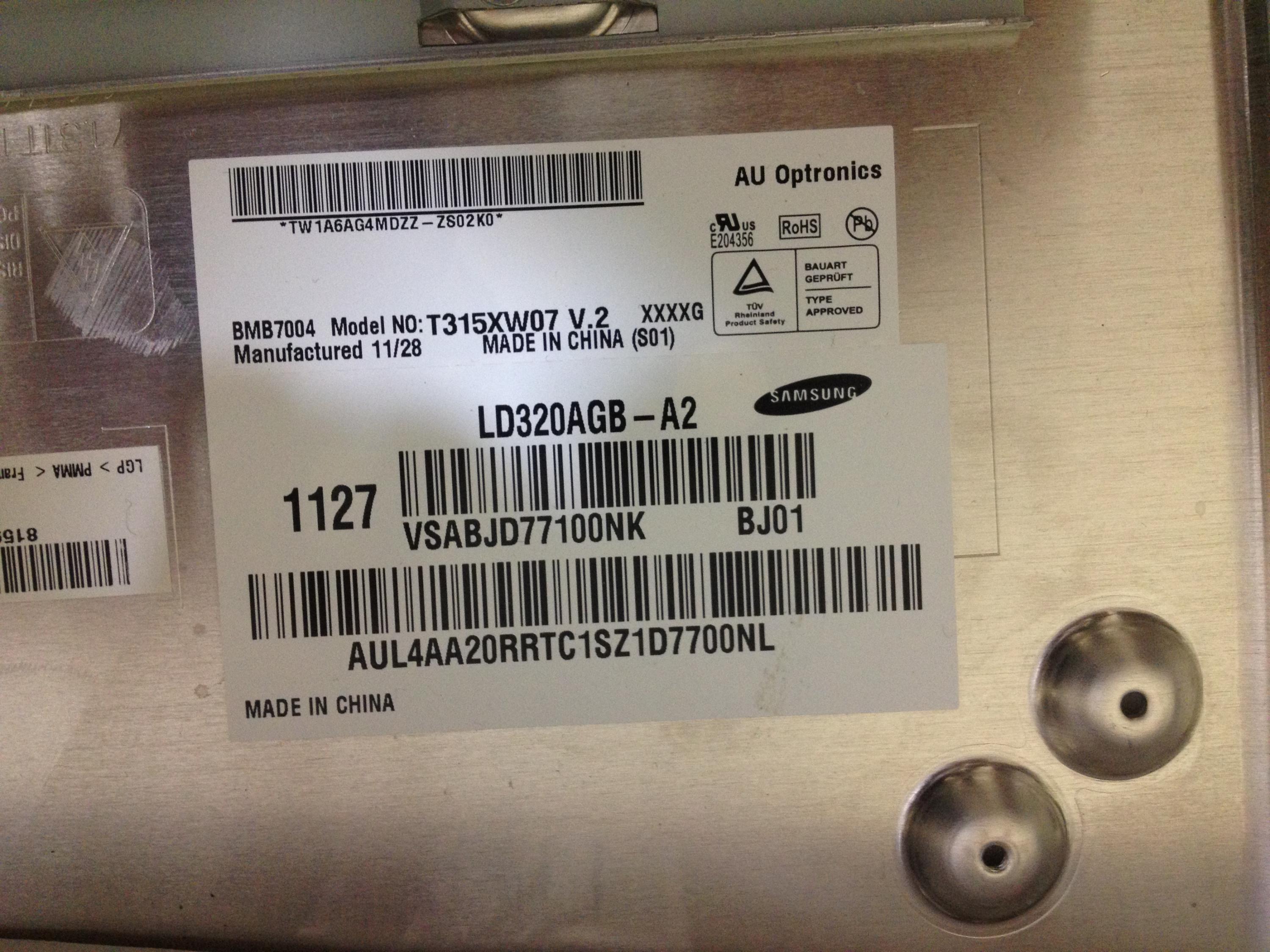

                            Can you give us the LCD panel model number? The spec will give us the info about the LED set up.

                              Re: Samsung UA32D4003BM 32" LED NO POWER
                              Ok retested voltages, at start got 146vdc,
                              after messing around with it, got 210vdc on blue 70vdc on black
                              added a picture of panel sticker with all the info.

                                          tom66, sorry for the delay i had a test last week and couldnt find time to deal with this project.
                                          just to clarify i understood the circuit.
                                          vin is the +12v for lm358?
                                          v+?
                                          and is 2n60b suitable?
