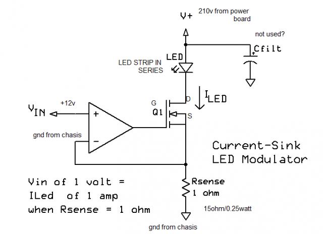

    Vcc for the LM358 can come from a 9V battery or other power source minimum 6V maximum 30V.
    You can use 2N60B.
    V+ is the 210V.
    The one LED would be replaced by the whole strip.
    The circuit ground connects to the TV's chassis ground so the current can return.

                            #73
                            Re: Samsung UA32D4003BM 32" LED NO POWER
                            i've tried the above diagram but got no change,
                            any more ideas before i try to order a new psu board?

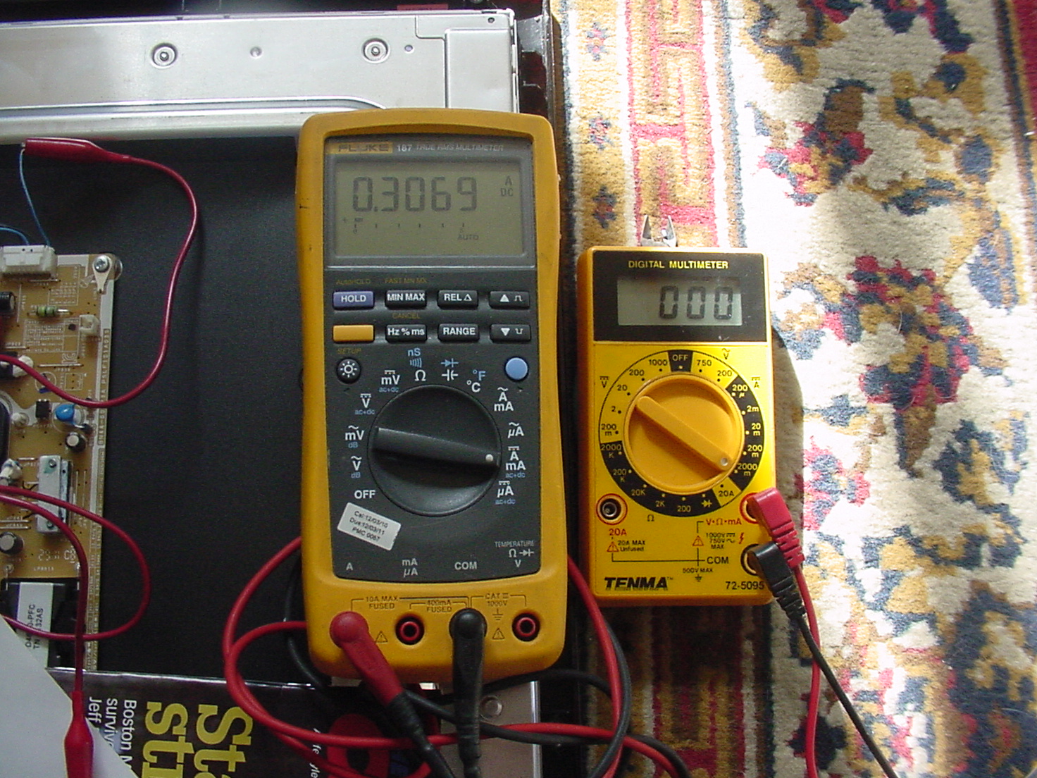

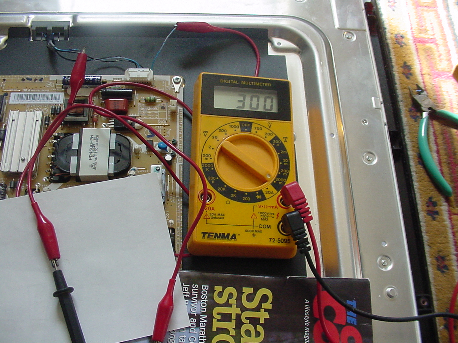

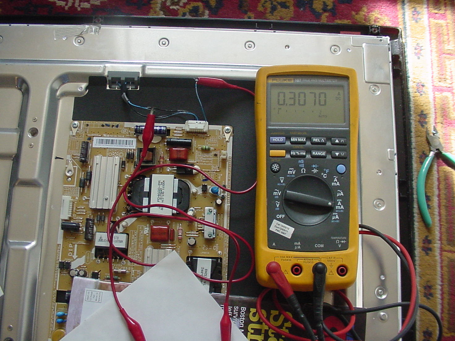

                              #74

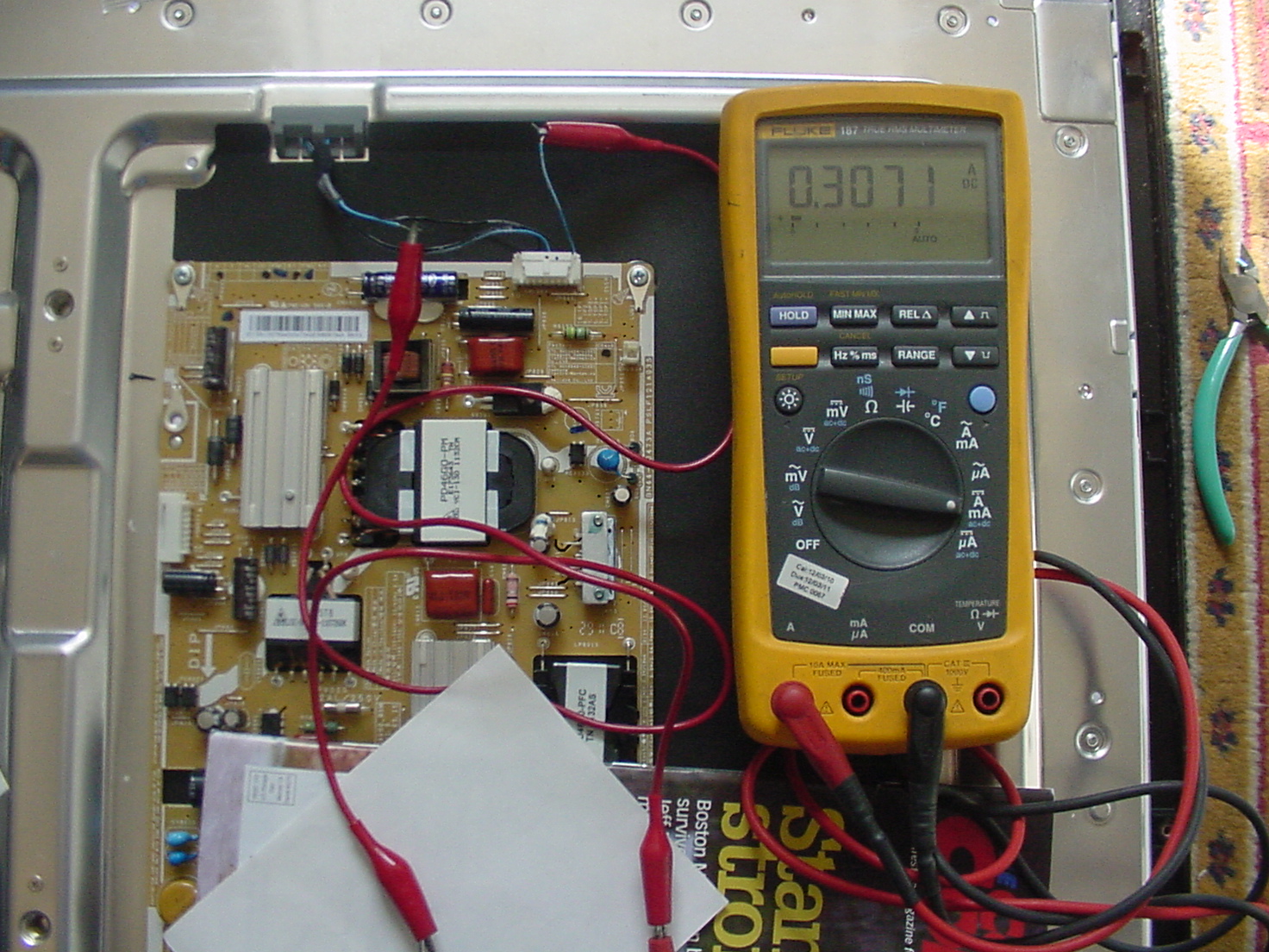

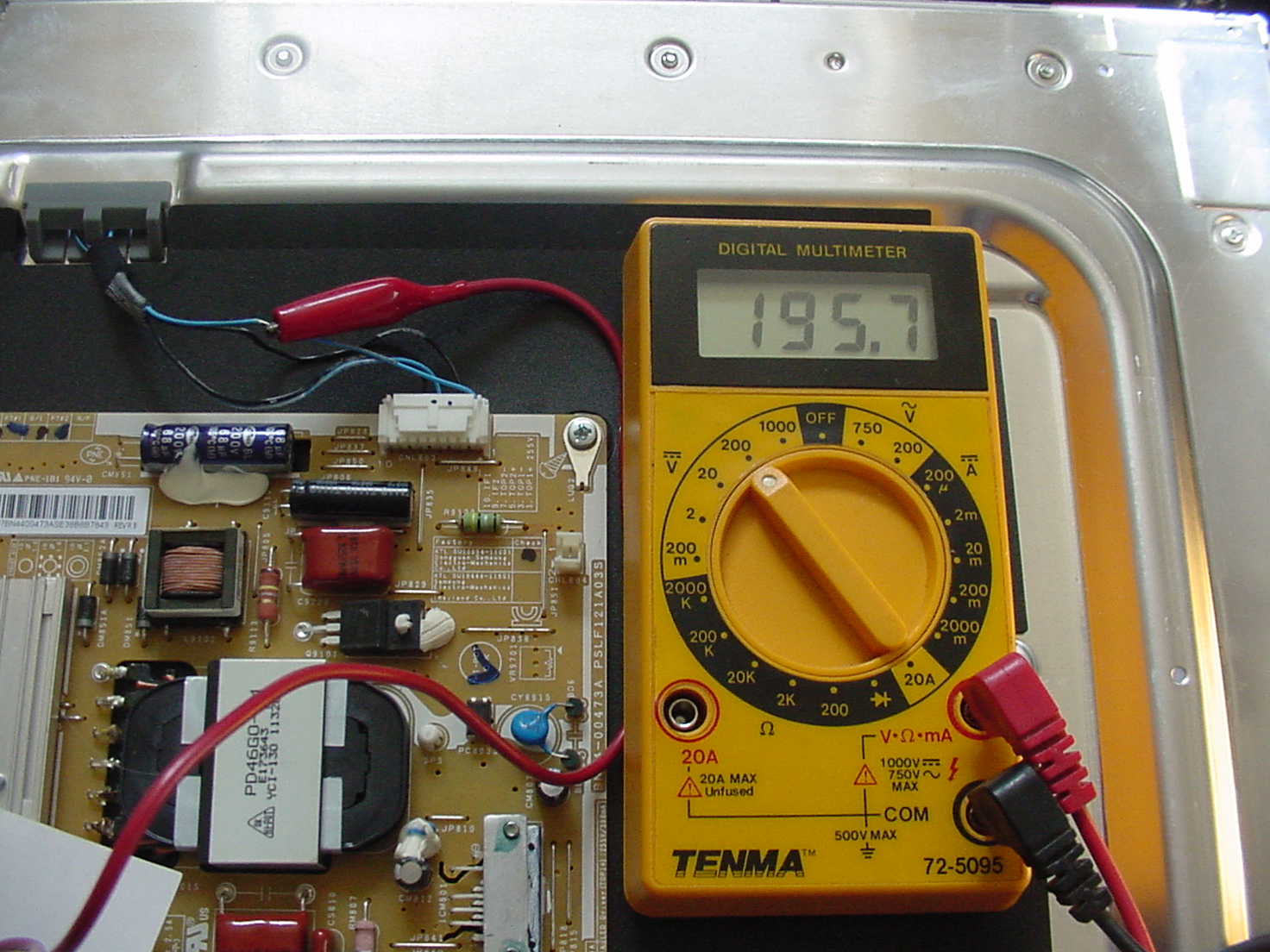

                              This is to show what you can do with your meter, you can use cheap TENMA meter or hundreds of dollar meter (FLUKE 187) to check LED backlights voltages and current of the TV.
                              Frequency of the output is 90KHz. I have done many and enough for verification of open LED strings. The DC is average reading but at least it shows you do have voltage and current if the string is not open.
                              This is SAMSUNG

                                  #76
                                  What do you mean? You do not see the LED light up? How did you power that OPAMP? Try scaling down the voltage so you you can use 12V lamp to see if the circuit that you built is actually working.

                                    #77
                                    yes the led will not light up,
                                    the tv keeps blinking.
                                    i powered the OPAMP with external 12v 1a adaptor.
                                    (maybe i wired it wrong?)
                                    could you have a look at the diagram i have updated?
                                    where goes the (-) from the extrenal adator?

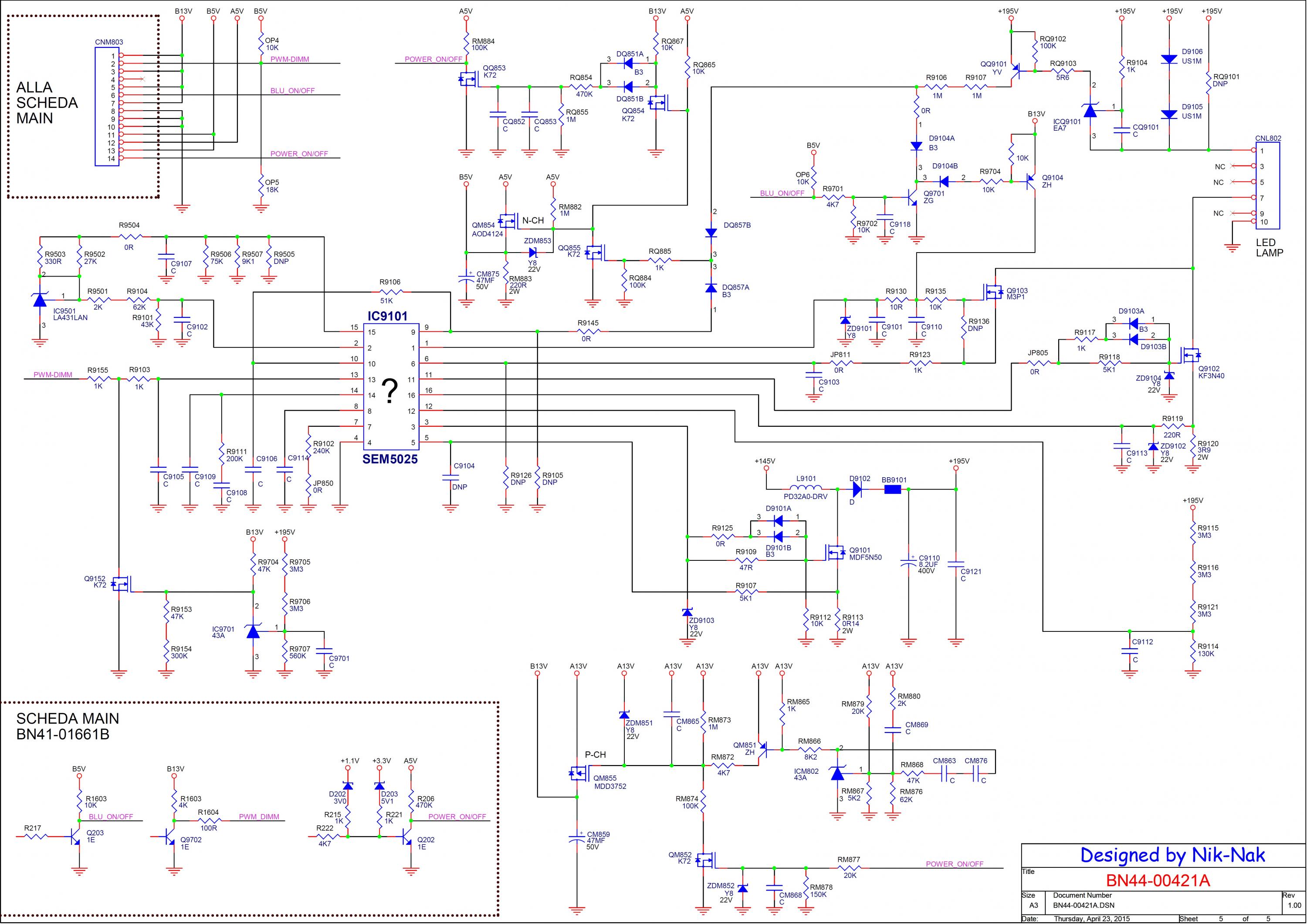

                                          #80
                                          Hallo all
                                          I think this circuit help you .
                                          the inverter not working it is suppllied with 145v and raised it to 195v by buck inverter .
                                          i solved this samsung there is bad mosfet QQ854 . THE ON/OFF CIR IS BAD AND THIS CIR IS APPLIED TO MORE THAN ONE SAMSUNG TYPE .
