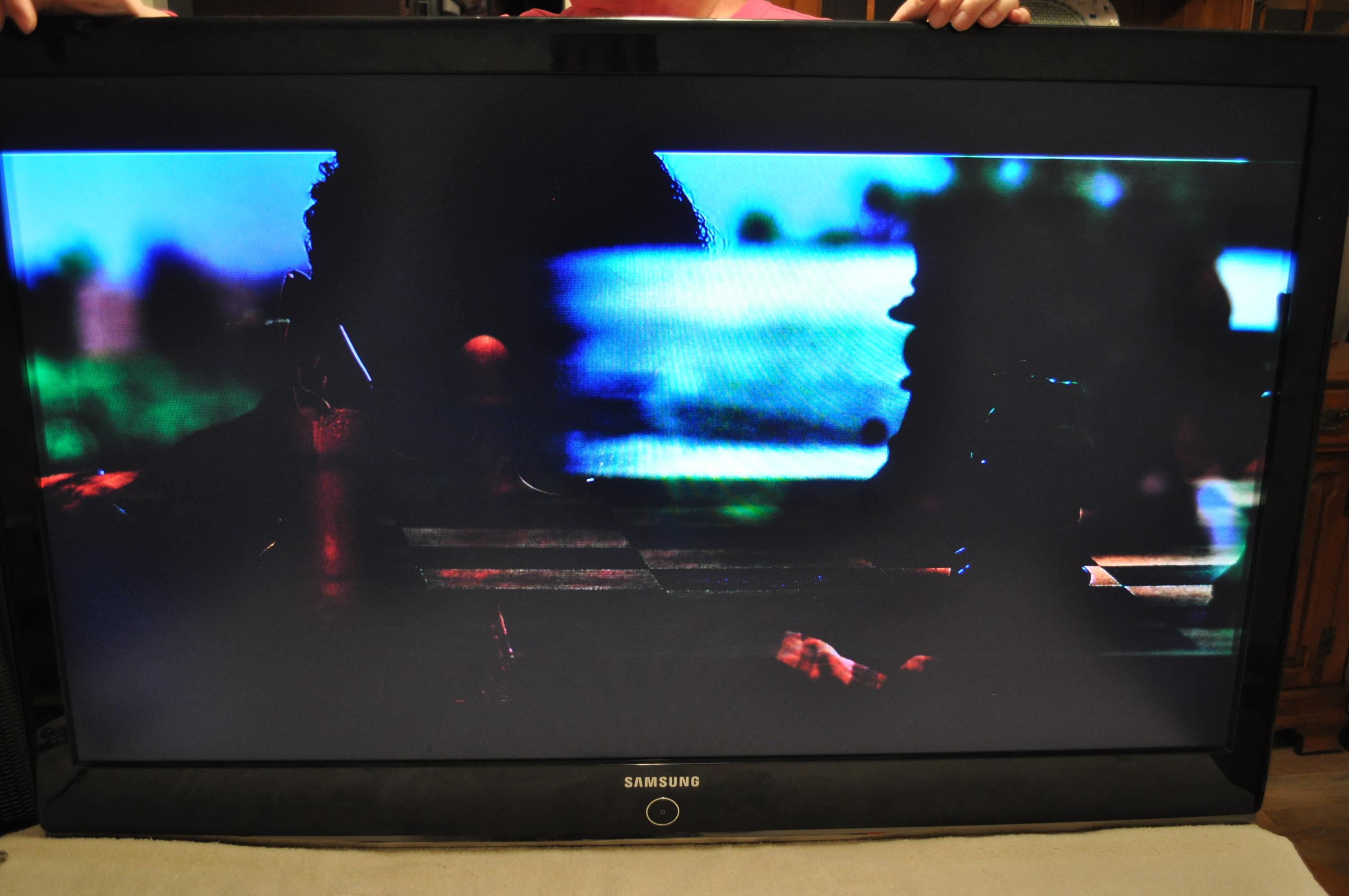

    Picked up a Samsung with power issues. Replaced several bad caps on power supply, now it powers on but I get this (see pics). I have pressed all around the screen and I don't think it is a tab bond issue. Could this be a bad TCON?

    Or possibly a bad main board?

      Ok i replaced the TCON today and no change. Some observations I have made: Most white colors or ok seems to be only dark images. Could a bad main cause this?

          Re: Samsung LNT4661fx/xaa
          Bad panel, I had the same model with the exact same problem. I replaced a known good tcon and afterwards it played 4 inch vertical bars so put back the old one. I'm guessing the old tcon board had something shorted in it which let it at least play a picture but with that dark contrast instead of bars.

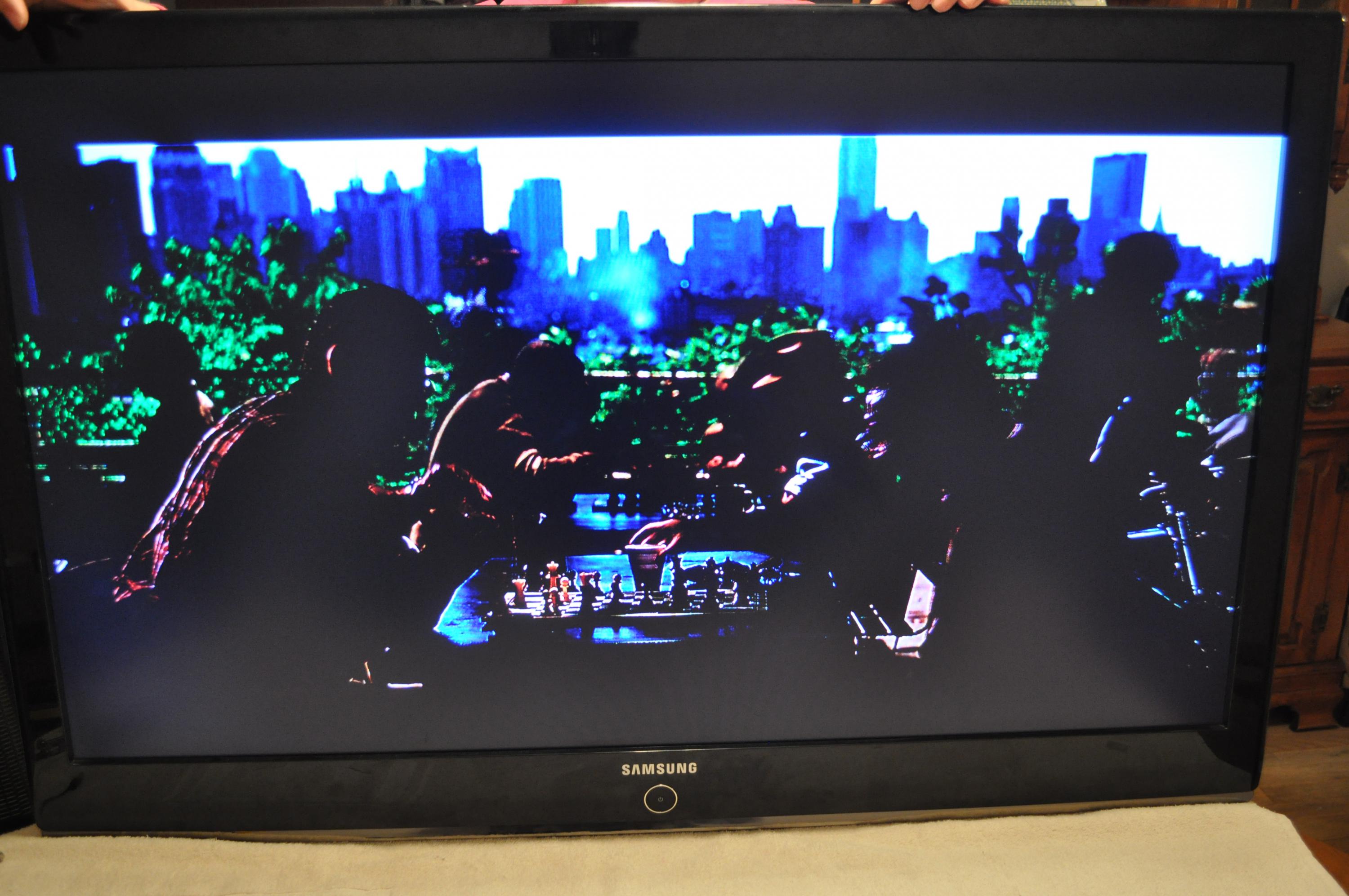

            Haven't worked on this for a while but I came across another mainboard and tried it now the picture has changed but is still bad. I don't disagree that it maybe a bad panel but I thought I would try a different main.

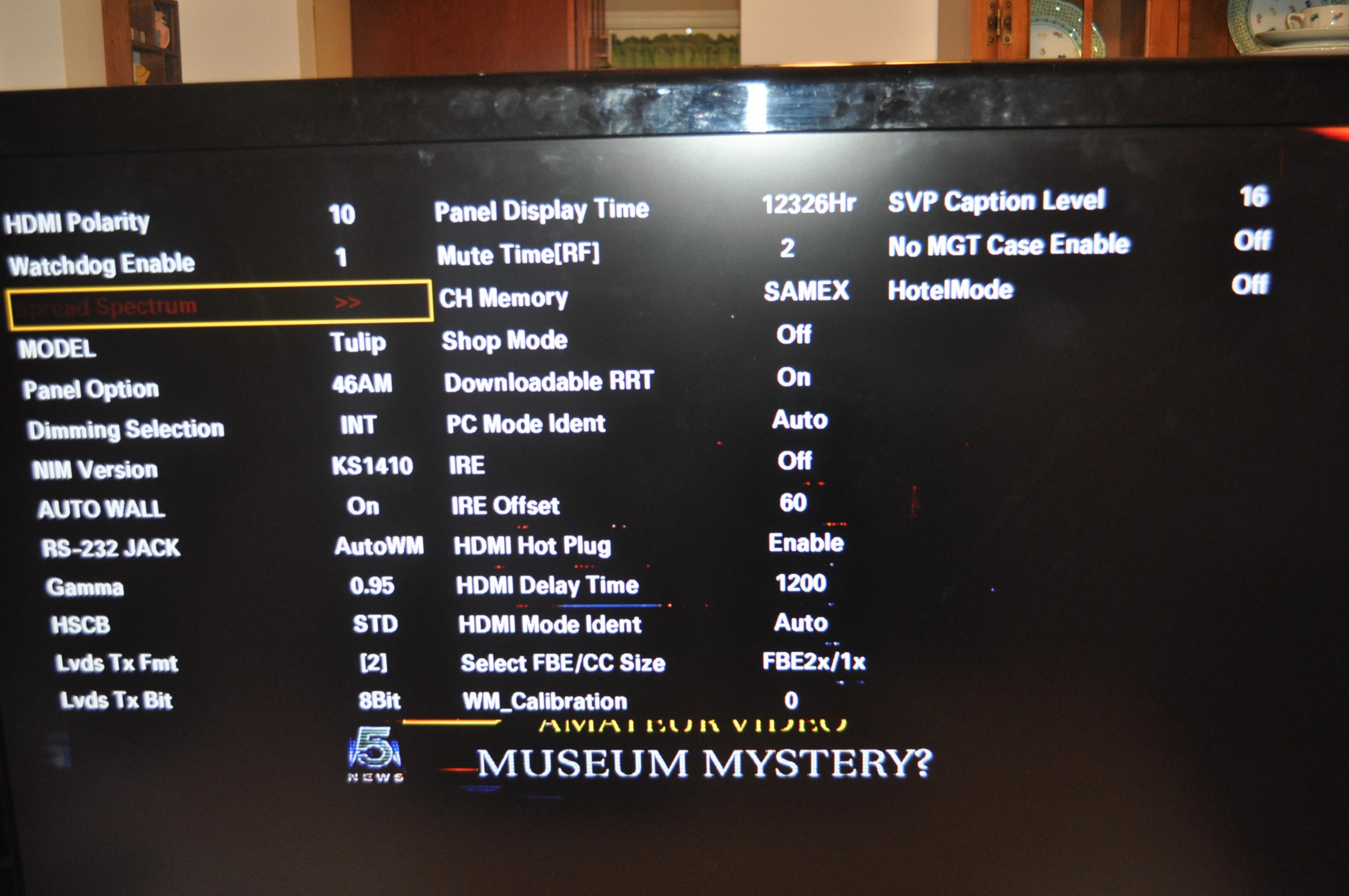

              panel adjustment in the service menu.
              TV off, MUTE and press 1 8 2 and power on the remote.
              There should be a setting in Option Byte with the LVDS options PDP, JEIDA, VESA. (also make sure to have something playing in the background on HDMI 1) helps you see the changes made if any.
              write down your settings before changing anyting once you change something you cannot go back (factory reset) you are programing your panels EEPROM. If you go back and set it to what you had before that will work.
              If the VESA deal doesn't work try changing the panel type if you can.
                  Ok was able to get into service menu. Got to the option Bytes but the LVDS had only two settings that you could adjust Lvds Tx Fmt and Lvds Tx Bit. I did try different setting in each and the picture would change but was never correct. I also tried changing panel type with the same results. I did this with both mains I have the original and the one I just bought (could be bad also) I checked panel hours and with original board 12k 7k with board I just got.
                    Option Byte Menu

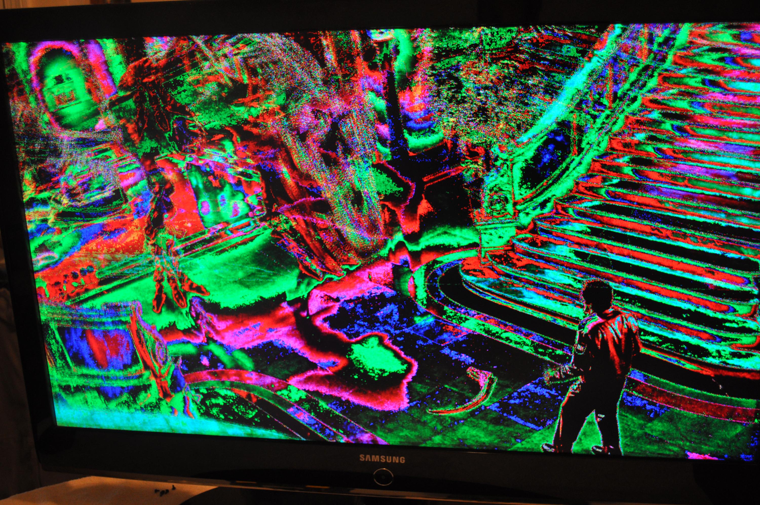

                          Have this model of tv with the same problem. Dark and very red. There were pink dots before. When I opened it up, I noticed some caps had been replaced and appeared to be the correct values. I did a reset in the service menu and it brightened things up and cleared the pink dots. Found VESA in the service menu and changed panel type with no improvement. I will check the gamma voltages in the tcon next.
                            A little further testing indicated the TV had trouble starting when plugged in. Took 3-4 restarts. Measuring the replacement caps, they were a bit low and had high esr. Replaced them and tv turns on right away and no pink dots. Still dark and red. Color seems off in the menus as well.
                            Checked tcon gamma voltages and they seem ok as well. From 1 to 18: 14.91, 13.89, 11.96, 11.39, 10.85,10.49, 10.25, 10.18, 8.85, 6.53, 5.47, 5.28, 4.97, 4.48, 3.83, 3.28, 1.33, 0.33
                              That's a sharp decline between 8.85 and 6.53 and also 3.28 to 1.33 seems like a sharp decline also.
                              Could be a cause to your dark and red problem. I would make sure that your LVDS cable is clean
                                Here are the pics. Tcon is LJ94-01904E or BN81-01312A according to Shopjimmy. Guess it's very red or very blue depending on scene. Not sure if I want to gamble replacing the tcon.
                                  That looks like a gamma problem to me. Let's see what others think.
                                    GAMMA Voltages problem to me.
                                        Used tcon on ebay arrived, I installed it and picture is normal. Looks like the big drops in gamma voltage were causing the color issues. I put the shield on and don't want to take it off again to remeasure the voltages. Thanks freakaftr8 and budm for the correct diagnosis.
