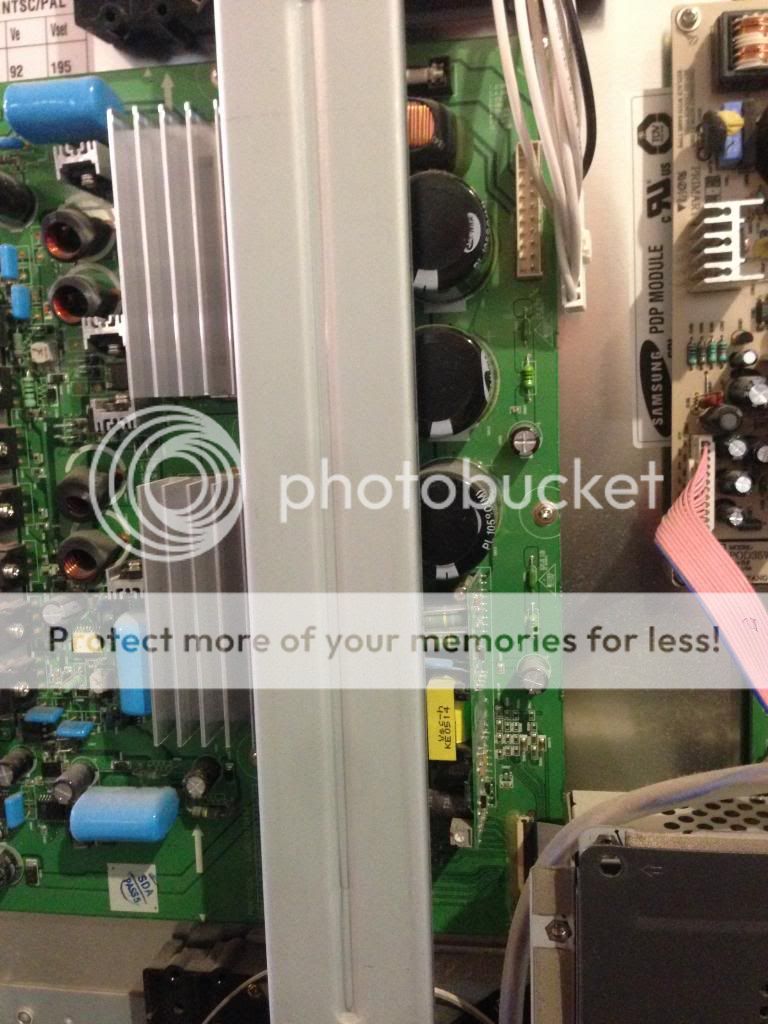

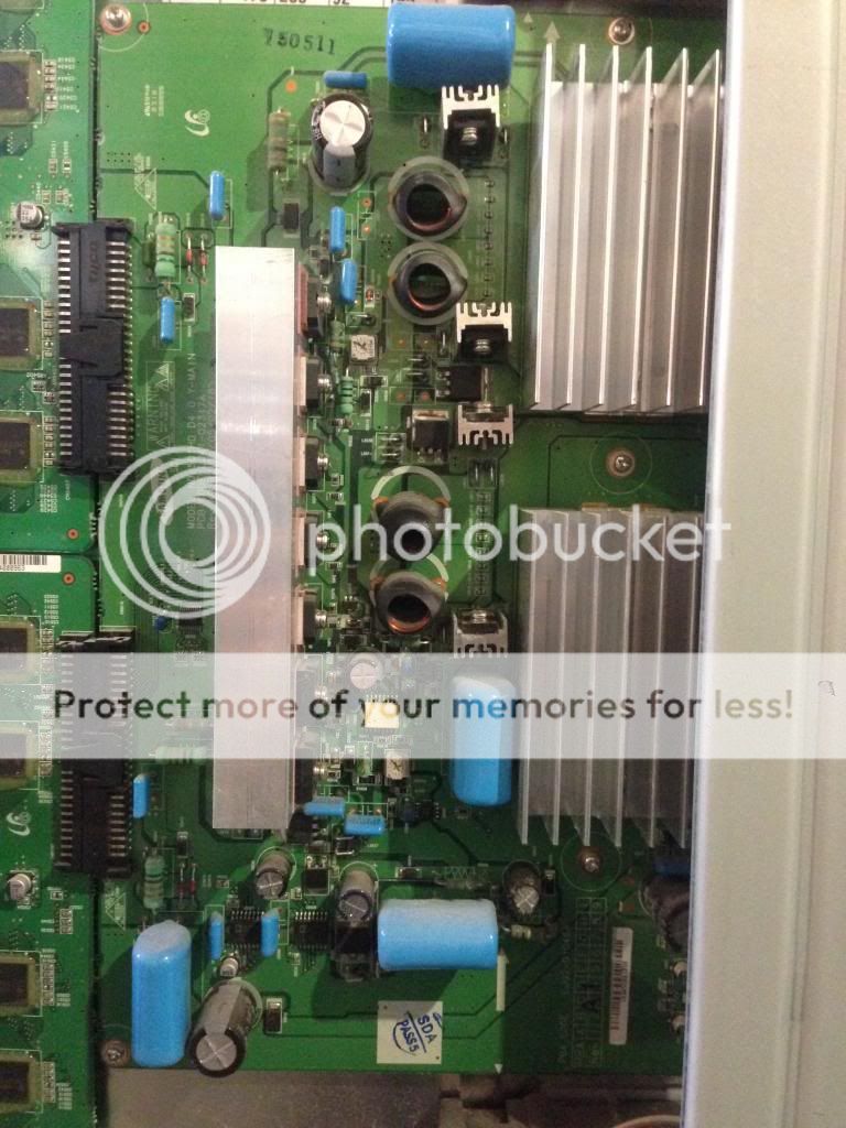

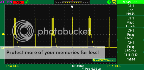

I have got a plasma that blew out it's power supply. I replaced the power supply with one from fleabay, and was happy to see that the tv now turned on, but has image issues at the top and bottom of the screen. Here's some pics:
All output voltages are set to match the TV's sticker, using a DVM they're all reading within 0.2v.
I attempted to mess with settings like the timing, but doing so only made the picture worse, and resulted in additional snow...what is being seen in the pictures is actually the best it can be(timing wise)

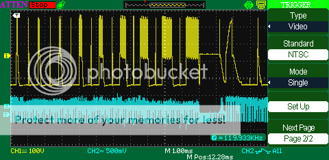

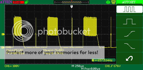

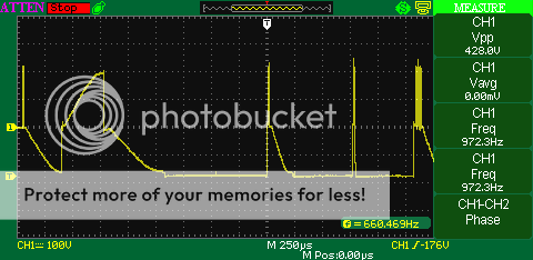

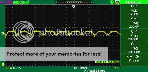

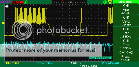

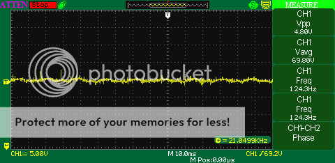

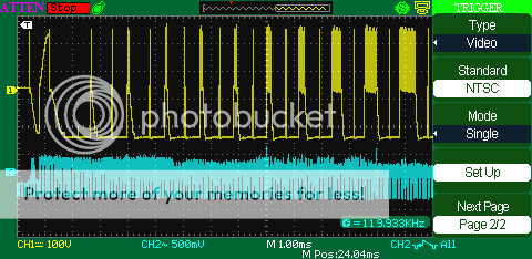

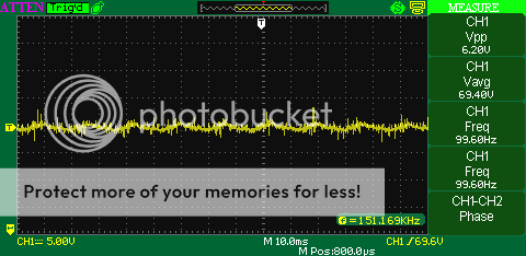

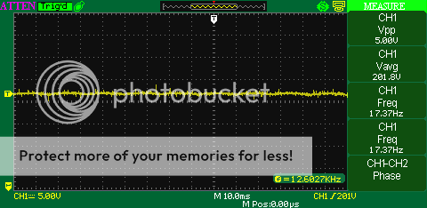

I hooked up my oscilloscope to the VS and VA outputs, and this is what I've got. (this is back probing the connectors while all still attached and powering the TV)
Any thoughts?
