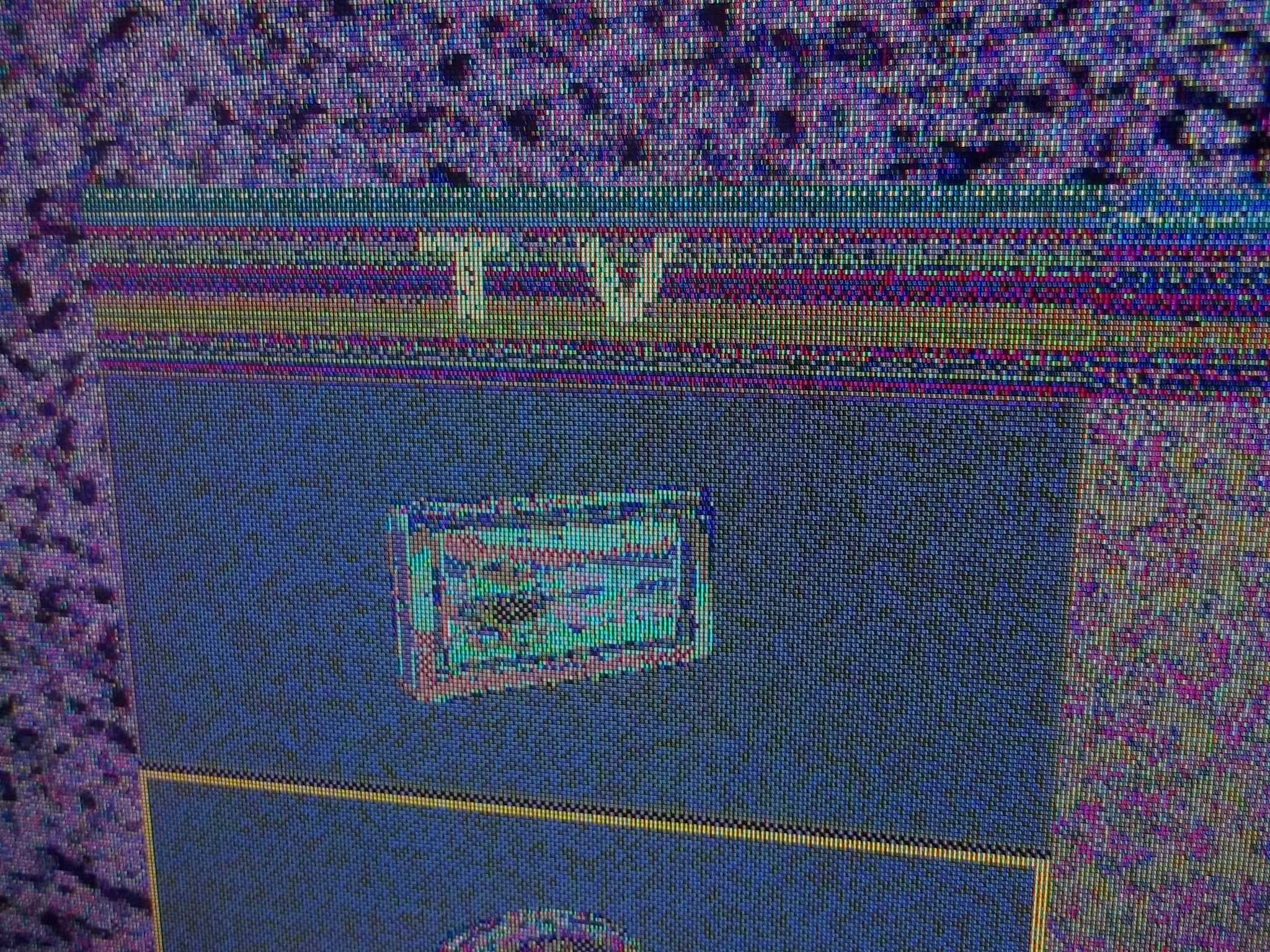

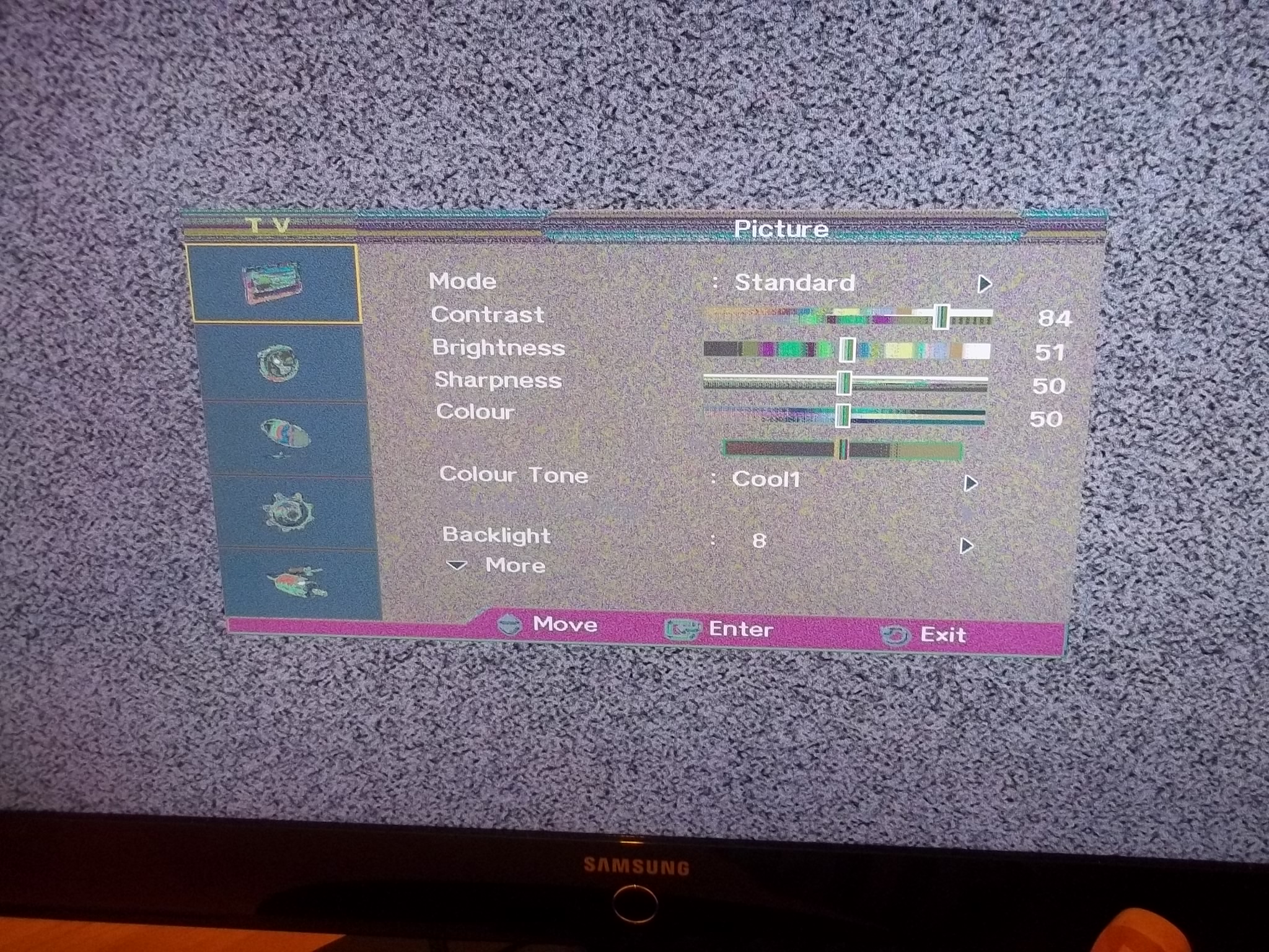

    Samsung LE40M86BDX strange colours.
    Hi, quite certain this issue is a bad T-con although I've recently tried a replacement and exactly the same issue showed it's self, that card went back as faulty so my question is: could it be something else like the main board, the panel it's self maybe? I've tried various in the service menu but nothing really effects it, thanks, Andy.

    Doesn't look like t-con, looks like LVDS setting is wrong to me. Check service menu panel option.
    From standby Info Menu Mute Power then check menus for Panel Option.

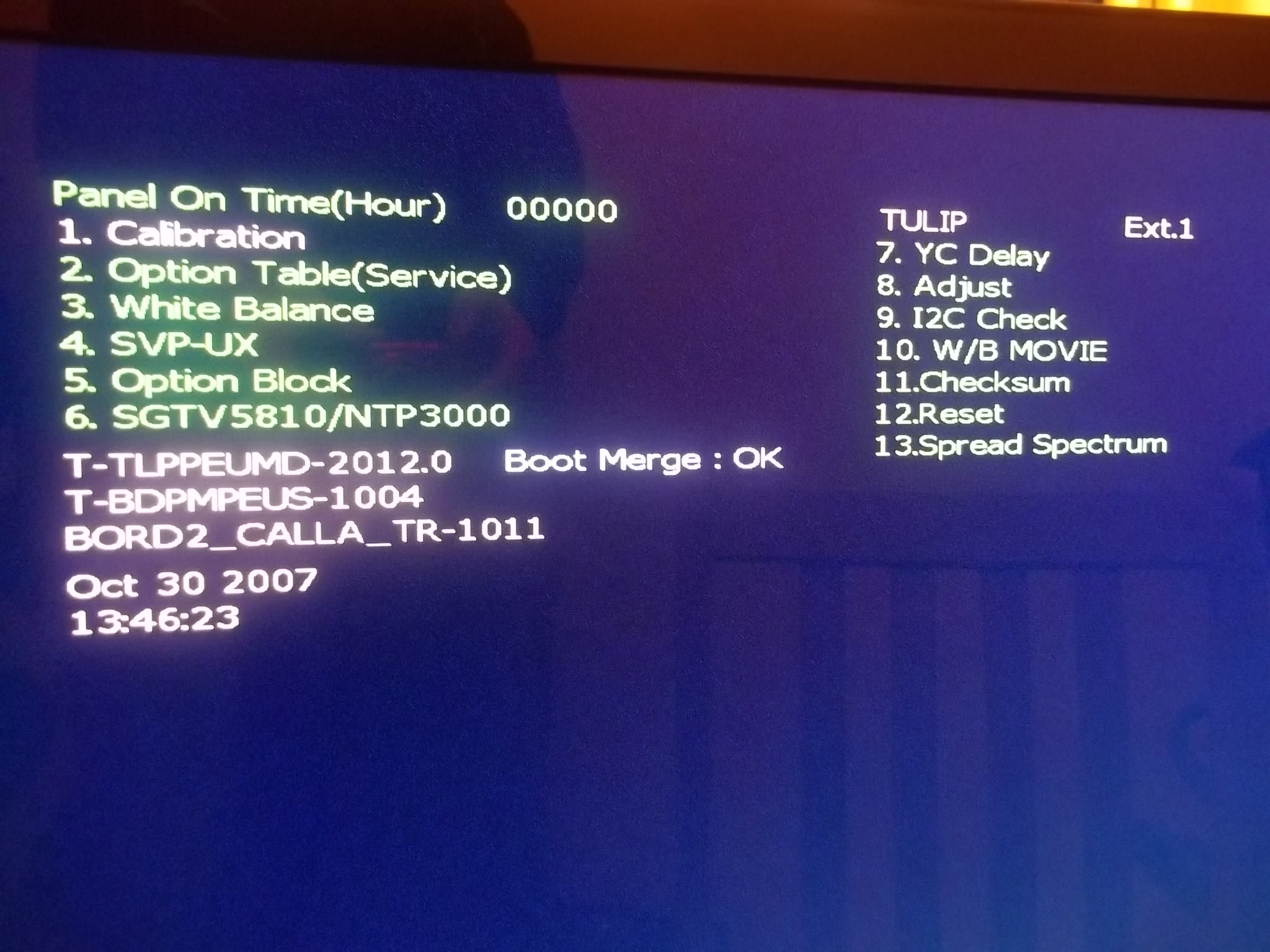

            Can you post a picture of the options available, and also what panel is installed in this TV?

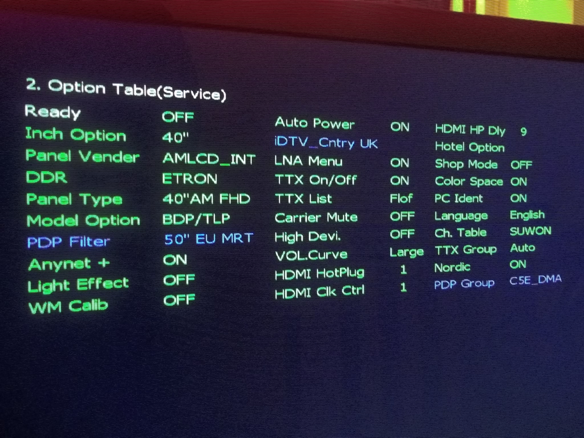

              Re: Samsung LE40M86BDX strange colours.
              This is what I see, I've played with the Panel type and vendor settings but it doesn't do much really, can brighten, change the colour of the writing, seems to invert the noise I see from the background(blue sparkles) to a similar distortion in the writing. Any ideas where the LVDS settings are in the menu, seen JEIDA before somewhere but can't find it??
              Panel number on the side is AC08, I hope that helps.
                            Another thing I should add, if I disconnect the T-con card the strobe effect goes, why I don't know, it's a mystery to me????
                              I had one similar to that that the previous owner had replaced the main board with the wrong one. I was able to fiix it by adjusting the the LVDS setting to the correct panel size.
                                OK and thanks, how does the LVDS setting look in the service menu? I've tried everything I know and looked specifically for it but I can't find it, any ideas? This is an 86 according to the back of the Tv yet it's had a board change in the past, one from an 87 and the eprom had been changed in the past along with the usual caps in the PSU.
                                I would also say it's possible as you describe as the replacement board was exactly the same in all numbers bar the tuner.
                                  Lools like a form of interference. Bad lvds cable ?
