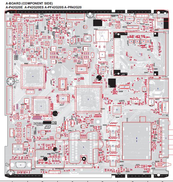

    Hi, Im looking manual service for Panasonic TX-P42G20B included block diagrams.
    also how to fix no display /3 red blinks // 3 - blinks 3.3v SOS D Board??

    3 blinks, that's a rare one. No D-board. definitely 3 not 4 blinks?
    here's a guide for this gen. 3 can be SC board failure too according to this. SC shorts at Vsus SC2 quite common.
    Would not hurt to quickly check that. Shorted SC has also triggered SOS4 & 10.
    Board will be TNPA5081 , (check revision AH?) which i know fairly well as i have a 50" version.
    This will do for fault finding, A board version may be different, rest should be essentially the same.

        please explain what differences you have concerns about.
        I still feel that manual will do the job.
        The A board shown is a TNPH0838. It may be a different revision but layout should be the same.
        SC TXNSC11NEK = TNPA5081AH = TXNSC1LGUU
        SS TXNSS11NEK = TNPA5082AH
        SM TNPA5086 = TXNSM11NEK42
        PSU LSEP1290EEHB = LSEP1290EEHB
        C1 = TNPA5094 = TXNC11LHUU
        C2 = TNPA5095 = TXNC21LHUU
        Maybe a picture of the layout of yours would help clarify.
        I am seeing a TNPA5130 XW tuner board and a logic board TNPA5299(D board? 3D model? GT20?) on FlatTV parts and SJ.
        As for block diagrams, both they and the schematics are in there. What precisely are you trying to identify?

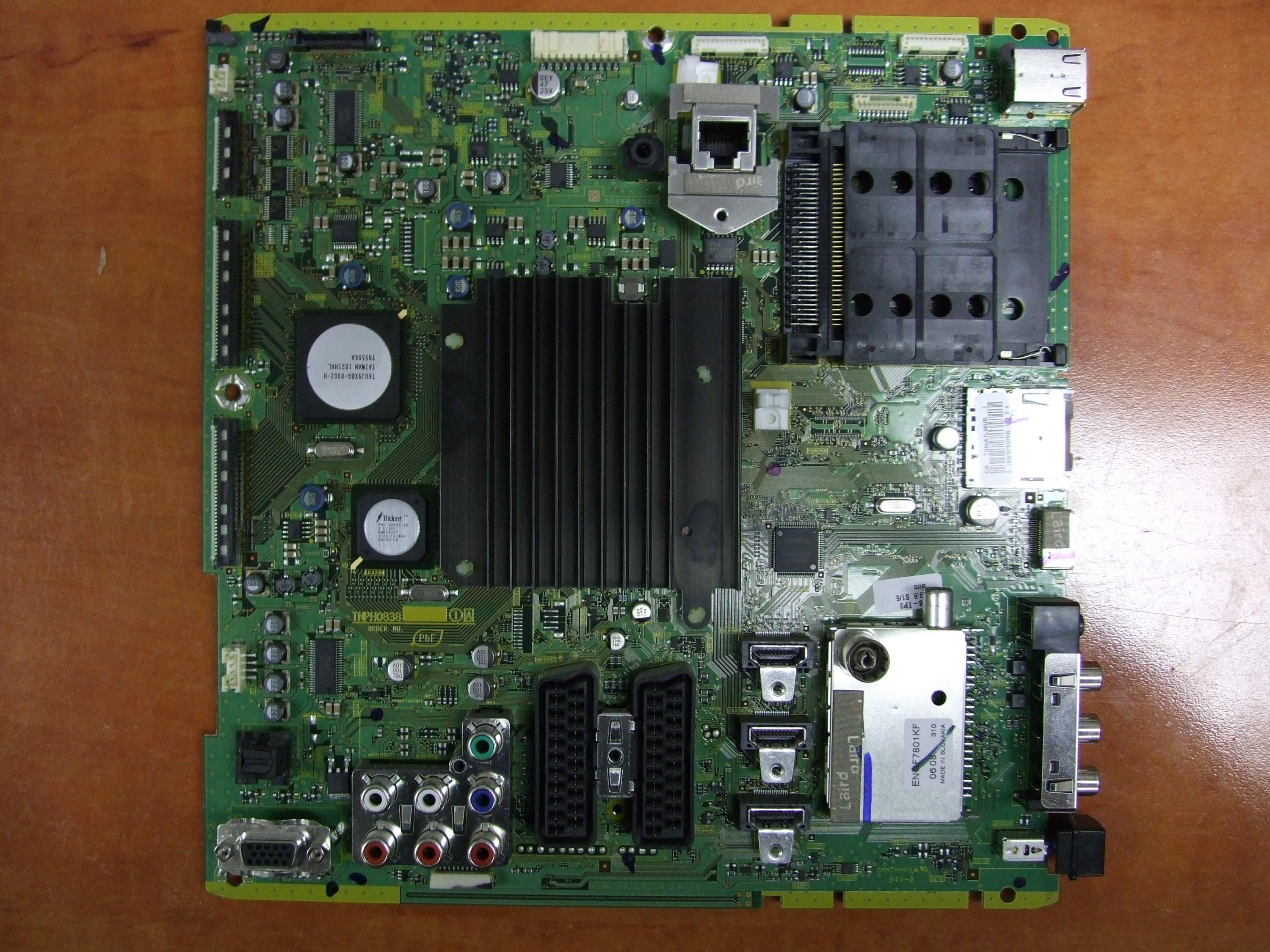

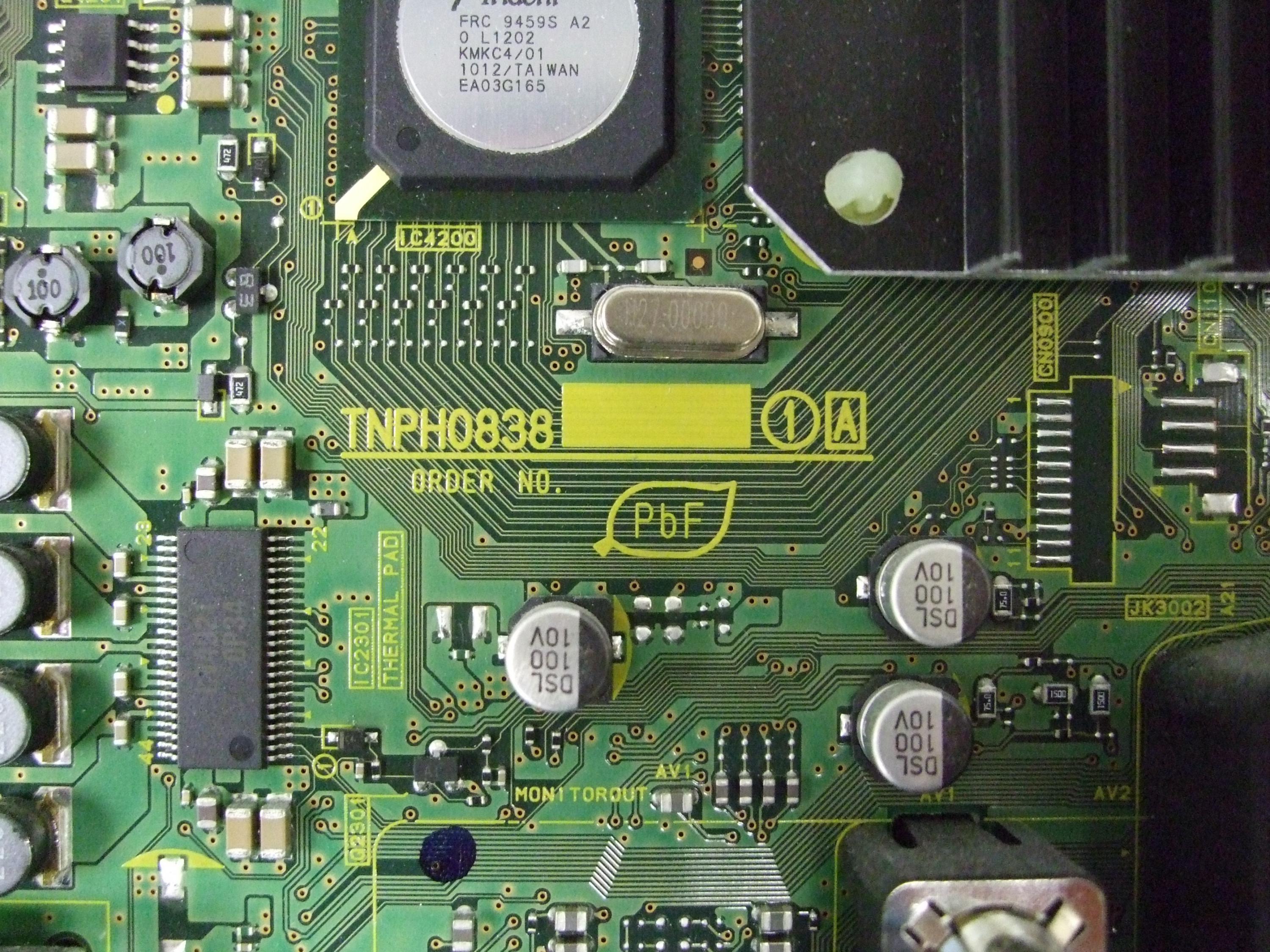

          I have enclosed my A-board layout below
          I am looking for a schematic A-board TNPH0838
          How and which components I have a measure on A-board ?

            I was hoping you'd post a snap of the whole rear of the TV with the boards .
            Use the manual I linked, it's the same layout.
            TP9011 is a 3.3V test point on the A board, use the schematic too.
            IC9803 is the 3.3v reg, it needs 15v at pin2, produces 3.3v out of pin 3. gnd is pin4. I'm getting this straight out of that manual.
            TP9011 is around ic9803 next to q9002 or L9000 for 3.3V
            I would start with the 3 blink flowchart in the training guide, it asks for checking shorted Vsus, Vda & 15V first.
            Then checks short on the A for the 3.3v, then isolates the 3.3v from the C boards to confirm whether it's on the A or C, then gets you to isolate each C to determine which one.
            Obviously depending on what you find will determine which path you take but ultimately the options are SC, C boards, A or panel. I would not expect the panel.
            Vsus , 15V , 5v go to the Sc board, Vda goes to the C boards , 3.3v is produced from the 15v on the A, goes to C boards
            3 blink is P+3.3V, there are Sub 3v and STDBY 3V but they are different SOS.
