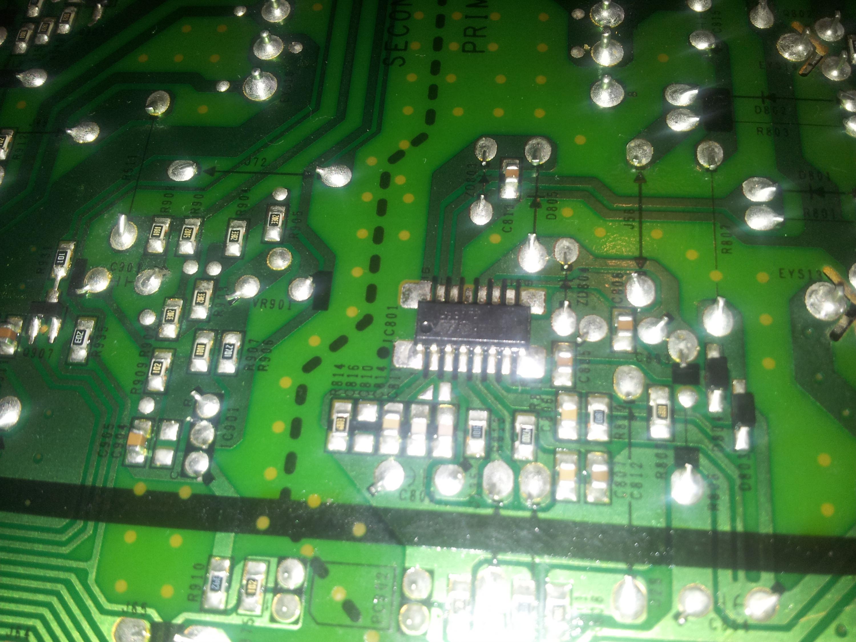

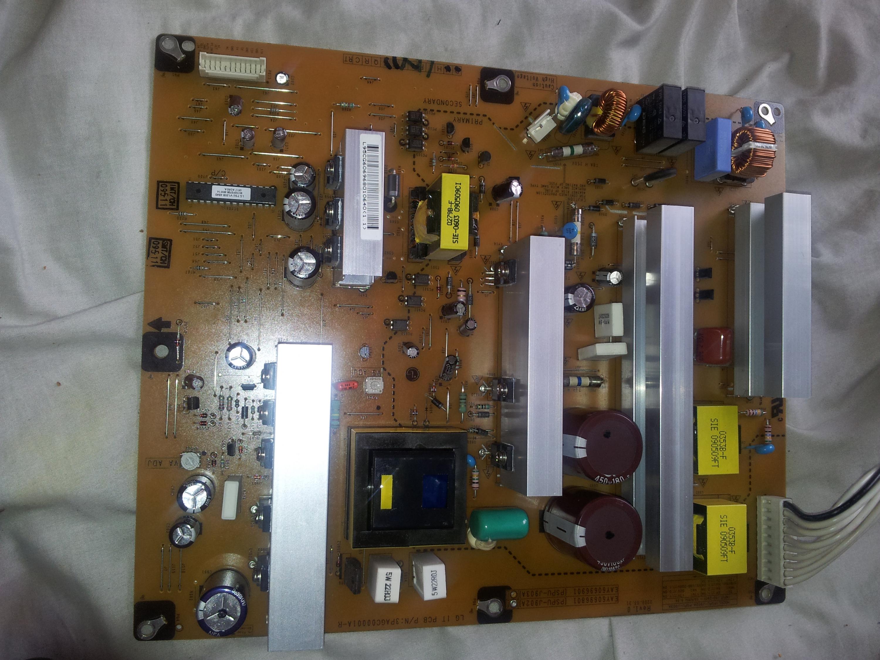

    Found PSU to have blown FETs Q801,Q802 (shorted)
    Will also replace: R801,R802,R803,R804,D801,D802,D805,F801,IC801
    Power board parts:
    Q801: Sub with IRFB11N50APBF
    Q802: Sub with IRFB11N50APBF
    R801: 51R THT 1/4W
    R802: 20k SMD 0805
    R803: 51R THT 1/4W
    R804: 20k SMD 0805
    D801: SB140A -> 1N5822
    D802: SB140A -> 1N5822
    D805: MUR160
    IC801: L6599D
    F801: 4AH 250V

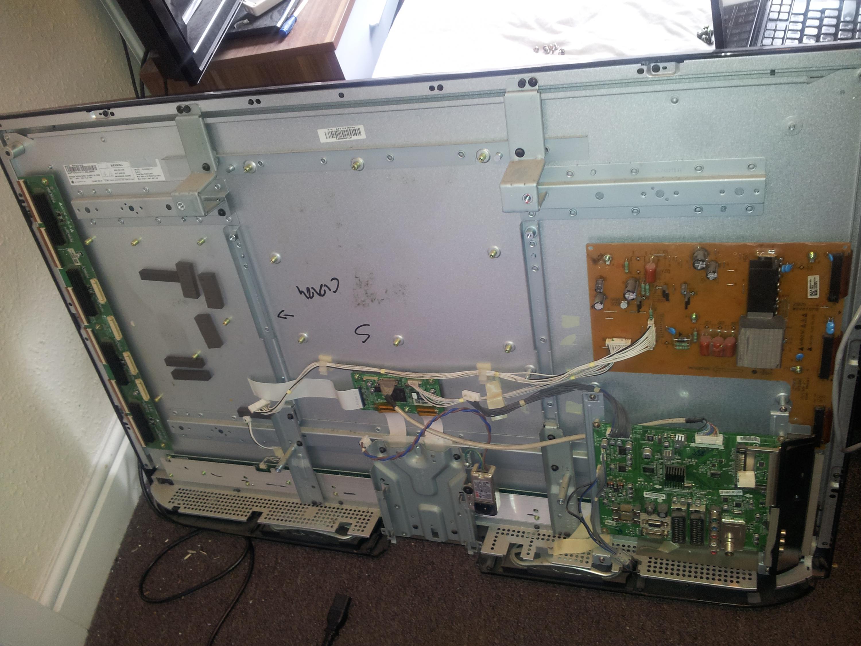

    The YSUS VS fuse was found blown, however, no parts could be found shorted; no short either end of fuse and no IGBTs/FETs short.
    Possibly repeated turning on/off after YSUS failure trying to get set to work made FETs fail on PSU? It is very odd that both failed...

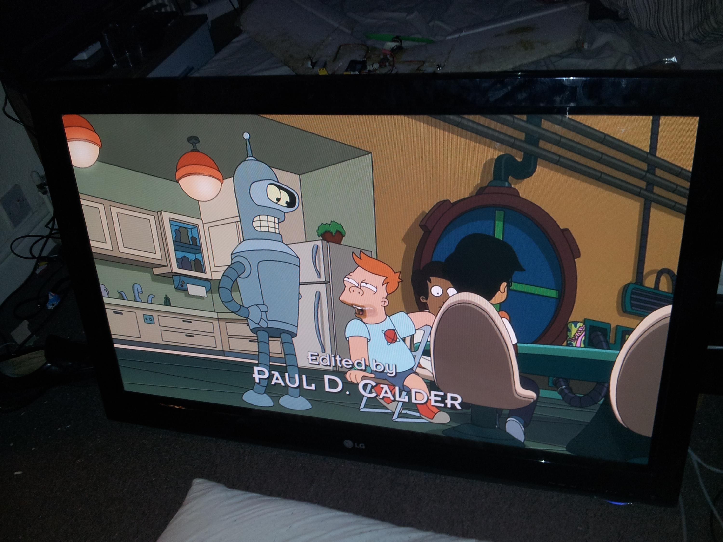

    TV is now fixed. The fuse on the Y-sus, and power board fault were the only issues.
    Picture quality is mediocre. Black level is pretty poor, but overall picture contrast is good.

        This has some very minor maldischarge, but otherwise no problems. Very watchable image.

                              The MOSFETs were like for like replacements. I reckon the failure occurred due to the Y-sus fuse popping and the user cycling the TV far too many times to get it to turn on. The power up process is the most stressful time for a power supply as with discharged output capacitance, the power supply is essentially driving a shorted load for about 1 second. Note these LGs discharge Vs/Va at switch off so they do not benefit from the Vs remaining high for some time.
                              The diodes were uprated for convenience, in that section the average current is <50mA or so.
