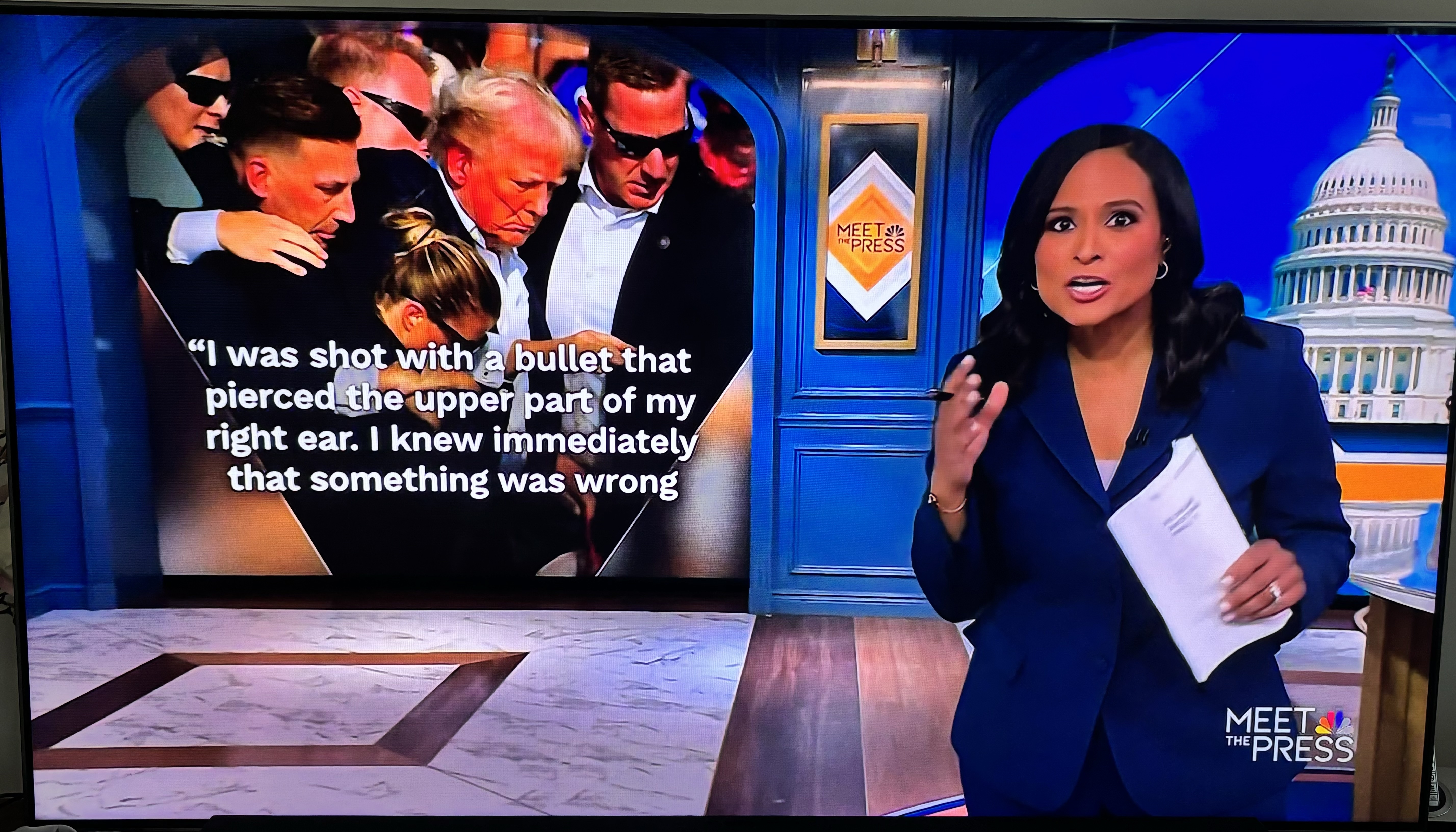

      Picture looks flawless in both SDR and HDR mode now.

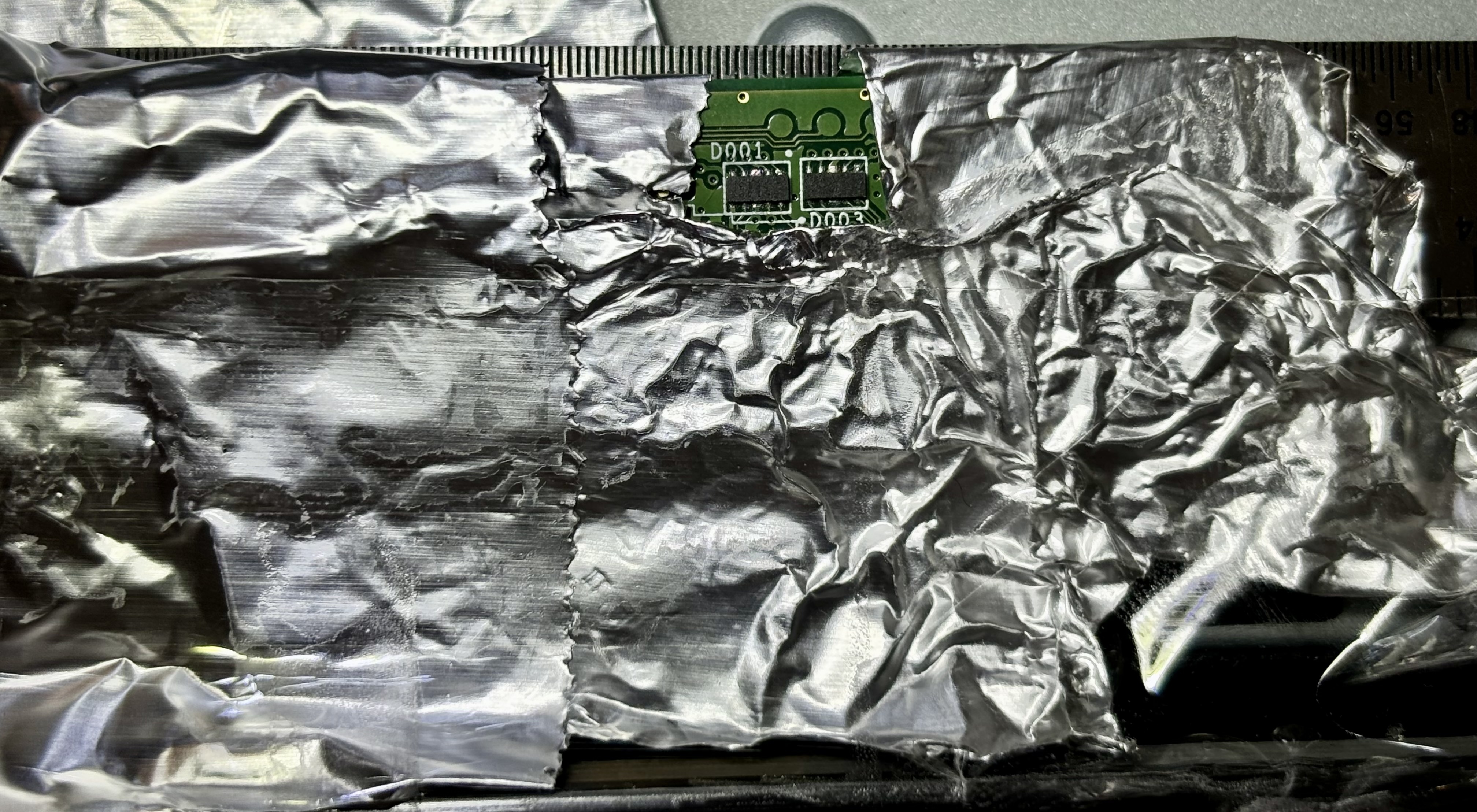

            So taping did the trick for you? It's usually what I try first, can you show or tell where you put the tape?

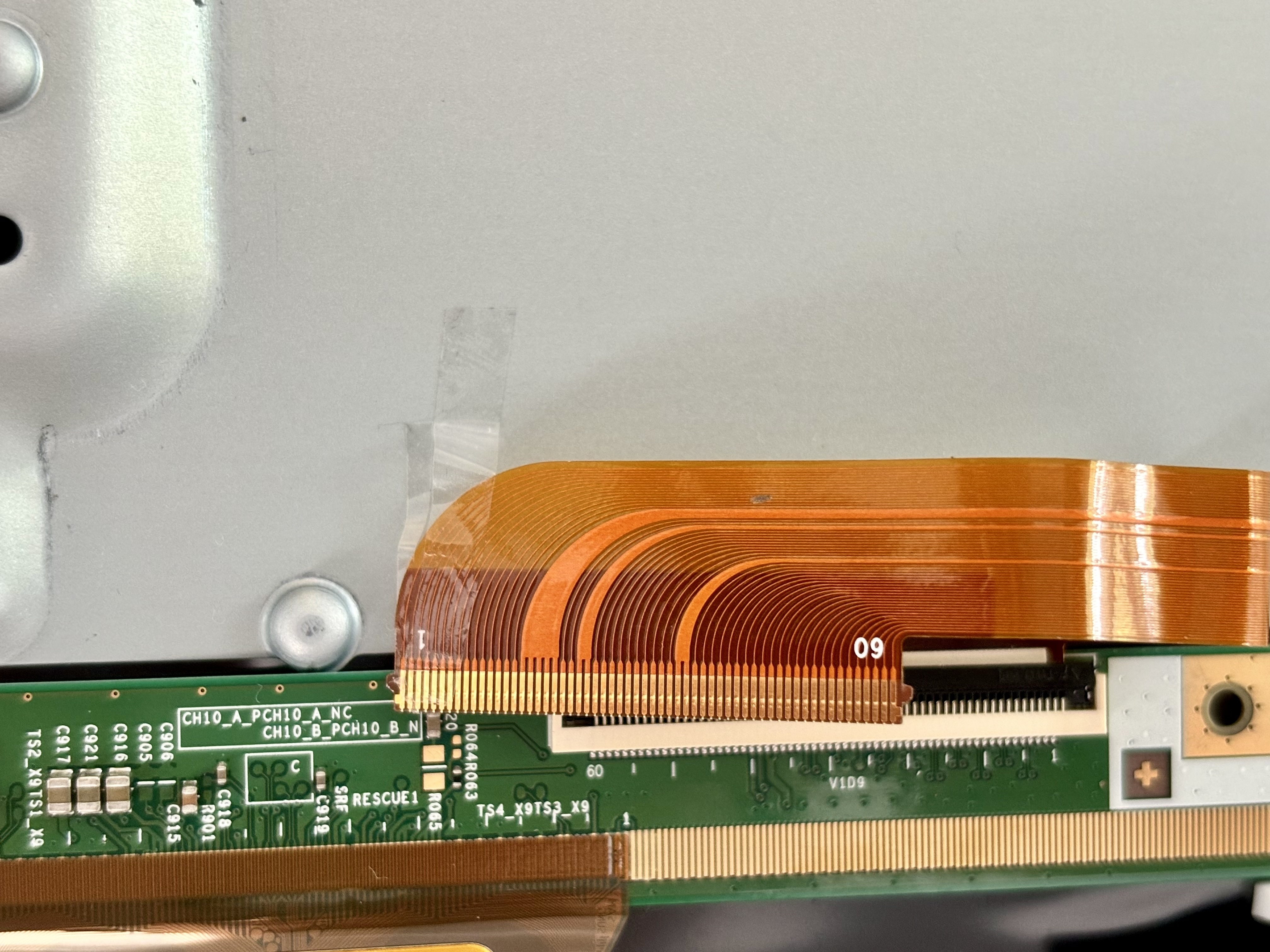

            I tap out the out-most few pins on the ribbon cable to the last scan/panel board. Maybe it only needs 2 pins but I didn't bother to test each of them.
            I tried tap out the main ribbon cable without luck as I wasn't aware the right most driver board is over heated on few resistors until Iotas pointed out the dark resistor.
            It ends up with a simple tap fix at least for now..
