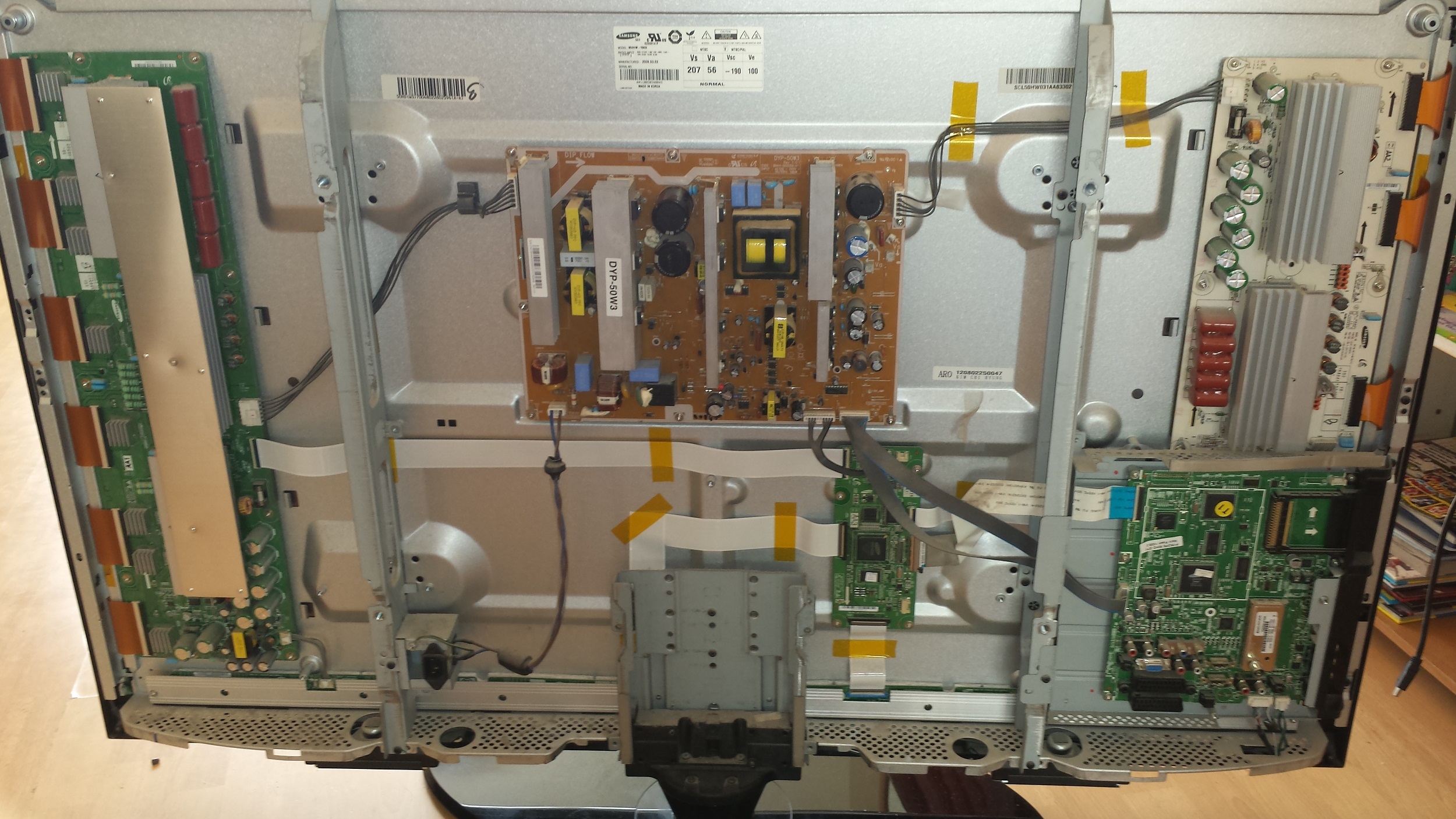

    Ok so ive got this tv which was totally dead so i checked on the net for any symptons so found this site and basically removed all the parts they listed and tested,but i could not find nothing wrong so i put the power unit back on noticed a standby light was on and the tv works now.
    so could it have been a cold joints etc ?
    thanks

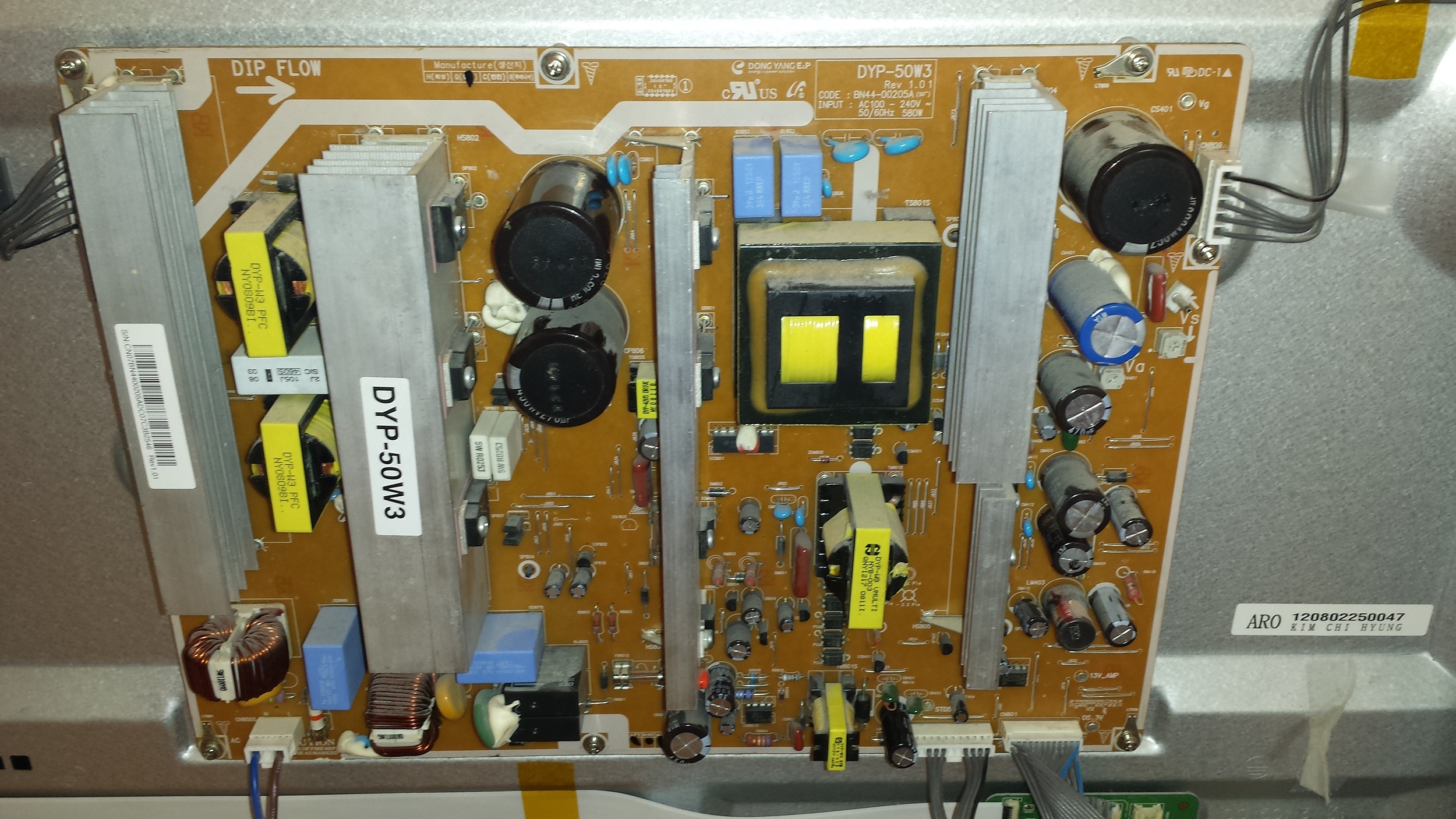

              hi tom all i basically done was tested the following parts listed below due to the tv was totally dead (but did not test the mosfet )
              F801S
              BP802S
              DP081
              CP085
              CP086
              FM801S
              FB801S
              DQ801
              DQ802
              DB801
              DB802
              DB803
              http://www.ohmsupplies.co.uk/Repair-...50A456-P50A457
              tv came back to life after doing this ran for a few hours last night but today went into standby ill be home later to test the 5v standby

                    No tom
                    • tw2005
                      • Oct 2011
                      • 6458
                      Re: Samsung ps50a457
                      Sounds like it could be dry joints. In the picture I thought Q801 looked a bit sus but it is blurred. PSU looks similar to the 50Q91,96 which I had one with similar issue. Cracked joints on the FETs.
                      I'm assuming you have 5v standby the whole time.
                        Yes 5v standby constant I have since resoldered the MOSFET joints all working again at the moment
                          When I discovered this issue I found when I flexed the board mid point I could get the TV to fault and just shutdown. hopefully this is all it was, no doubt we'll find out in time.
                                Not really resoldered Q801 and Q802 still waiting for it to go into standby though
                                  Can be hard to tell, but everytime you touched the board it came back mysteriously. I would have gone feral and touched up all the heatsinked parts to totally take that out of the equation but where those are that is the equivalent heatsink and FETs that gave me grief.
                                  Nil cost and a bit of time, better than replacing boards straight away. I guess once it starts running longer than it has previously then our confidence will grow.
                                  That one I had could run for hours, be good for a few days then just randomly drop dead but was perfect when it was going. Took me a week to get it to fault, that's when I thought I'd try and induce it with tapping the heatsinks.
                                  Once I flexed the board that permanently made it worse, it was fun. Was a fix for a mate.
                                  he just put up with it . i have seen one go up in smoke though with those bad joints.
