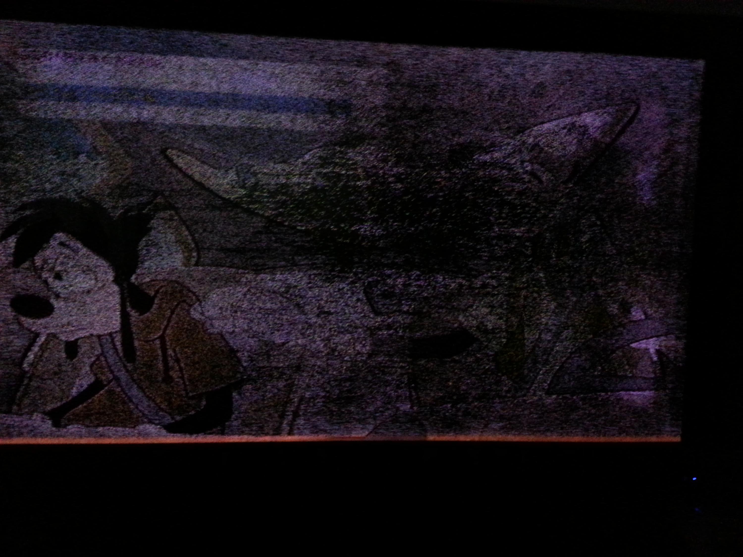

    VSus, VA good. Logic Board, Y, X and buffers. Unit turns on with no problem sound working, logic board led blinks once every second. Not sure if panel is defective.
    Have read through the forum still unable to find corrective action. Thanks in advanced to all.

    Dim picture generally X_SUS faults.....
    Check the waveform at the TP or the panel connector....

            Re: 42PA30RQ Troubleshooting Dim Raster and Image
            Thanks for the pdf. I have attached a photo display.
              I have ran the test pattern they are seen on the background very dim. Also checked LVDS cable for continuity.
                      Its definitely an X-main problem looking at that if that helps.

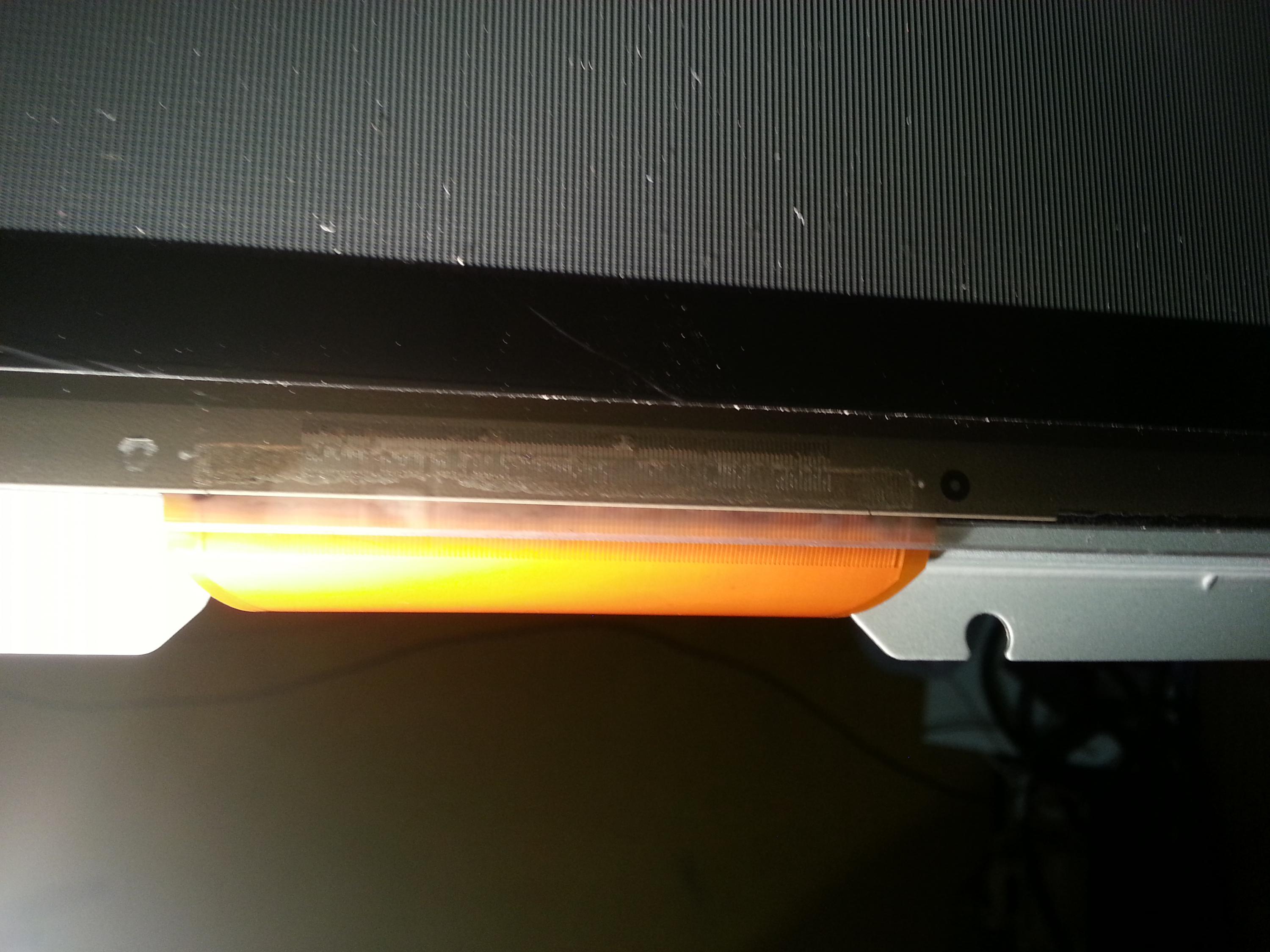

                          Tom I found this after removing front cover, is this repairable? I see small sparks when tv is initialized. Thanks...
                            Where are the sparks occurring? Possible to get a video?
                              It happens at this connection looks like corrosion, humidity. Initial spark only on this top connector which powera from main x board. All others look clean .
