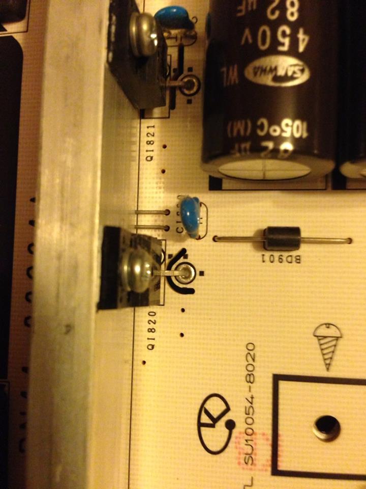

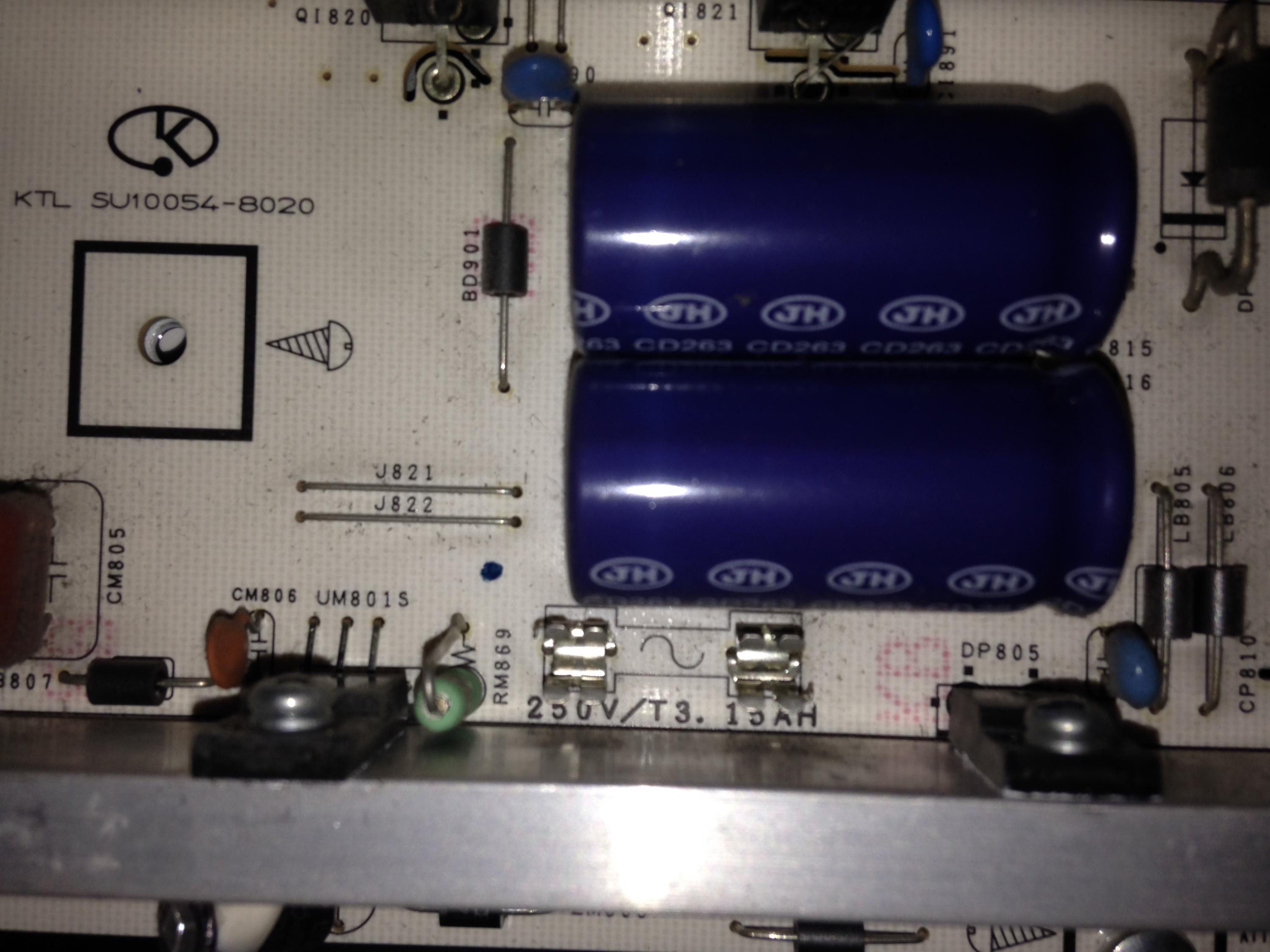

    Hello all,
    I am new to the community and very new to electronic repair. However, I am very patient, a good listener and willing to learn.
    I have a Samsung LN40B500P3F that just powered off when I was in the middle of watching House of Cards Season 2. I opened it up and checked the fuses. The 250v 3.15 Fuse was blown when I tested it with my dmm. I went to Radio Shack just to try to put a new one. They only had a 125v 3.15 fuse that was clear, but the employee said it should work fine. I put it in and it immediately blew when I connected power (as expected). I read up on testing N channel MOSFETs using a dmm. I got the datasheet online after looking up the number (F22nm60n)- http://www.alldatasheet.com/datashee.../F11NM60N.html. Three of the N channel MOSFETs read 558 or 559 on the diode setting. Two of them appear to be faulty and set off the auditory alarm on my dmm. I assume this is part of the problem with the power supply/inverter board, but I don't know what else to test from here. I am fine with just buying a new board if, but would like some advice if there is another less expensive solution. I saw this repair kit on ShopJimmy, but I am not confident enough with my soldering skills yet- http://www.shopjimmy.com/samsung-bn4...repair-kit.htm. I also want to verify that it is indeed my power supply and not my main board. I assume it is with the FETs testing bad, but I am new to this whole repair bit and am looking for advice/help.
    I read on these two threads and performed the reccomended tests- https://www.badcaps.net/forum/showth...ng+LN40B500P3F - Same results: No readings when testing the 4 points recommended by budm at OHM mode at 200K. I have not done the light bulb test.

                Something is not right with the MOSFETs that are making the meter beep. Its a hot side of the power supply dead short. I'd advise taking them out of circuit and retest. Also while they're out of circuit check for any diodes That might be shorted. you would be surprised how much of a simple repair this could be.

                    I tested the diodes. All tested fine. Any idea where I can get FETs? Would radioshack have an equivalent to FQPF9N50? I saw a few from china on ebay, but was hoping for one a little more local. http://www.ebay.com/itm/2pieces-FQPF...item27bdccf3c4

                      Just noticed this is the number on my FET - F11nm60n

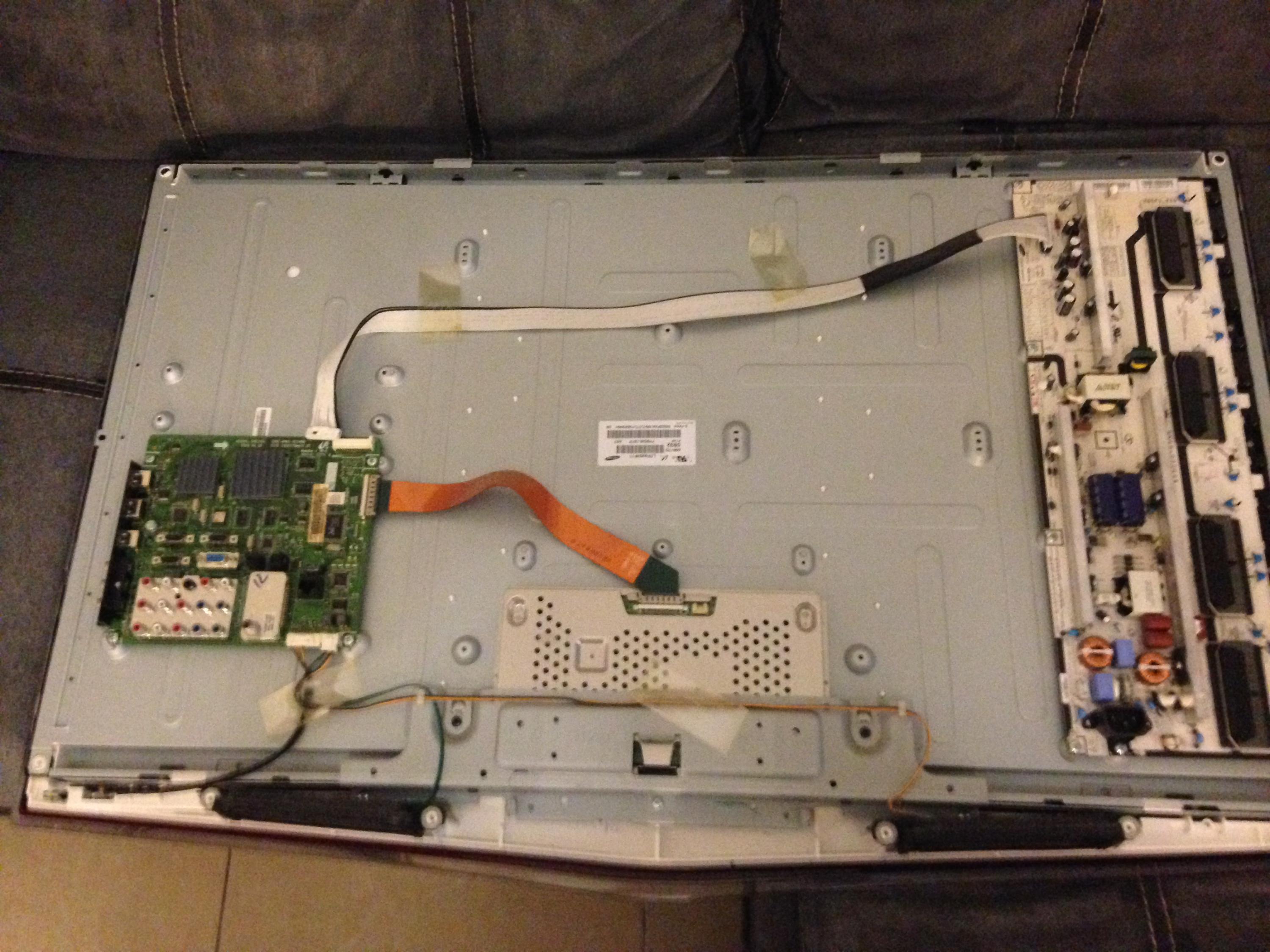

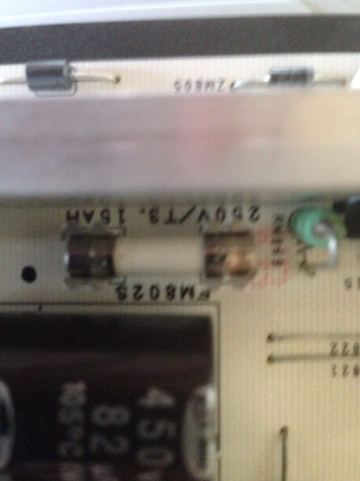

                                  Greetings, I have the same issue on my LN40B650 which has the same power supply board (BN044-0264A). I'm also a DIY kind of guy but my knowledge in electronics are kinda limited (solder skills good, Already repaired a couple of PS with bad caps but that it!). So I'm looking for help here.
                                  Out of the blue the stand by LED disapeared and the tv isn't swithing on anymore. I opened it and figured out that the 2nd fuse FM802S on the diagram was dead. I bought some more (exam same reference from Little fuse 250V/3.15A slow blow fuse) and upon installing it and connecting the TV to the power outlet it instantly blows, dit the test twice, with and without the cable going from the SPS to the Mainboard connected.
                                  So definitelly another component should be dead. The caps should be ok, they look good at least, no leakeage spotted.
                                  Any idea to what test I could do with a DMM to pinpoint the bad guy? On hte cold section, I pretty much get 0V anywhere as the fuse is blowing and cuts whatever is after it.
                                  I can post whatever photo needed!
                                    Re: Samsung LN40B500P3F - Won't turn on
                                    Check resistance on the two legs of the snubber capacitors CI890 and CI891 to see if it shows very low resistance.
                                      budm, than you for the quick reply. Here are the readings:
                                      CI890 = 00.6 ohms
                                      CI891 = 00.6 ohms
                                      They are shorted. I remember tryng the voltage of the 2 big caps (CP816 and CP817) while connected and they were around 200V If I remember correctly.
                                        OK, remove both caps and check the resistances of the caps again off the board. It is either shorted caps or shorted power MOSFETs.
