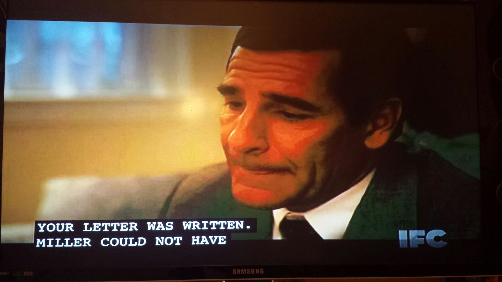

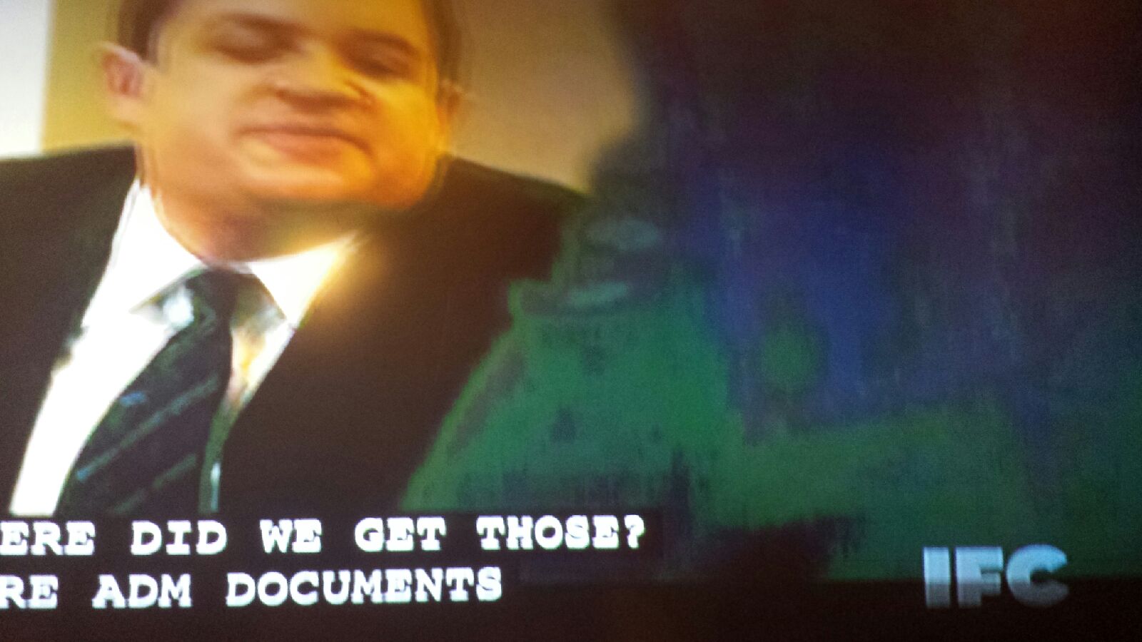

    Hi.Color Discoloration after color wheel changing on Samsung HL-P5085W.May be i need to do some adjustments?Please see pics attached.
    Thx, Felix.

    It has to be related to the act of changing the wheel so check every connector, make sure they are all seated properly, it is possible that you gently knocked one while reaching inside to change the wheel, good luck.

        I think on these sets if you change the color wheel you have to adjust the timing on the service menu. Norcal715 on YouTube has a video on it.

          See attached also pay attention to #9 step

            If the color wheel adjustment was off you would not have the flesh tones you have, the face color would be off ie: greenish I've changed a lot of color wheels and the index delay was never off that much. It looks like either connections to the dmd board or the dmd board itself has a problem.

                Thx! Will try tonight

                  the color whell blowed up.before all was good.

                    It helped.Problem fixed.Thank you.
