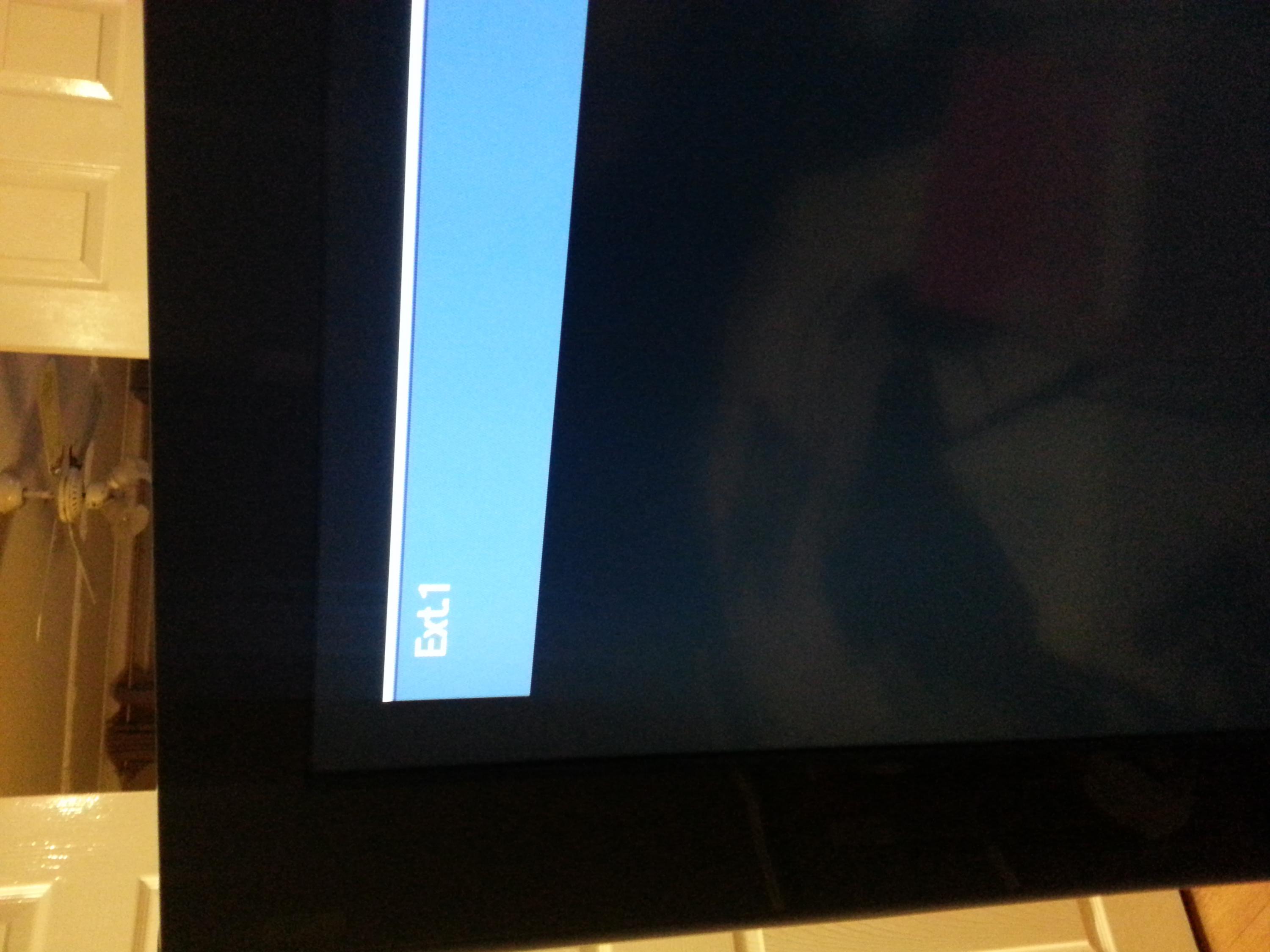

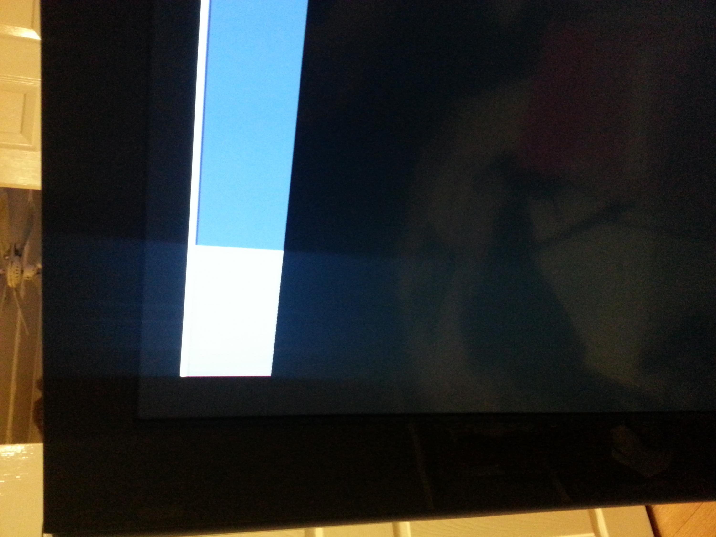

    I have a Samsung that is fine till the screen is moved slightly then it comes up with a line on the left then move it again it goes I have checked the connections to the t con board and they seem fine
    Re: samsung 37 shake gets a line
    I'm going to say tab bonds.
      How I fix that
        See here for one example of many:
        http://www.youtube.com/watch?v=purk_SyiT44
          Thanks I'll get it done in morning
