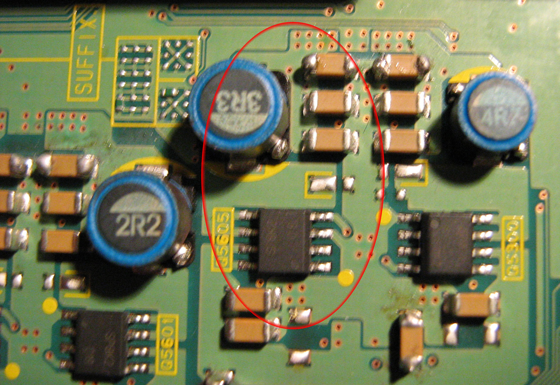

        I found some smd capacitor shorted on the "A" board. There are 4 groups composed by a sp8k1 or sp8k2, an inductor and 3 caps. I post an image of these groups. I found a cap shorted in 2 of the groups. It's very difficult to desolder smds without damage the pcb underneath.
        The tv now works but shuts down after a couple of minutes keeping the green led. Not only cfl power off, also the image goes away.

          Re: [Panasonic Lcd TX-L22X20E] 7 blinks of death
          From these groups I have 5V, 3,3V, 1,8V and 1,2V. Power led blink green then solid but i have no more image nor backlight.
            Well, if you remove a cap, you change the behaviour of the circuit. Who knows what that could do to the output when it gets hot or more current drawn?
              It seems a power issue. I see the audio optical light turn off and on when it try to start. If I let it powered sometimes it fires up and work for few minutes.
              I had only 10uF at home but I think it needs 22uF. I'll buy some.
