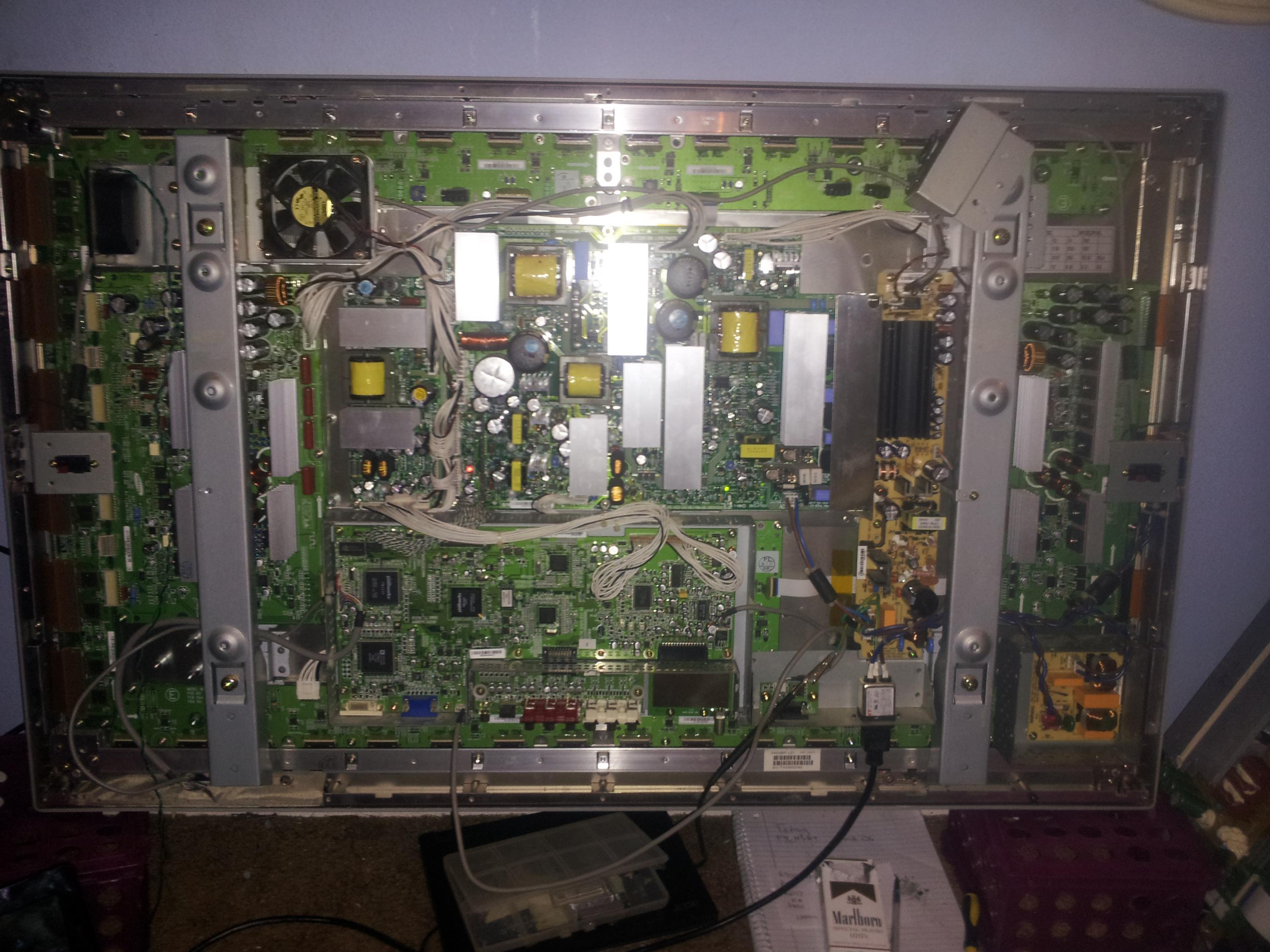

    So I bought another $10.00 42in Plasma again. This is a Tatung P42HSMT. I was told that the set was fine & then 1 day it was turned on and it shut off after 10 sec. (Protection Mode I think) Well I got it home and pulled the back off of it and powered it on. Immediately the PSU's Led8002 & Led8001 turns off and then Led8004 turns on red and the TV turns off and cannot be turned back on until I unplug it and reconnect. I have done some research trying to find a manual but it appears that the PSU (which is Samsung LJ44-00068a Rev.02) is fairly common & found in various Samsungs (Duh!), Phillips, Magnavox, Sanyo, Norcent & apparentley Tatung Plasmas.
    So far what I have done is unplug the Y-sus & Z-sus to see if the psu still shuts its self off because of those boards and it does the same thing (red led) plugged in or not. I cannot find any obvious damaged caps or blown/fried components on any of the boards. I have checked all of the bus like fuses and they are fine also.
    I would really love to fix this thing for I have many PSU boards to get parts from and I have two other (Sony KDE-42xs955 that needs a YSUS & a Vizio vw46L that needs a tcon) large panel tvs that im into around 10.00 each, so I would really love to get this thing working.

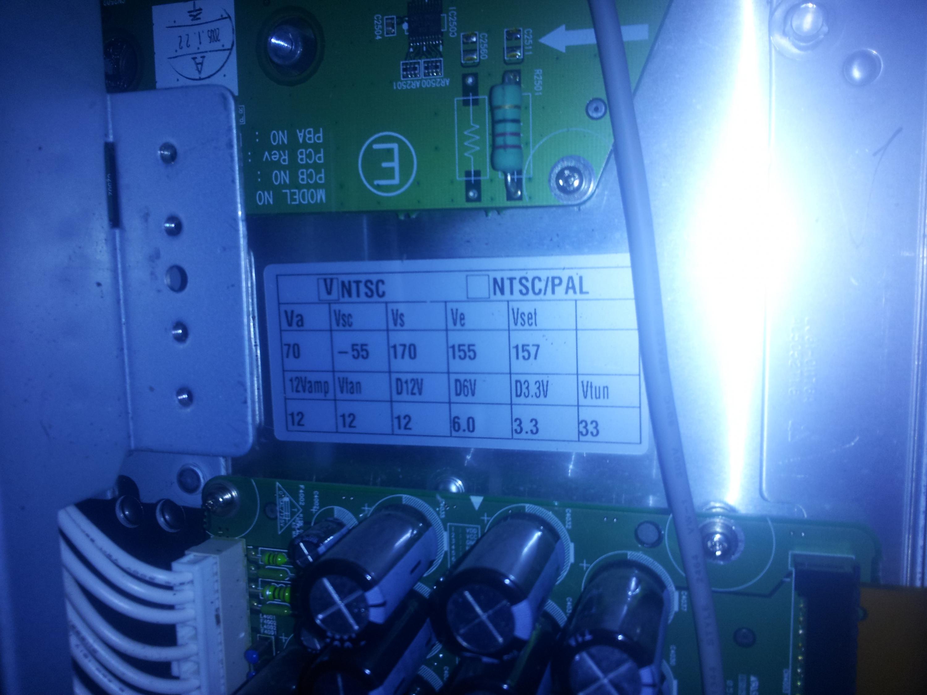

    Have you checked if you get Vs and Va voltages from power supply? Post a picture of the voltage label on the right hand side of the plasma panel.
      Re: Tatung P42HSMT Power Issues
      I get voltage on VA and VS but they are nothing close to that label either on standby or during power on.

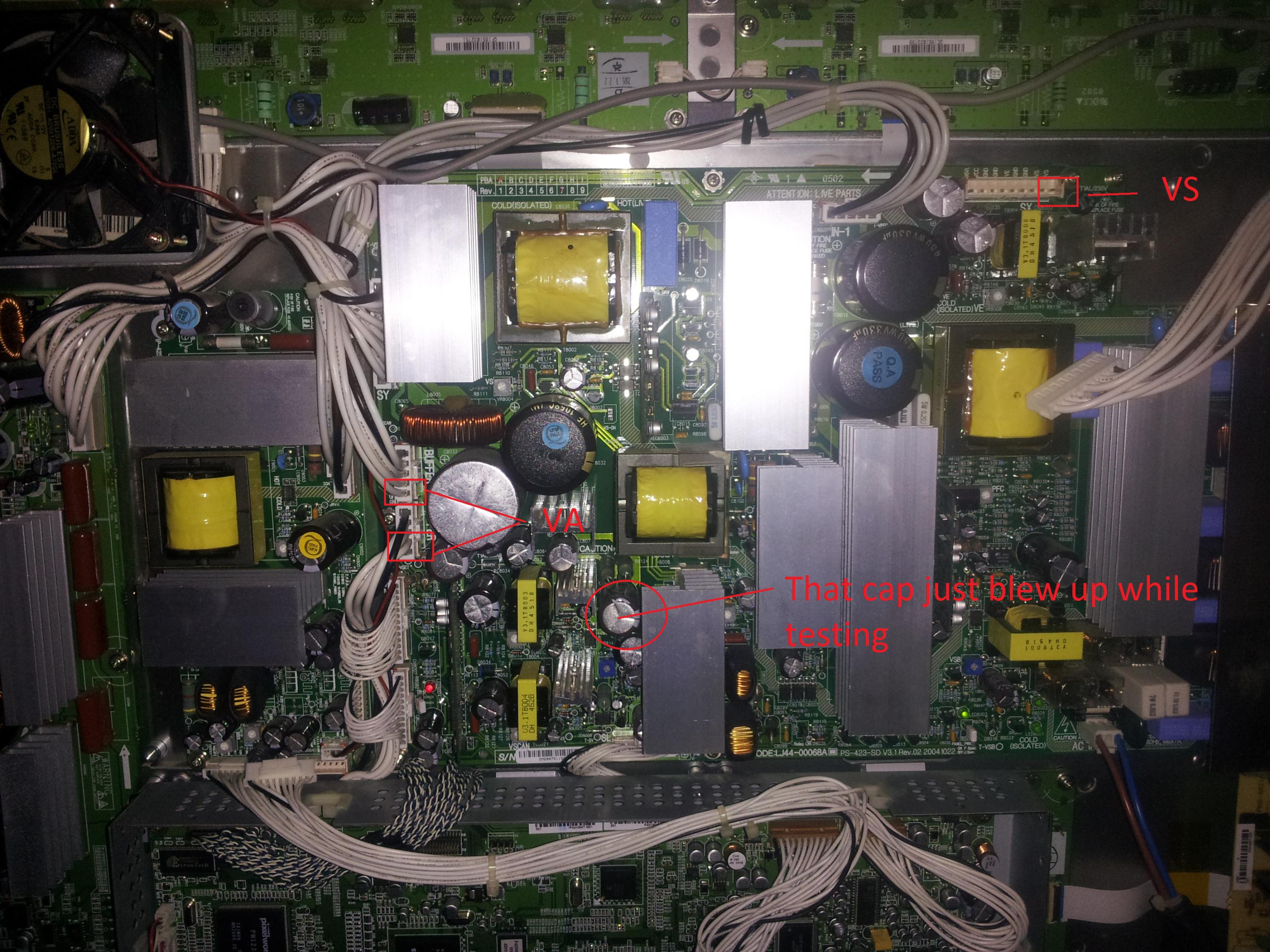

          So, what do you measure on Va and Vs?
            VA @ CN8005 where the buffers plug in at I 65v and dropping and the VA pin above it I get 135v and dropping
            VA @ CN8006 on VA Pin 1 i get 143v & dropping & VA Pin 2 I get 140v & dropping
            VS @ the top right corner plug I get 1.399v @ standy by when on I get 2.744 and dropping.
            2nd VS Pin I get 1.579v and dropping @ standby. when powered on I get .944v and dropping. the 2nd time I rechecked the voltages @ va a capacitor @ C8059 just blew up in my face.

              im replacing that cap now!

                    there a 2 caps up to the top corner with 2 resistors and diode usually go bad on these set
