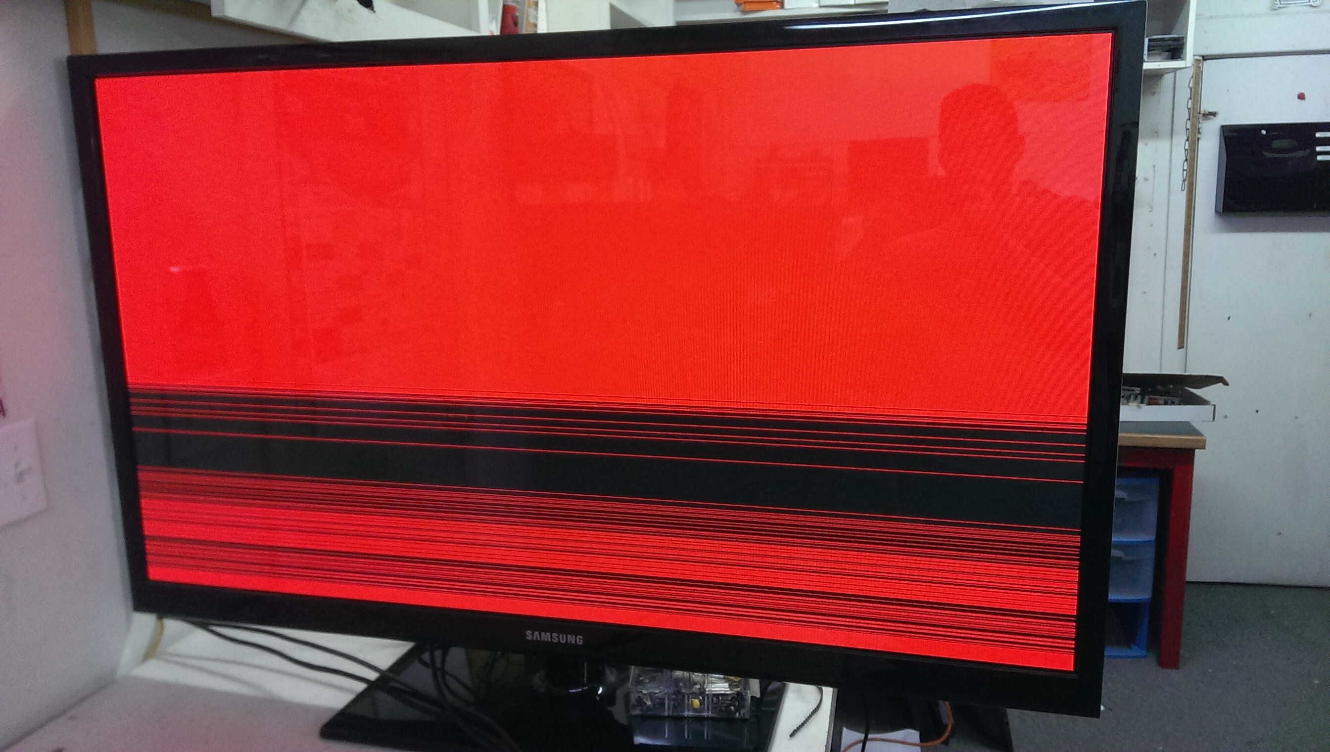

    PN51N450A2D horizontal lines
    The tv has a great picture. However, the bottom 8-10 inches of the screen has black horizontal lines. Have replaced the ysus and xsus.
    Any suggestions ?
  • freakaftr8
    • Oct 2012
    • 3743
    Re: PN51N450A2D horizontal lines
    I'm afraid that panel is toast. This is an inherent samsung issue with the newer samsung plasma TV panels. Have seen it quite a bit lately.
    There is as far as I know no fix for this. Has something to do with the electrodes in the panel coming detached from the ribbons. You can try unplugging and reseating the lower ribbon cables but not sure if it will help here.
    I'm sorry
      May be worth just trying a good buffer-board--May get lucky....
        Thanks, I was afraid I was gonna get that answer.
