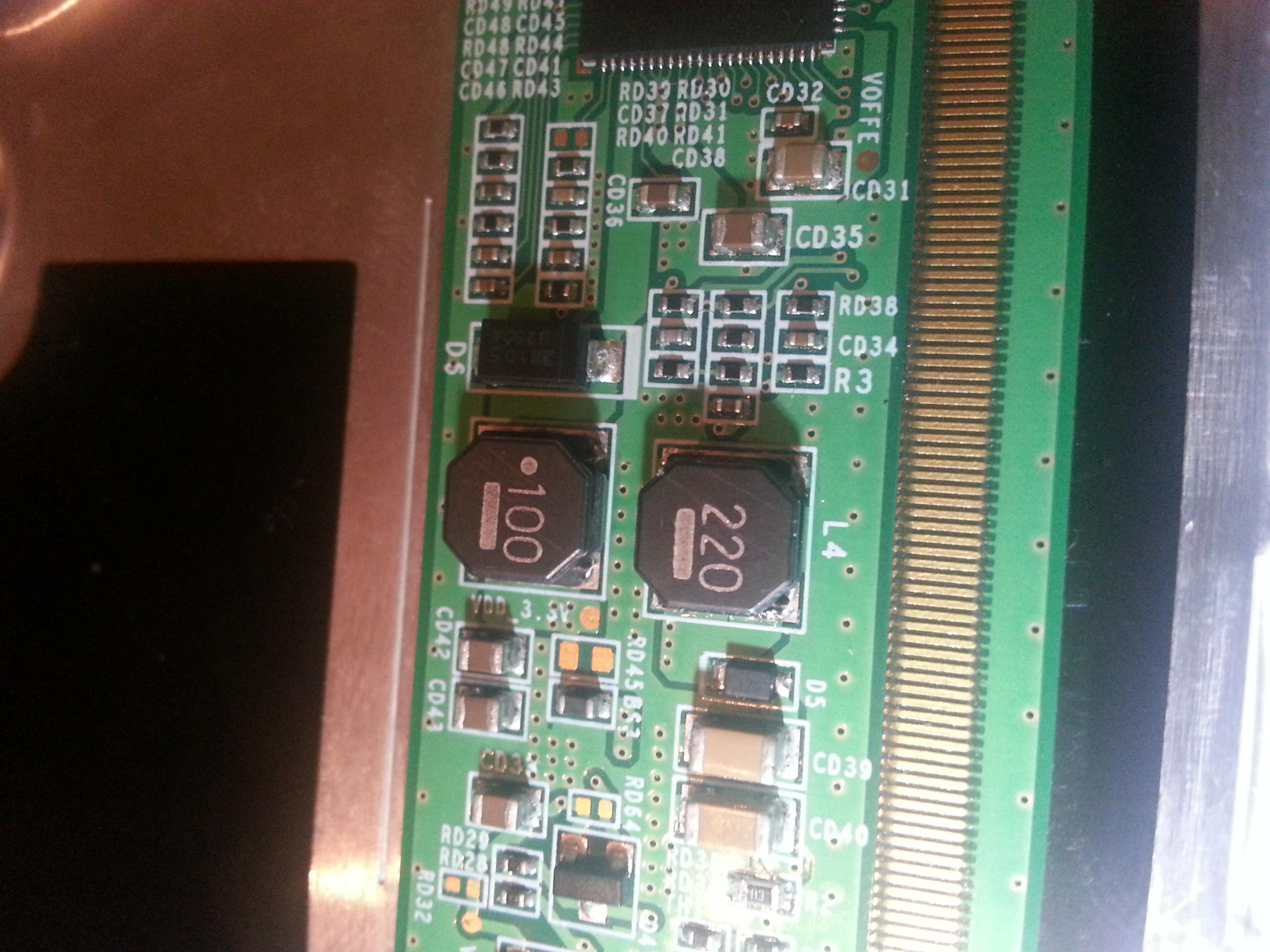

    That waveform confirms main board is sending video data, so my thinking is something on that bonded t-con board is bad, meaning the panel is bad. You might be able to find some way of harvesting the t-con from a scrap screen, perhaps via very careful re-bonding of that single tab (since there's only one to line up, it's marginally easier.)

                I'm not giving up in this lol I'm getting power to the left side as I look at it but from here I'm getting nothing from anywhere on this the 220 one
                  #68
                  Re: samsung 32 UE32D400
                  That seems normal for that configuration, as one end is grounded. Possibly VGL generation circuit (negative.) It's often not abnormal to get significant voltage drops across components. Electronics would be awful simple if everything worked at V+ or 0V...

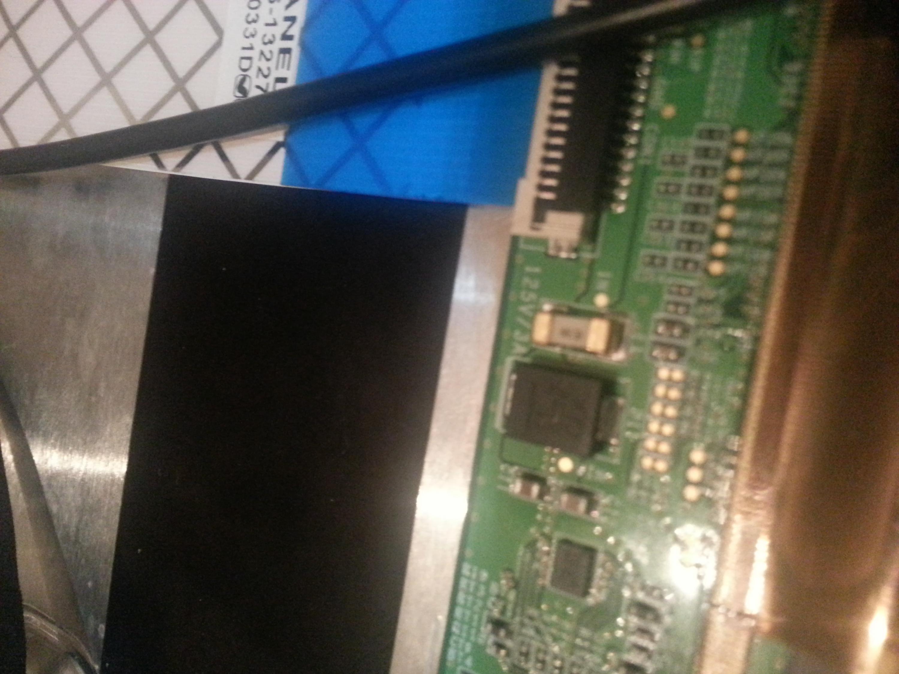

                          Stupid question time this next to the fuse is getting 12v ish into it but nothing from the other side is it suppose to ?
                            #73
                            It is a TVS surge protector. It shunts higher voltage transients to ground. It's an odd device in that position, I'm guessing it might be useful for some of the more inventive power supplies that we're seeing in cheap TVs which are horribly unregulated and could damage a normal T-con over time. I suppose since it's such a cheap device it's just some insurance for Samsung.
                            One end is grounded so you will see nothing "out" of it. That is how it works.

                              Is it a diode ? Remove power and test it to see which way it should be conducting.

                                    If I just un clip the ribbon to it and move it slightly I get a bunch of lines on the screen like black and white

                                      Do you notice any change on VOFFE/VONE when doing this?
                                      I think it is a fault on that t-con board, but no schematic and no datasheet for the parts, it's hard to narrow it down.
