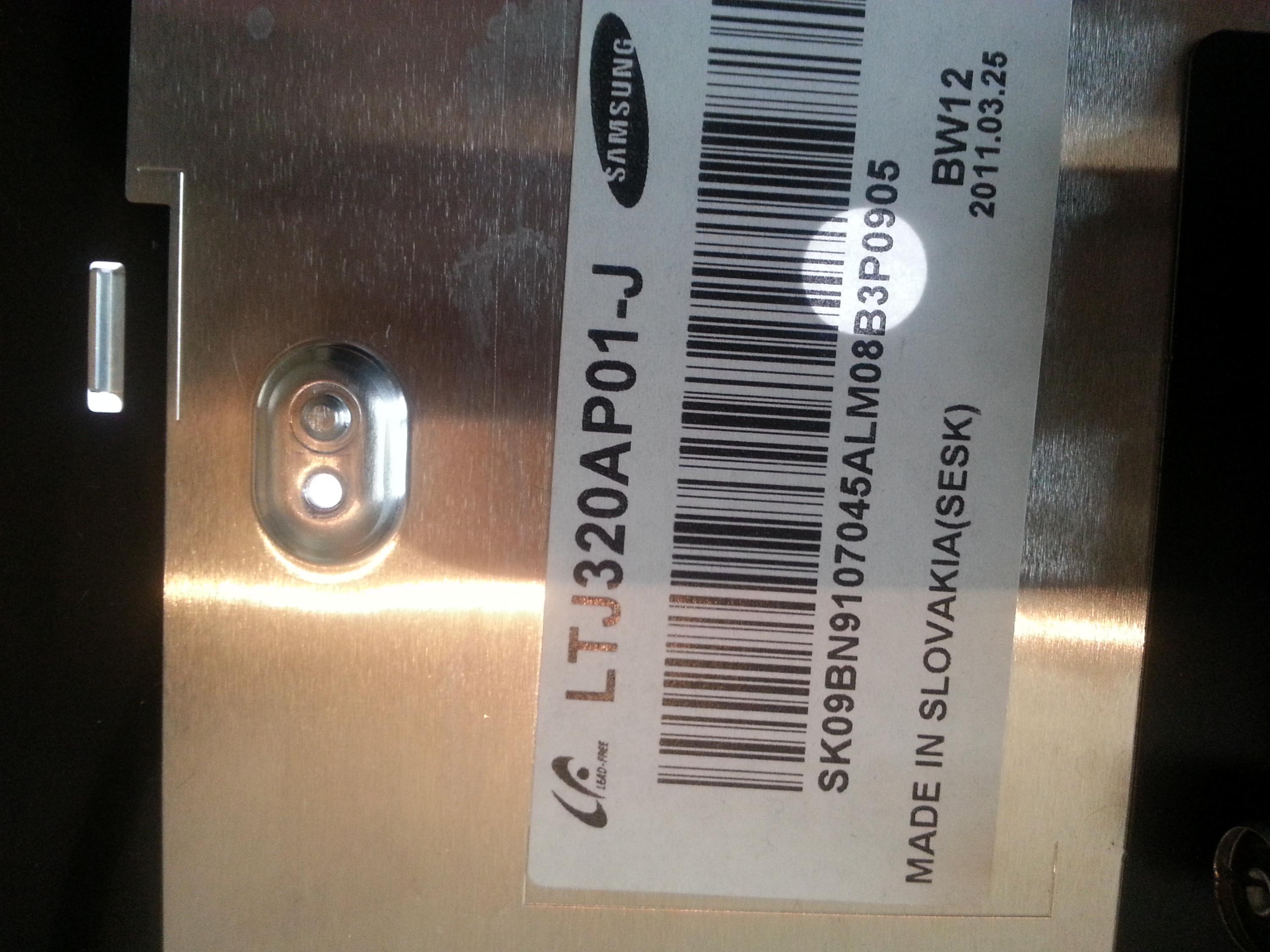

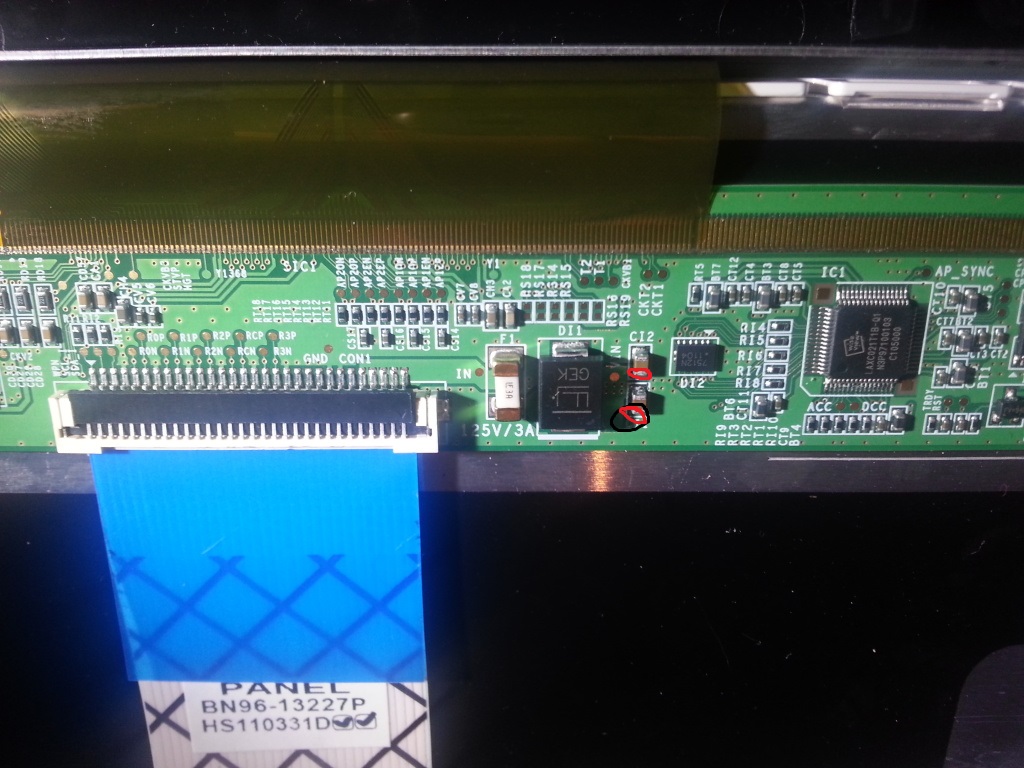

            Without a pin diagram hard to telll.... there should be an "LTN","LTA","LTY"###### number on the back of the LCD panel. e.g. SAMSUNG LTA32P0A6. Can you locate this? Part number scheme might vary.
            • adamp91gvm
              • Jan 2014
              • 706
              • uk
              #46
              Re: samsung 32 UE32D400
              Just put a pic on
                #47
                DS:
                No obvious enable pin. You would need a scope to see if main board is sending video to tcon.

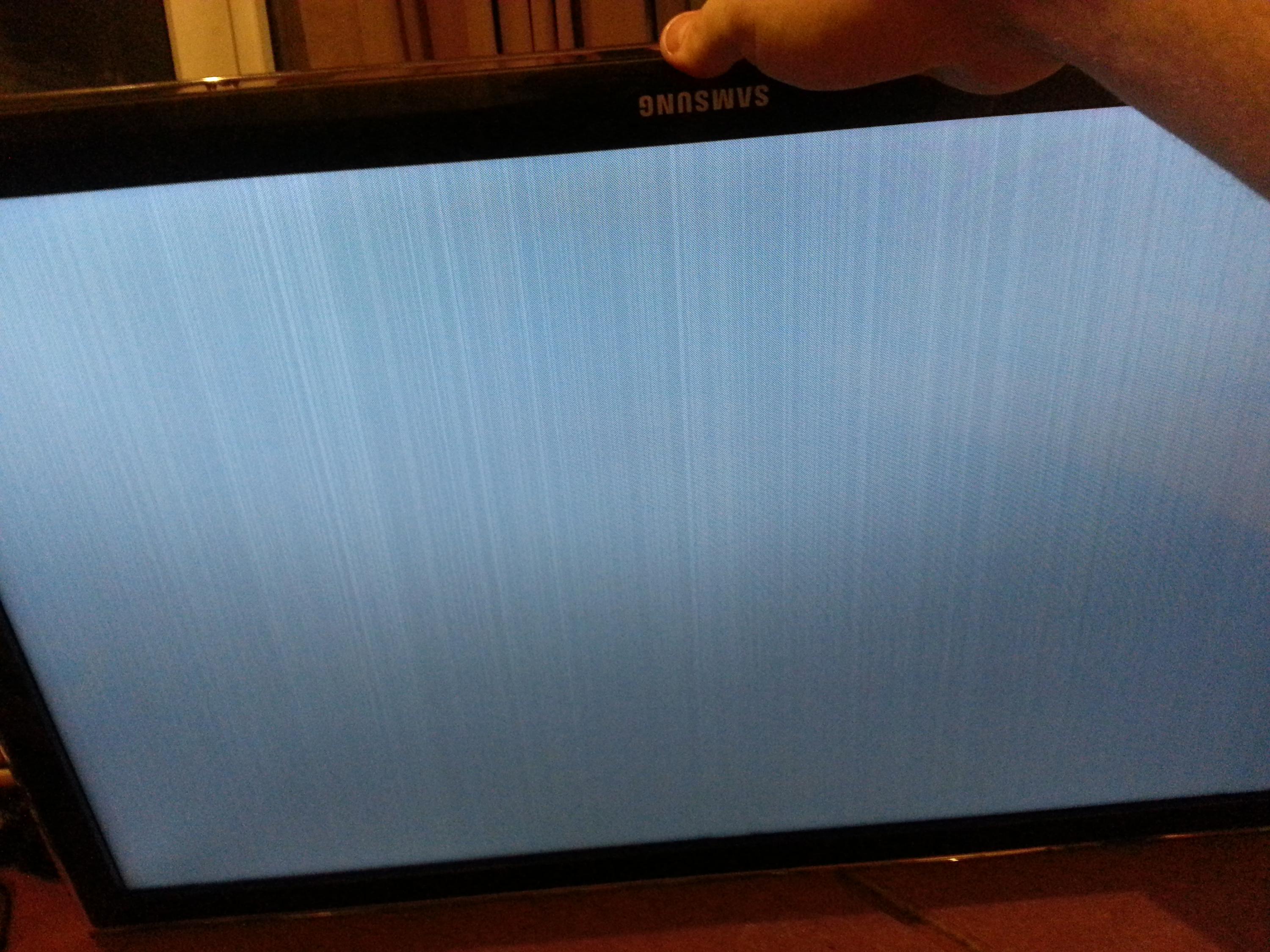

                  #48
                  Right decided to give this another try moved the ribbon to the t board and I get this when I move it about

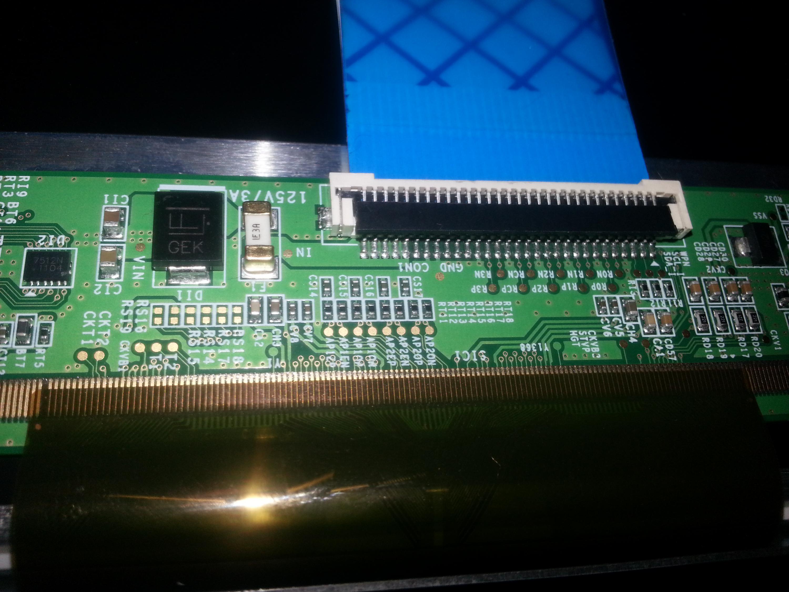

                      #50
                      Just the points on the t board coming out of the ribbon
                      • adamp91gvm
                        • Jan 2014
                        • 706
                        • uk
                        #51
                        Just here ?

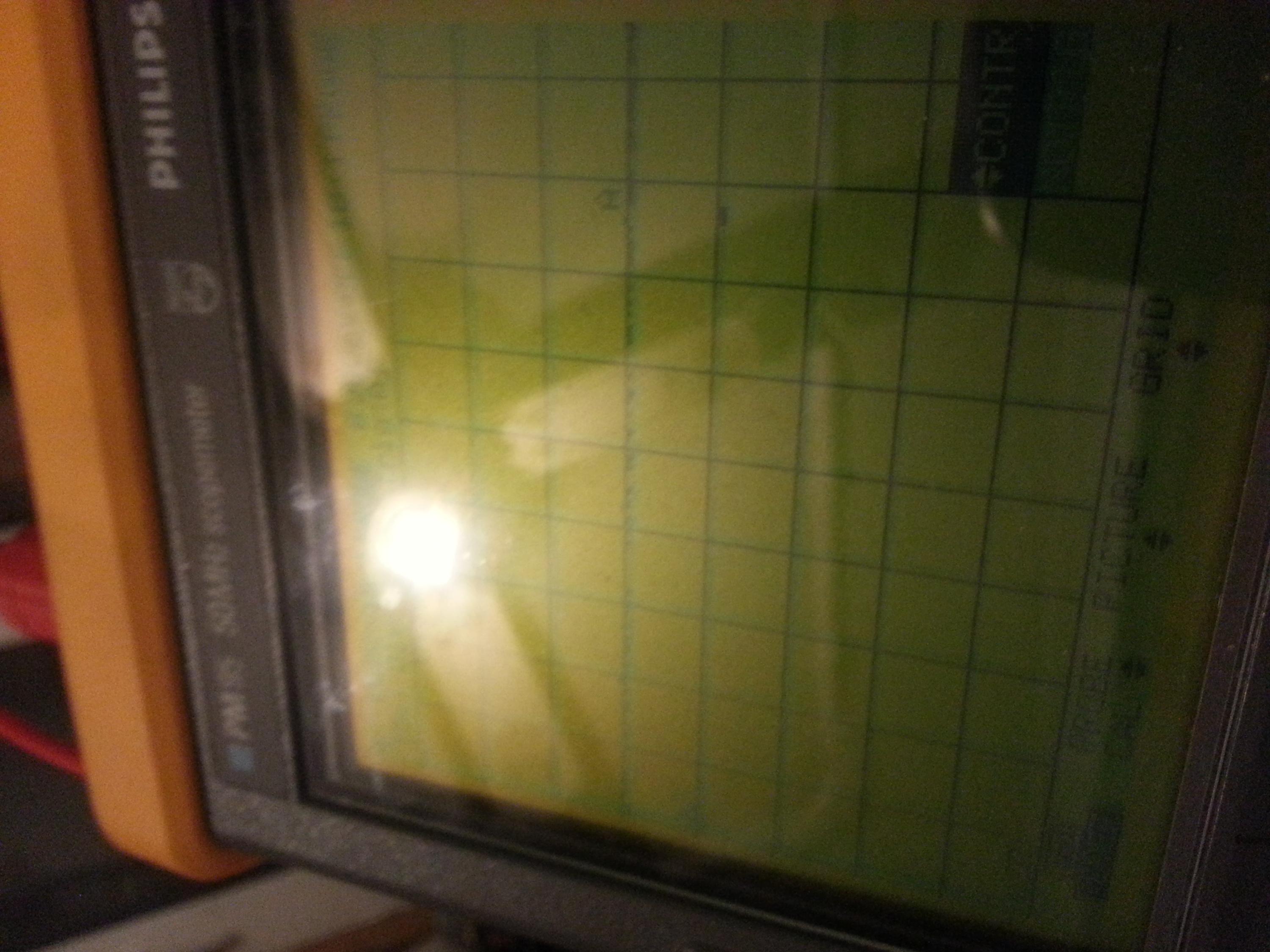

                          #52

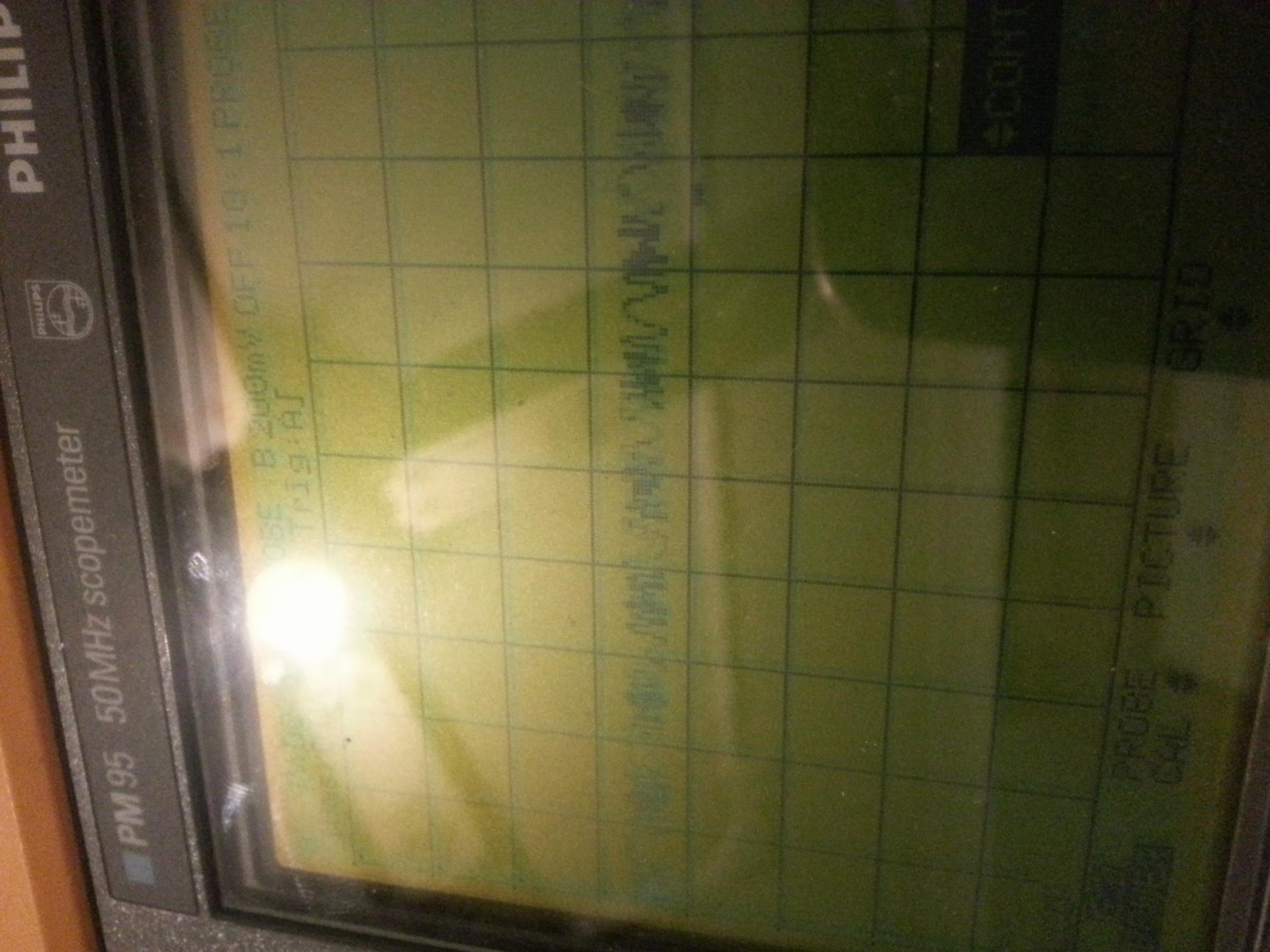

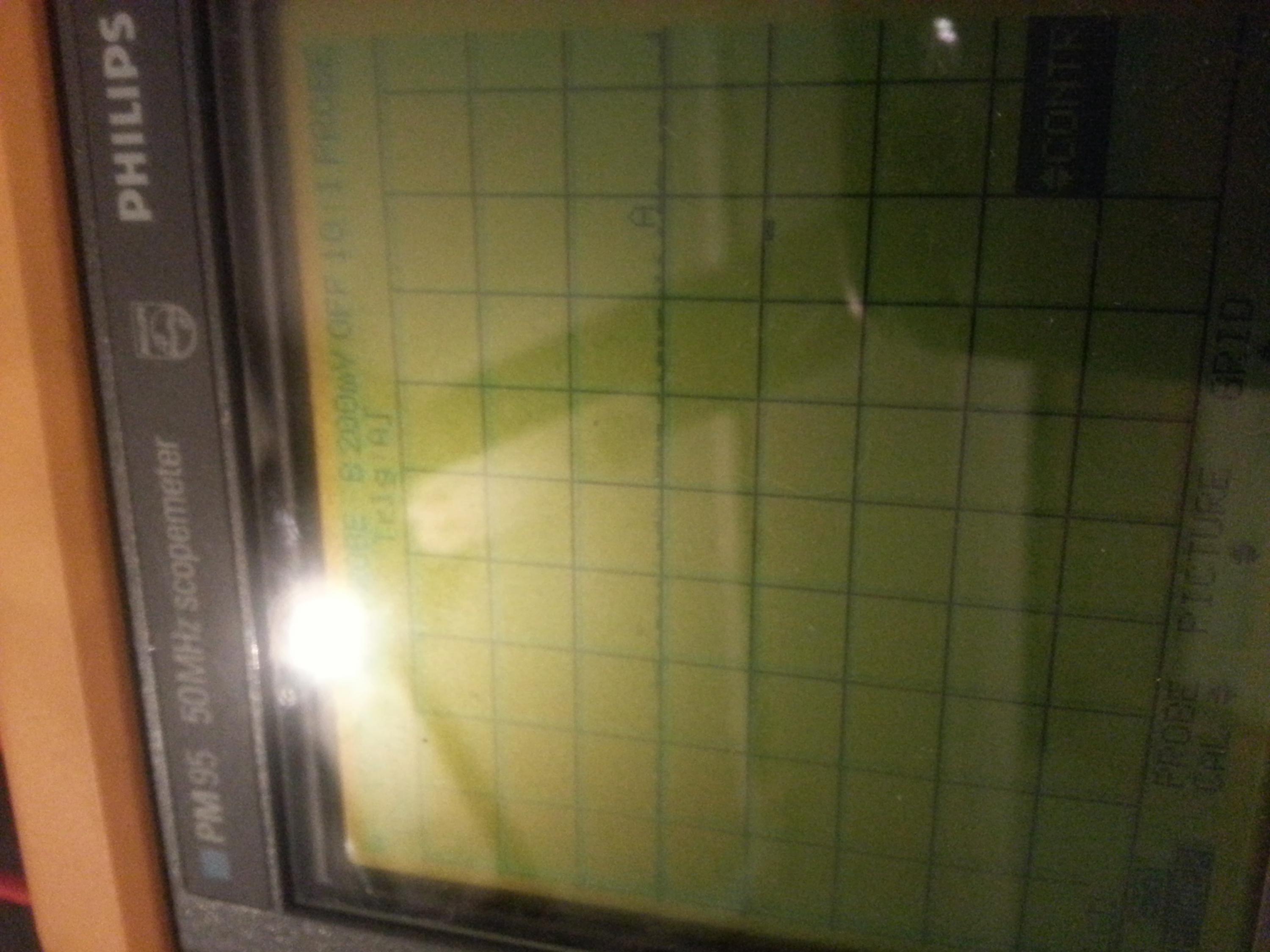

                          Try checking the R0N, R0P, RCN and RCP test pads. As you have been testing on the plasma.
                          • adamp91gvm
                            • Jan 2014
                            • 706
                            • uk
                            #53
                            1vdc 10ms/div ?
                            • adamp91gvm
                              • Jan 2014
                              • 706
                              • uk

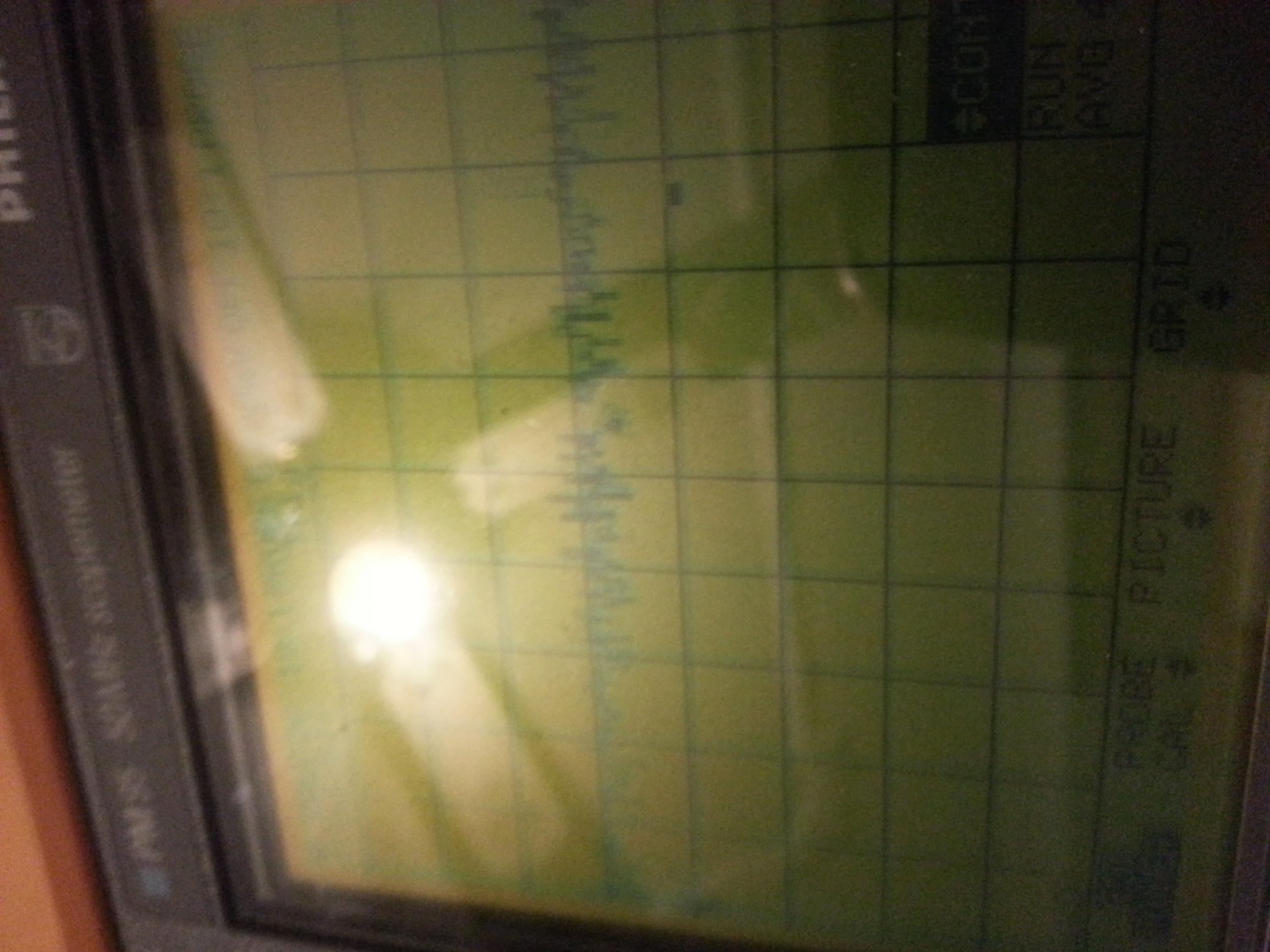

                              #54
                              Ron
                              • adamp91gvm
                                • Jan 2014
                                • 706
                                • uk
                                #55
                                Rop
                                • adamp91gvm
                                  • Jan 2014
                                  • 706
                                  • uk

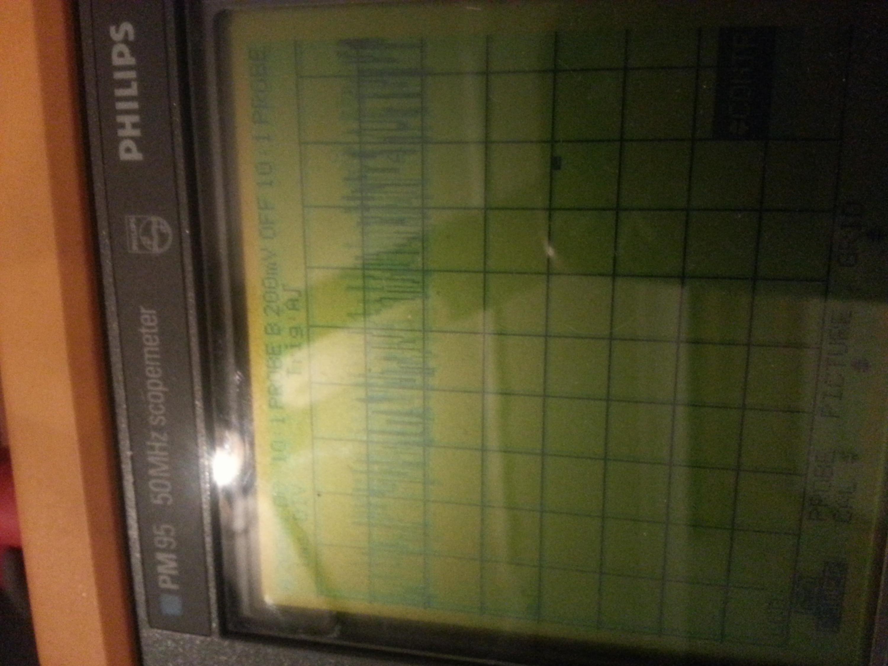

                                  #56
                                  Rcn
                                  • adamp91gvm
                                    • Jan 2014
                                    • 706
                                    • uk
                                    #57
                                    Nothing from rcp
                                      #58
                                      Try 100mV/div at 1ms/div on RCP and RCN.
                                      • adamp91gvm
                                        • Jan 2014
                                        • 706
                                        • uk
                                        #59
                                        200 mv it was other wise it went off screen with 1 ms that's rcn
                                        • adamp91gvm
                                          • Jan 2014
                                          • 706
                                          • uk
                                          #60
                                          That one had to be 20 mv 10ms/div that's rcp
