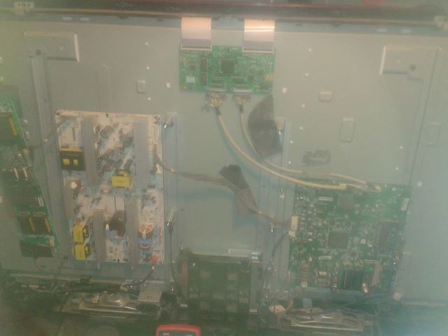

          Re: lg42lg7000-za schematic needed
          ok, I've got the tv open, Caps seem fine on the esr meter.
          the power supply took a bit of time to turn on but when it did I had all the voltages but nothing on screen.
          any ideas where I go from here?
                "the power supply took a bit of time to turn on but when it did I had all the voltages but nothing on screen.
                any ideas where I go from here?"
                More details such as backligts are on or not, PS_ON, BL_ON, 12V, 24V 5VSTB voltage readings? Pictures of the boards?

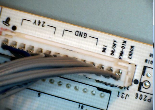

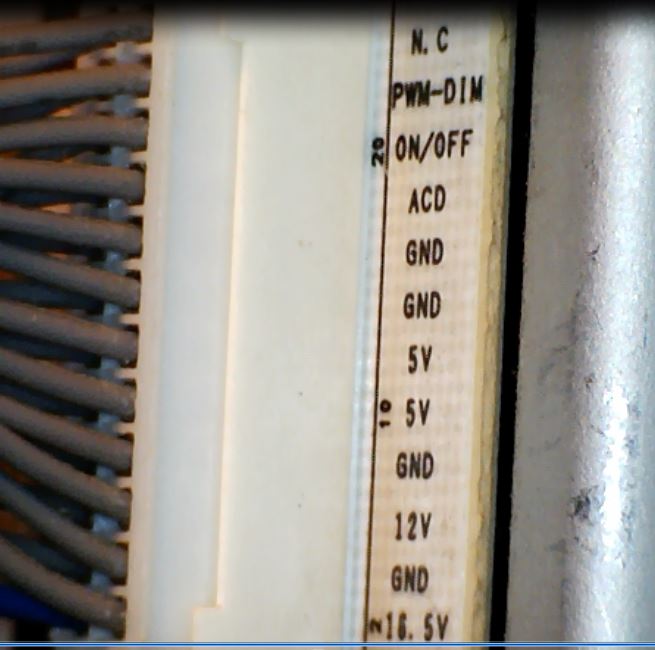

                                nc ov
                                pwm-dim 0v
                                on/off 4.5v
                                acd 5.1v
                                gnd
                                gnd
                                5v = 5.1
                                5v= 5.1
                                gnd
                                12v = 12.2
                                gnd
                                16v = 16.1
                                  Try disconnecting the PWM-DIM line from main board end, and connect it to a 5V line with a 100 ohm resistor in series, does backlight light up?
                                    error is 0v
                                    pwm-dim is 0v
                                    on/off is 4.5v
                                    bri is 0v
                                      how can I just disconnect the pwm line ? its in the plug with all the other voltage lines.
                                        Cut the wire approx mid way through, in such a way that it can be reconnected.
