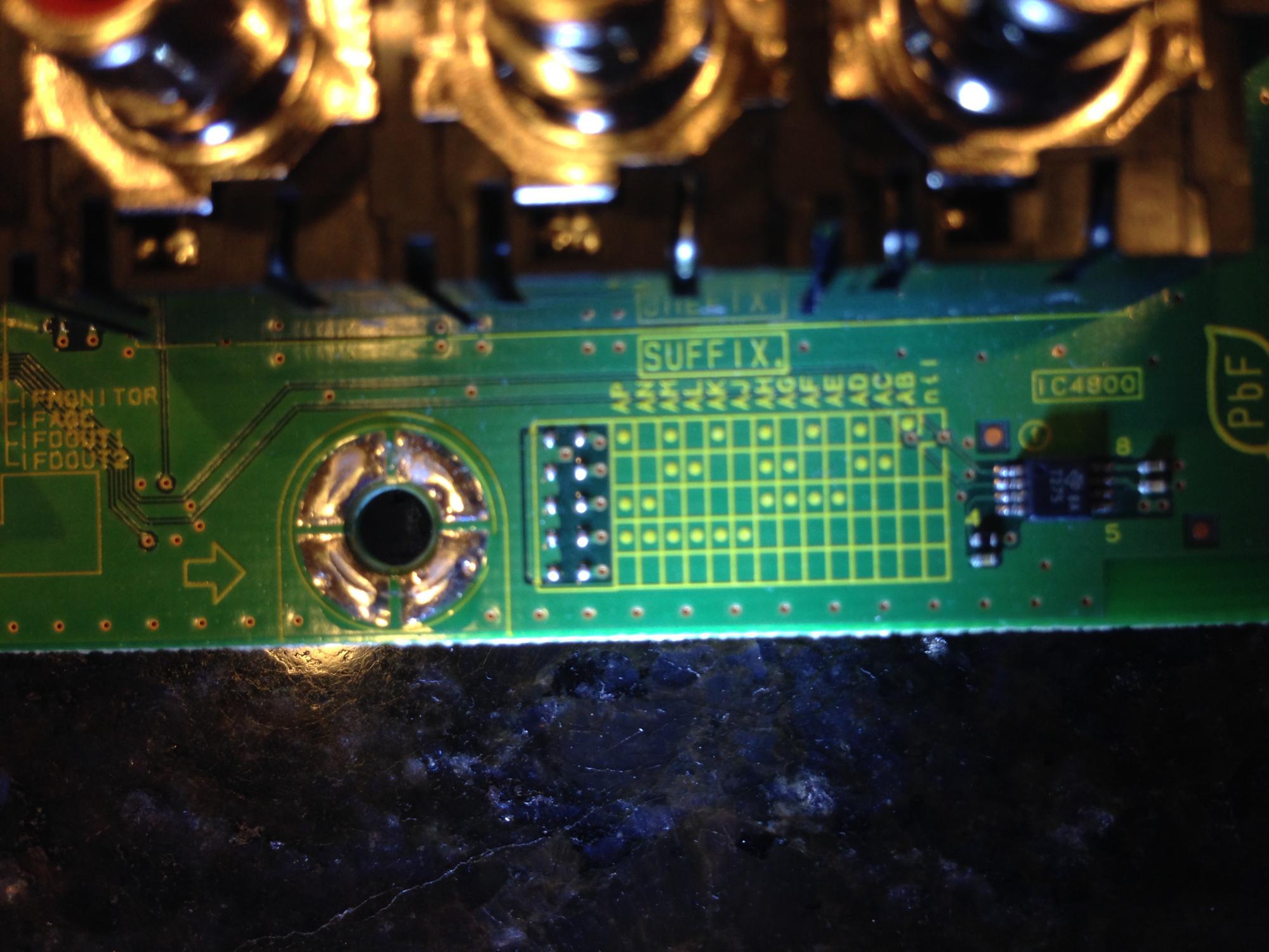

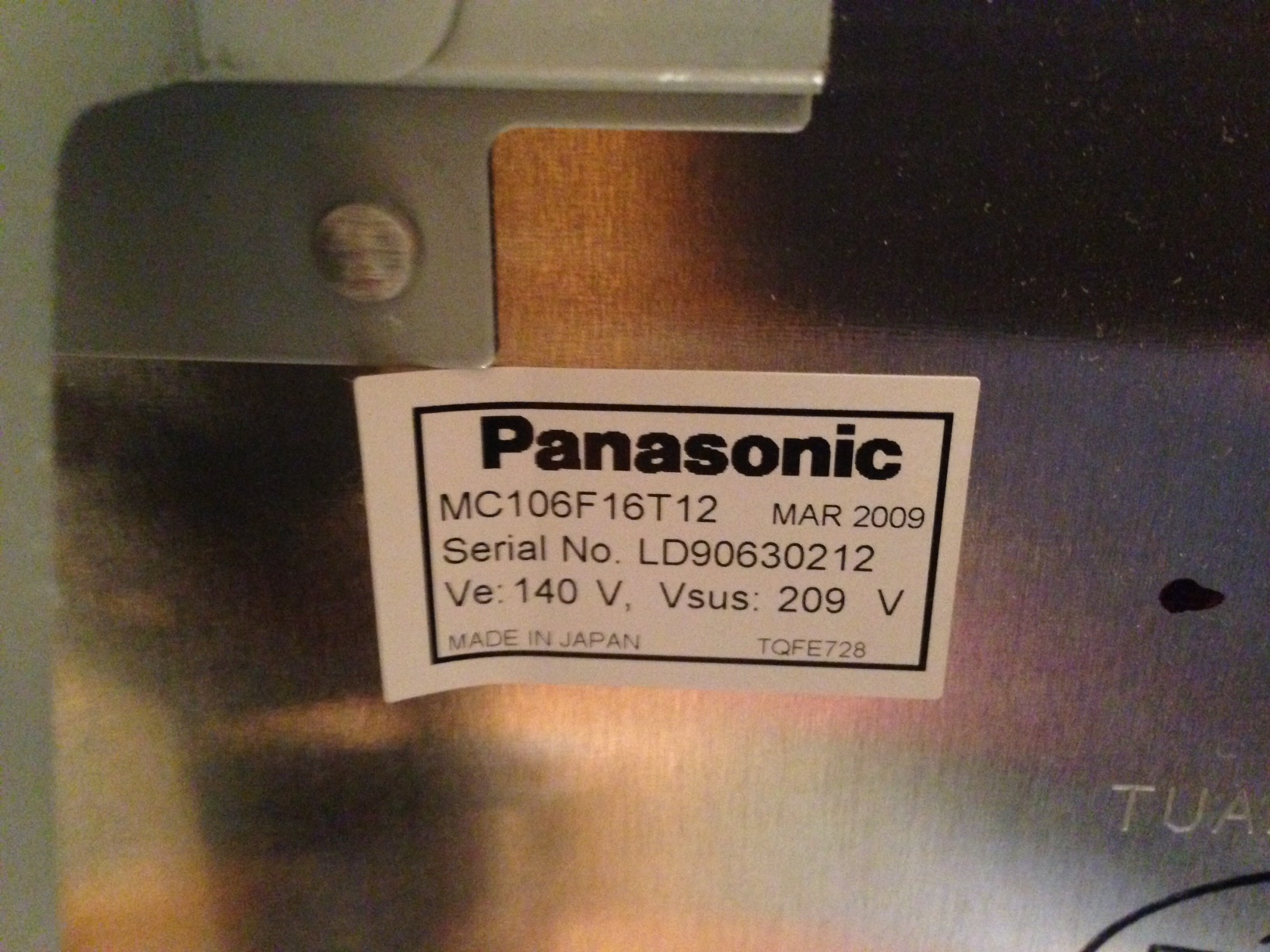

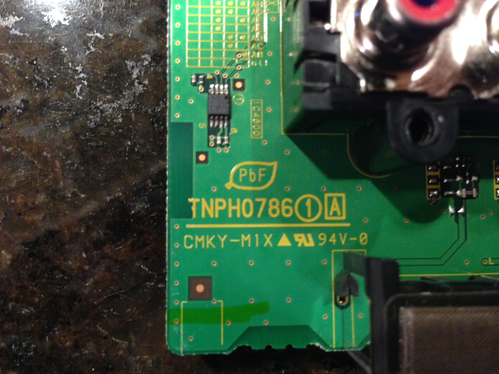

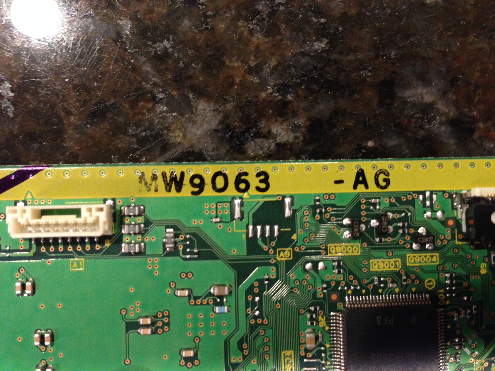

          Hello Badcaps Forum. I found this board looking for an answer to my "12 Blink" issue on a Panasonic TC-P42S1 plasma. I've read about everything on here and other websites trying to determine if I can fix it for about $200 or so. If not, I'll probably buy new.
          The TV is about 3-4 years old and has had no issues until one day on power down, we heard an additional click after it shut off and immediately the SOS light started flashing.
          Here's what I've checked:
          - unplugged SC board, 12 blinks
          - unplugged SS board, 12 blinks
          - unplugged both SC & SS board, 12 blinks
          - Checked standby and power on voltages coming into A board and all are correct
          - no shorts in speaker wiring or speakers
          - connected speaker to alternate signal source and the speakers function properly.
          By all I've read here and from other sources, it's the A board. However, my A board (TNPH07861A) isn't available many places other than used ones on Ebay with prices from $120-212.
          My questions:
          1. How critical is the board version? I have found TNPH0786AF at ShopJimmy & TNPH07862A versions. (I'm assuming they wouldn't work or can't be changed)
          2. Is there a way to bypass the sound amplifier altogether and just use a sound bar?
          3. Has anyone used ModusLink PTS (http://www.moduslinkptstvboards.com/txn-a1efuus/) for board repair? (This is the direction I'm leaning)
          4. Is there anything else I should do/check before reinstalling a replacement A board?
          Any other suggestions would be appreciated. Thank you in advance!!

            Little curious about the part number you've quoted TNPH07861A, sounds like the PCB print number.
            What other numbers can you find stamped on the board or a white sticker but not the one on the tuner module?
            A few have had SC boards repaired/refurbed at moduslink, can't remember reading any bad reports.
            • tw2005
              • Oct 2011
              • 6458
              Re: Panasonic Plasma TV LED blinking 12 times
              I'd stick to
              TXN/A1EFUUS or TNPH0786 no suffix. There's a matrix on the PCB above the TNPH0786 number. The suffix is determined by the placement of 5 jumpers above that table which you decode looking at the dots labelled in the matrix.
              SJ says yours has no suffix which I suspect means there'll be no jumpers.
              The AF is a 46" panel.
              42U1, version AE I suspect would work however A30 is missing for the fans.
              So it should work as they have the same panel, you won't have fans running.
              That's what I see at a glance.

                You are correct that the part number is TXN/A1EFUUS and the board number is TNPH07861A. There is no suffix that I can tell. Pictures are attached of the board numbers I find and the panel info.
