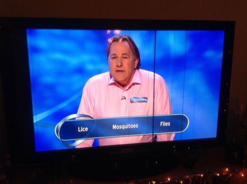

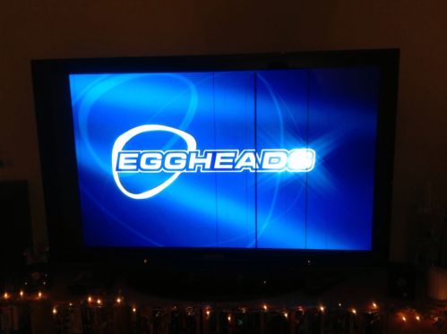

    This tv has vertical lines running down the screen i was under the impression horizontal lines are a failining panel as i've had previously on a plasma of my own until it got smashed
    so is vertical lines still a bad panel or is it a tcon or buffer issue?
    I've only ever seen one or 2 lines in a screen but this has several
    Re: Samsung PS50A457P
    More often than not it will be panel, chips embedded on the bottom ribbons fail so non-repairable.
    I have had it once on a 2007 panasonic, single line, was the panel, tried all the reseating, board swapping etc. no change.
    rare but sometimes I've read it was a bad connection but I myself would not consider any TV as a repair project if it had that display.
    that's my opinion anyway.
      ALL vertical lines are bad panel, MOST horizontal lines are bad panel.
      This is a bad panel shockingly common with these models.

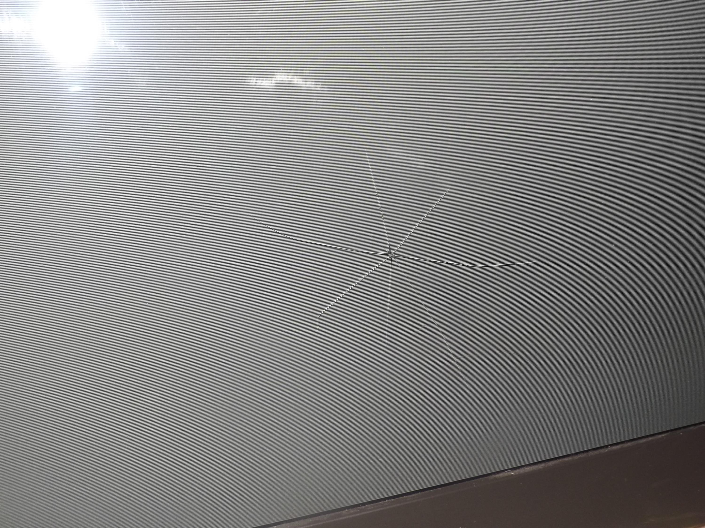

                          How'd a battery break the screen, are they really that fragile? My PZ80 has a 1/8" sheet of glass in front of the internal plasma panel. You could break that glass and have it replaced for about £50.
                            basically I'd thrown a toy of the kids a battery came out and bounced up and hit the screen now i get sound and just blackness on turning on you can see the screen powering up as the black changes colour.
                            At first it wasn't noticable at all (the crack) until i looked closer, it doesn't feel like it's the outside glass or whatever it is as the crack doesn't have any feel to it from the outside so i'm assuming it's the actual plasma panel underneath
                            Have to say i felt like crying when it happened and still do haha
                            got a SHARP Aquos LC40LE831 in it's place from upstairs in the mean time, but 40 inches just doesn't compare nevermind the other features i've lost
                              If the screen is glowing and not buzzing are you sure the panel is bad? It probably IS bad, but I've never heard of a cracked plasma panel glowing.
