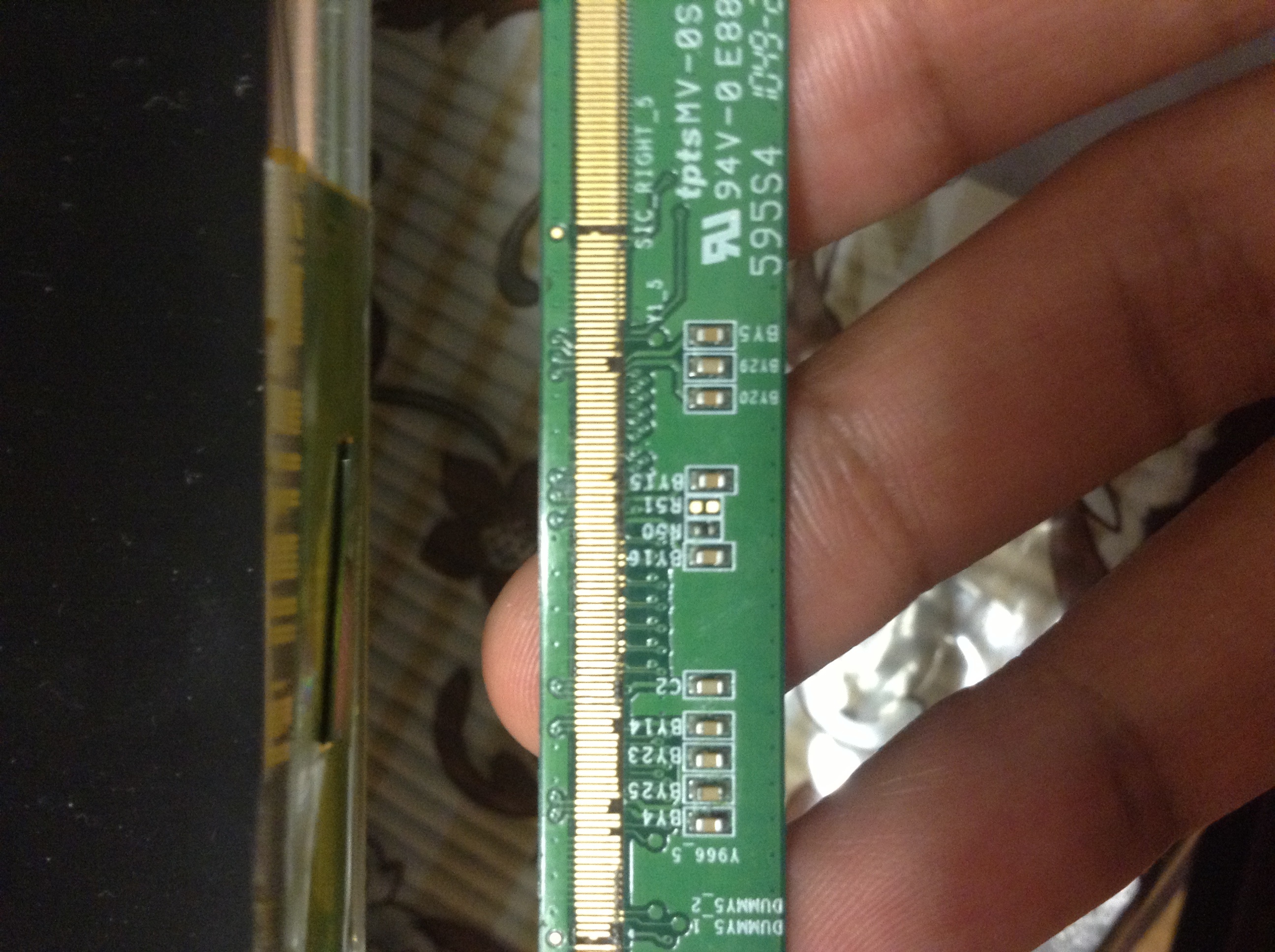

    Hi, ive been doing a little reseach on how to fix this, but i want to know is it possible? Soldering the thin wires? My kids watered the tv, so then i opened it found a flex tab that had been eaten from corrosion. Please tell me how to hard wire them, its already damed but want to give it a try. I don't know if i should have , but i peeled the tab off.
    Thanks for the help

    That sadly may not be repairable. Those are fused on with some kind of epoxy I believe. You could try heating it with an iron but don't think it's going to get very far.

            I'm pretty sure that's not repairable. Too fine for any one to do by hand. Need an expensive dedicated machine to do that.

              What about that 3M conductive tape that only conducts in one parallel direction ?

                  Worth a shot, I suppose - it's the alignment that's going to kill you, the individual lanes are probably 0.05mm apart. If you can line it up, maybe... Big, big maybe.

                          It's definitely NOT solderable, you'll break it. Feel free to try other methods.

                                  I don't exactly know but I would guess that tape may not be suitable for an appication where the temperature fluctuates so much, an Ipod I'm sure is fine but in the back of a Tv, I'm not so sure. The way I see it is heat is used to remove sticky things, whether they be glass digitizers from phones, Ipads or ribbon tabs as he showed in that video, so if it does work, and because of the heat generated, I don't think it will last long if indeed it works at all but as ever, you have to try to see, so good luck, if you do go down this root it will be interesting to see and hear what the results are, Andy.

                                        The difference I see between the two fixes is the BWM guy is actually using just simple old sticky tape to hold down that type of ribbon cable in place, the Ipod guy is using this special conductive sticky tape that the OP desires to use in this application. The tab bonds do require some level of mechanical strength where as the BMW fix looks to clamp firmly down with the four screws giving the mechanical strength required. I just see this becoming the infamous tab bond issue extremely quickly what with the heat variations that will go on, especially around the tabs, I would have to advise on some pressure over the areas concerned, plenty said here on how that's done.
