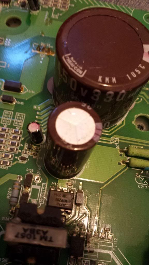

    Hello all!
    I need the schematic for the PSU of a Pioneer plasma PDP-435.
    The service manuals does not cover the PSU but everything else.
    Reason is I have a blown standby powersupply where the 8-pin controller IC "lost his hat" during a power surge.

    Re: Pioneer plasma PDP-435 need PSU schematic
    hi whats the psu board sticker number?
    • PowerAmpFreak
      • 982
      • Sweden
      Hi, the sticker says: AXY1085-B
        http://assets.shopjimmy.com/media/ca.../x/axy1085.jpg
        Please see the picture in the above link.
        The small (7-pin) DIP integrated all-in-one SMPS controller, next to bottom side of PCB, is the one I need.
              The IC of interest has designator "M1" in silkscreen of pcb.
                I think I still have an old.power supply at home. I'll look tonight for you..
                  I can tell you that I have a power supply from a pioneer pdp503 in front of me at work that is using the M1P282 IC
                      Thanks for that info. I find no info about that IC at all.
                      Designator M1 = P282? Did I get it right?
                          Yes that's correct.
                          Here is a pic.. Note this is the power supply to a pdp-503mx. http://i845.photobucket.com/albums/a...psa1aa128b.jpg
                            This IC M1P282 is a very rare one unfortunately, I certainly need to look for scrapped PSU's to find one.
                                Too bad your in Sweeden. I'll give you that power supply. It's scrap but the rectifier and startup circuits I know are good.
                                  I am very positive to buy this from you. Since the powersupply is not the same, but obviously uses the M1P282 maybe you could cut out the standby supply part, to lower the package weight?
