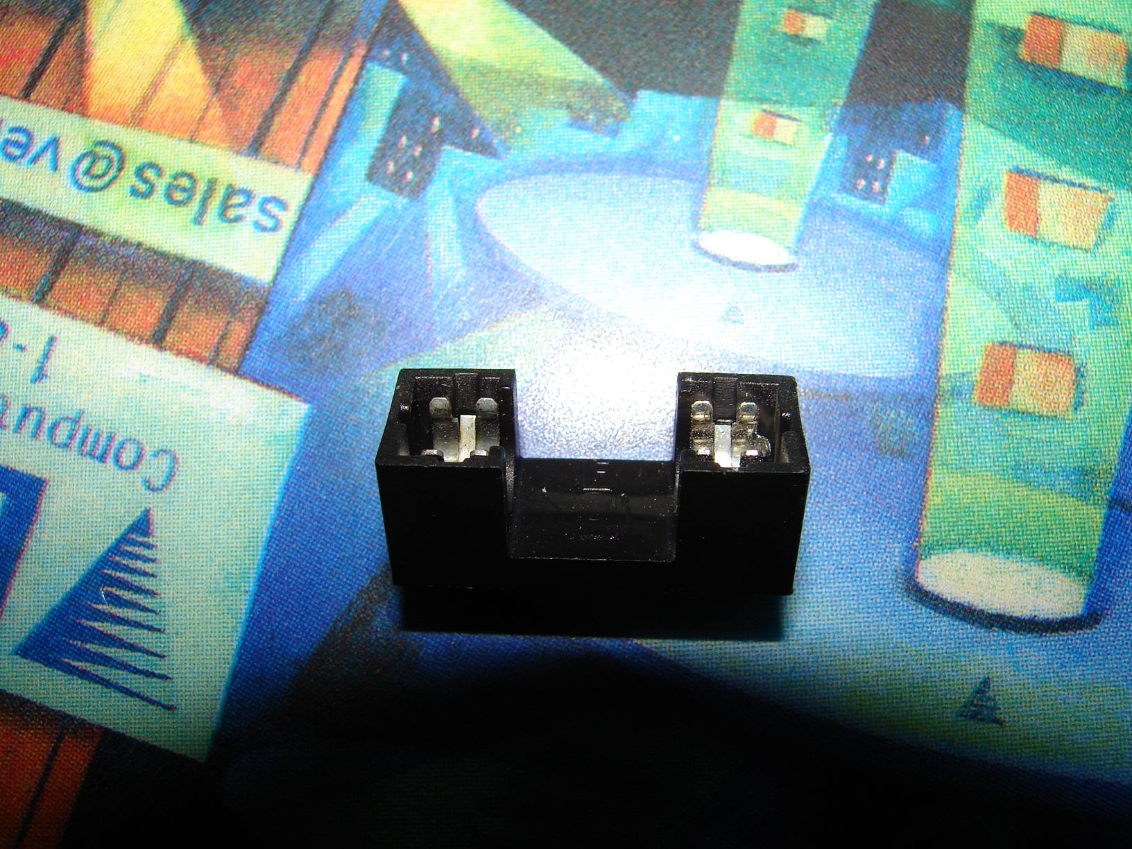

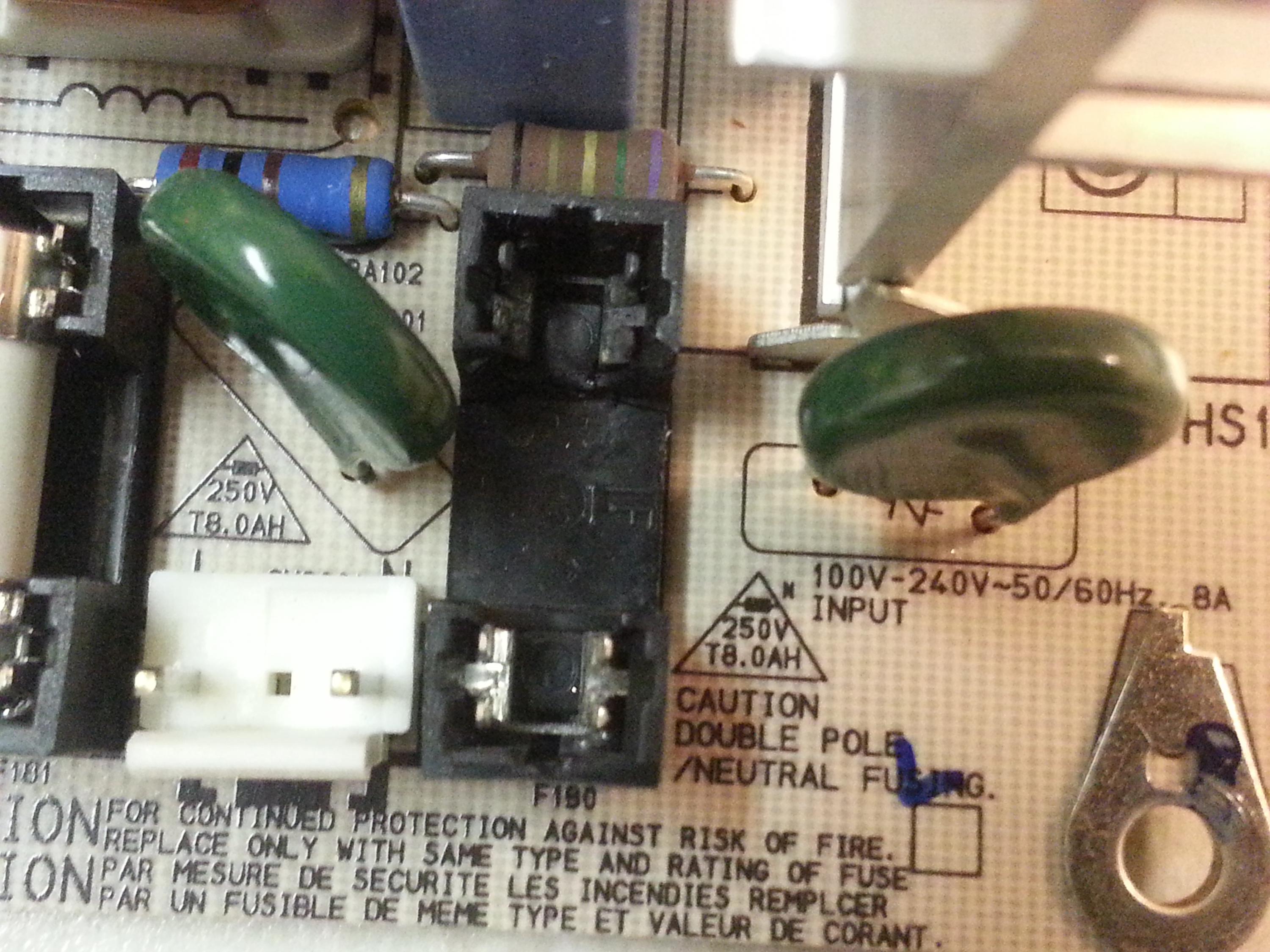

          Is the fuse in a fuse holder? I have seen faulty fuse holders cause this problem, replace the fuse holder. If the connection between the fuse and the holder is a bit resistive it will cause heat, once it is heated the spring tension will be lost. I uploaded a picture of a bad holder, note the darker contacts on the left vs the nice shinny contact on the right.
            There is definitely discoloration on one end of my fuse holder. There seems to still be plenty of tension for holding the fuse though. I'll go ahead and replace it anyway. Are they general in connection and mounting, or am I going to have to research a part number? Link?
            Any other suggestions?
            Thanks for the advice.

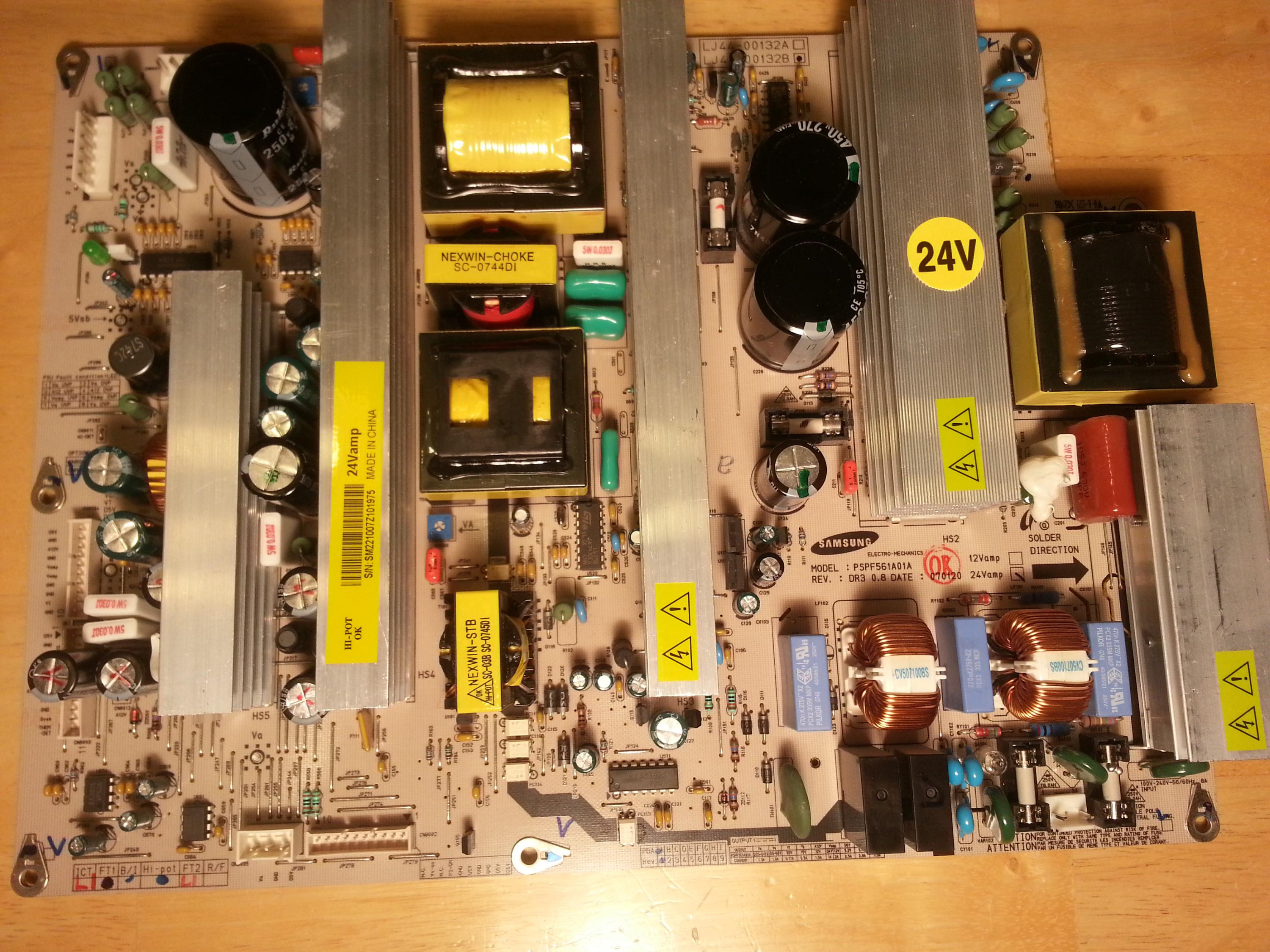

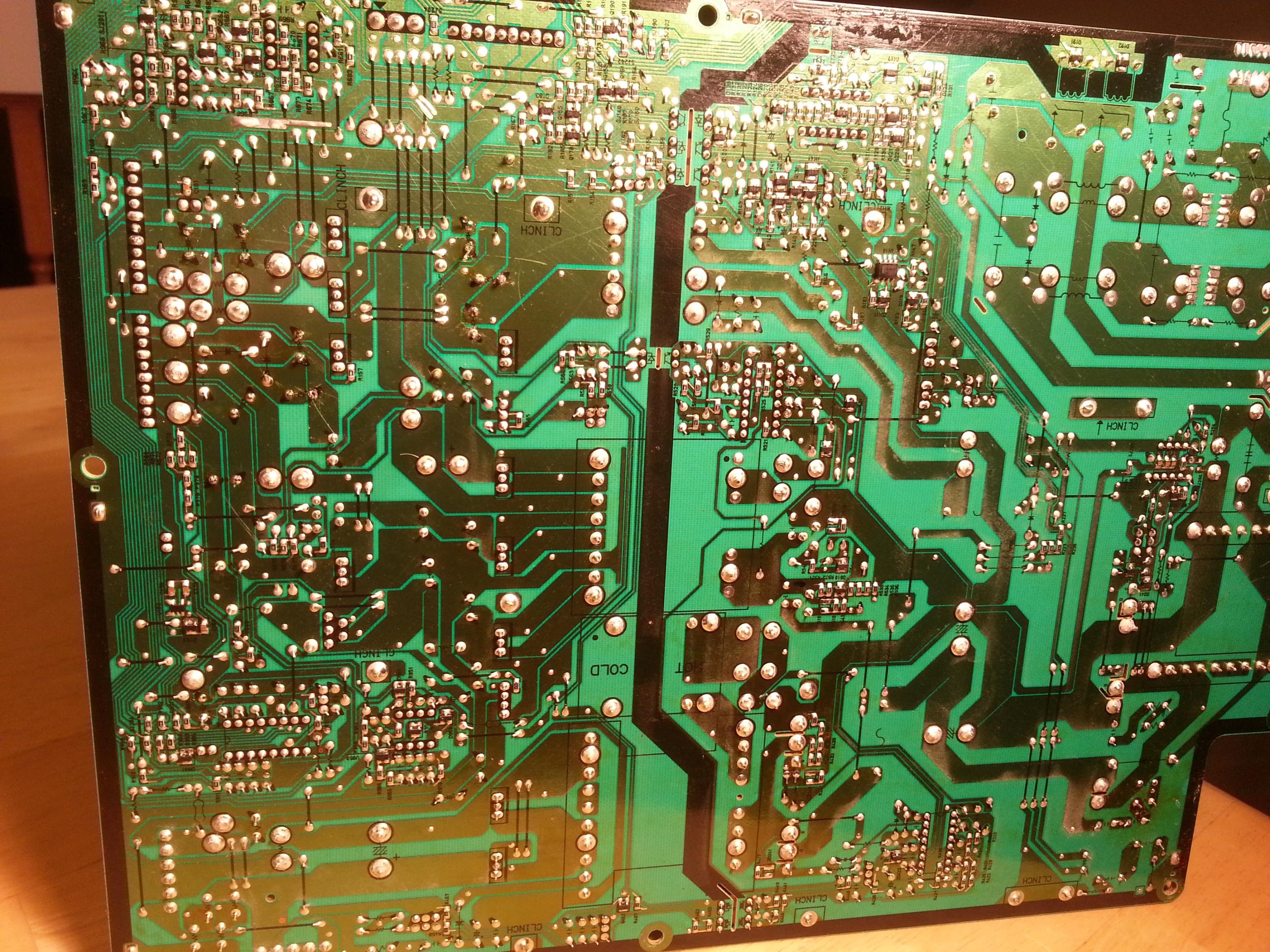

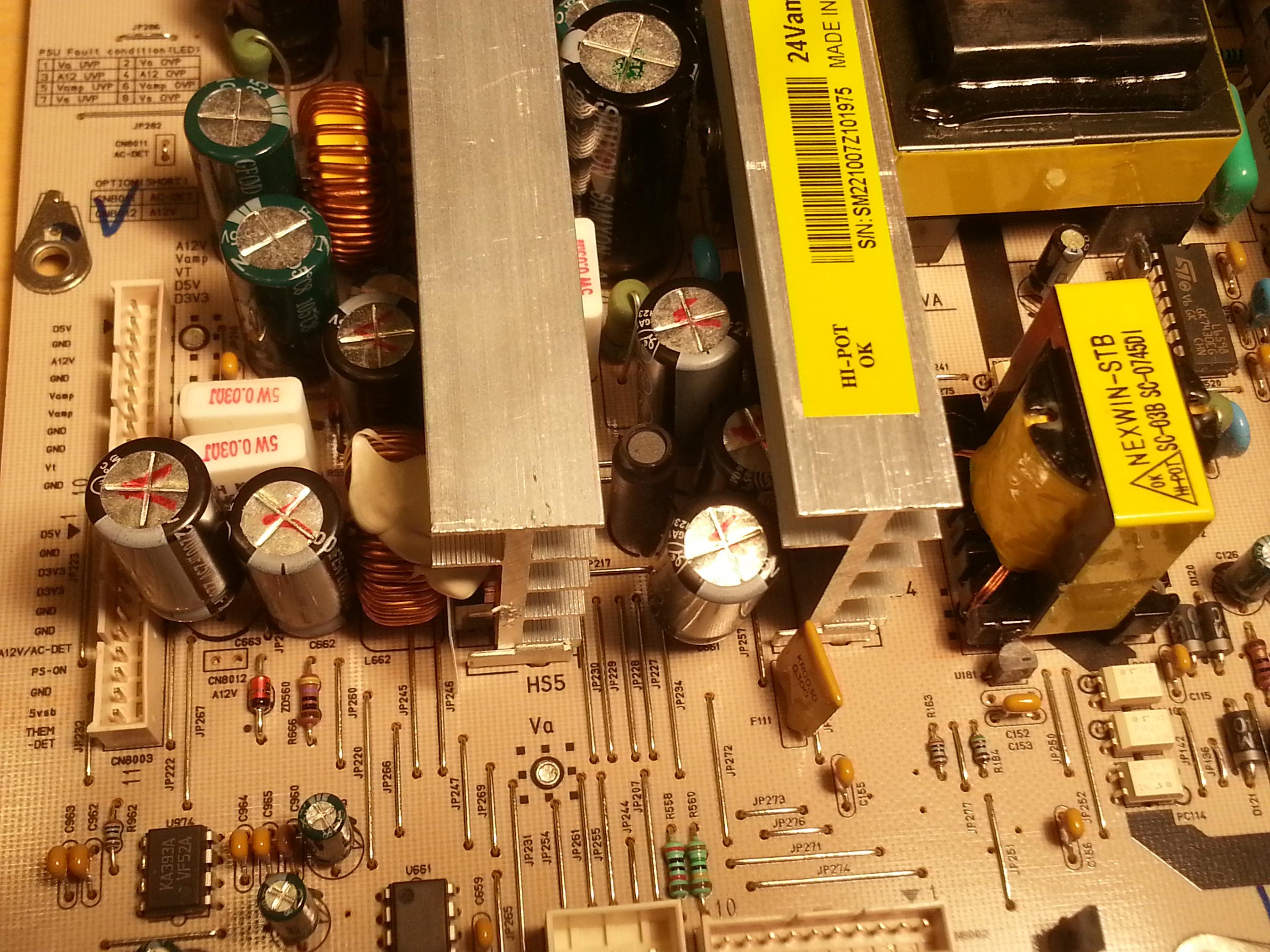

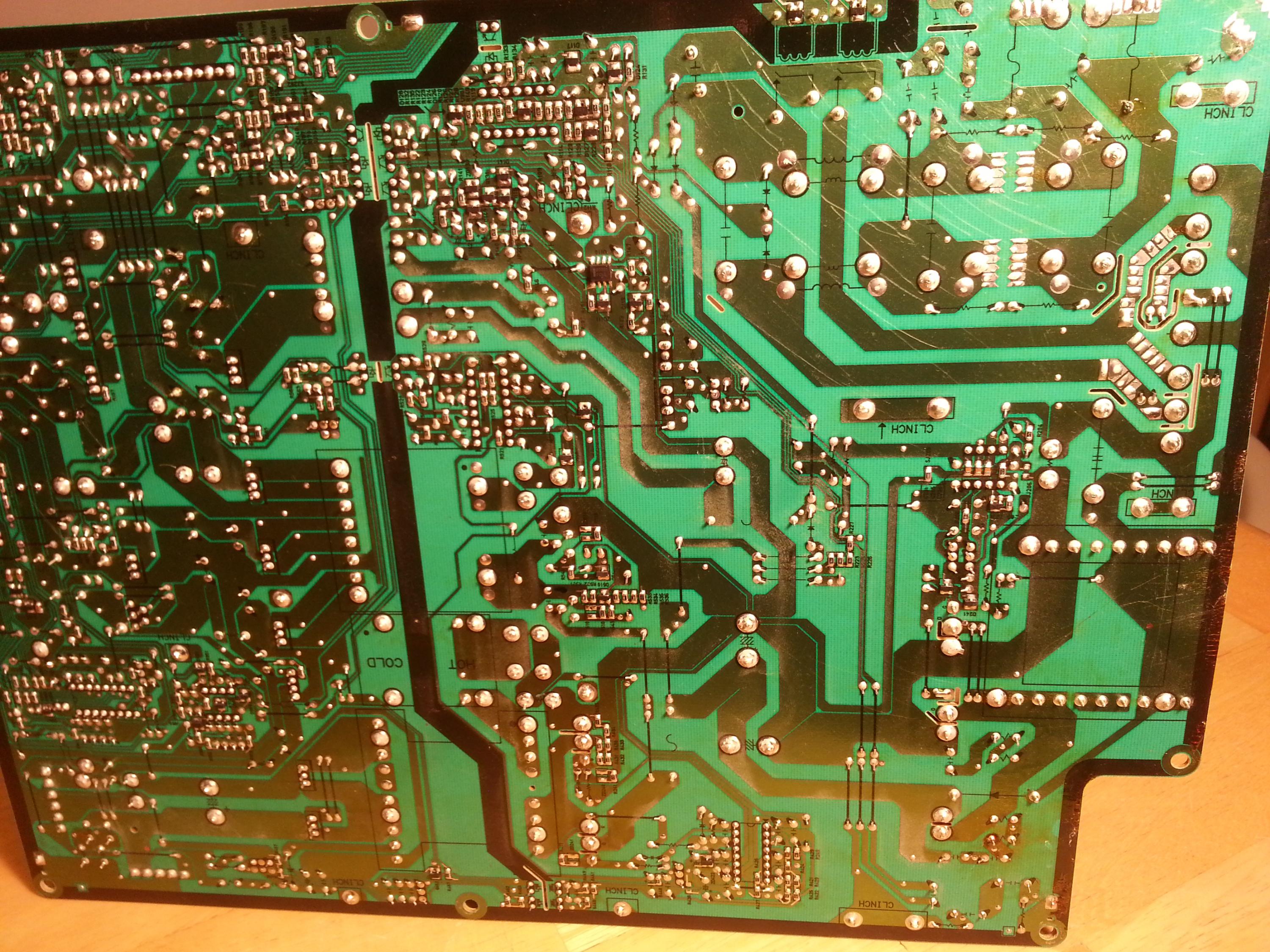

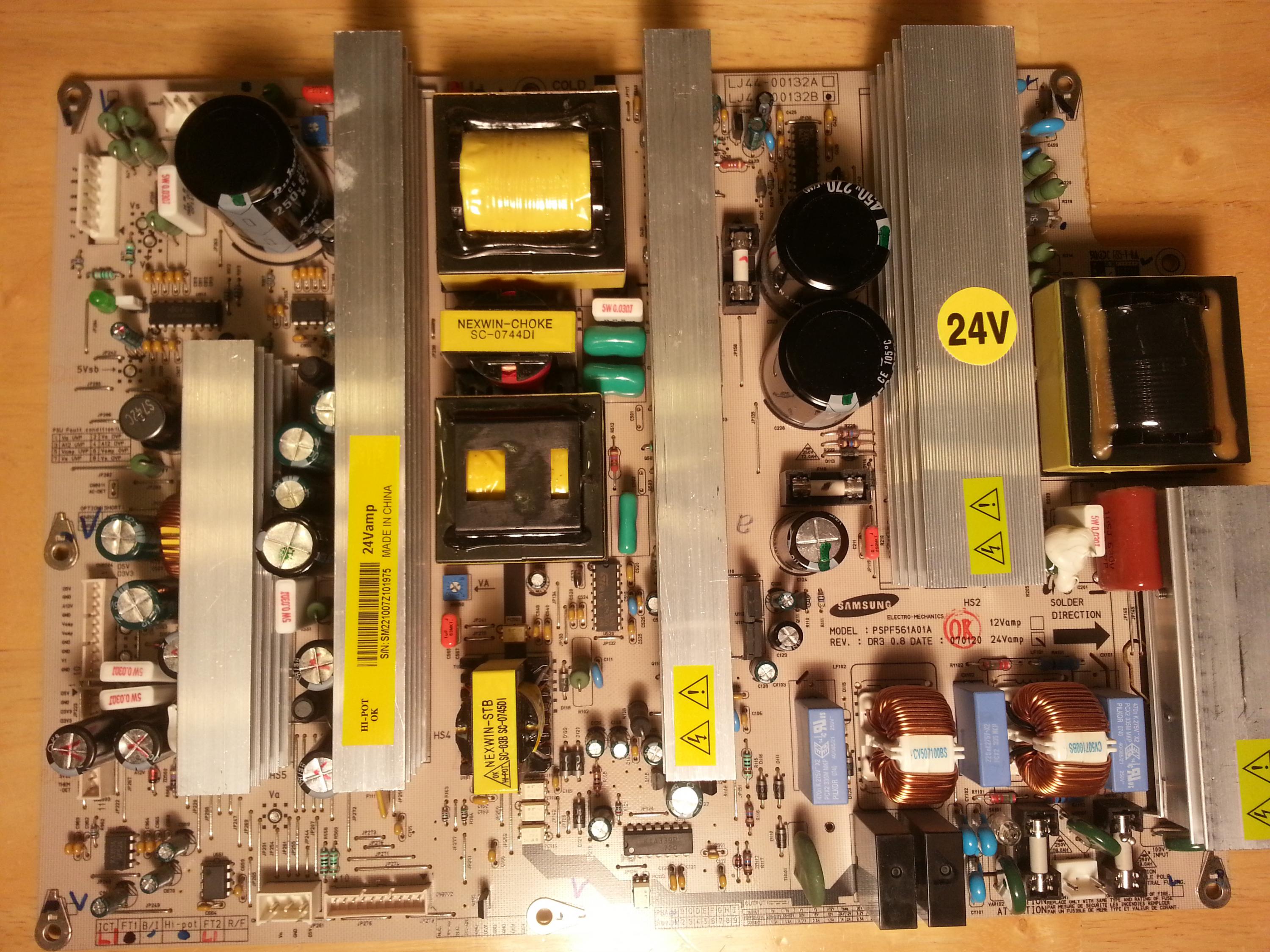

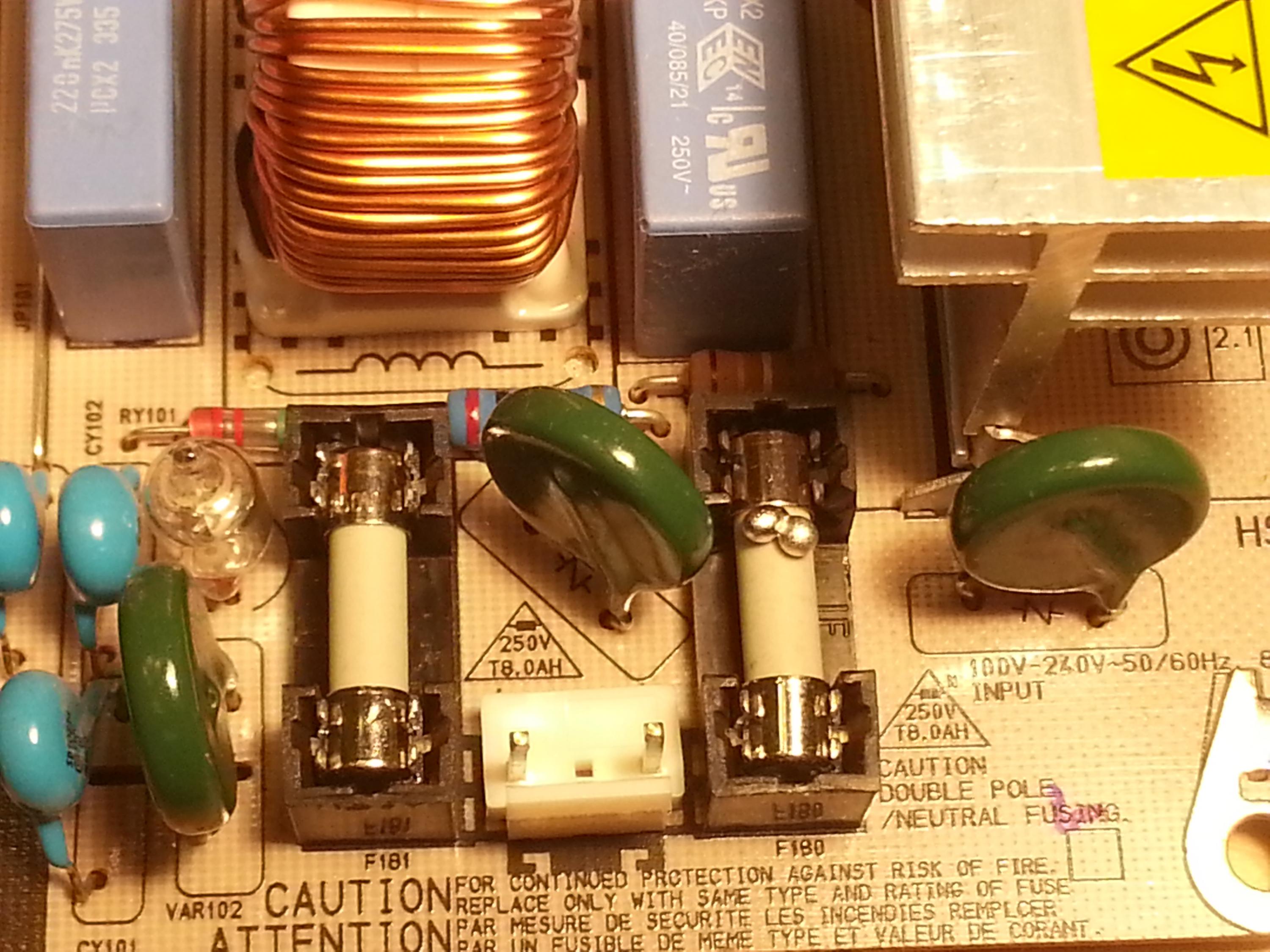

                  I snapped a few pic's if it helps at all. The new (2 day old) ceramic fuse is also getting melted. The capacitors marked with red (6 ea.) are the ones that I replaced with the "kit".
                  I am having atrouble locating the correct fuse holder to order from Digikey. Of the ones they have listed with a picture, none match exactly what I have. I couldn't find a part number on the fuse holder itself (unless it's on the underside) other than a LF marking. I assume that stands for Littelfuse. Any suggestions?

                    Re: Vizio VP50 blowing fuses.
                    Both sides of the ac line are fused. The fuse Is not (blowing) it is failing due to heat. Do a search on xbay for (5mm x 20mm circuit board fuse holder)you will find one or more there.

                      Those fuse holders are used on many boards, I got mine off an old lg ysus, check with a electronic shop, they might let you take one off an old board

                        Please replace fuse holder or repair.When all components check OK TV working and after couple hours or days blowing T8A250V main(input) fuse I found bad fuse connection overheated fuse holder contacts.
