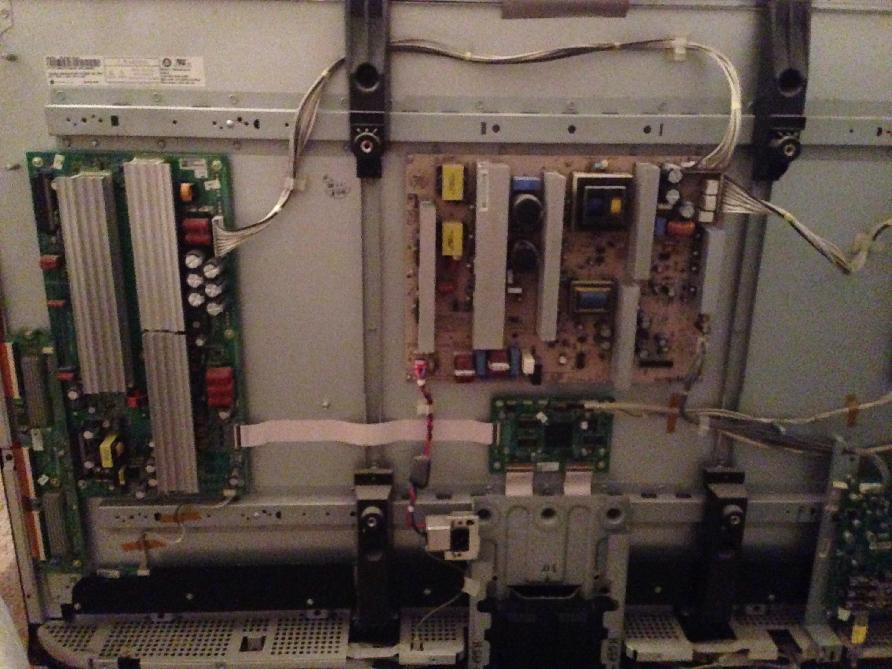

    Re: Lg50pg3000 not working
    Can you supply pictures of the circuit boards in the chassis? Buffer board failure is particularly common on these sets.
    • Ballvalve
      • Dec 2013
      • 11
      • Ireland
      Here is pic one

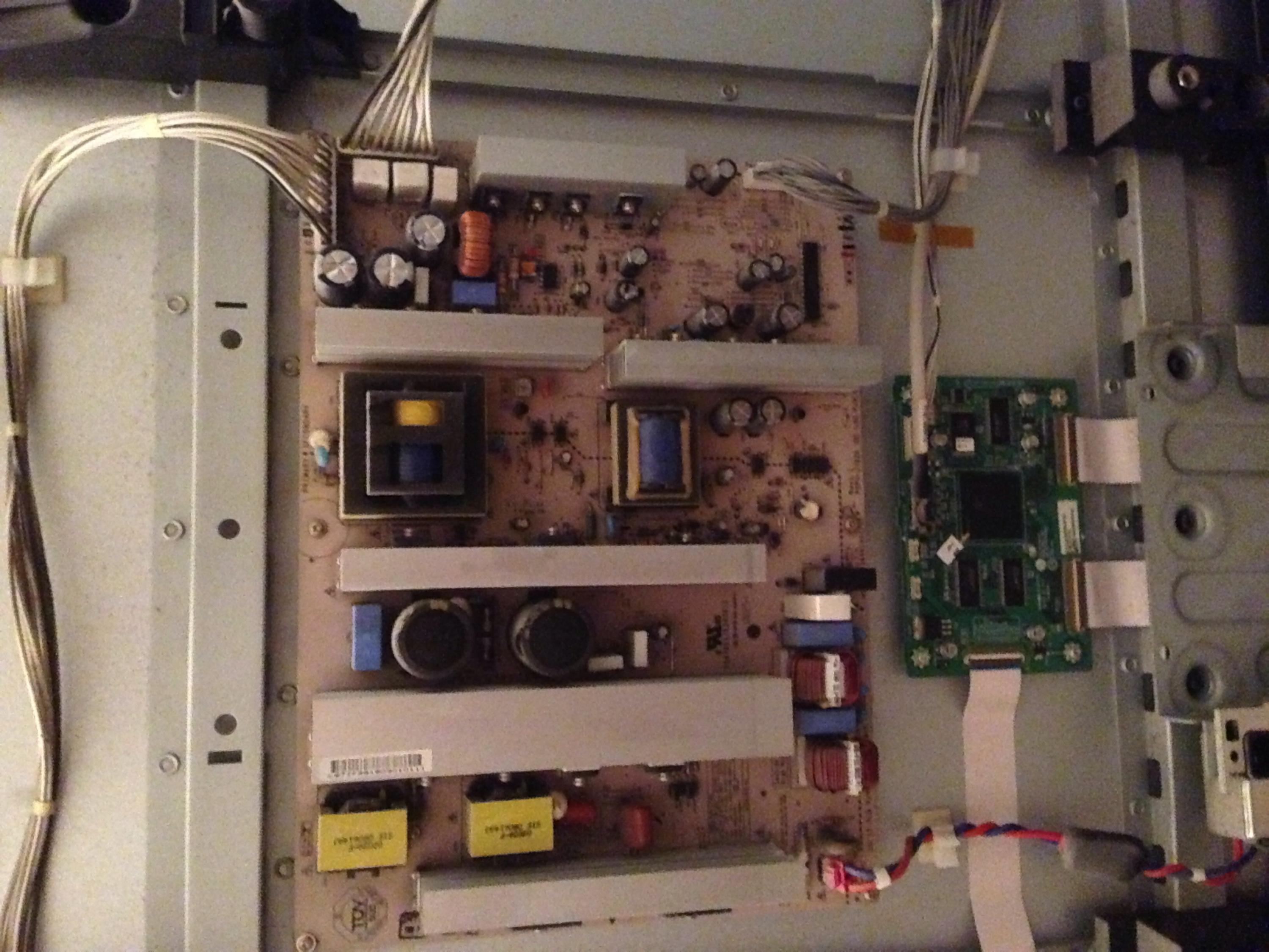

        Pic two

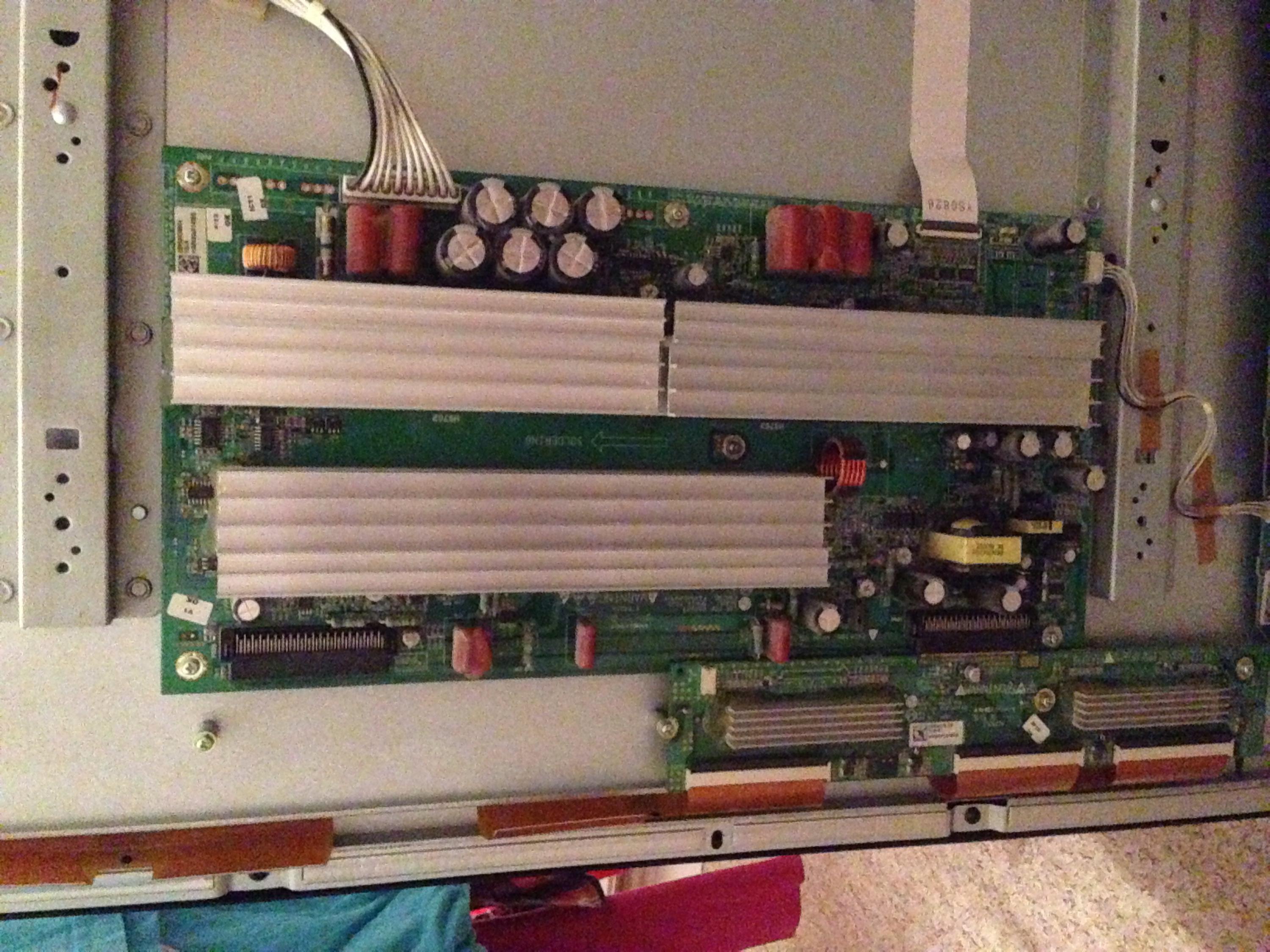

          Pic three

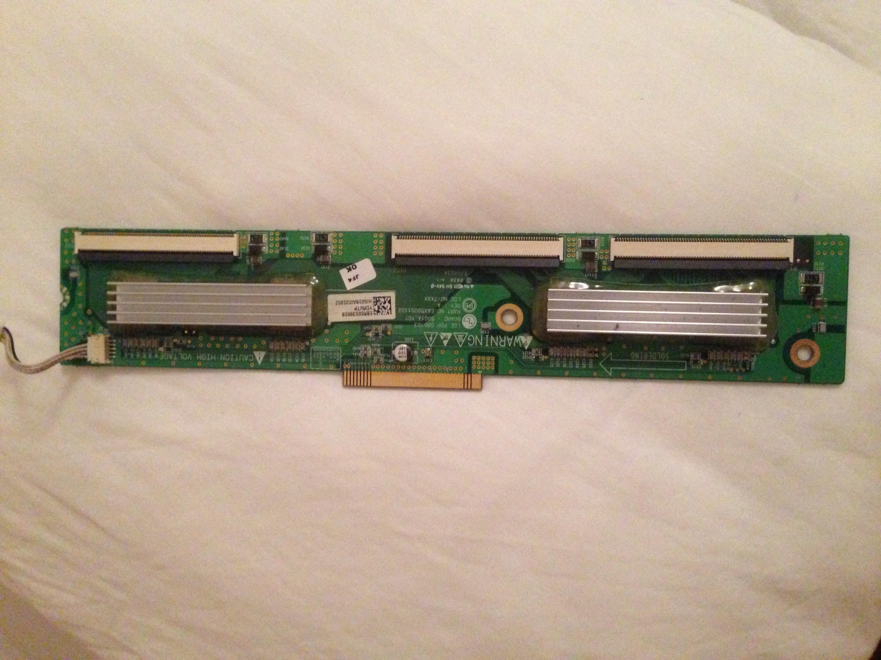

            Here is the buffer board I took out

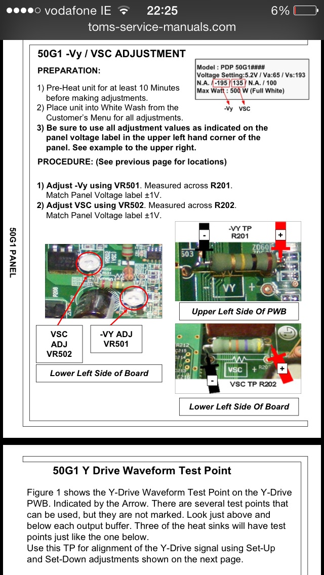

              OK, top left of plasma panel (https://www.badcaps.net/forum/attach...2&d=1388265614), there is a sticker, marked: MODEL: PDP50K1##### (for example) What does your say?
              • Ballvalve
                • Dec 2013
                • 11
                • Ireland
                Pdp50g1####
                  OK, the manual for your plasma module (note: not TV, but the screen inside the TV with all the boards) is here, search for 50G1 to find the right page:
                  With both buffers installed refer to the test points for Vsc and -Vy and confirm if the voltages are good.
                  Then remove one buffer at a time and see if a voltage returns, if it is missing.
                  You must use a digital meter and make sure to unplug the TV for at least 30 seconds before making -any- connection change.
                  • Ballvalve
                    • Dec 2013
                    • 11
                    • Ireland
                    Do I test these test points to earth and what voltage should I get. I have a fluke meter so should be able to test them
                      You measure -across- the points indicated with the black and red as specified.
                      • Ballvalve
                        • Dec 2013
                        • 11
                        • Ireland
                        I have 154dc across by and 135 across vsc with the top buffer out.
                        I have no voltage with across them with top buffer in place
                          154V? Are you sure? Not 194V?
                          But yes looks like top buffer is bad.
                            Ye defo 152 v dc .
                            Can I adjust this to 195vdc
                              Just to make sure are you testing across the resistor marked Vy? If so yes try adjusting it up although I would not expect this to restore picture.
                                It will only turn up to 154vdc.hopefully if I get a new top buffer board it'll work .
                                Cheers for the help
