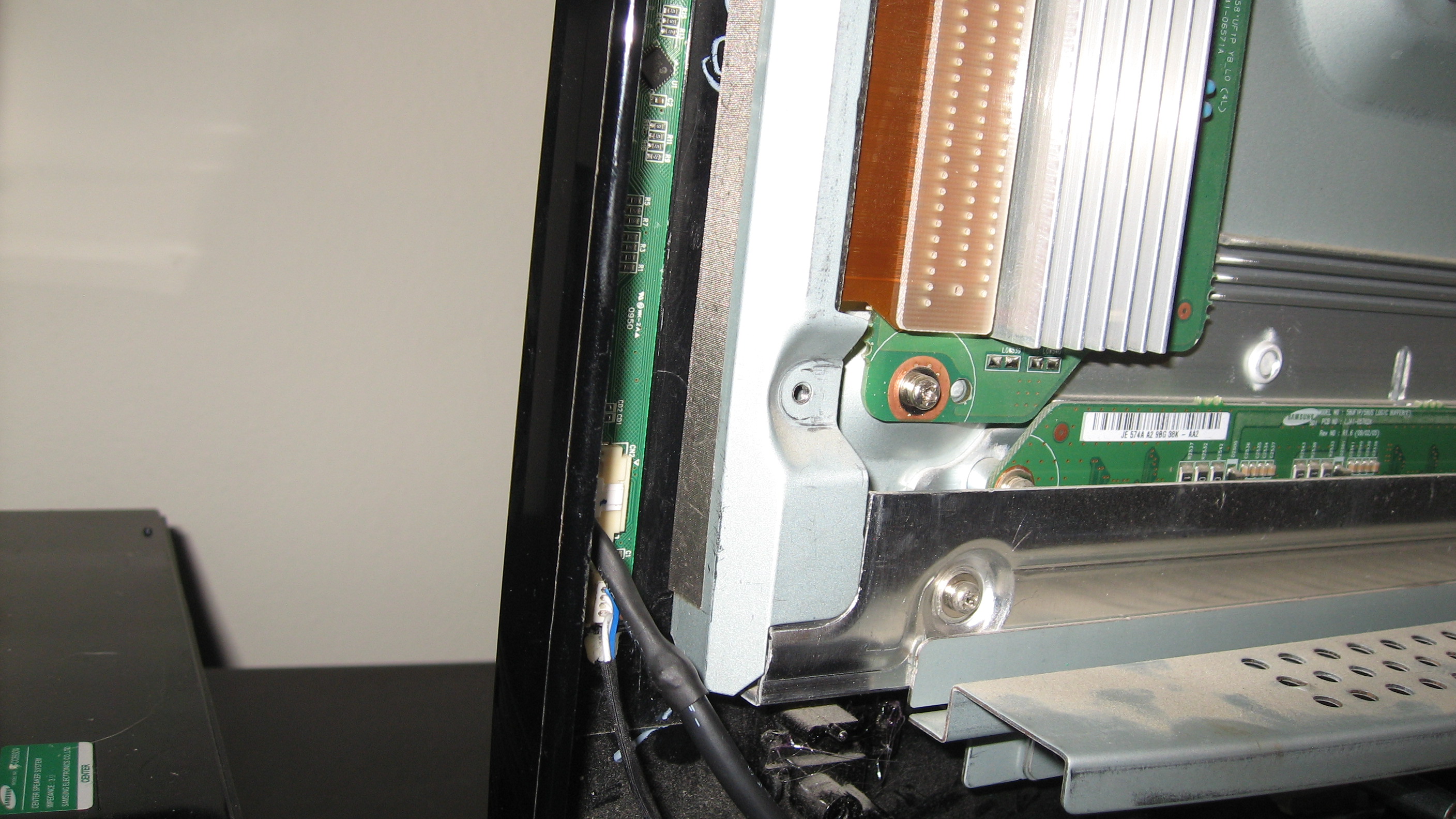

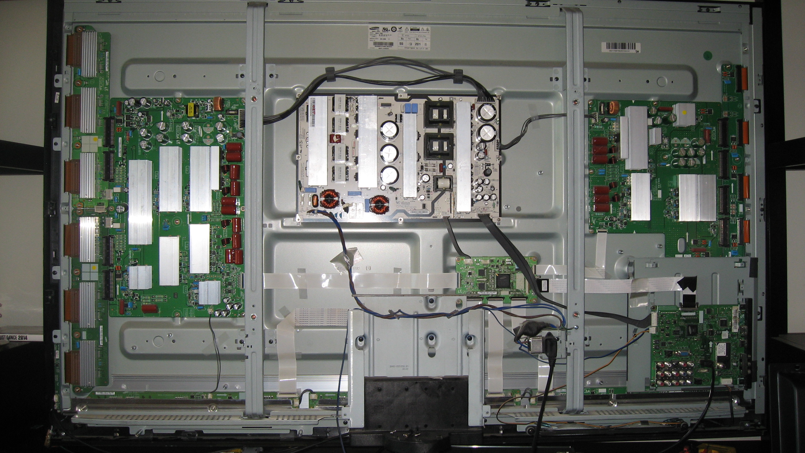

                    Re: Samsumg Plasma 58" PN58B540 PowerSupply Shutdown
                    Here is some more info that might help.
                    Attached is a large view of the back of the TV. The issue I am having is on the lower left of the picture. The second image is a close up of the button control module. On the side of the aluminum frame you can see the conductive tape (at least that is what I think it is). The voltage is hard to determine with the DMM. It appears to be fluctuating. Is this normal to have a voltage on the tape?
                    I have disconnected the button control module from the main board and it is still powered. I believe this is coming from the charge on the conductive tape since I do not see anywhere else that the button control module could be getting any power. As soon as I plug the assembly into the main board, the tv shuts down.
                    Any troubleshooting ideas would be greatly appreciated! Thanks for all the help to get me this far.
