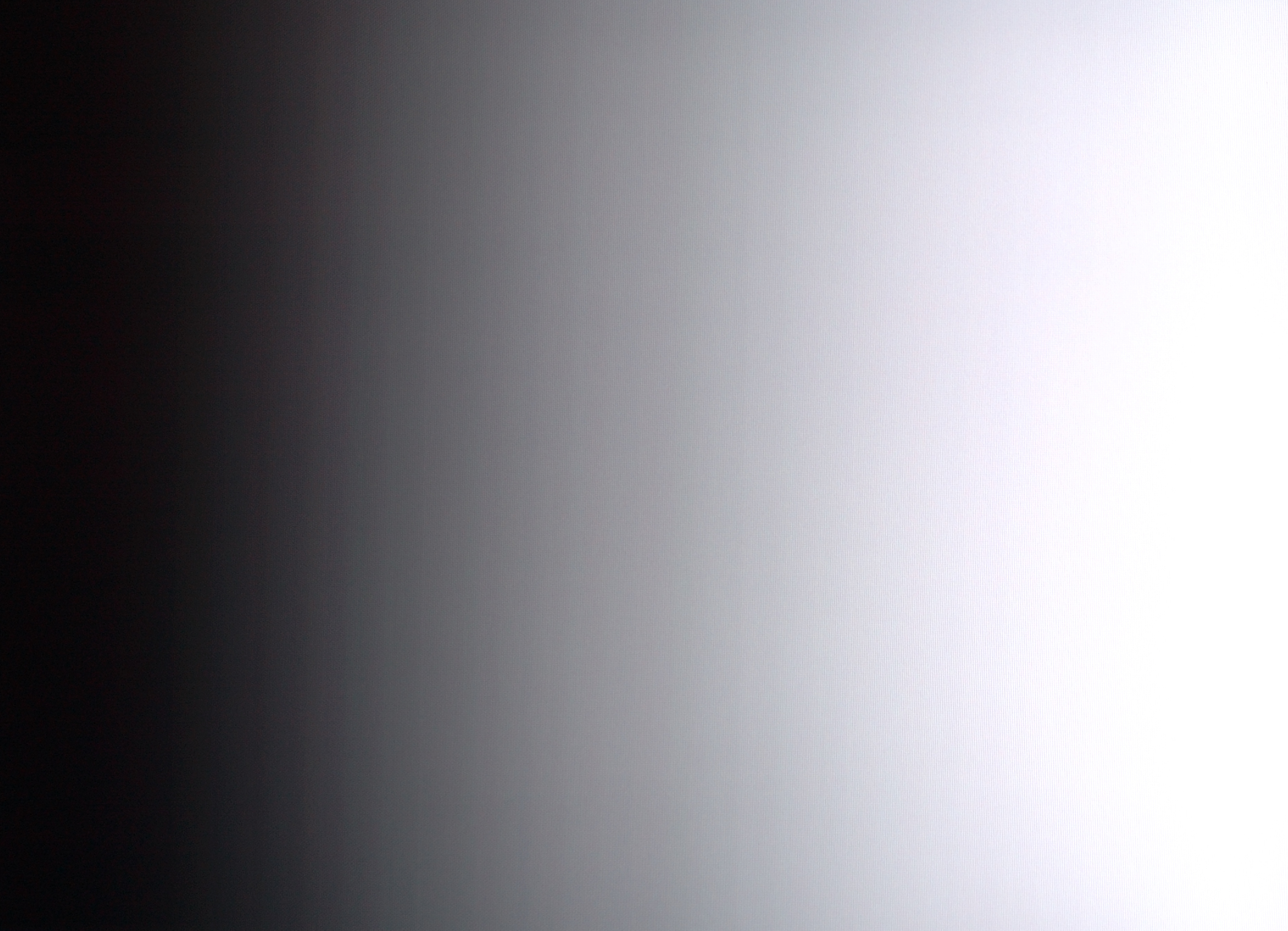

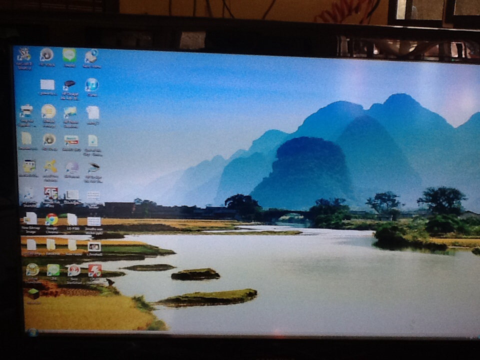

      This is the first time i connected it with a desktop cpu, colors seems fine but contrast is too strong adjusting it, no good really hard to tell what the problem is, sorry...
        Re: Samsung LA37B530P7R color and picture quality problem
        Try loading this image in full screen.

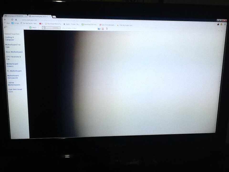

          Hi tom66,
          Here it its, looks like its over contrasted, what do you think?

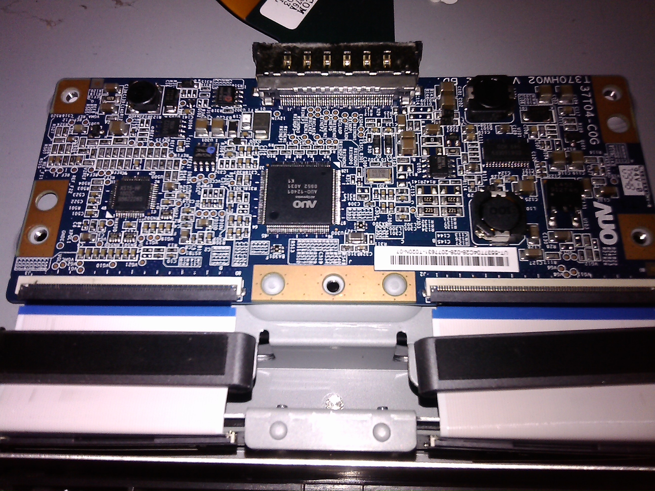

            I would agree. Can you post a picture of the t-con board?

              The tcon has a AS15HF chip
                So many failed AS15 IC. They do run warm and I see some of these have thermal transfer pad to transfer the heat to the metal shield.

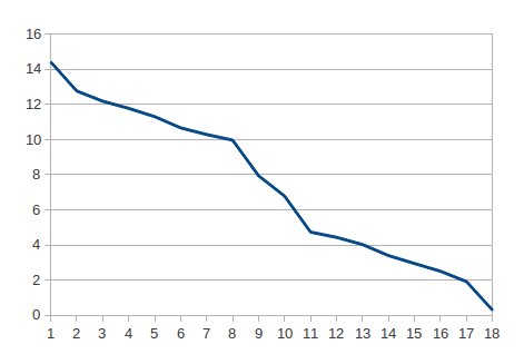

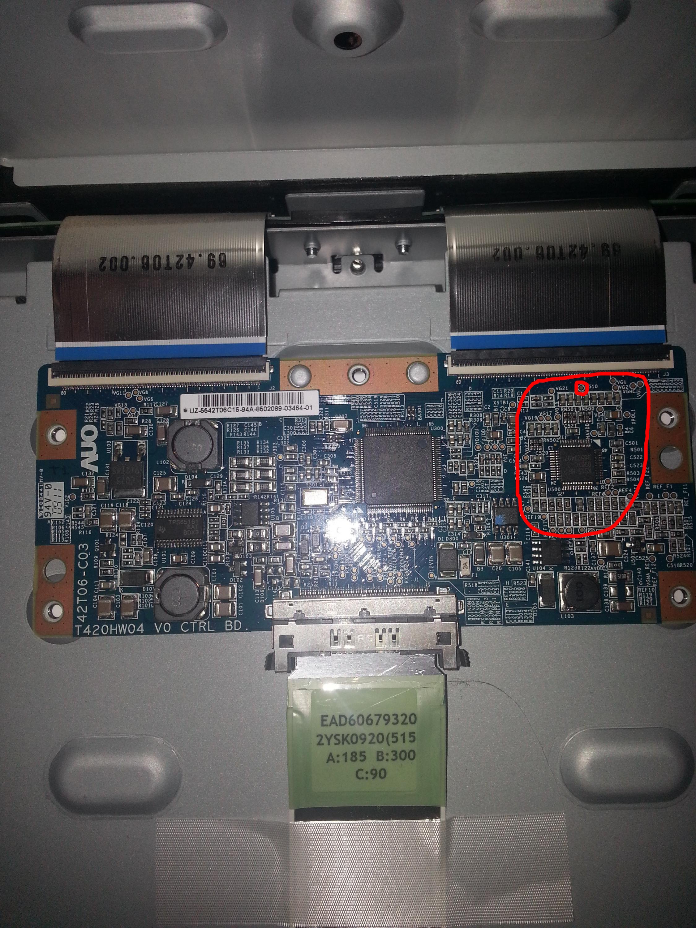

                  See attachment. There are 21 or 22 VGAMMA voltages to check I believe. I have highlighted one. (This is from same t-con board but other repair.) They are labelled VG1 thru VG22. To check voltage, set digital multimeter to DC 20V. Press gold pad test point with red probe, and keep black probe on chassis. Note voltage and repeat for all 21-22 points.
                  Plotted in order the wave should look like the graph (may vary, but it should be monotonic, i.e. increasing or decreasing only. Any sudden spikes or shallow regions are bad. It should also range from 0-15V.)

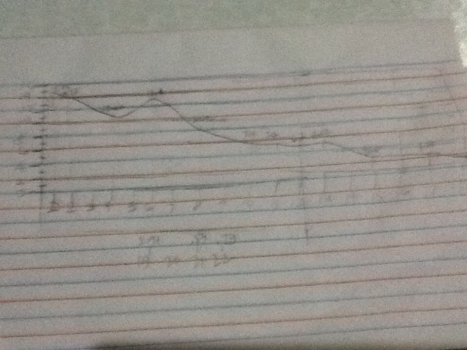

                        Hi tom66,
                        Here's the v measurements, sorry for the blurred picture, but as you can see there a big spike reading on vg6 and a small one on vg13, does this mean that my tcon or as15 chip needs replacement?
                          Forgot to post picture
                            #33
                            Yep, definitely bad. Replace AS15 or t-con board.

                                  Yup but my dmm i believe is not accurate its just a Chinese version but if its ok for you then here it is...
                                  Vg1 - 15.43v
                                  Vg2 - 15.17v
                                  Vg4 - 12.60v
                                  Vg6 - 14.41v
                                  Vg8 - 10.25v
                                  Vg10 - 7.9v
                                  Vg11 - 7.7v
                                  Vg12 - 6.7v
                                  Vg13 - 7.0v
                                  Vg15 - 4.88v
                                  Vg17 - 4.24v
                                  Vg19 - 2.91v
                                  Vg21 - .53v
                                  Vg22 - .29v
