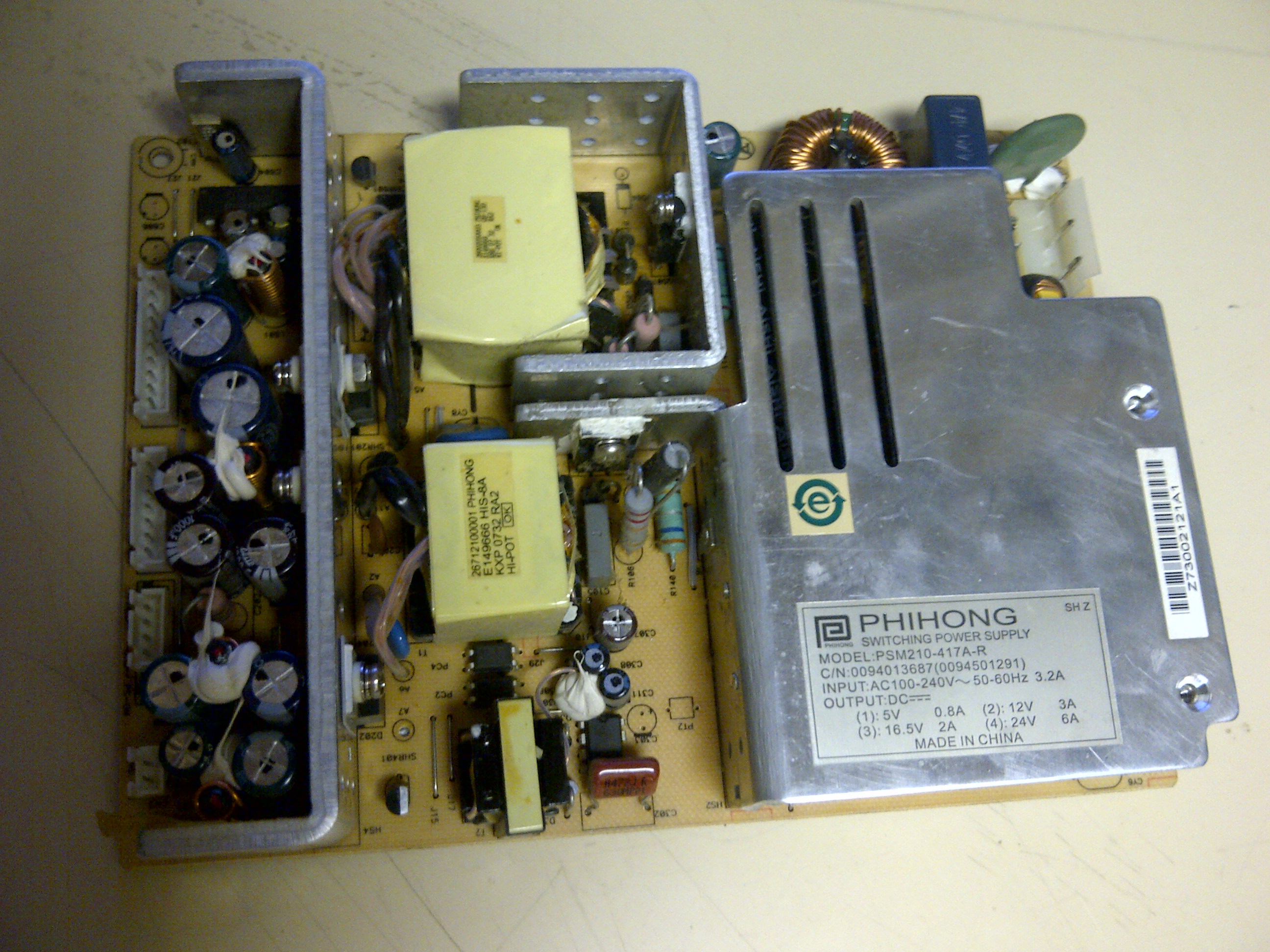

Insignia NS-LCD32 No Power Blown Fuse
  • dcapper
    • Dec 2013
    • 496
    I picked up this Insignia TV that wouldn't power up. After opening it up, I saw the main fuse on the PSU was blown. The power supply's model number is PSM210-417A-R. Been reading a little and it looks like this psu isn't worth fixing. I did find one mosfet Q102 shorted.The number on it is PFV2 18N50. Has anyone had any luck fixing these power supplies?
